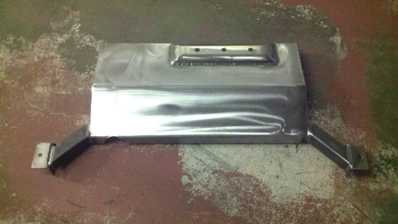

    That T-Case skid looks like it could take a beating. So the cross-member is welded/part of the skid it looks like?!:cool:
  5. Mar 18, 2012 at 2:55 PM
    #425
    92LandCruiser
    92LandCruiser [OP] Well-Known Member
    Feb 20, 2010
    #31761
    8,324
    Nevada
    80 series Land Cruiser
    Cummins, tons, 40s
    Yep! looks like this
    and the cross over drop is optional

    you make that tcase skid? looks realll nice for an option to keep the cross over

    That's a Relentless skid. I didn't really want to spend money to re-route the cross over.

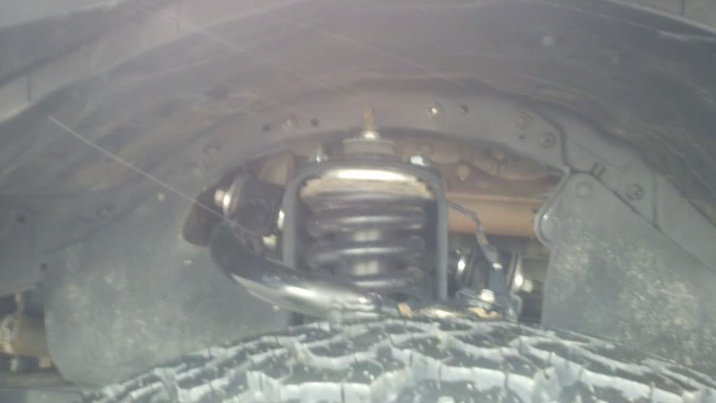

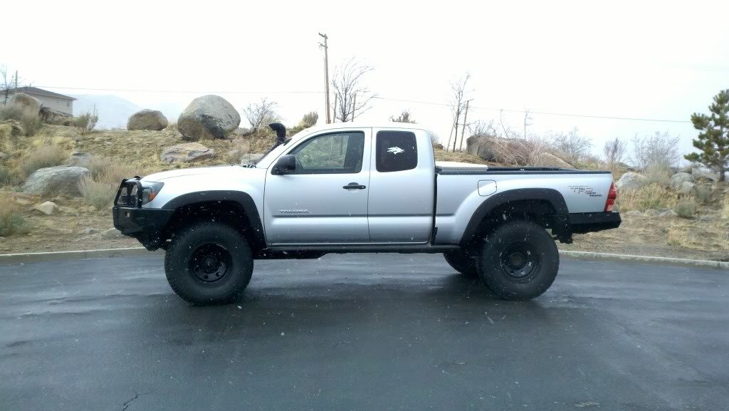

    Cut out some 1/2" aluminum top plates yesterday.
    1/2" with 886s and OME nitros netted me a full inch of lift. Whoops. CVs will suffer.
    Heres pics from today.

    Truck looks AWESOME Max. I gotta do the black flares and lights. I'm kinda thinking the Bushwacker pocket flares myself, but money may dictate that I bed-line what I got though!

    Damn I love the look of our trucks with HC bumpers :p:cool:

    Looks a lot better at the new height. How much lift total now?

    Ehhh I went from 7" driver to 8" driver from UCA to fender. Not sure how much lift from stock.

    Also, if anyones curious. I kept stock studs and switched to new 10 x 1.25 nuts with 3/8 washers and have a thread poking out. Good enough!

    I keep thinking about it and that one thread where I asked people to post their numbers I had 7" from top of BJ to fenderwell now it's 8" driver
    7 1/4 and 8 3/16" passenger.
    I just don't understand how it could have lifted a solid inch with a 1/2 top plate.
