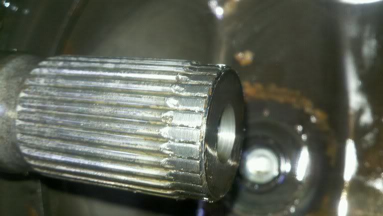

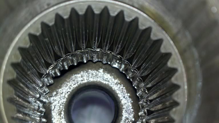

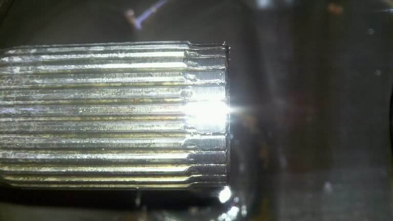

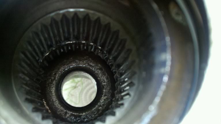

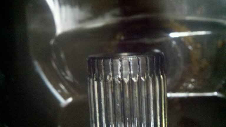

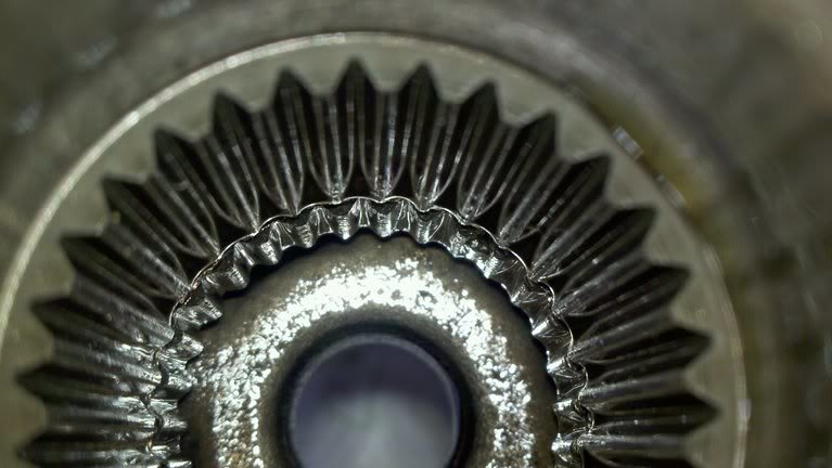

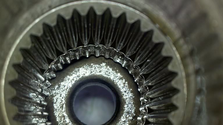

    Ran Hells Revenge trail with a group of TW guys at Moab. About half way through they said my locker wasn't working. Ben apparently also heard a pop.
    Got off the trail pretty late and I was pretty tired. I started airing up and everyone took off. Plan was to go hit the showers in Moab then back to camp for dinner. Finished airing up and put it into 2wd and couldn't go anywhere. Realized it was an axle shaft or the diff.
    Found JLees number on here and got a hold of him, he came back up to the end of the trail and then called Alvin (wetworks) who had some jackstands and other helpful tools.

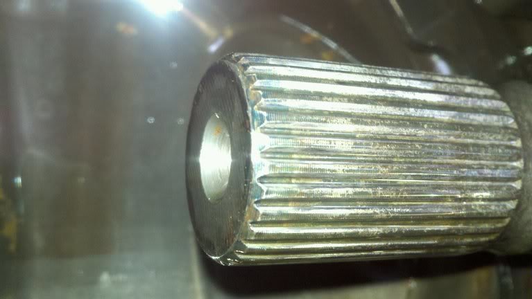

    We slowly narrowed it down to the passenger side axle shaft, we thought it was broken but when we got it out we found the last 1/4 of splines were stripped. Confused we threw it all back together and after talking to Jace (lotsoftoys) I decided to run it back to camp in 4hi.
    Called Chase at ECGS in the morning and he was certain I had snapped a side gear at the collar. He told me to run it home 2wd locked so Jace and Evan helped me lock her up and we headed back home.
    Chase sent me a new diff fedex overnight for a very reasonable cost, thanks again Chase if you see this! Got it this morning, pulled the old 3rd and found just what he thought. Snapped the side gear right at the collar and the remaining splines couldn't handle the load and just wiped right off the shaft. Rounded the splines on the inside of the gear a bit too. Guess I'll be needing a new shaft, Chase says I'll be alright to drive it for now though.

    Nah, there was a little wheel spin involved but nothing crazy. Chase said OEM parts are out of his control, but he still gave me a crazy good deal and a lot of help. I only found this failure online a couple places, doesn't seem super common. I posted on TTORA and I'll probably ask a few other places too.

    Got the new 3rd in. Running the shitty shaft for now, I'm trying to find a whole assembly bearing and all included to replace it.
    Everything seems to be working so far! :D
    Chase said I could get a chromolly shaft through him but it's 270$ then he said the bearings are super expensive. I need to do some research.

    yep the bearings a crazy pricey.
    id just go to a junk yard and try and find one.

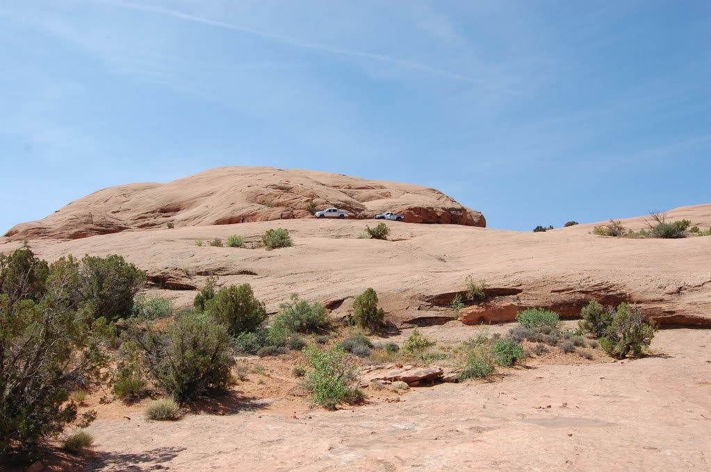

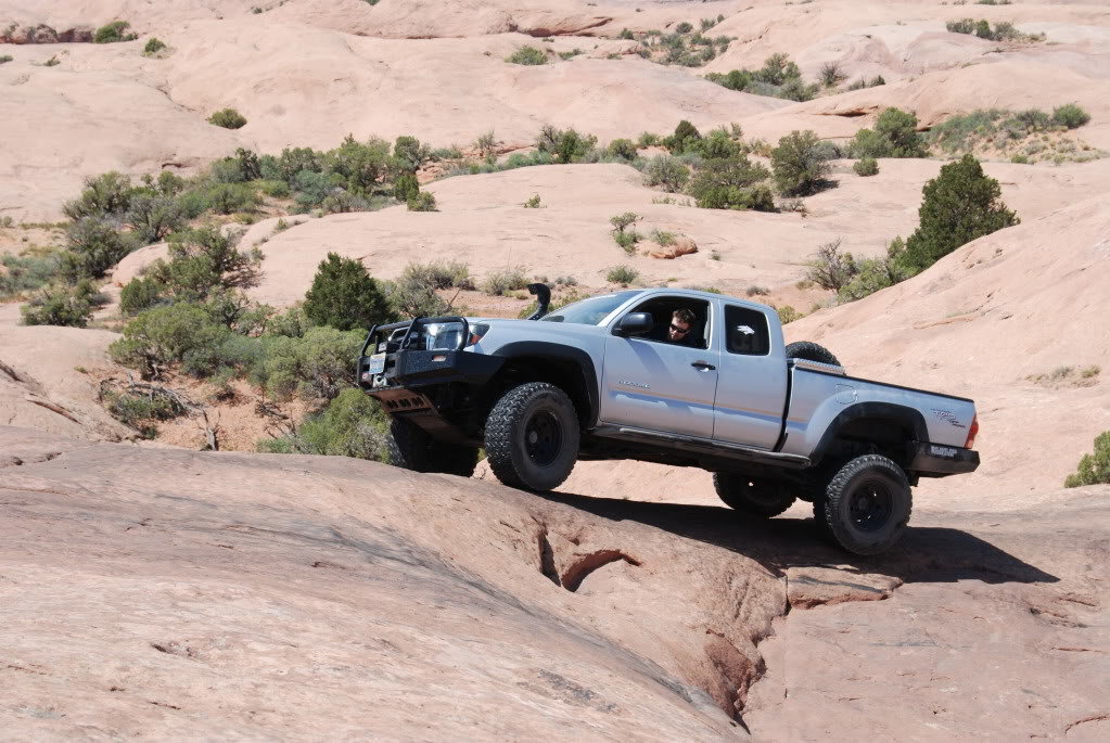

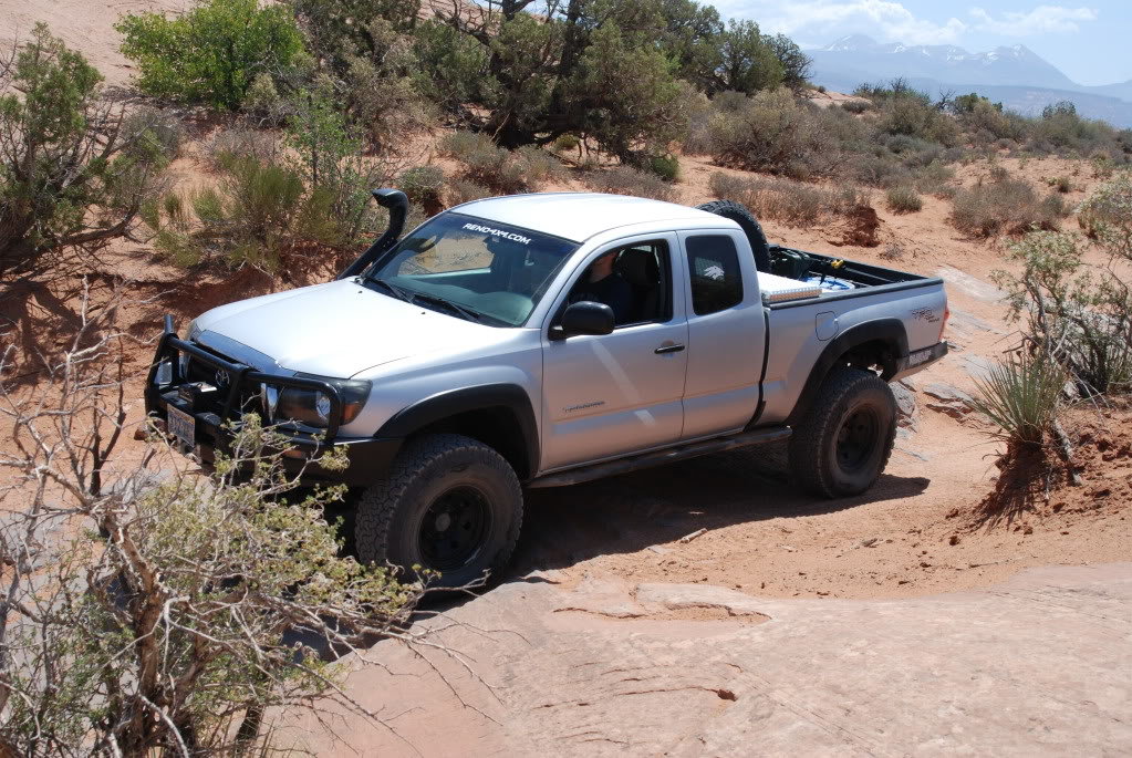

    Here are some pictures from Moab and the trip to.
    Really just wanted to go for a couple days, meet some people, do some wheeling, and mostly show the GF parts of NV and Utah she hadn't seen before.
    We had a great time even with breaking my 3rd.
