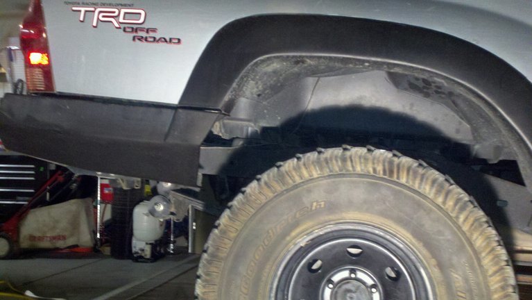

  12. Oct 20, 2012 at 10:39 PM
    #712
    92LandCruiser
    92LandCruiser [OP] Well-Known Member
    Feb 20, 2010
    #31761
    8,324
    Nevada
    80 series Land Cruiser
    Cummins, tons, 40s
    Not nearly as easy as I had hoped!
    Think it looks good. ??
    Got some of the other side done but cutting through the two pieces where that box is is a PITA!

  14. Oct 21, 2012 at 10:53 AM
    #714
    HomerTaco
    Mar 28, 2010
    #34129
    45,874
    HomerTaco
    HomerTaco
    HomerTaco
    If it was easy all the kids would do it...;)
    Looks great Max! :thumbsup:

  16. Oct 21, 2012 at 12:18 PM
    #716
    92LandCruiser
    Feb 20, 2010
    #31761
    8,324
    Nevada
    Cummins, tons, 40s
    I'm wanting to strangle you!
    Naw, not your fault but damn is it a bitch cutting through both plates.
    I might bug ya eventually though to tie it all back together. :)
