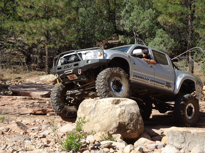

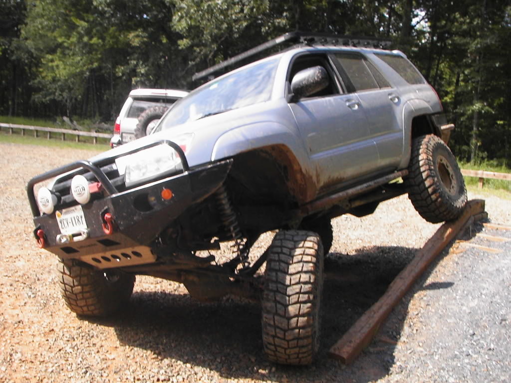

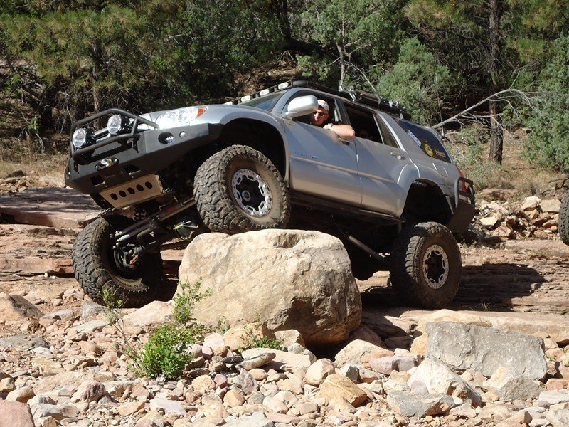

    just link it just like I did. The three link front and rear with opposing panhards works awesome.
    Here are three examples of trucks with that same set up.
    Roams4runner_zps8fce5590_85742c8512eb1fd9a19ab752e5860f1aa78dd5d3.jpg`
    You wont be sorry.

    This truck is going to be more of a light crawler... exploration... camping... road worthy vehicle, with a heavy ass cummins with loads of torque. I'm looking for good flex but above all I want it to be strong and stable. I know you have no problem cruising down the highway and I'm sure the 3 link would work well... None the less I feel the cost and the competence to get me there is quite a bit more substantial than leaf springs or even radius front leaves rear. Even if I attempted your 3 link up front I'd still be tempted to run leaves in the rear.
    Money and skills... :p
    Really I just feel like I'd fuck it up. Guess I should re-read your build.
