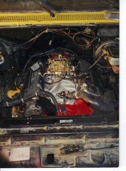

    Ever argue with a woman? Holy shit would that be a good one...then she'll want more horses! Nope, I gotta think of a better arguement than that.
    Thanks for trying to help. BTW...I have a 560hp big block that can probably be crammed in under the hood...maybe?

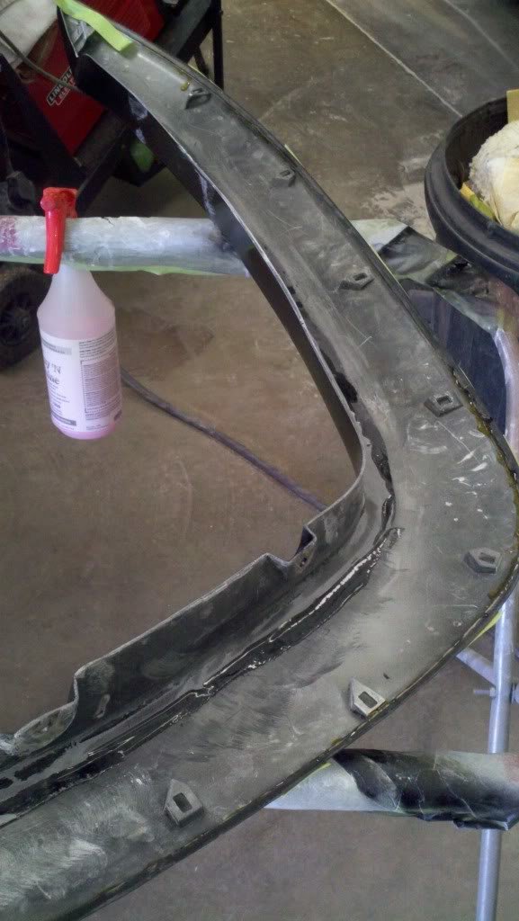

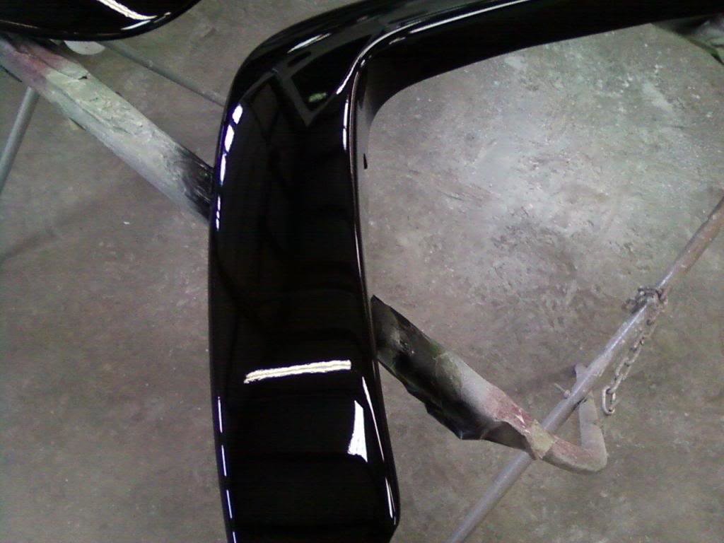

    Well I copied some ideas here, hopefully they're okay with that...
    they won't be quite so glossy and they are a bit wet in this picture but...
    btw Reno Toyota: 0, Fastenal: 1
    86 dollars for fender clips?! wtf?!
    EDIT
    3M 08223 adhesive is the shit used on my flares. Needs a special applicator gun and sets up fucking quick. ~50$ a tube

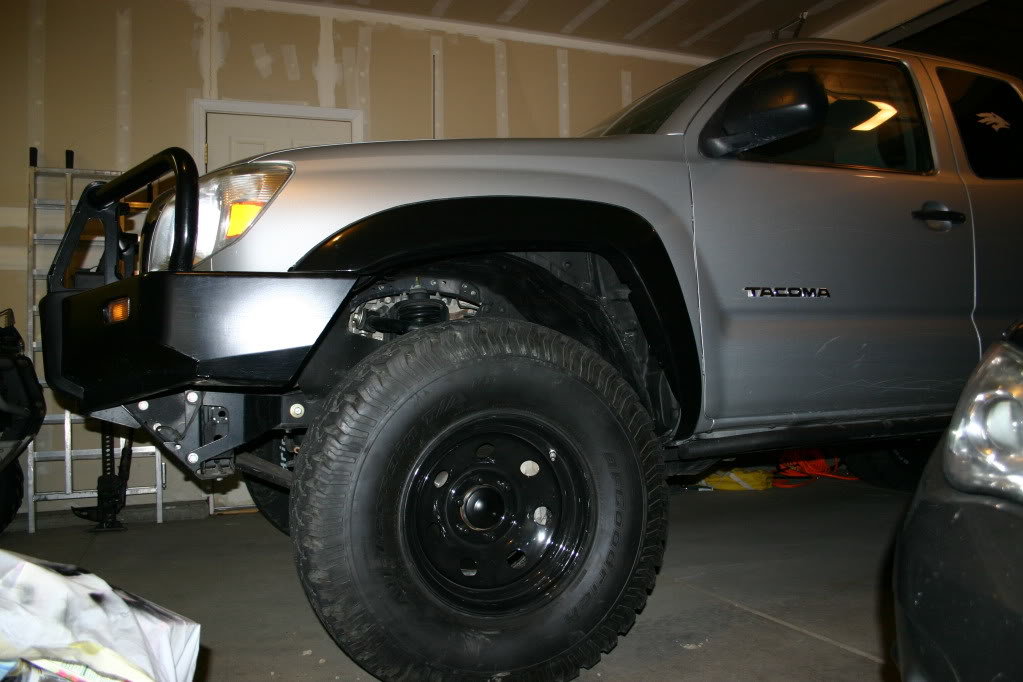

    I can't find my alignment sheet but I think it was set to ~2.4 deg caster and I think I need to push it up to about 3 now. I'm getting some rubbing on my cab mount and I don't want to trim much more off this area.
    Am I correct in my thinking that this should push the tire forward away from the cab mount? Other side hasn't rubbed yet but I'm not sure how much I've flexed it.

    I'm not 100% sure, but I believe if you go higher numerically, you willput the tire closer to the rear of the opening. Are you getting wandering at 2.4?

    To my understanding the more caster the steeper the angle the tire goes back as it travels up so you want less caster so it doesn't go back as far.
    This illustration may clear it up
    http://www.familycar.com/alignment.htm

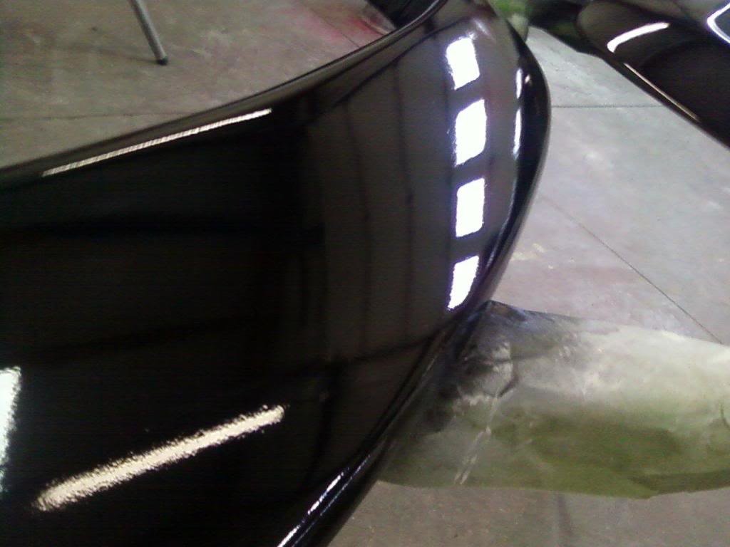

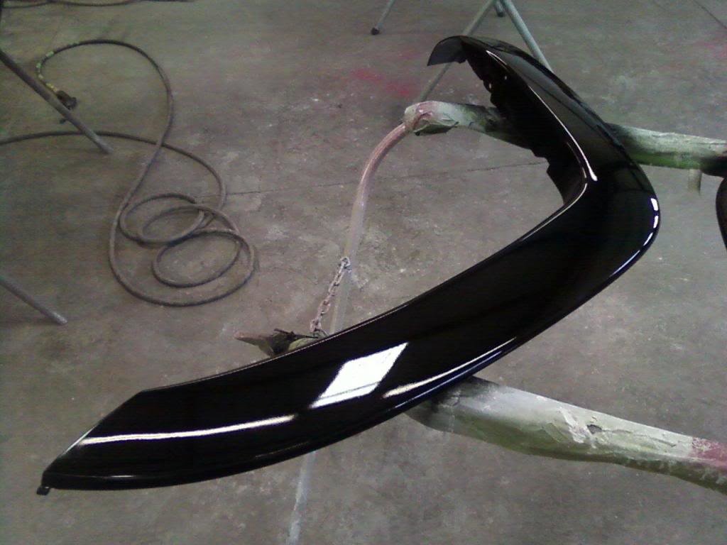

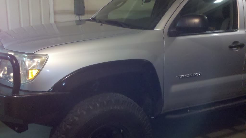

    One down, one to go. At least in the front. He's starting the rears tomorrow.
    He painted them satin but they're a bit too glossy for me so I might take them off at some point and put bed liner on them or perhaps just a semi gloss or something.

    Looking good Max. Were the original flares just sectioned? Any step by step pics of the job? I like the way they turned out. Are you able to see the section, or does the paint cover it well? If the "seam" is seeable, I would think some kind of bedliner would cover it up, then you can do the rockers and lower body panels to tie in the bumper and flares...:D
    Sorry for the inquisitiveness (that's a word for ya), but I like the idea of the stock look, except for the tires of course!:p
  16. Apr 26, 2011 at 3:05 PM
    #136
    92LandCruiser
    92LandCruiser [OP] Well-Known Member
    Feb 20, 2010
    #31761
    8,324
    Nevada
    80 series Land Cruiser
    Cummins, tons, 40s

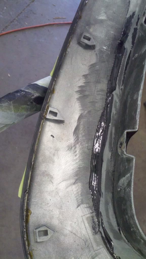

    Sorry no step by step pics. He basically cut the middle out of the flares and then used an expensive 3M glue to bond them back together, he also had to put a piece of an XJ flare in there somewhere to fill a gap of some sort. Yeah you can't even see the seam.
    Haha, I think I'm gonna leave the rest of the body. Although Eric's bumper should tie everything together nicely I think. Thanks :)
