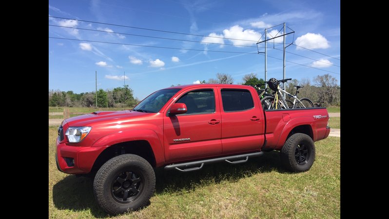

    Can you post a picture of how it sits now? I'm looking into a the same thing

    Not the best picture but the rear sits lower.

    Nice color :thumbsup:

    Thanks!! It's not really noticeable at all. It looks good

    Yeah. It's not a very good picture. But I can tell when I look at it lol.
