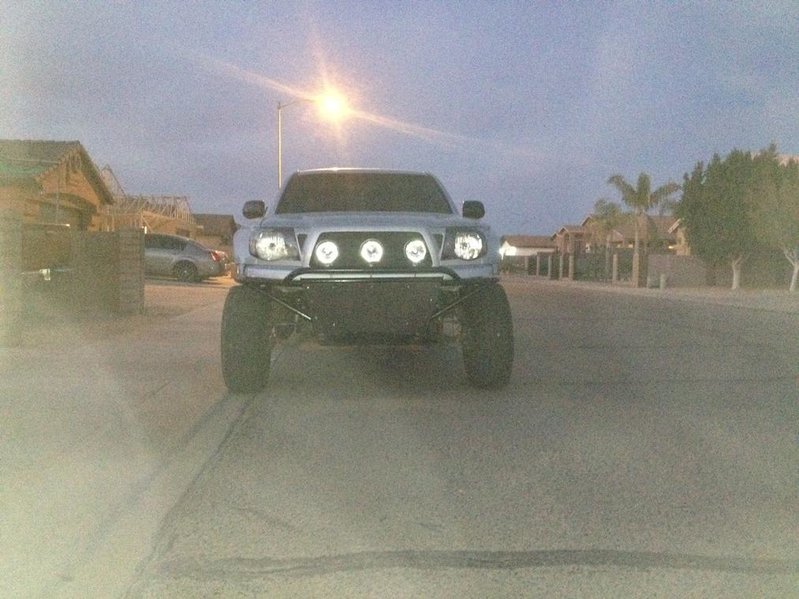

    I decided to start this thread to discuss/show off your Maxtrac spindle lifts and hopefully end the failed group buy/price questions...hopefully this will help other TW members considering this lift.
    I personally bought these from Jacob @ Suspension Specialists. Great guy to deal with and kept me updated on everything...these spindles are new to the market and am happy to be testing them out...with that said, I've been extremely happy with them, are beefy as hell, had a smooth installation with no hiccups.
    ...so show them off!

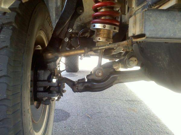

    My Setup:
    Front:
    Maxtrac 4" Spindles
    Fox 2.5 Resi Coilovers
    Light Racing UCA's
    285/75 16 tires
    16x8 3.75 backspace
    108mm to 106mm hub rings
    8/2013
    1/2013
    8/2012
    7/2012
    6/2012
    How it stands currently (3/2012)
    ...more pictures soon.

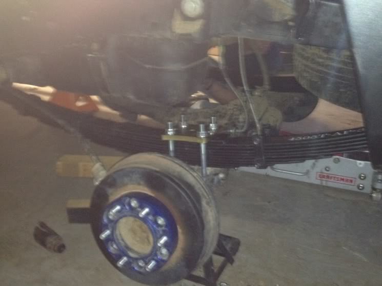

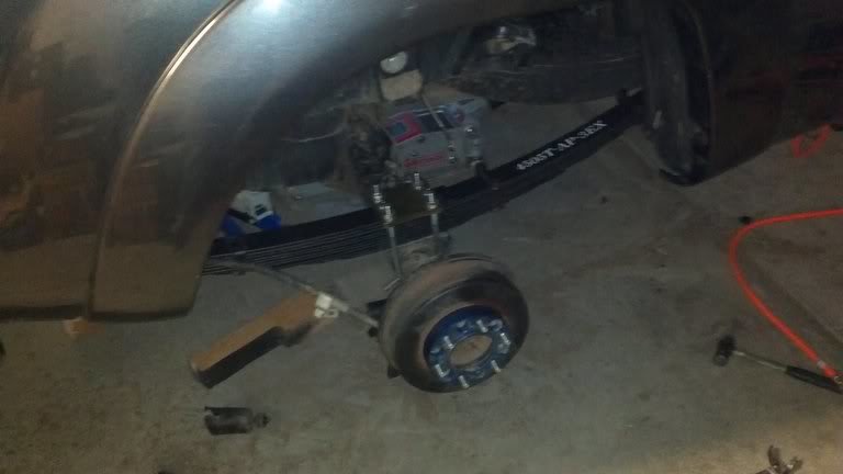

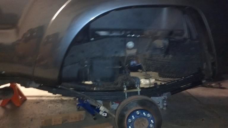

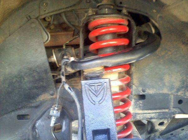

    Here is mine!!!! I went with the spindles and 5100's set at 0. The driver side is turned up maybe 1/2" to compensate for the taco lean... The front is measuring right at 25 1/2" hub center to fender. Still need an alignment.
    Here is the rear measurements:
    photobucket-32161-1329019315691_1091e21291e049874263f9e0148d1f8cb2a1e277.jpgphotobucket-35744-1329019340439_45b829c6045dc73d9ddce7d30d93862524af48bd.jpg

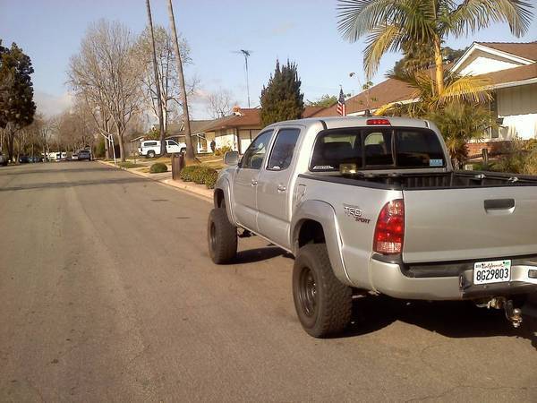

    Just figured out how to attach photos on here but i have maxtrac spindles with 5100 at .85 and a tsb pack with a 2" tuff country add a leaf and 5150 reservoir shocks in the back.
