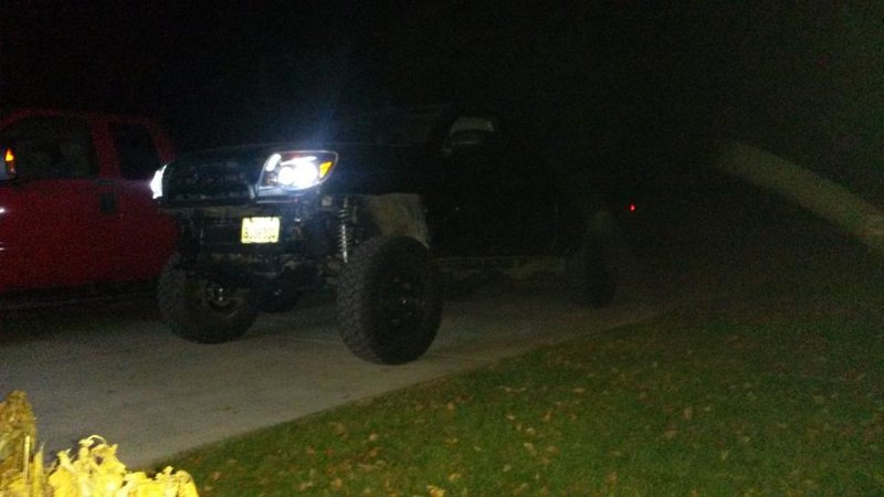

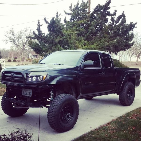

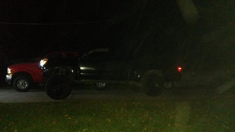

    So here is my 06 prerunner with eibach springs billy 5100s and maxtrac spindles. Billys are set @ 1.75 sits pretty high but I know itll settle overtime especially once I put my prerunner bumper back on. I am really pleased with how it rides and looks. Cant wait to get my aal and shocks for the rear. Major bro lean but itll be fixed when I get the cash :):cool:

    Spindles wont effect the geometry at all so the 1.75 is the only thing that'll affect the alignment in anyway but you're under 2" so you should get within spec no prob.

    Good lord that fronts ridiculous. There's no aal that will level that out. Your gonna need a whole new leaf pack or a big ass block to level that out. Bring the front down and make the ride better.

    Im actually happy with how it sits and rides upfront just want to raise the rear end up 1.5 to 3 inches and dont want blocks unfortunately. Id like to get some extended billys for the rear with an aal. I know ill still be nose high but thats the look I want :p ive always wondered why access cabs get bigger lifts with this setup though?!:confused::eek:

    How high is the lift in front? I calculate 8 inches?

    The 1.75" setting does provide 1.75" of lift with the use of stock coils. You have eibachs which have a higher spring rate (620) and typically just yield more lift anyways because of the quality of coil. These will not really settle much if anything at all on a 2wd truck.
    My guess is you are getting more than 1.75" of lift with that setup and I suspect when you have an alignment done they will be using nearly all the adjustment available to get the numbers right.
    Personally I’d drop the truck down some, but then again I really wouldn’t go over the 4" of lift simply because I care more about quality of ride and performance over height.

    Yeah ill definitely be dropping it down to .85 sometime this week. Rides fine and alignment is not that far off which is surprising. After I drop it down I should be at a 5 to roughly 6 inch lift. Also will be getting aal and some billys for the rear. Ride quality should be a little better and should still be nose high just not as high as I am now so .85 should be where I want to be ill see when its done. Cant find an access cab with 285s @ .85 with this setup. Ill post up some pics when its all said and done:cool::rolleyes:

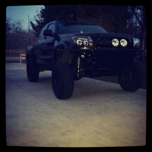

    So here is a day picture of my major bro lean but like I said will be dropping it down to .85 or even 0 and also adding addition weight with my prerunner bumper. If anyone has access cab with this setup please post a picture. Id like to see what .85 or 0 would look like with this setup. Will be dropping this major bro lean down by this weekend before my casters start messin up thanks
    Bird33 likes this.
