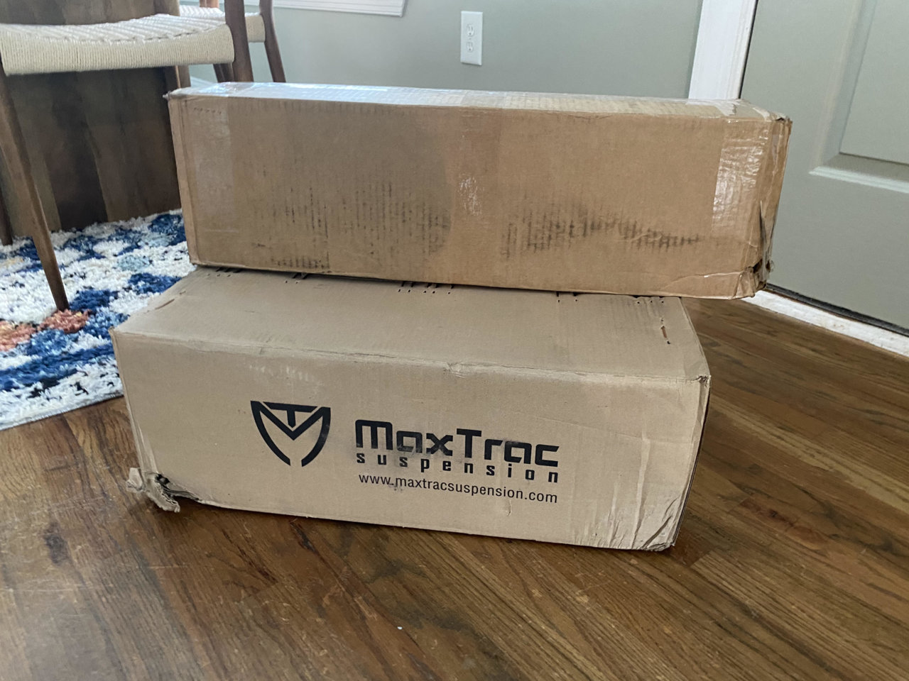

    Thanks man! Will do!! They got delivered today so hopefully it will be sooner than later!
    dumontrider and Jimmy92870 like this.
  19. Jun 21, 2021 at 6:56 PM
    Jimmy92870
    Jimmy92870 Well-Known Member
    Apr 2, 2018
    #249239
    803
    Texas (DFW)
    07 DCSB PreRunner
    Post pics never seen a 3rd gen Army Green on spindles lol
    BobcatSR[QUOTED] likes this.
