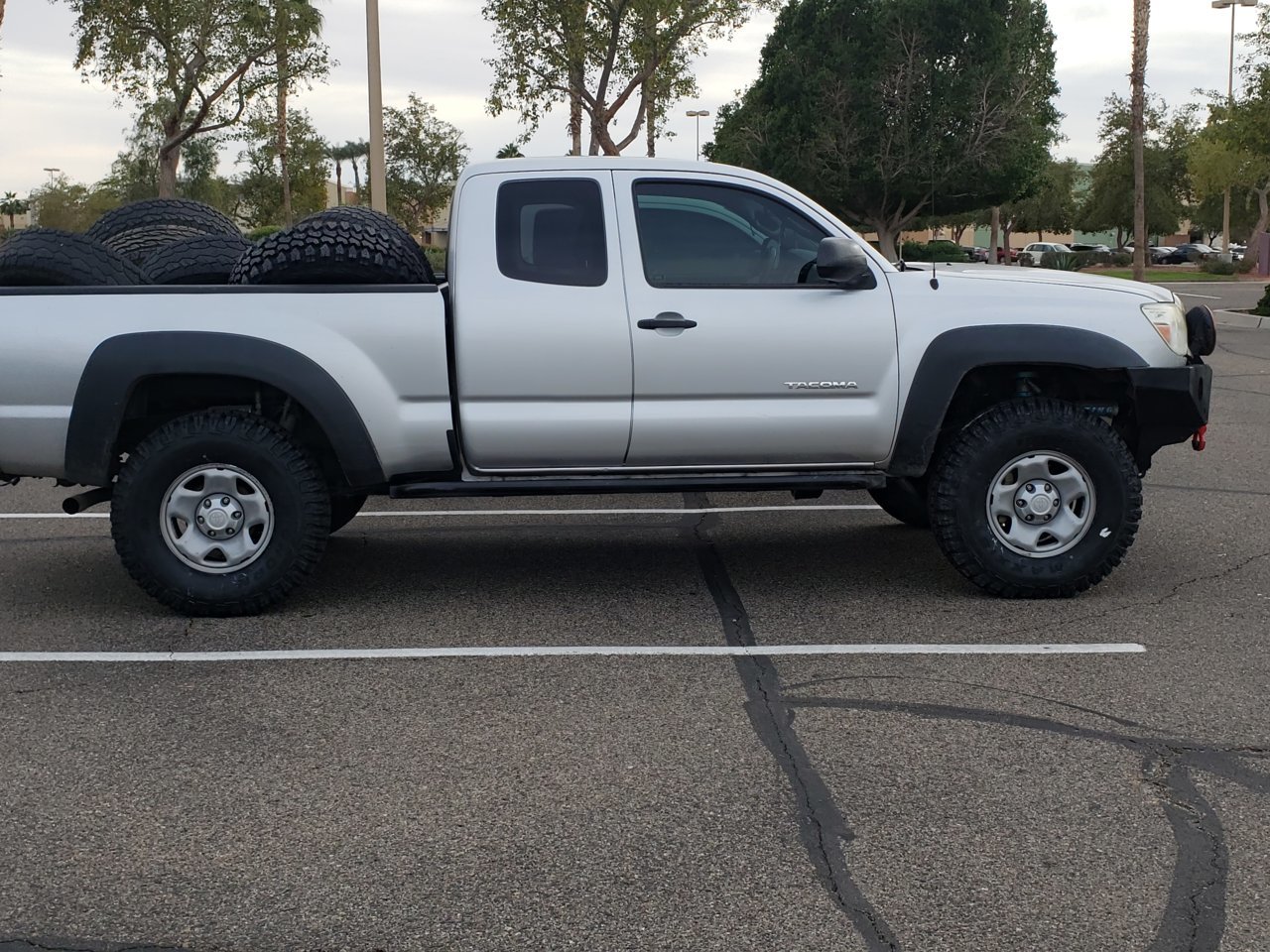

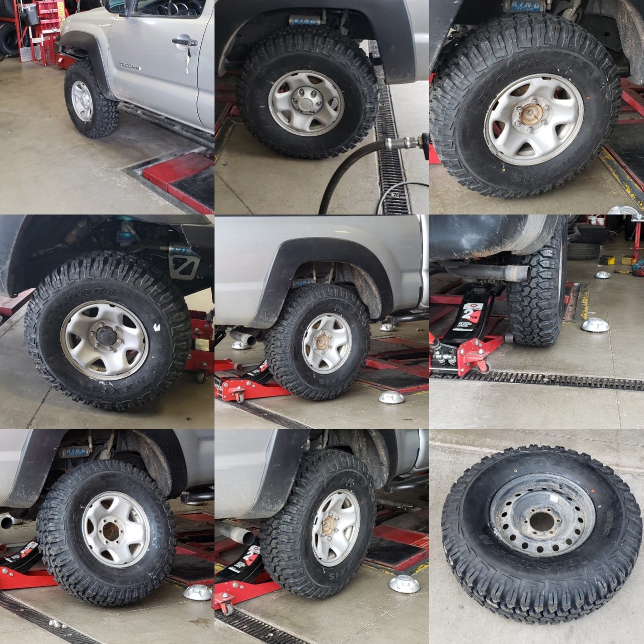

    Got the Maxxiss bighorns mounted and I love them so far should have went to tall skinnies a long time ago. I was afraid of the 4.10 gearing on the four banger. I have to say its rolling just fine.

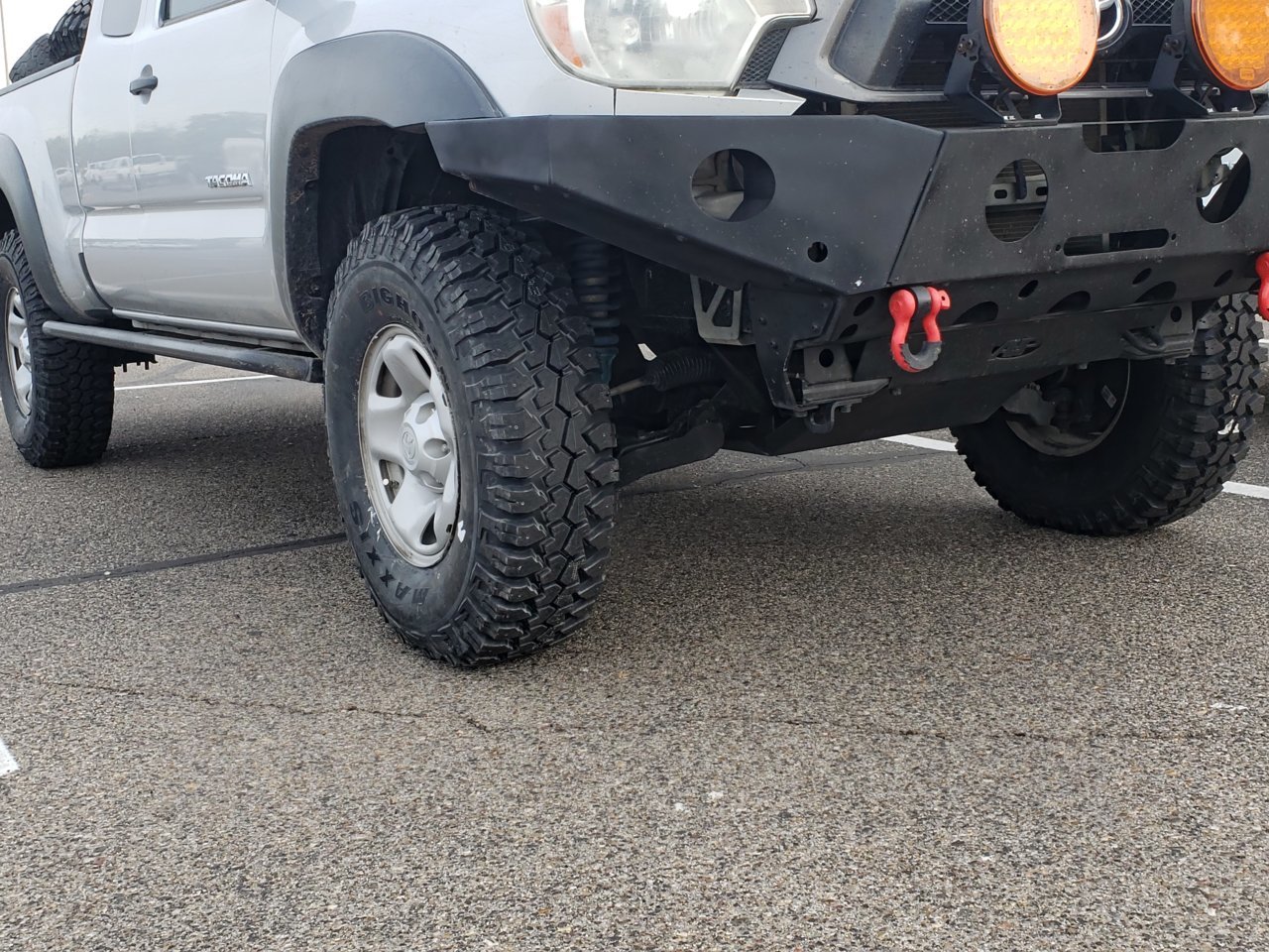

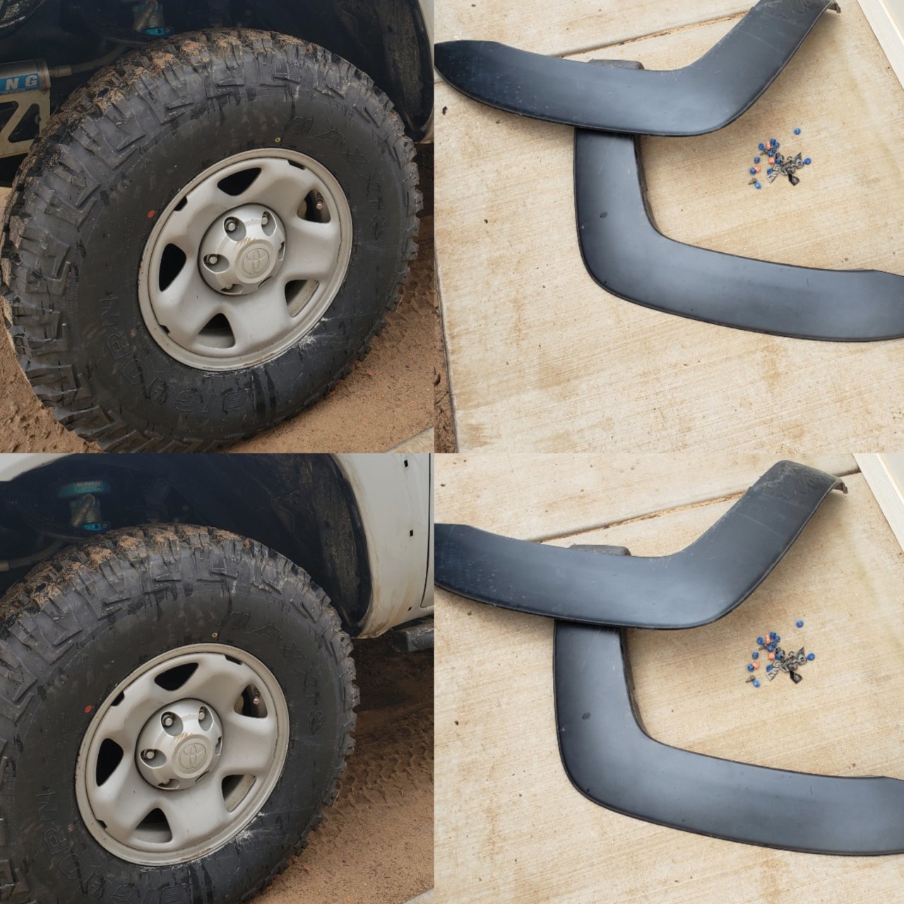

    I took them out for some desert R&D yesterday. Low speed articulation zero problems rubbing at full locks. Higher speed light rubbing from hard hits on whoops. On washboard its amazing way smoother from just a little taller tire. Not sure I'll be hucking the pizza cutter tires like I did with the 265/75r16s. I might end up self clearing some fenders.
    Update: front fender flares started self clearing took them off so they didn't

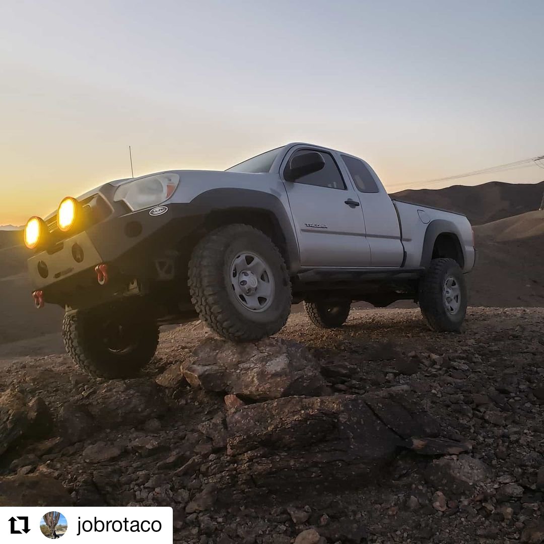

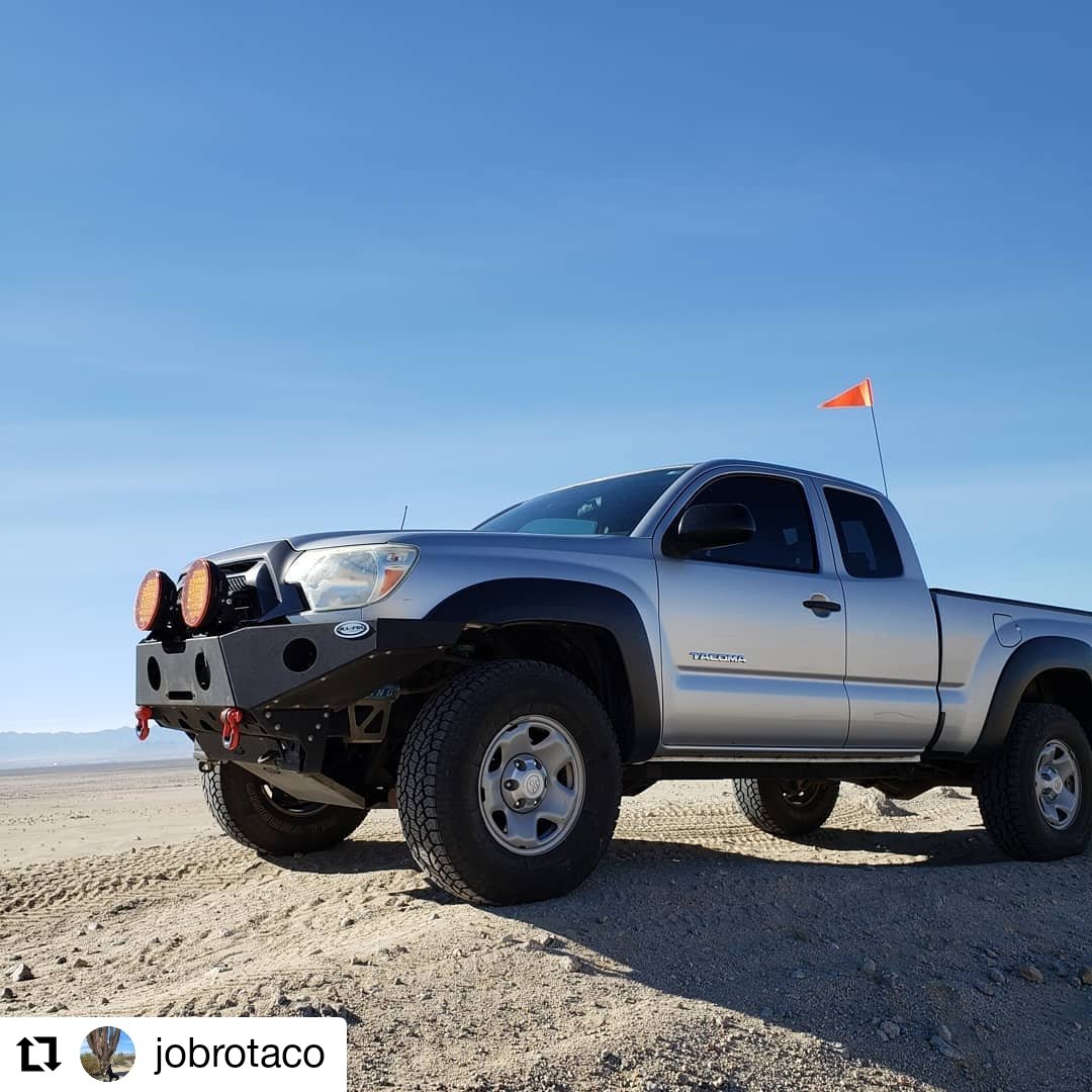

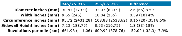

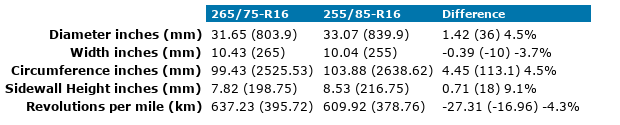

    Differences between my last tire size choices

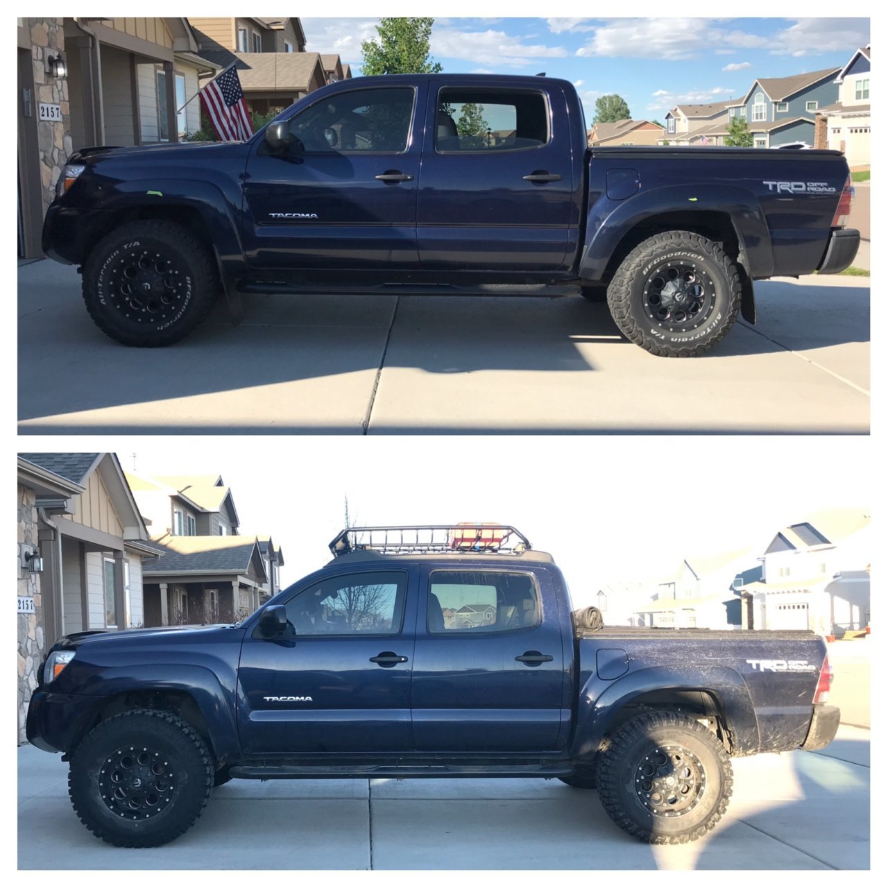

    Here’s the before and after: KO2 265/75R16 to Bighorn 255/85R16. Had slight rubbing in full lock but taking off the forward front mudflaps fixed that! Tires are surprisingly quiet and even smoother than the KO2s!
