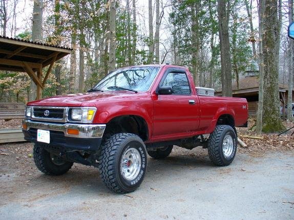

    Ive had 2 toyotas with buckshots, a 93 with 3'' lift and a 98 Tacoma with 3'' lift. I had 32x11.50s on both of them and wish I had gone with 33x12.50s. The 32s looked tiny on them both. Heres a pic of the 93...
