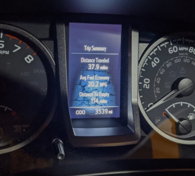

    First week follow up. So, over 500 miles on these tires. Dirt roads, a little bit of real off-road, freeway, grooved freeway, some rain (no snow). Here are my thoughts.
    Quick Comparison of 265/70R16s
    • OEM: 37lbs
    • SL RAZR: 38lbs
    • SL Wildpeak: 44lbs
    • LT BFG KO2: 52 lbs
    • LT Wildpeak: 53lbs
    • LT RAZR: 54lbs
    I was an early adopter of the Wildpeak and before now, I would have considered them my favorite AT tire. However, these are quickly becoming my favorite because they better meet my overall needs, and seem to be better, overall, at more things.
    I never had a problem with BFG's, they look good, I liked how "square" they look. They performed well, but are freaking heavy and really impact acceleration/braking/cornering. I liked the Wildpeaks more, but they were also heavy, although I felt they performed, overall, better.
    So far, because these are so light, I can discern virtually no difference in handling from the cheese-ball OEM tires. Mileage may have taken a slight dip based on the computer, but I'm still consistently getting over 20mpgs.
    • These things are really quiet. It's close, but probably quieter than the Wildpeaks. Definitely quieter than BFGs. Slightly, every so slightly, louder than OEM.
    • On grooved highways, really stable. Better than both Wildpeaks and BFGs. Very little wandering.
    • Rain. It wasn't a toad-floater, but no hydroplaning, very stable and confidence inspiring. No slipping under normal acceleration. Better than BFGs for sure. On par with Wildpeaks.
    • Braking, Excellent, better than the BFG/Wildpeaks, probably due to lower weight
    • Acceleration, Really really good. Again, because of the low weight, they come up to speed nicely. On par with OEM.
    • Dirt Roads. A really fun tire. Plenty of grip, easy to feel when they are starting to slide. And they slide very predictably.
    • Real Off Road. Very compliant. Didn't really push them too hard. They are SL, not LT, so I don't expect these to be rock-bashers, but thats not really what I need.
    • Highway compliance. A very nice, comfortable tire. On par with OEM.
    • Cornering. The carcass is slightly stiffer than OEM, so they feel more planted in the twisty bits. Not as stiff as an LT, which can be viewed as a pro or a con depending on speed, radius, etc. of the corner.
    • Look. This is subjective, but I think these are the best looking tire's I've ever had. They are almost too chunky looking compared to what I'm used too. I've always run AT tires, these look almost like an MT, but they sure behave light-years better than an MT on tarmac. I also thought the raised MAXXIS and RAZR would look gaudy. But in the real world, it just looks... cool.
    So, final thoughts:
    If you want an LT tire for heavy off-roading, I would be very confident in this tire.
    But, if you want a good looking, chunky tire, plenty capable of modest off-roading, but that also doesn't ruin the on-road mannerisms of the truck (which I think is probably the majority of us) the SL version of this tire, simply cannot be beat (so far). I do kinda wish they offered the SL in a 75, but the with everything else you gain, I'm willing to give up that 3.5" height (1/2 inch sidewall height) difference for all the other Pro's the 265/70 SL tire offers.

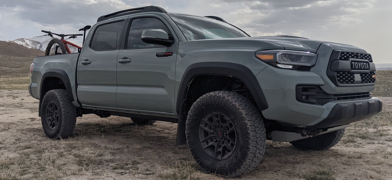

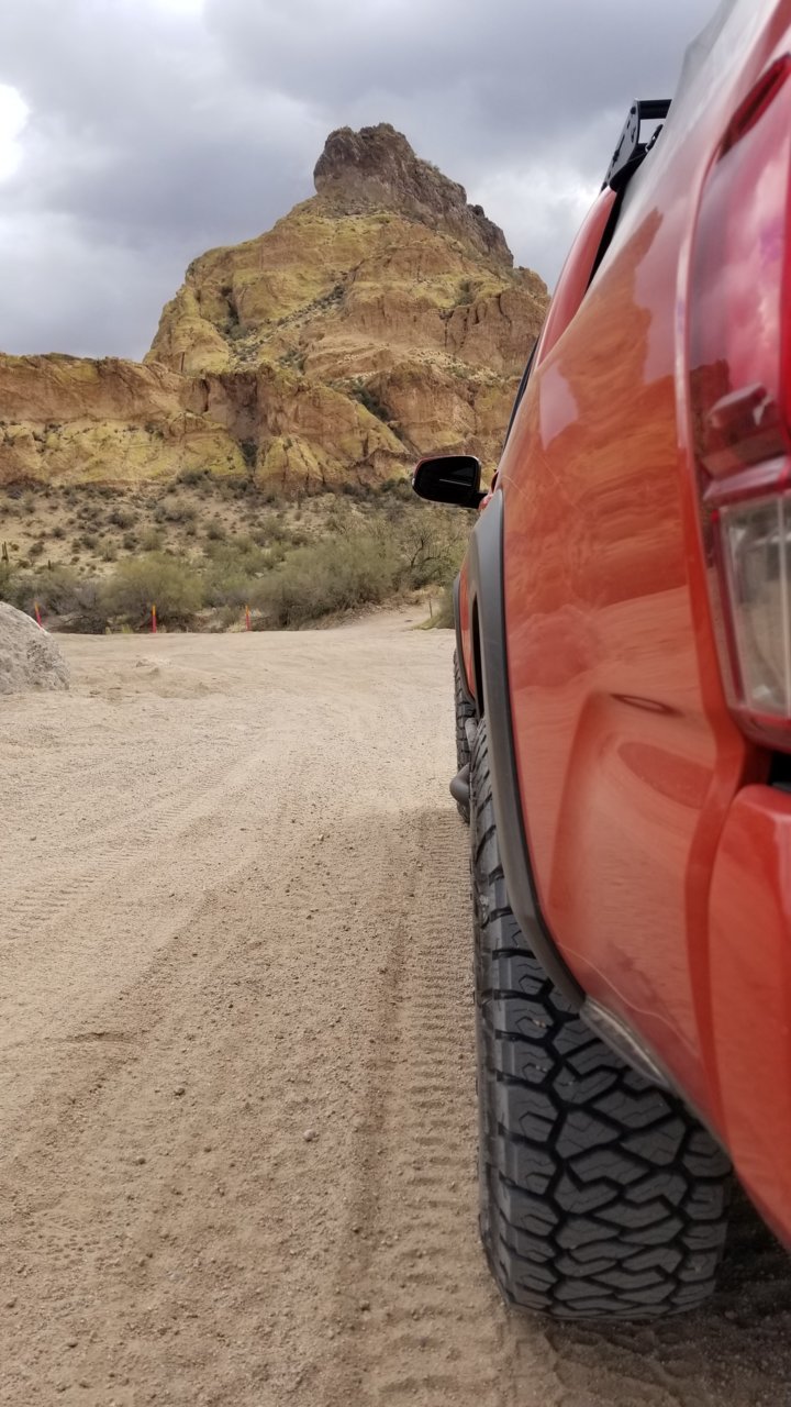

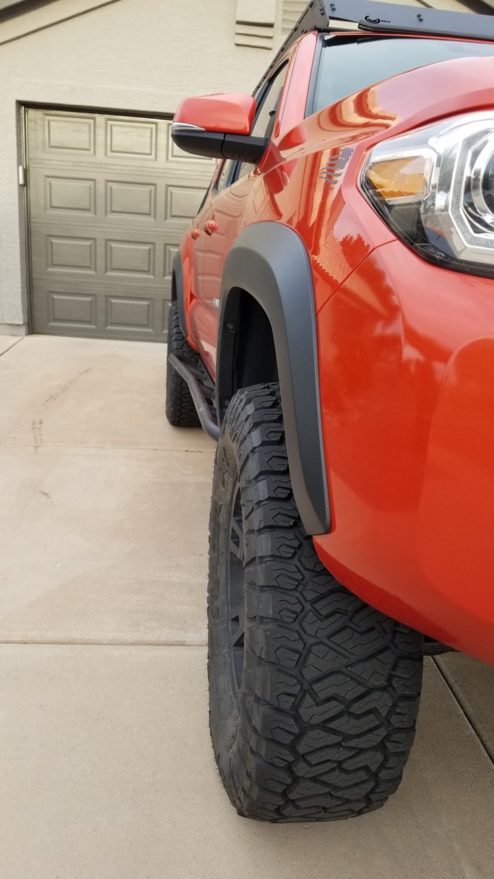

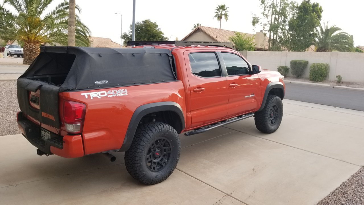

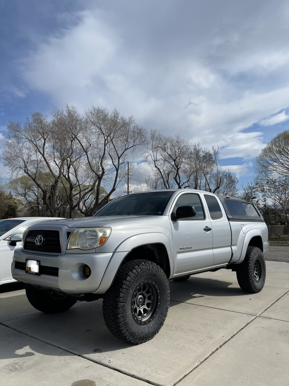

    EE0A51BA-B11A-4DCE-AB79-7C8AB3FA46AE.jpg 849939C0-4868-47A4-A52F-9E9DC46B0476.jpg
    Fenders and flares trimmed. I like these better than duratrac on road so far, haven’t taken them off-road yet.

    Looks great, What size and rating?

    thanks, 35x11.50r17 load range E
