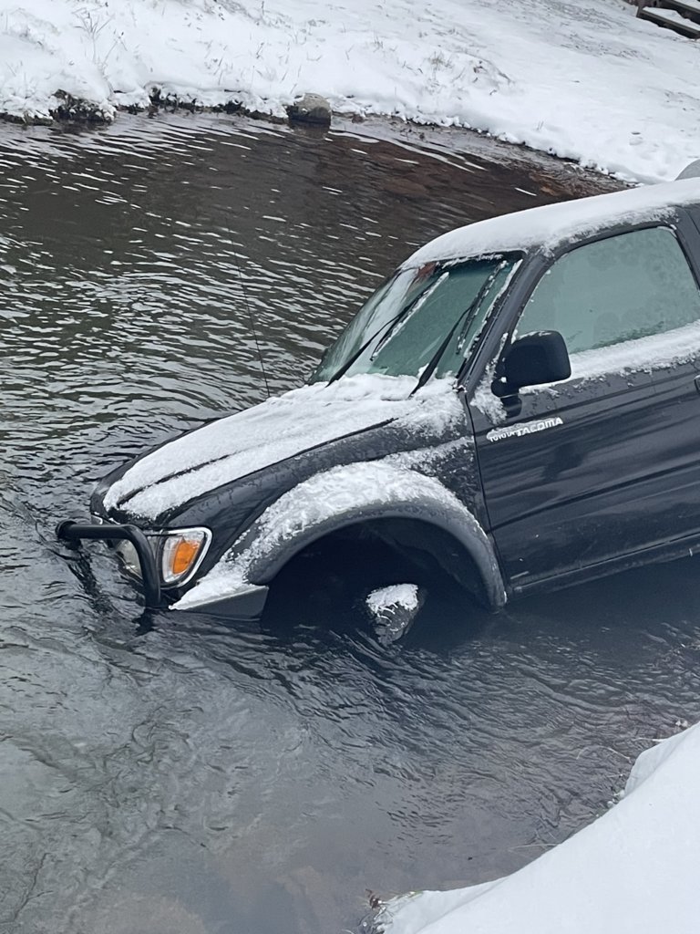

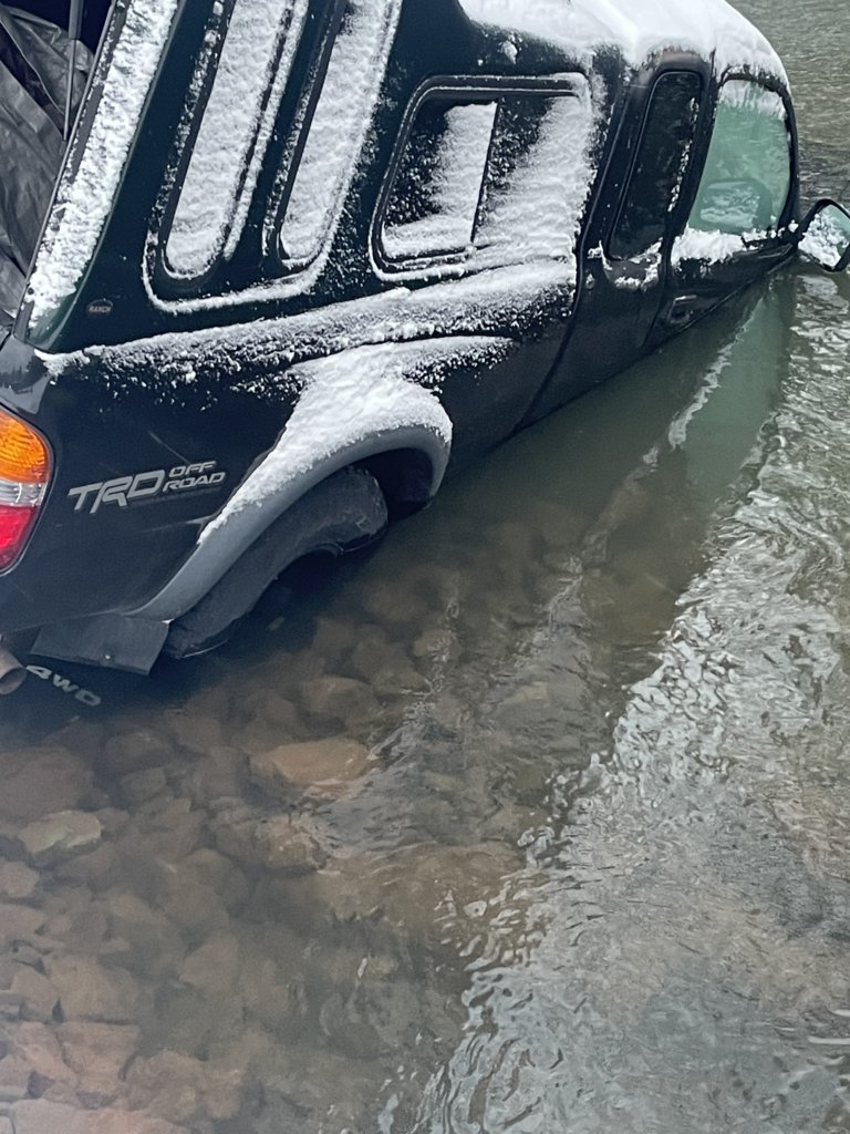

    IMG_2158.jpg IMG_2160.jpg So..was driving in a white out. Went to take a slight turn, and she kept going straight . Ended up in a ditch with water in it . Passenger side half of my engine was submerged for around 11 hours.
    I killed the engine as soon as I hit water. Pulled the air filter out after the tow yanked me out of the ditch and it had water on it but it wasn’t soaked, and the intake farther up from the box didn’t even look like it had any water in it.
    Miracle no injuries and no property damage where it happened. Also no body damage at all.
    I’ll upload photos, would like to hear opinions on weather or not the shop will be able to bring it back to life.
    When we pulled it out there was an audible alarm being generated from fuse box area. Pretty loud. 3.4l v6 not super or turbo charged, r150f manual trans . Meticulously maintained for its entire life. She has been a great truck to me over the years

    Wow, glad your OK. I guess if it was me I'd let it all dry out real well. Change oil just cause, pull some plugs you can get to and check out the cylinders as best I could for water or pull em all which entails removing plenum and blow out the cylinders by cranking motor. Your airbox intake tube was for sure under water. Hopefully everything works out for the best. Depending upon my bank account and ability. I myself would not pay a shop open check book to once over. I'm sure tow man hit you hard.

    Yeah pull plugs crank, drain oil, fresh oil in and get it running asap and she will be fine. Do not let it sit for long non running rust will kill it.

    Good suggestions above. FWIW, I took water through the intake on my second gen, and actually caused the engine to stall. My air filter was soaking wet, and there was water in the airbox. I cranked it over without the plugs, blew the air compressor into the spark plug holes, and it fired right back up. I had one spark plug that was wet.
    The electronics would be the bigger concern for me given how long it was in the water.

    Good thing is the both fuse boxes were not under water but the ecm probably was. The interior is easy enough to completely strip out. If I were you and had a garbage with some basic tools and basic know how, you can easily remedy this yourself.

    Do not let them say its a loss, pull the spark plugs out crank the engine dry out the intake, and passenger side electrical and (air compressor works wonders) and see if it starts up.
