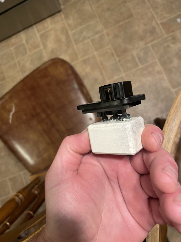

    Resistor for the blower motor is toast. And two of the screws around the blower cage are so rusted from being underwater that i shot them with blaster. Didn’t attempt to pull them, gonna shoot em every time I do the brake line and hope for the best. Good evening to everyone .

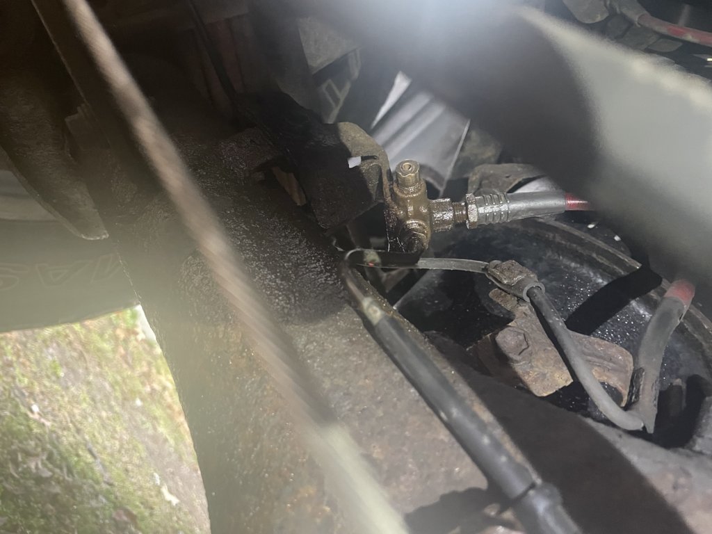

    I got the wheel side connection free. But the side going into this junction will not come out…any ideas ? Only one I have is take the other two connections off the junction get the junction off the truck and try to free it up on a bench. I would like to replace the junction anyway at this point but if you guys have any ideas that might help me get the darn connection I want free, I’ll try it. I’ve already started prepping bolts holding brackets to the line going to passenger rear tire with blaster. All I want is the frozen up connection free though. All I want

    Did u try to tighten it a little to break it free then loosen ?

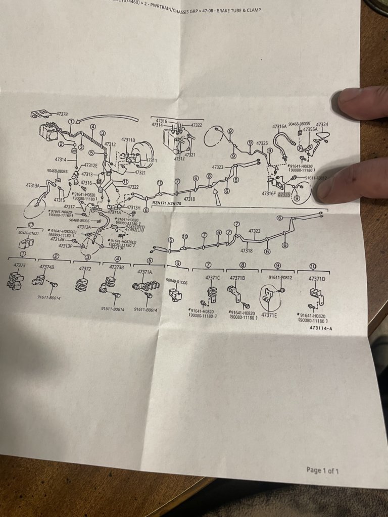

    The bracket circled (9) that I’m pointing to in this diagram …as soon as I went to take the bolt out of it the whole bracket twisted. Got it bent back mostly but Jeeze Louis , nothings easy is it? And of course it’s a bracket coming off the axle itself. It holds speed sensor cable and brake line.

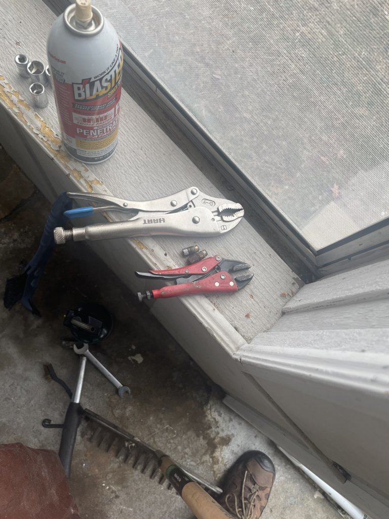

    I didn’t, cuz I’m dumb. Now the whole suckin thing is rounded. I tried propane torch, scary cuz it’s close to fuel tank and filter. Don’t have a map torch. Propane did nothing noticeable.

    Started blaster oil on all 9 labeled brackets headed to passenger side wheel. I’m so mad !

    I had similar issues with my front hard lines, even with proper line wrenches. PB blaster, patience, and vice grips eventually got them off when totally rounded. Careful heat in your situation since you're near the gas tank.

    10mil line wrench is what I’m using , but even on the new line it has slop. 10 mil is the correct size right?

    If the bracket is moving you need to back up the 3way splitter to apply leverage to remove the offending fitting. Vise grips, channel locks or a small pipe wrench

    the bracket is not moving.
    I’ve put it on hold due to rain.
    Thanks for your insight, the three way is solid.

    I would use a back up wrench on it. It helps for leverage

    I just got it off . I pretty quickly rounded the nut off and I was using a small pair of channel locks instead of a normal sized set. Didn’t have enough leverage . It’s off now. Gonna try to crack the bleeders now

    That extra four inches of leverage did the trick . Got all four bleeders a fresh taste of blaster , gonna let em sit and try to loosen in a bit. Today is a good day boys.
