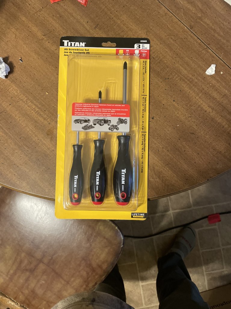

    Not going to let it deter me from getting it sound as I can in the next week and a half. Got till the 3rd. But I will accept the company vehicle. Oh, I did have a battery light on the dash this morning. I don't remember seeing it yesterday morning, both mornings same symptom, click, no crank no start.
