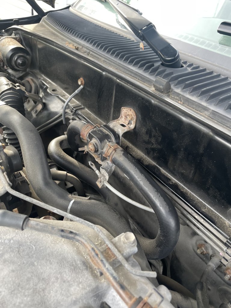

    @TACOTU3 pulled that cable off my heater valve control. Fixed my full bore heat(that was getting old). Now I’m exactly like you . Thank you IMG_2668.jpg

    I have ac again! Happy to report my compressor wasn’t damaged from the water, just the cable seized up in the heat position on the heater control valve! Great success!

    If anyone has ever replaced the cable that adjusts that lever, let me know how deep that rabbit hole is to get at it and replace. I’m digging through my Haynes book now.

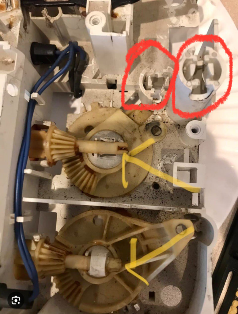

    Here is where the cables connect inside the module, the red circles (ignore the arrows, I just pulled this picture off of Google). If you damage any of that, they’re just going to pull right out every time you turn the knob.
    there are two more on the other side, so you’ve got to get one or two of them unclipped before you can really start moving that module around, otherwise it’s kind of got itself held in place by cable tension.

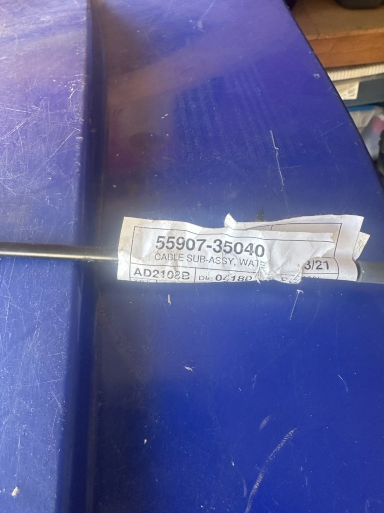

    Here’s the part number from mine, just been sitting in my parts hoard for a couple of years… Want to say it was somewhere around 15 bucks
