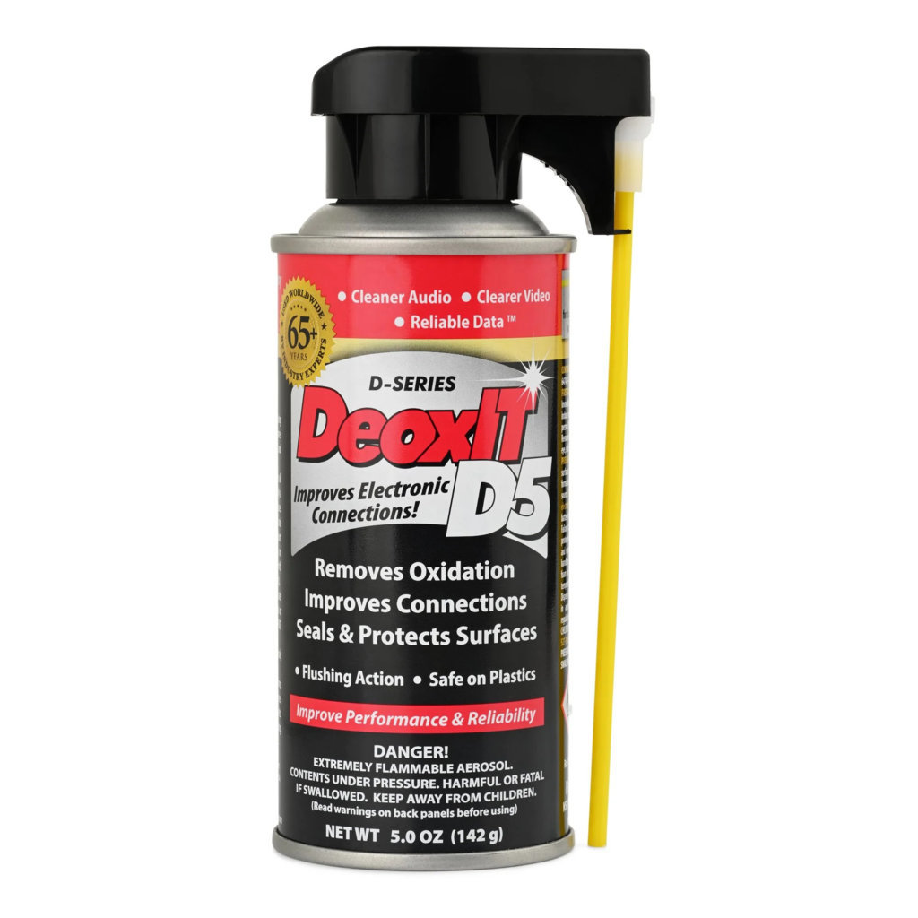

    I don’t have a shop..but my buddy does . And I’m a low voltage dc tech as my job. Done all the suspension work myself. Electric issues are much more dynamic and I have already thought the same, unfortunately. I agree wholeheartedly.
    So, it hasn’t been a daily driver for over two years now. My work provides my vehicles.
    In essence, you’re correct , and it was already a hobby truck. I actually have a can of deoxit for working on pots in my hyfy home system. Never whipped it out for the truck, but something tells me I’m gonna need to order a value pack of it. Stuffs expensive! Truth hurts sometimes. Rolling with the punches

    Renots
    No need to replace all engine harnesses
    just need to unplug every pigtail and spray with electrical cleaner
    my neighbor swears by CorrosionX
    Expensive shit but WAAAY less than any harness.
