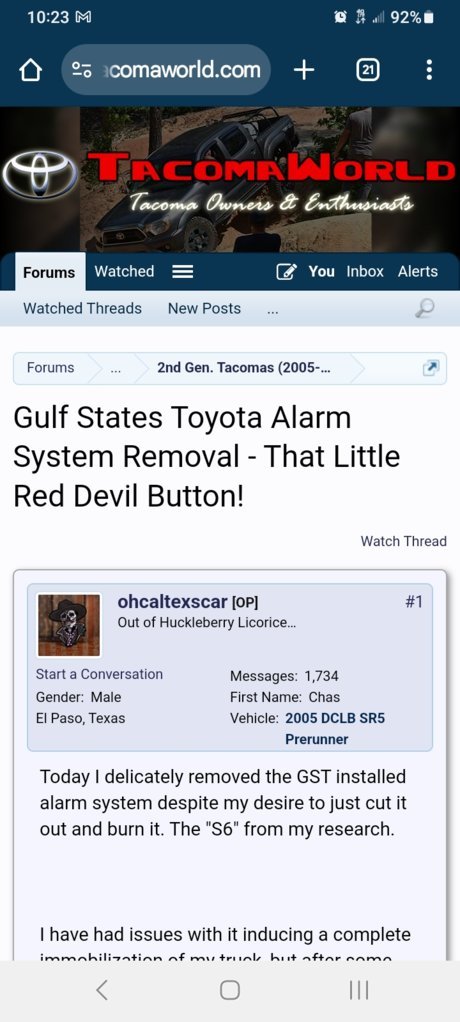

    Not sure check it out. My truck had the gulf states toyota dealer alarm w/keyless entry left me stranded a few times till I removed that POS last year.
    You may not have that one but I think the rs3200 came in some trucks your ym. Anybody else know???

    I had to screen shot it. I feel like a moron how the hell do you post a link from a previous thread, anybody help lol
    Edit: I'm going to search I'll figure it out

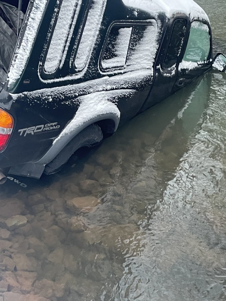

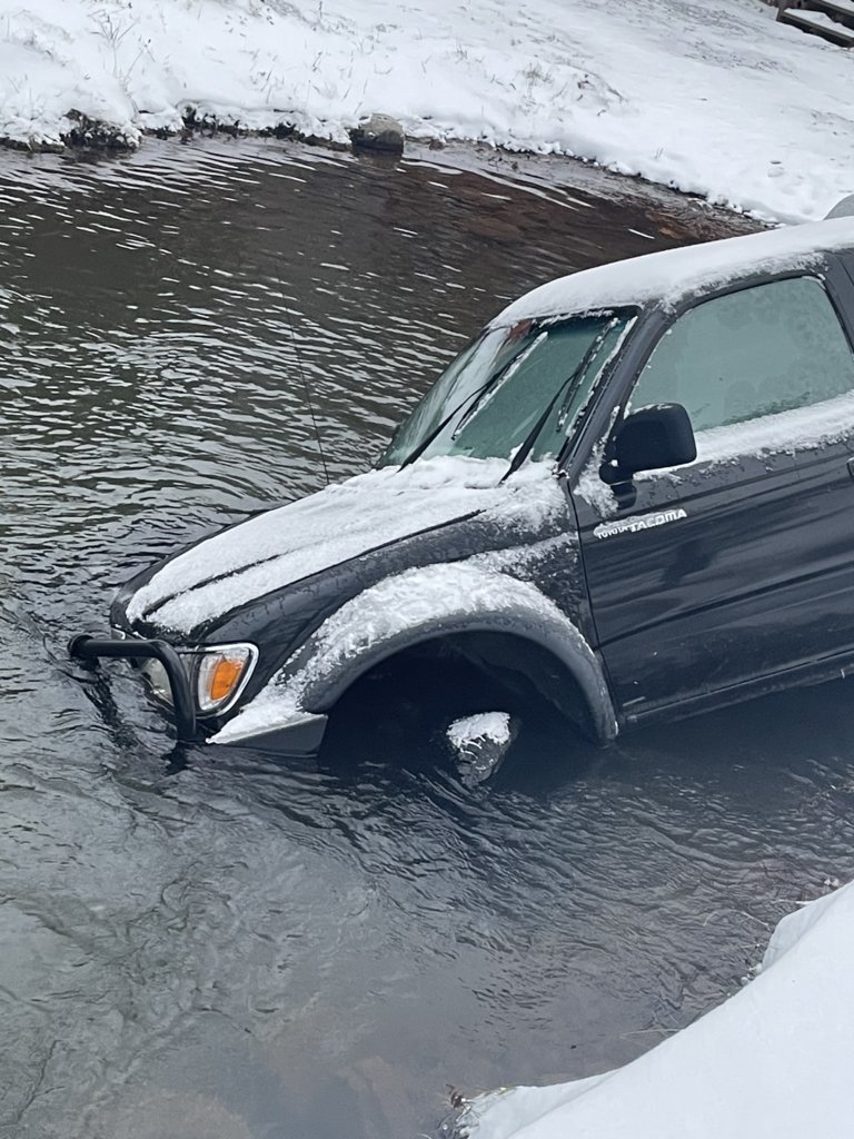

    Here’s a recap of how it sat in the water …bout 11.5-12hours it sat like this
