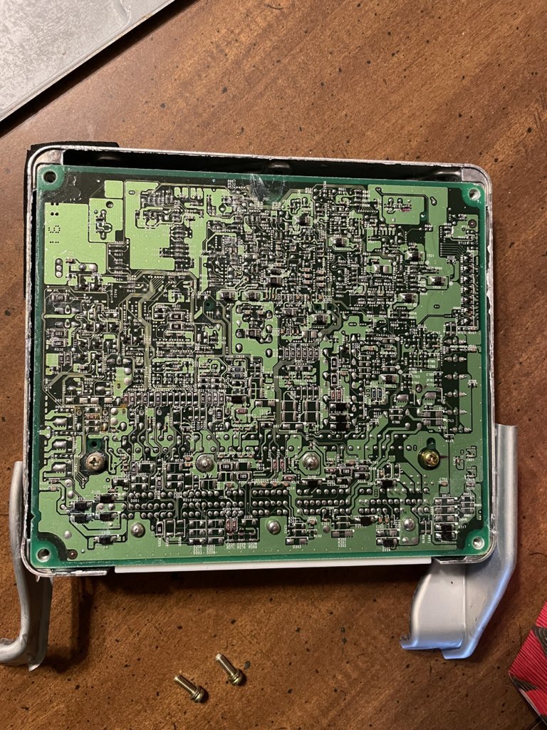

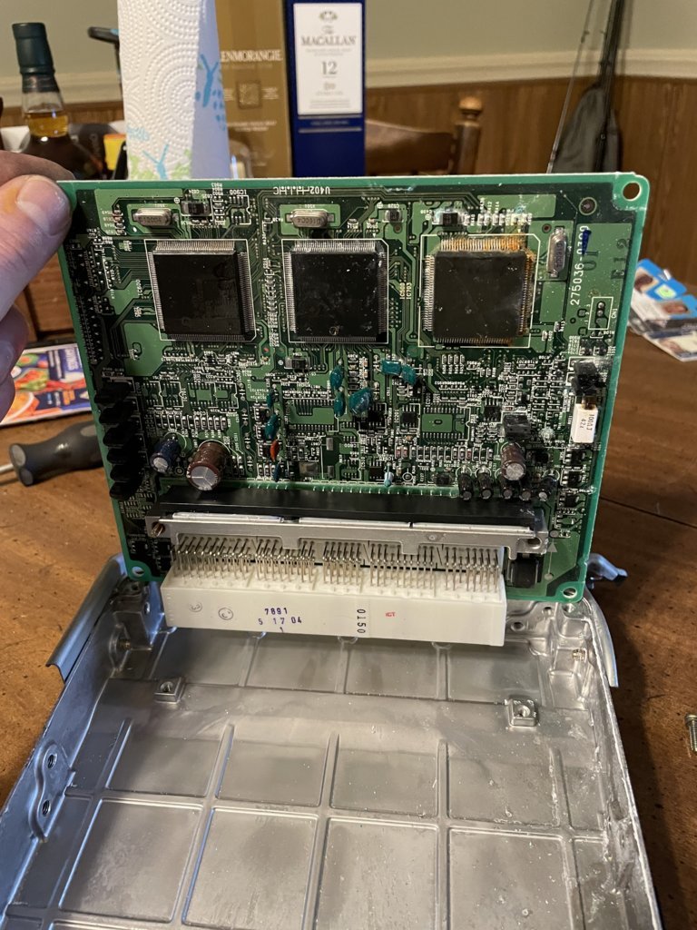

    safe to say she’s toast? Or should I take these corroded screws out and look at the other side

    I see corrosion where water got into one side for sure . Rust spots. Water entered the case 100%

    Definitely got wet ECU…

    I’m screwed

    Can yall help source ? 89661-04830
    I see a few on eBay

    I had to replace one in our Old Rav 4. Purchased from ebay and it worked fine.
    Good Luck

    Ordered one. 777$
