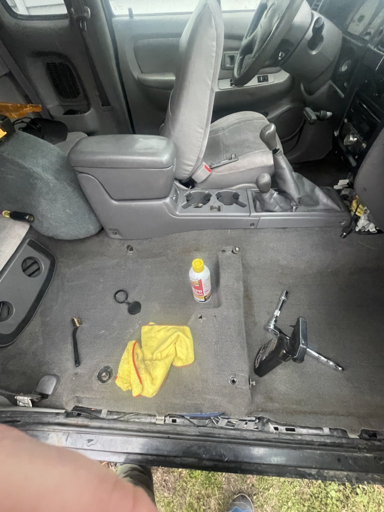

    Attempted to clean it but one of the chip wire connections was so corroded it broke when I brushed with toothbrush . Pretty sure this thing is done. When the new one arrives do I need to get it programmed with the vin or anything like that?

    Makes sense, the leads were pretty corroded. You could microsolder it back on but I would call it done for.

    Yeah I couldn’t find any breaks in the hoses yesterday. I’m fixing to put this old ecm back together and see if it improved functionality. If I can get heat I can dry out the floor much easier. And I’ll check back in when I figure anything else out on the brakes. Marnin fellas !

    The leg coming off the chip I thought was broken is just a black corrosion spot. I can’t see this old ecu not functioning better than it was yesterday after I cleaned it up. Then brakes.

    Put in the old ecu, can’t get it to fire up anymore. Cranks but no fire up. No amount of poking around near the battery will get it to the condition it was yesterday. Saw this little bell module coming off the master cylinder , I’m wondering if it was the alarm that was audible that I was hearing yesterday when I was able to bump the right stuff and get it started. Gonna put the battery on the tender and try again after while. When i heard the muffled tone i knew it would start. IMG_2286.jpg

    So we tested for power in the fuse box under the hood and we aren’t getting any power to any relays or main fuses related to engine.

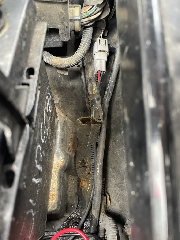

    Found the brake leak on left rear line near the wheel. Rigid line

    Last post of
    The day. Ordered a pre bent steel line to replace the busted one. 15 dollar, cheapest part I’ve ever ordered from Toyota.. it’ll Be here around the same time as the ecu. I’m not a flarrer haha. Good evening fellas
