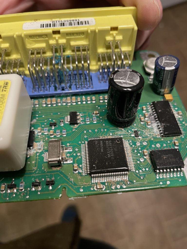

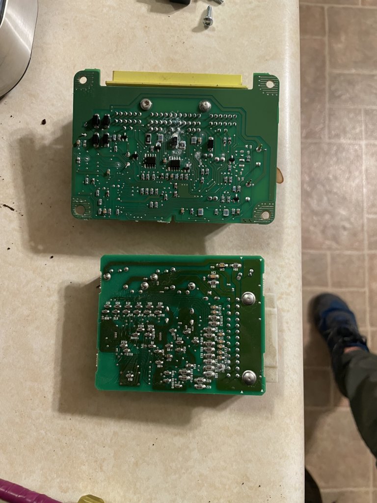

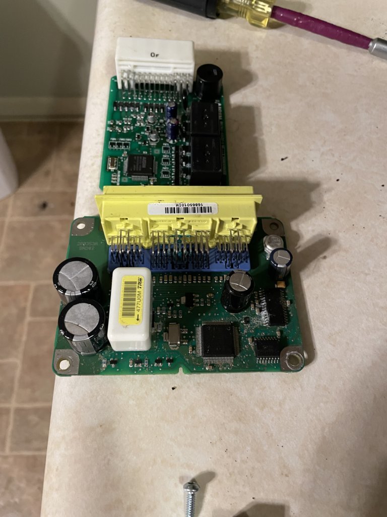

    airbag module and 4x4 control module, both have corrosion and water damage.
    Gonna get these ordered tomorrow … 4x4 module looks like I may be able to clean up but definitely not the airbag board…will replace both. It was a good day fellas ! Cleaning up for the evening.

  12. Feb 9, 2025 at 3:08 PM
    #152
    renots
    renots [OP] 15mpgTaco just entered the chat
    Jun 29, 2014
    #132951
    285
    Doug
    Southern Illinois
    04 Tacoma SR5 TRD OR 3.4L M/T 4x4
    OME suspension lift 882 coil overs Aftermarket UCAs and upper ball joints with zerks Arb bumper with warn winch All new dakkar leaf springs Diff drop kit Suspension parts purchased at wheelers off road 32” all terrains and nicer bullet hole rims.
    better shot of the airbag module 89170-04040.

    Surprisingly both boards cleaned up really nicely. I’m going to definitely order both tomorrow, but i want to put these back in before Tuesday so I can test run with the new ecu. Highly doubt either of these boards will come in before the ecu is here.
    Anyhoo, tomorrow I’ll be back at it, cleaning and the like. Got all the rusty bolts from the tear down sitting in pb blaster, some of the seat bolts were quite bad. I did snap one bolt head off today, one of the bolts that hold the center console of the interior to body. Gonna drill it out and retap just cuz I’m that kinda guy, and I have a tap and dye set ;). Might do it in imperial…haha..I won’t. I’m not that type of guy.
    JIS set on order..
