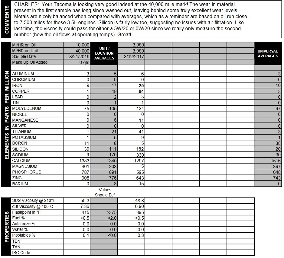

    To give a quick summary here :
    This thread was about INITIAL OIL CHANGE. As per the very post.
    These are the findings compared to THE SAME engines with 7200 miles on average on SUBSEQUENT NOT INITIAL OIL changes.
    My oil with slightly less than 3000 miles
    5X the amount of alumnium
    2X the amount of iron
    20x the amount of copper
    20x the amount of silicone etc
    Make your own decision based on facts. Facts are that the metal levels are severely elevated at 3000, 4000 and 7000 due to engine break in during the first oil change interval.
    Different trucks with different owners, in different states. However all show the same exact pattern. Want to keep in longer? Sure. But if you were wondering what's floating there from the factory during break in... this is your best bet to find out.
    Lab Report #1
    Lab report #2 with 4000 miles also showing
    3x the iron at least
    30x the copper
    Oil Report #3
    Also showing
    3x Iron
    20x the Copper
    10x+ silicone

    You still don't get it.

    You probably did more harm than good on that INITIAL oil change. All those little particles your talking about fill in the groves and help everything to seat properly. There's you real science for you.
