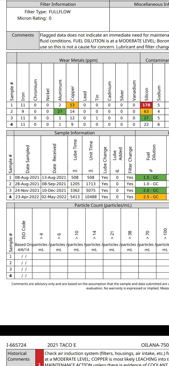

    This may have been mentioned already but I honestly didn't feel like sorting through 28 pages to see....
    I do mine every 5k.
    My concern is always the fuel dilution.
    It's that high at less than 10k. I can't imagine what it would be at 10.
    i asked about this scenario in the past but got no feedback, presumably because i didnt include a photo of a pop tent with a pro grill on it.
    anyone see high fuel dilution?

    This thread was mainly about the first oil change not subsequent. 2.5% fuel sucks.

    My 1st was at 450
    My 2nd was 1250
    My third was just under 5k
    I agree with your ideology

    Looks like it’s in the MODERATE range…..

    Interesting that copper is so damn high in both of our cases … wonder why. Silicone makes
    Sense based on sealants etc
