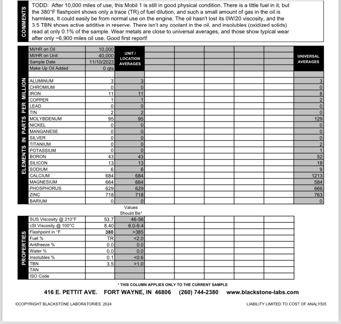

    Did my 1st change at 500 miles and then went to 10k changes, all Mobil1.
    Here’s the 40k analysis from Blackstone.

    Do you have the 500 mile one? The 40k one is not what is being discussed in this thread.

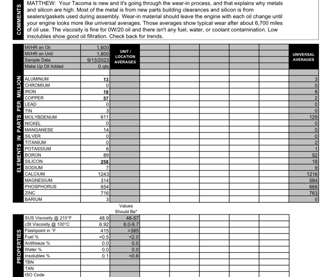

    I’ll add another point of comparison. Here’s my change from the factory fill at 1600 miles.

    Yeah so that is correct there are metals and things still in the factory fill that the filters don't fully collect. Only changing the oil will flush it out in time. I'm not sure how bad it is for the engine to go 10,000 on the first fill of engine oil but glad I changed it when I did. mine has been changed by the dealer at 10,000 then by me at 15,000 the dealer again at 20,000. changed by me again at 25,000 where I forgot to sample again and I'm about to 30,000 now and as soon as I get a good saturday to work outside I'm changing the oil and will collect and send in a sample. Then I can see if all the metals have dropped as they should.
