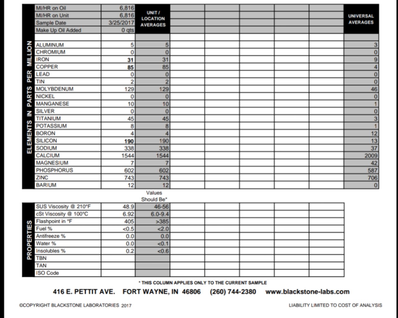

    My numbers after 6800 miles. I go 10-12k between changes now days.

    Those ppm add up fast!
