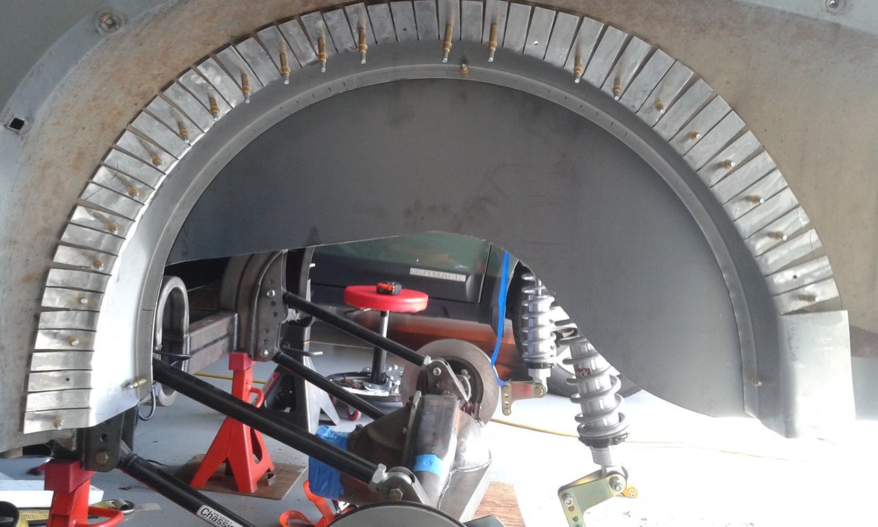

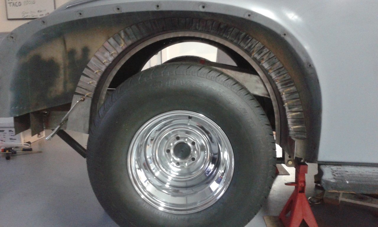

    Driver side is fully cut and held in with cleco pins. Passenger side need 2 more tabs cut. Ran out of cutting blades for the grinder and local shops are 5 times per disc more than HF for discs that dont last half as long. Tomorrow, I have to go get a sheet of 16ga anyways so I'll stop by HF to get more discs.
    This gives me 1/2" of clearance on the top of the tire at full tuck. But since I dont want my 4 link smacking the frame rails, I am going to put in 2" bump stops which will give me 2 1/2" at full tuck.

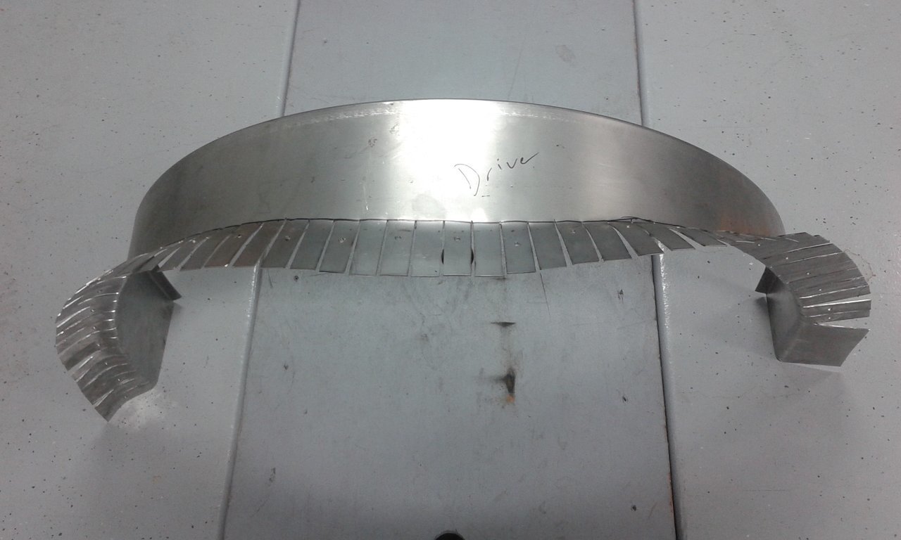

    Tomorrow, I will make the inner skins from 16ga. Then I will clean the paint off the OE inner fender and start the long process of welding everything together.
    This is the contour it needed.

    One side trimmed out. Other side is almost done, just need to trim the top edge a little bit.

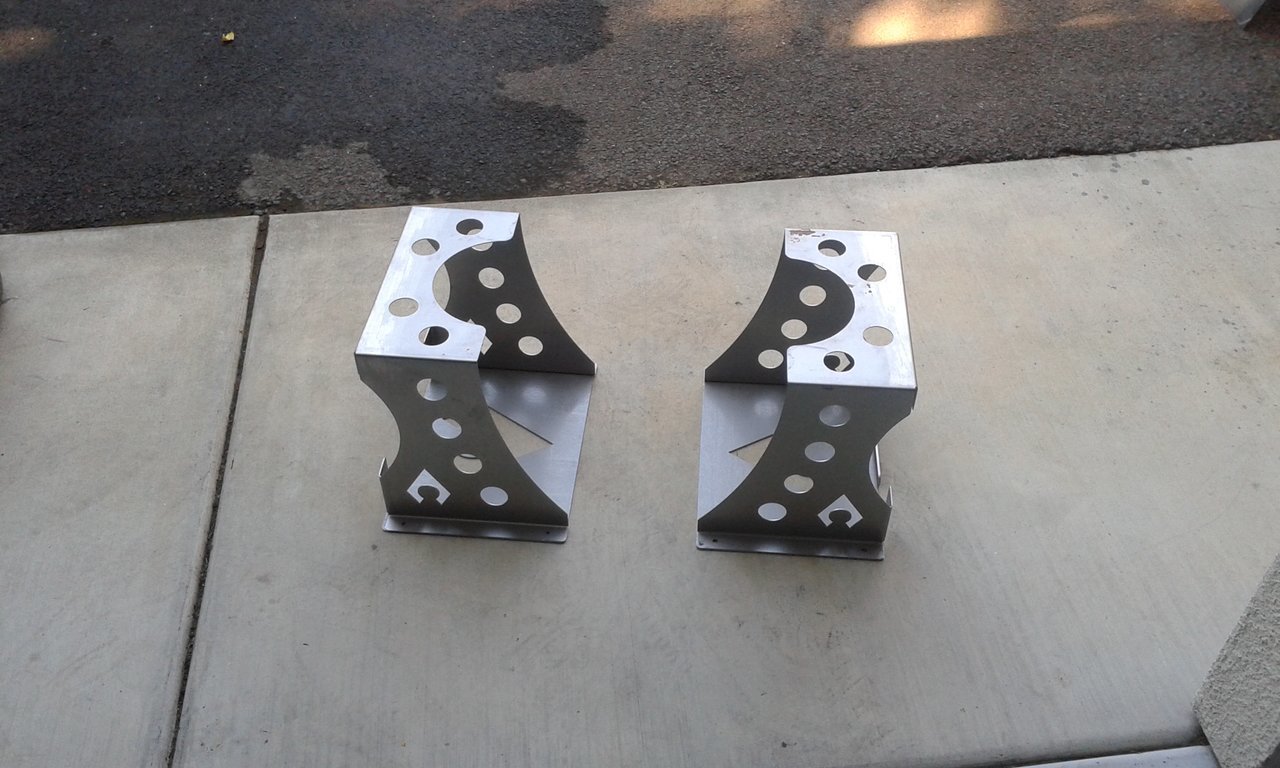

    Fuel cell mount came in. Just waiting on the cell itself.

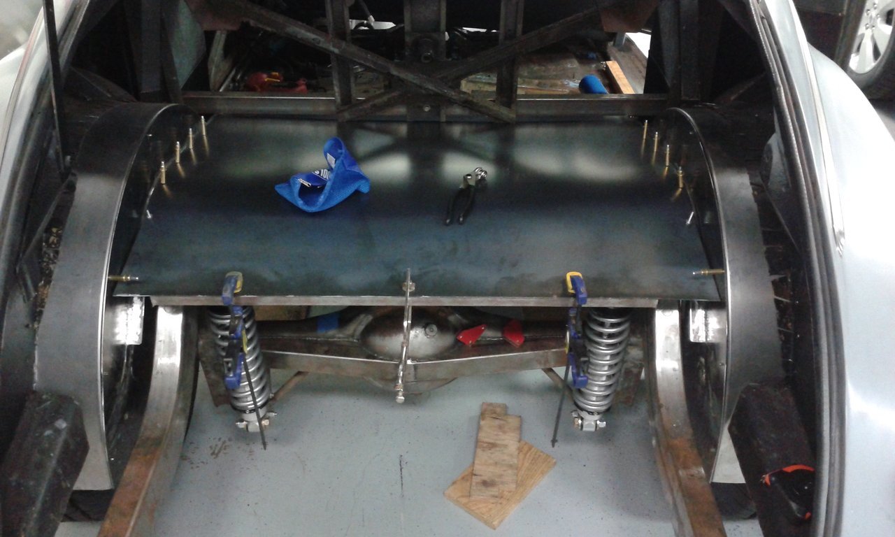

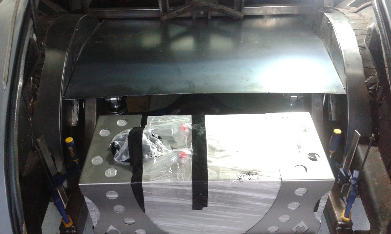

    A little bit done today. I welded a couple pieces of 1x1x1/8 angle to the tub after shaping them to the same curvature of the frame rail with 1" spacing. They act ad a ledge to mount the trunk floor pan which I am making out of 16ga sheet. I plan to mount the fuel cell then box the floor over it so that it gets airflow. Im basically going to make a toolbox without a floor that will be part of the trunk pan and also be a shield for the fuel cell. It will have a lid that opens to access the cell for maintenance and adding fuel. The cell will sit on eight 1/2" rubber dampers on frame mounted crossmembers. That way, it is separated from the body.
