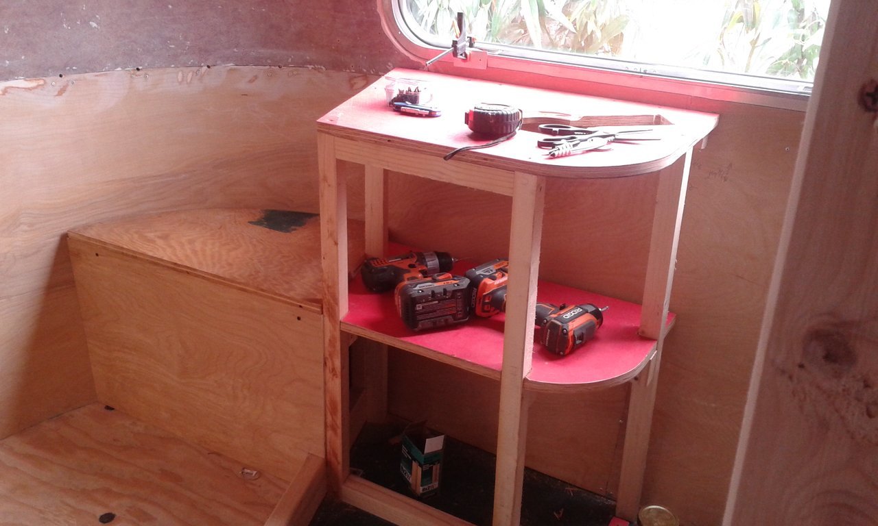

    Wood matched to the fiberglass cap. This will make it so there is a smooth transition when we fiberglass the entire bathroom.

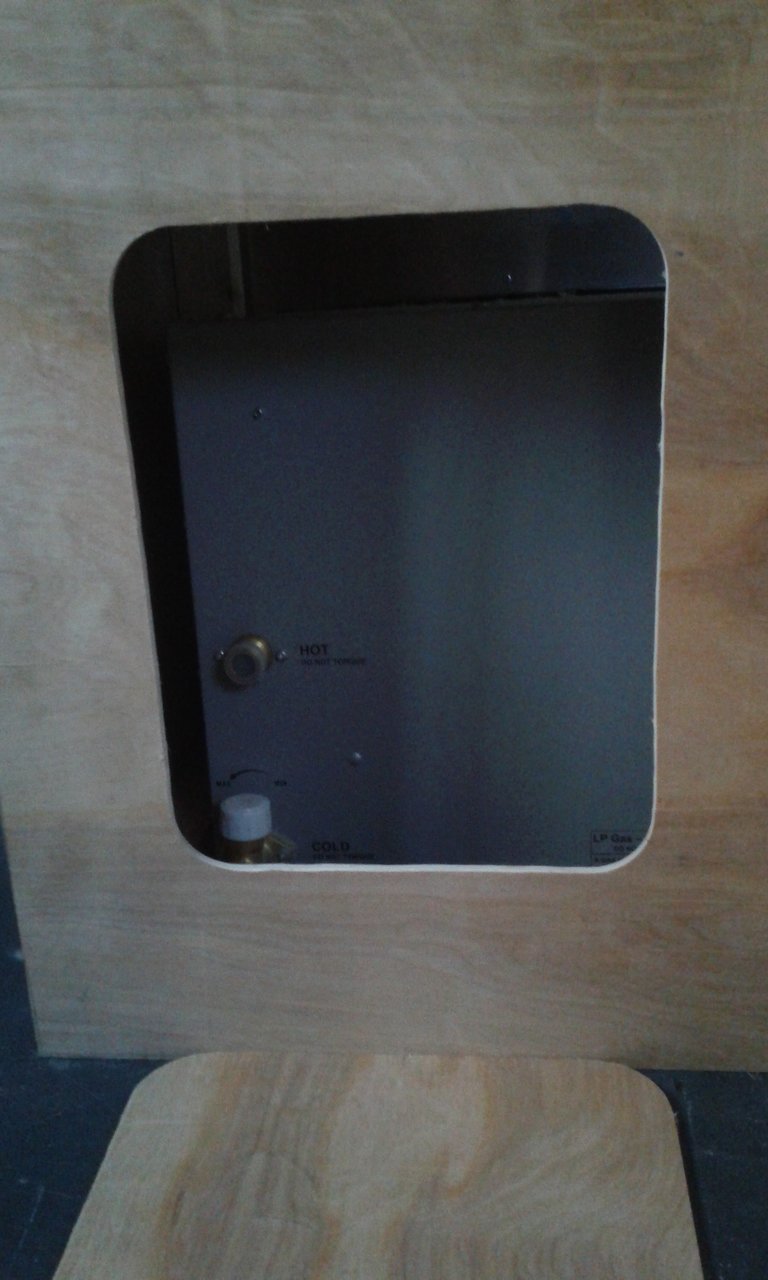

    Made an access panel for the water heater.

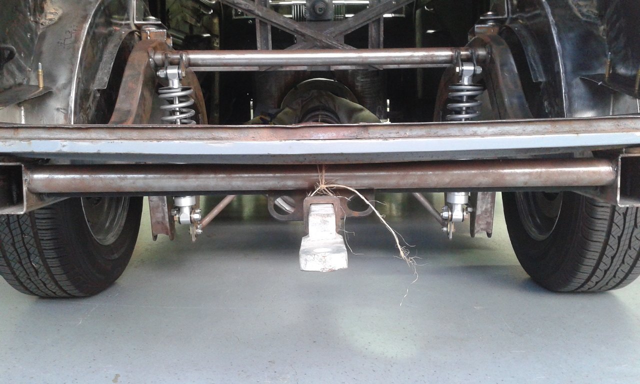

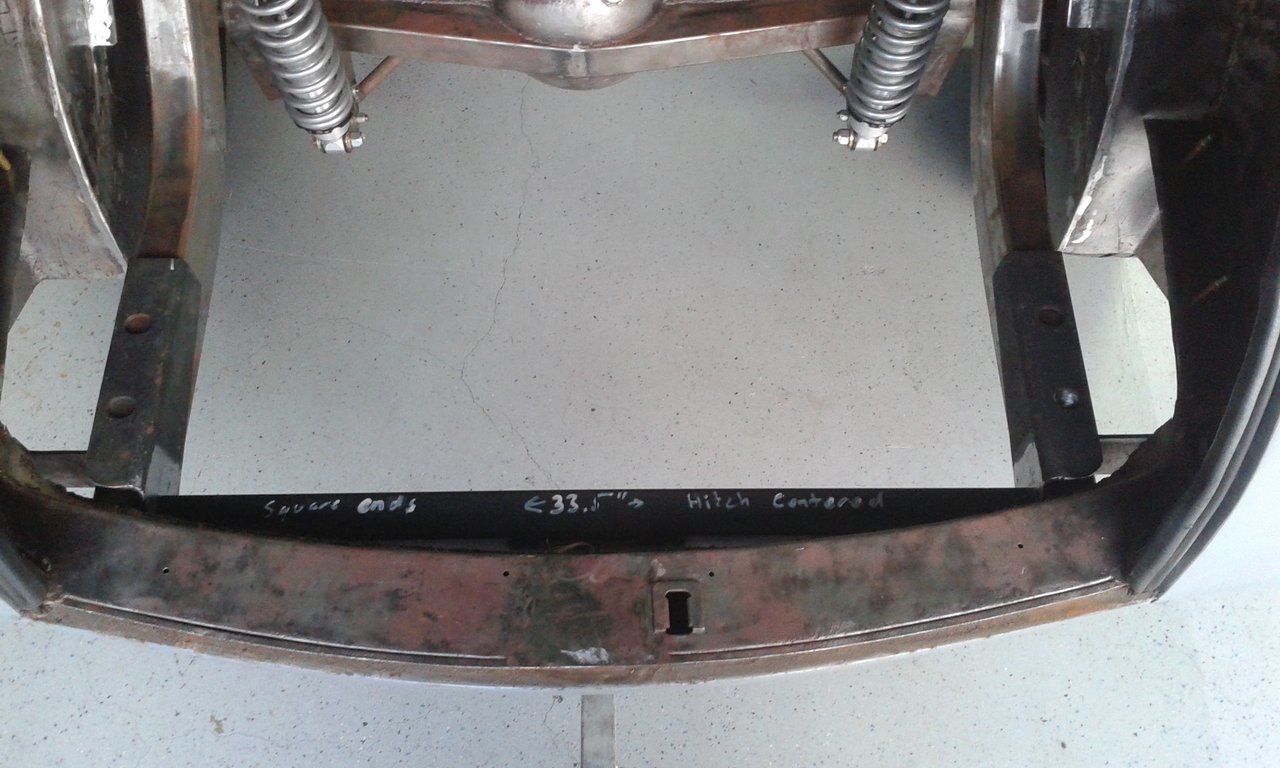

    Back to the car a bit. Modified the hitch to fit. Will get welded together after I get the car back to ride height so I can level the hitch.

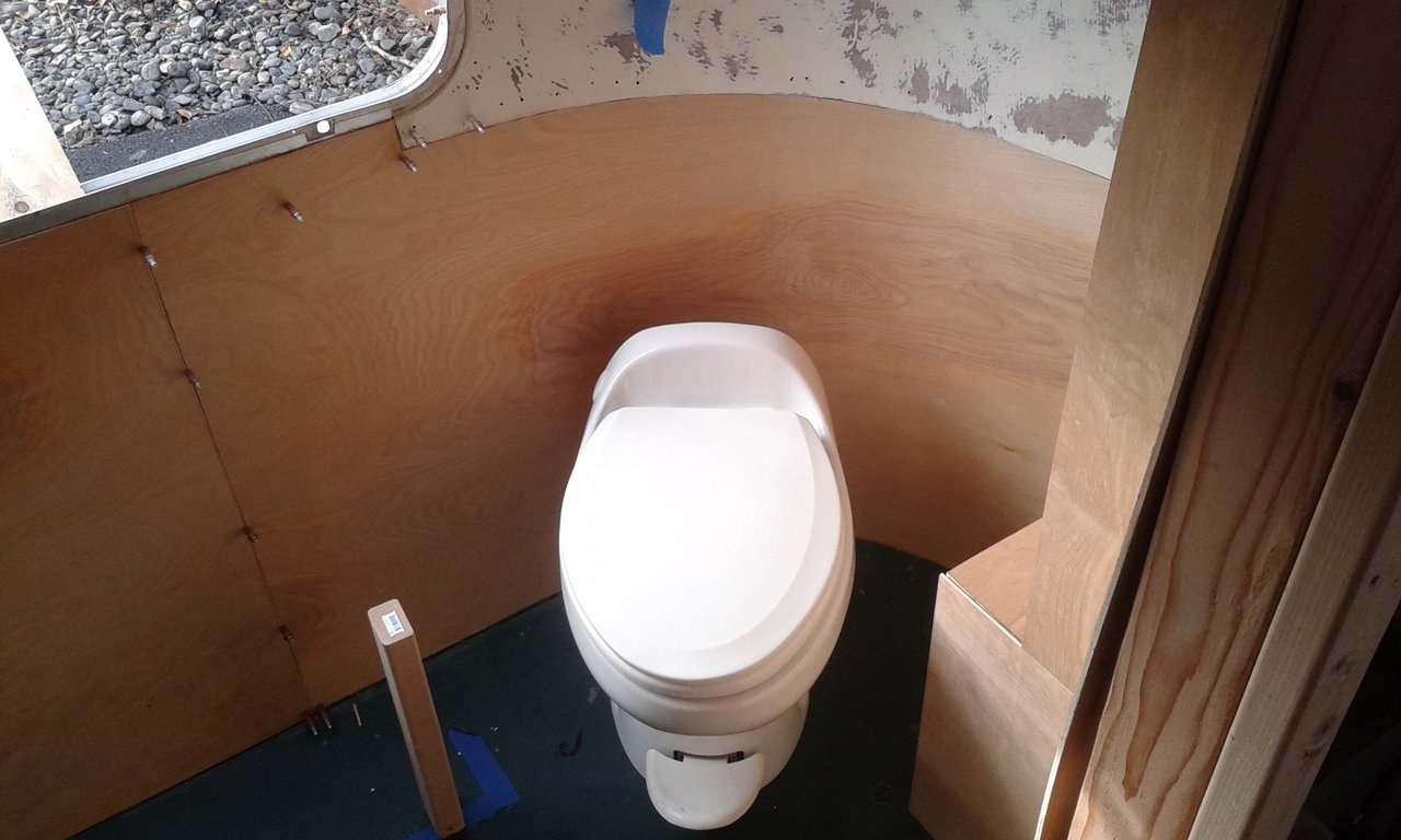

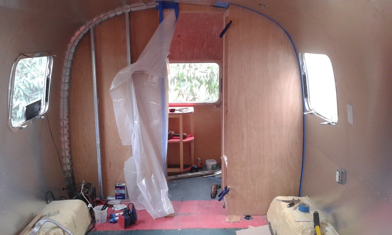

    Worked on the bathroom a bit.

    Yeah. Once its all together, itll come apart and then start getting fiberglassed. I wish I had access to a shredder sprayer. It would make it much easier and make the fiberglass much cleaner.
    Once the bathroom is done, work will begin on the kitchen.

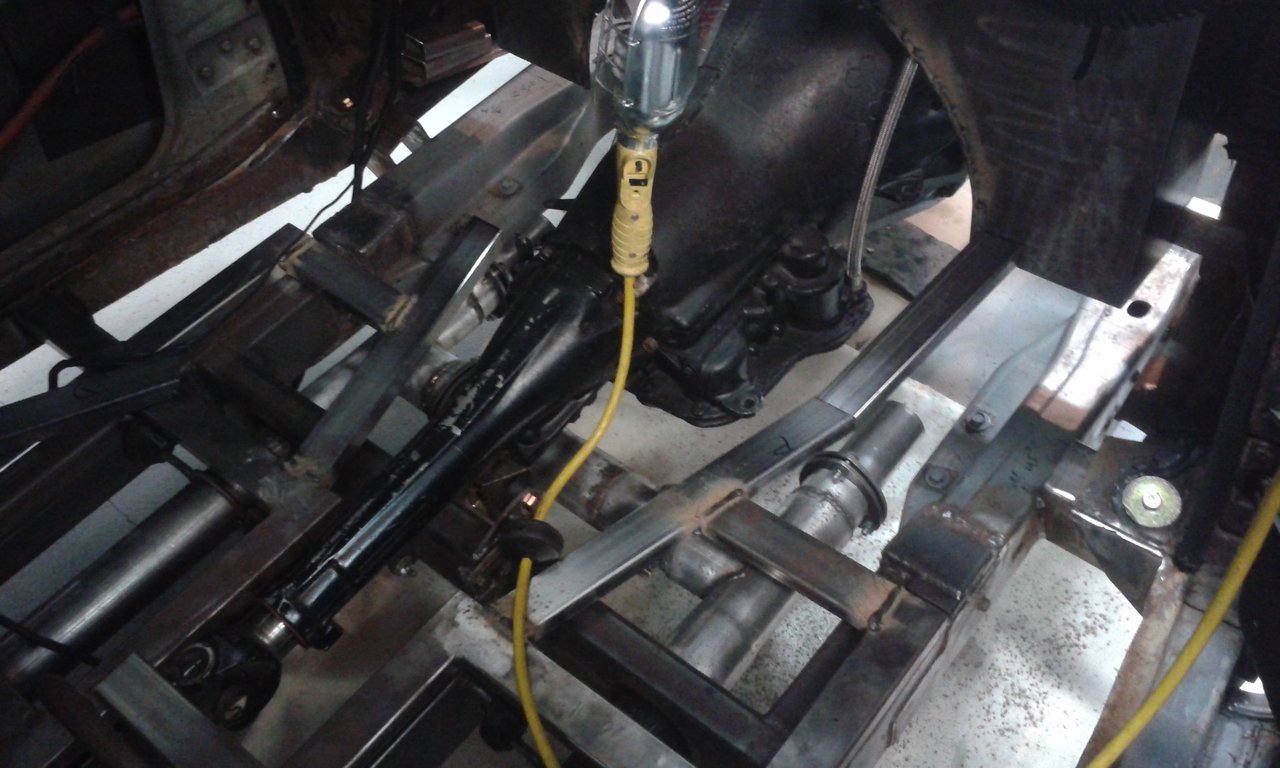

    Havent gotten much done. Worked on the toe boards a bit. Got the angles figured out and the tranny tunnel floor braces cut out.

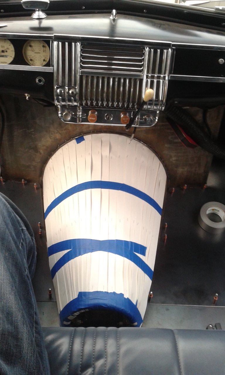

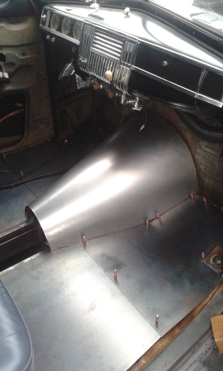

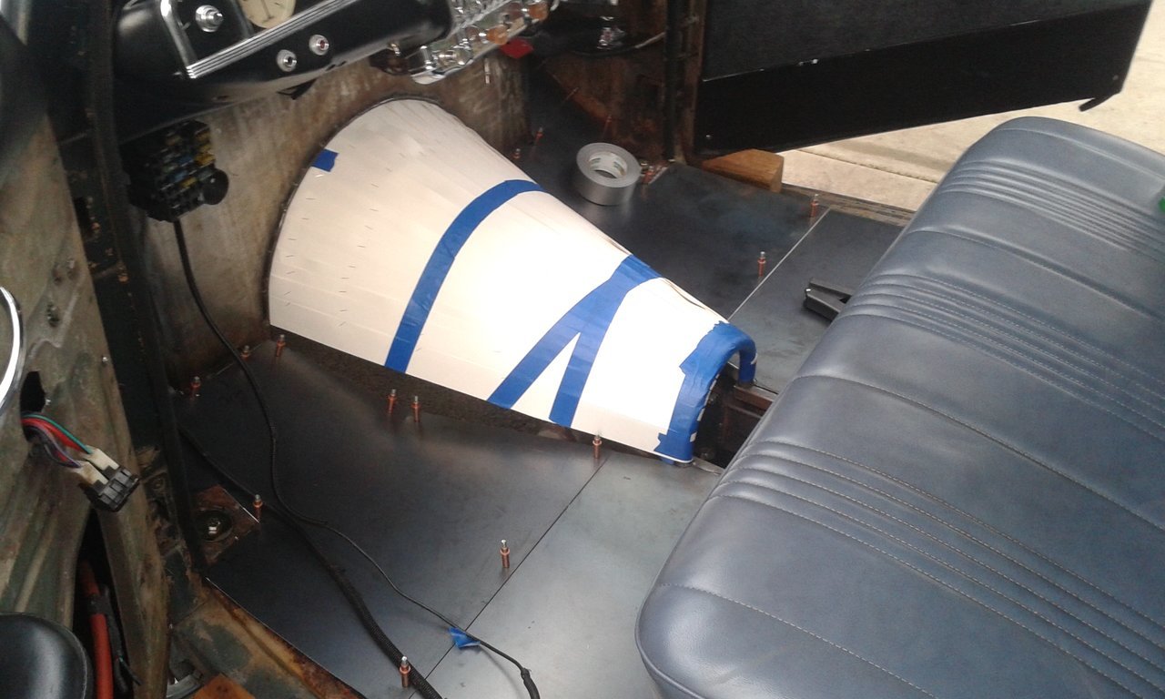

    Making a tranny tunnel template.

    Transferred the first template to heavier material and finalized the shape.
    Ill go pick up a sheet of 20ga steel on tuesday.

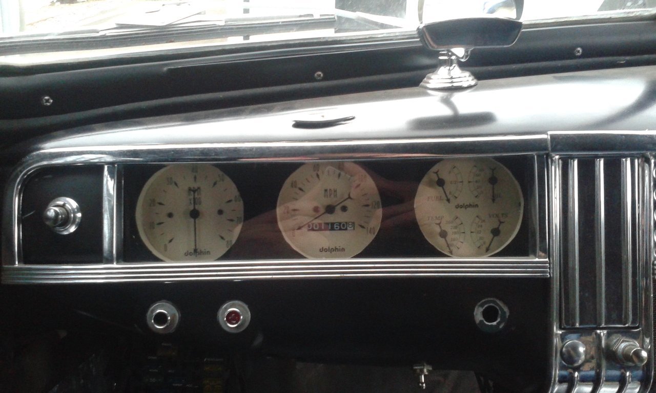

    Looking good :thumbsup:
    Can you get a better picture of the gauges? those look awesome

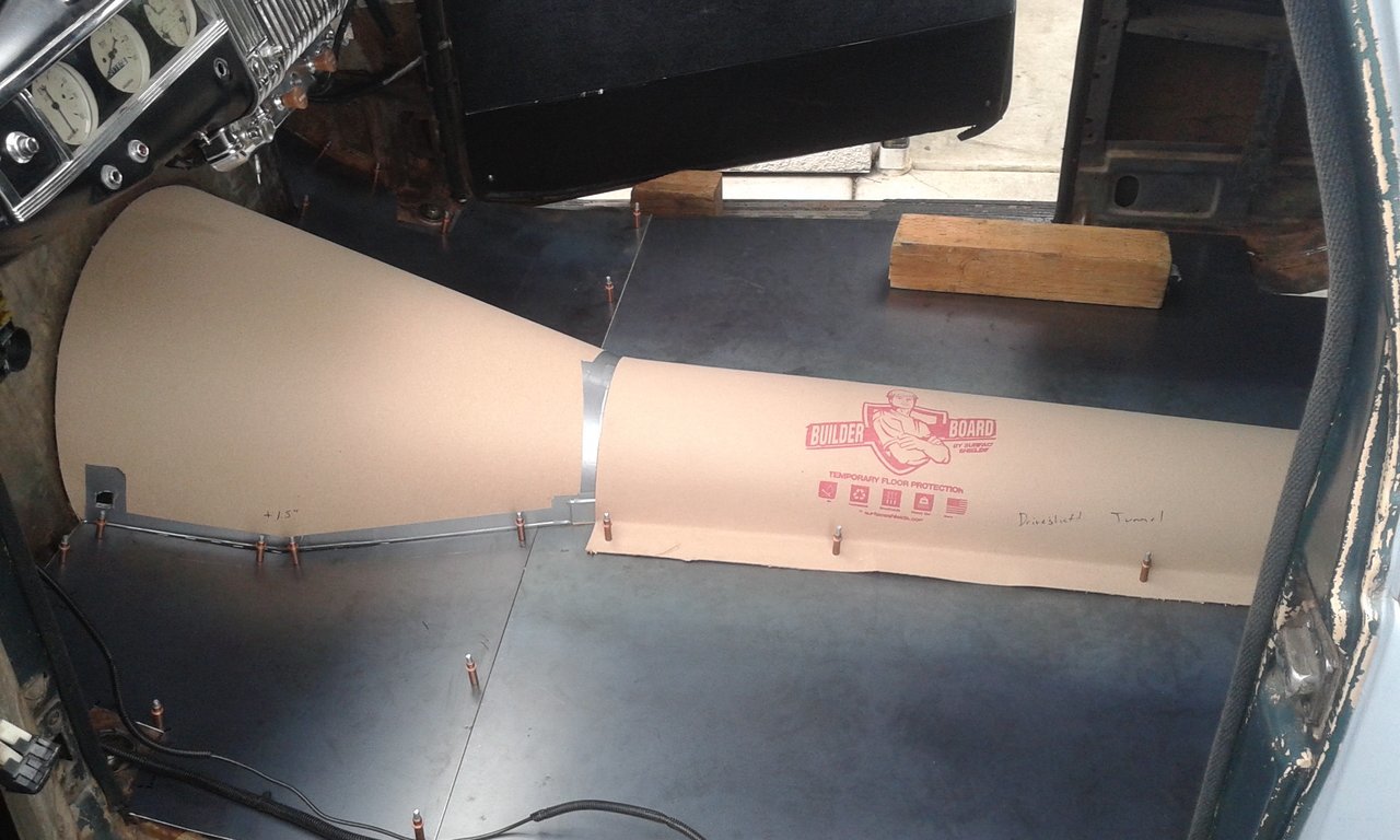

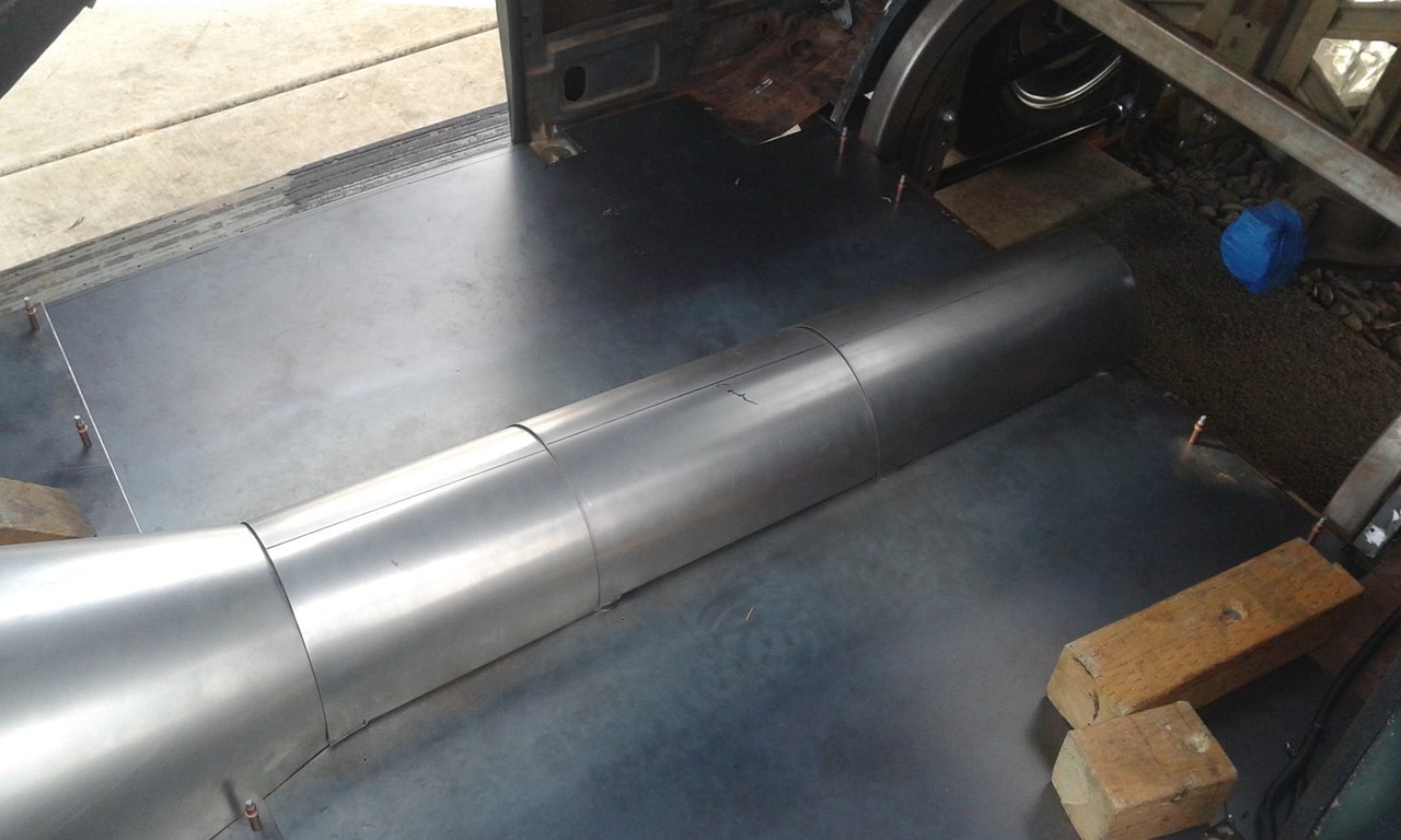

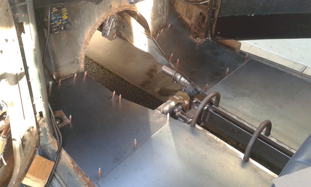

    Trans template transferred to 20ga.
    Gauges are by dolphin. I took a piece of plexi and mounted it to the original surround. Then figured out where I wanted them and taped the circles then painted it on the back side. Then I cut the faces off the gauges and epoxied them to the plexi. I tried to find someone that would mill out a new bezel in aluminum with a face and mounts that would get rid of the plexi, but the only place that was willing to do it wanted $5k+ for one piece.

    Driveshaft tunnel transferred to steel. Had to make it in 3 sections to be able to bend it. The bottom edge is bent inwards then down the inside of the rails to lock them in place. Itll eventually get welded on, but for now the spring force is holding it well.

    69,788
    What are you using to shape the tunnel and shaft pieces? Looks great.
