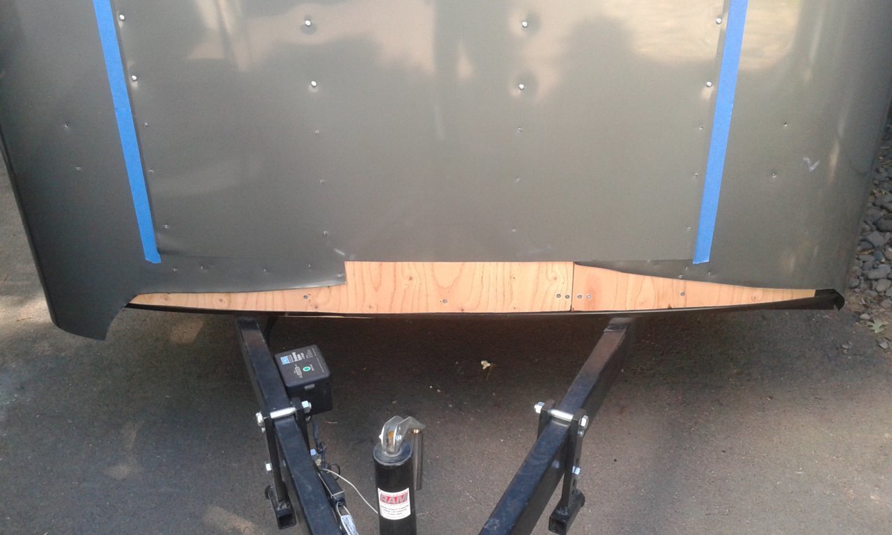

    Panels pulled off the curb side wall. Sealed it with ProFlex RV sealant and put the panels back on. I will pull the screws out 1 stud at a time and put some 1x1 wood studs inside the steel studs to give the screws something to bite into since half of them are stripped out. Most of them are 1/4" long self tappers, so I will be replacing the screws also.
    I cut the stud out for where the window will go.

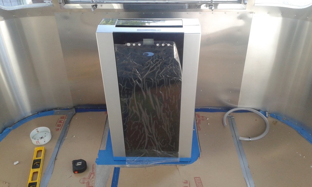

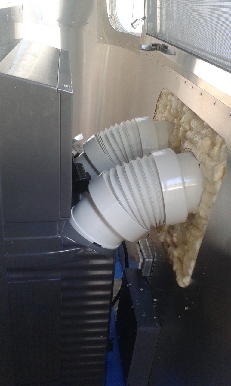

    Installing the AC in the Airstream.

    Intake and exhaust.

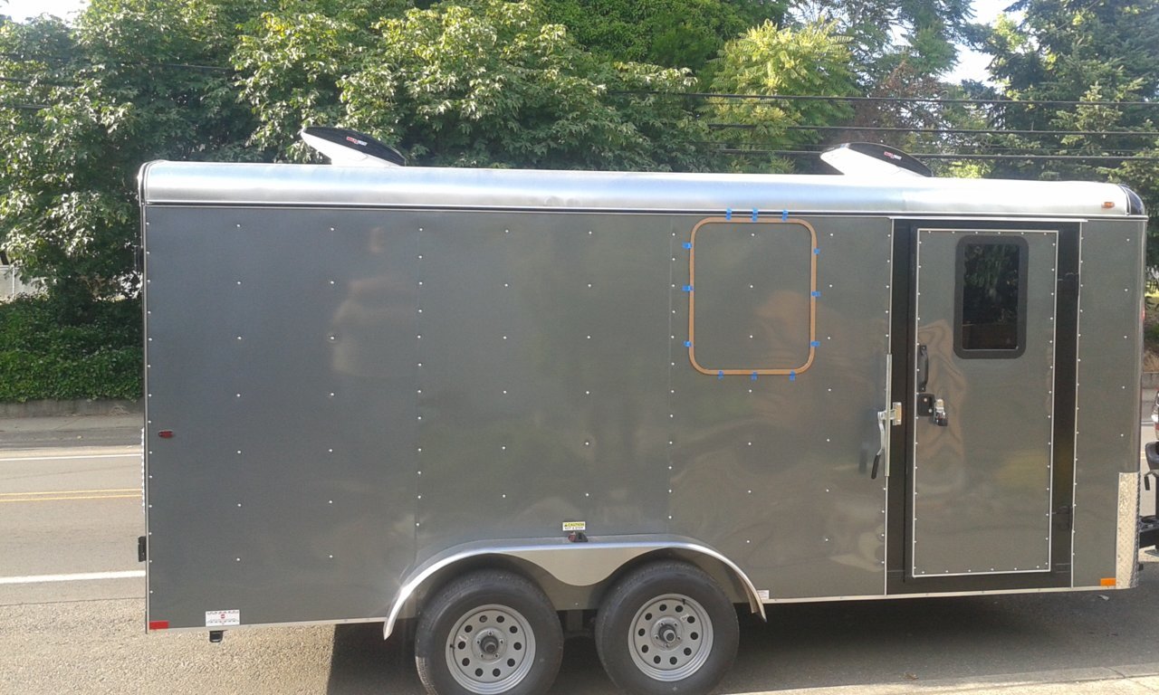

    Adding a side window. Will be taking the panels off the other side to seal them after I get the window in.

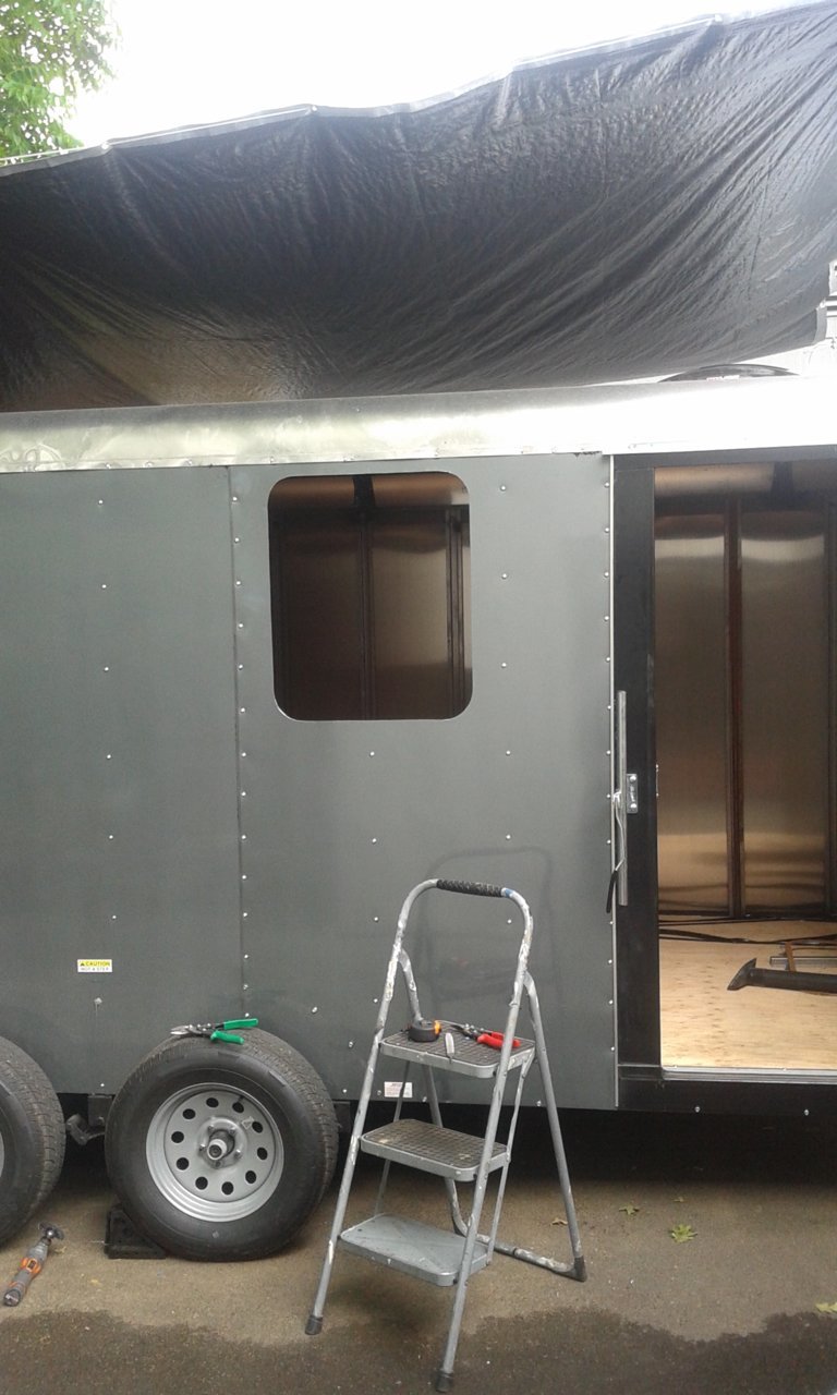

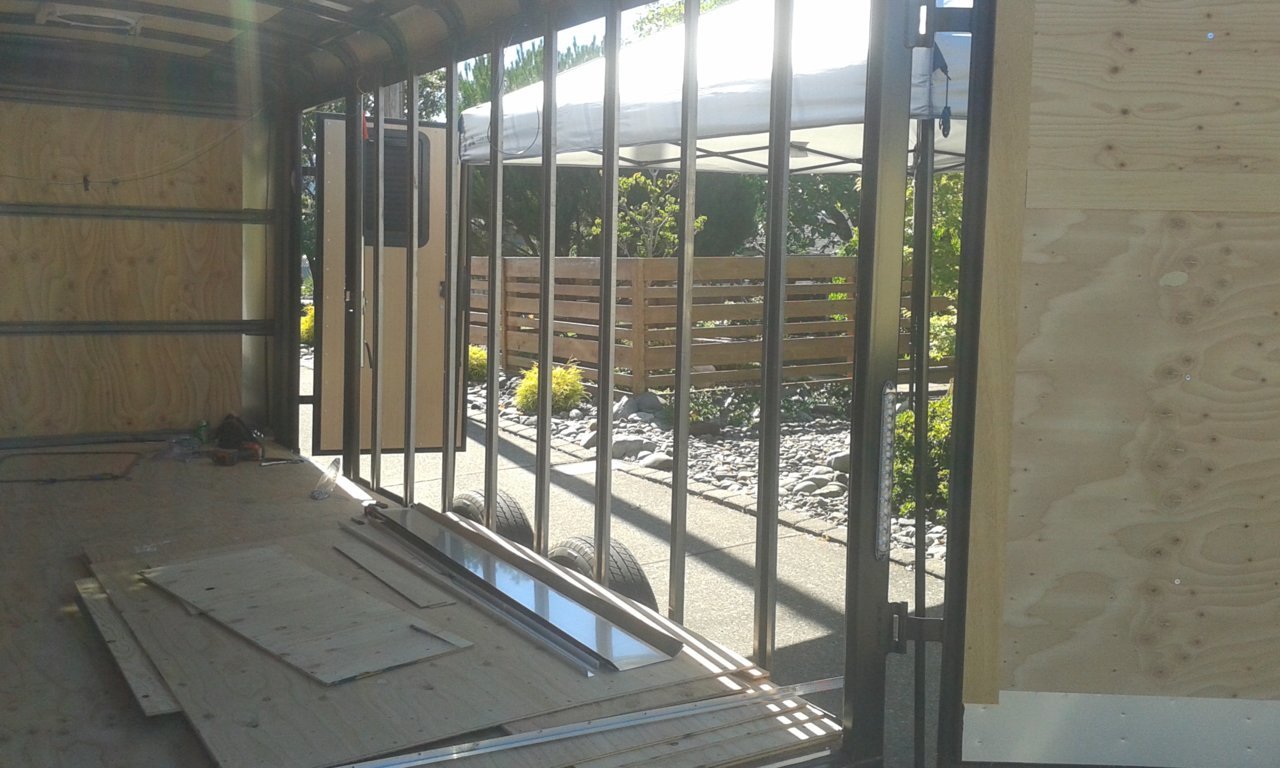

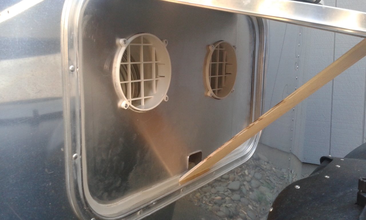

    Well, kitchen window is in. I used 3/8 plywood to make a trim panel for the mounting ring to press against until I build new walls.
    Tomorrow, I will put the trim back on the roof seam and take the tires off to add a couple screws to the panels below the fender. I am jumping back and forth between working on the trailer and the car. Im just waiting for coil spring insulators to get here and then the suspension will go back on. Im sandblasting all the nuts and bolts then painting everything black.

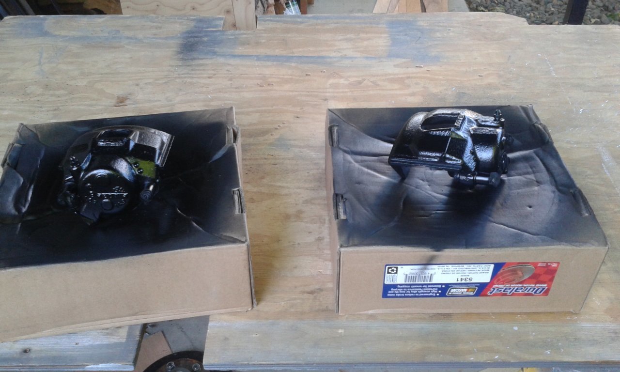

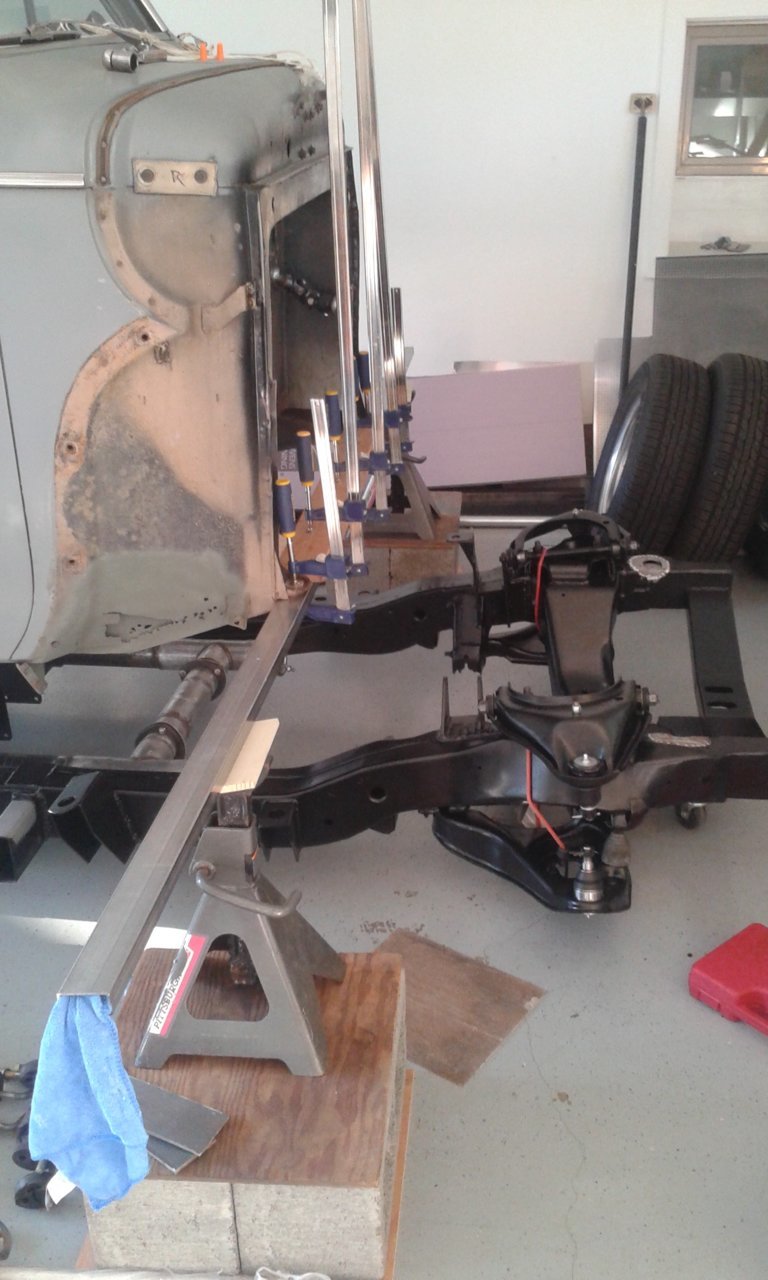

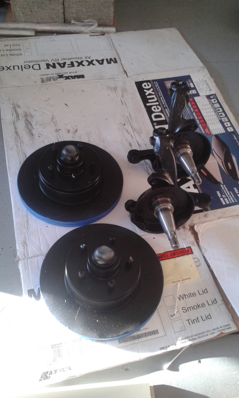

    Its annoying waiting on parts. Waiting for the coil spring insulators, so Im doing what I can. Parts are painted and mostly assembled. Keeping the tape on the rotors until they are installed to keep the braking surface nice and clean.
    It was too windy today to pull the side panels off the trailer, hopefully tomorrow is better. I am also going to throw away the self tapping screws for the fenders and install backing plates along with rivnuts and bolts.

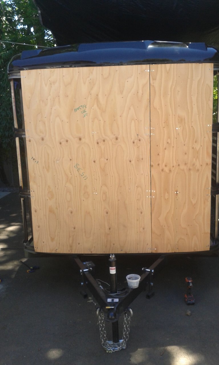

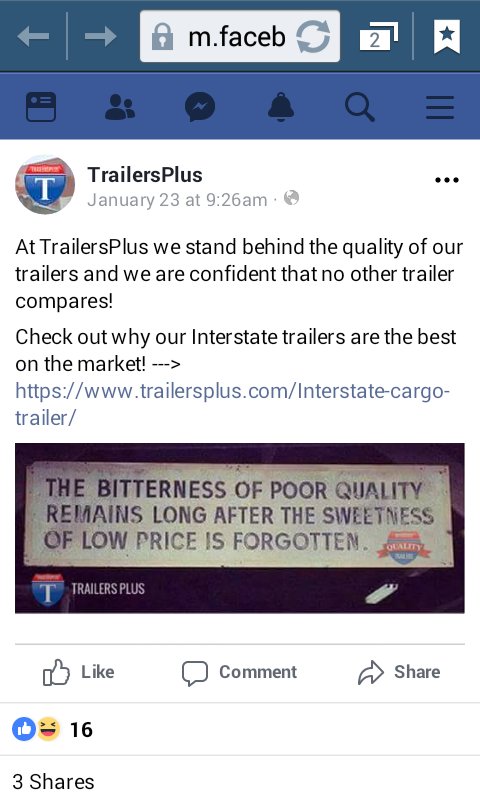

    Update from Trailers Plus. They appear to have removed my comments and photos. They have also blocked me from being able to comment on their page.

    Sad. Truth can hurt.

    Yep. Oh well. It will be a better trailer when Im done.

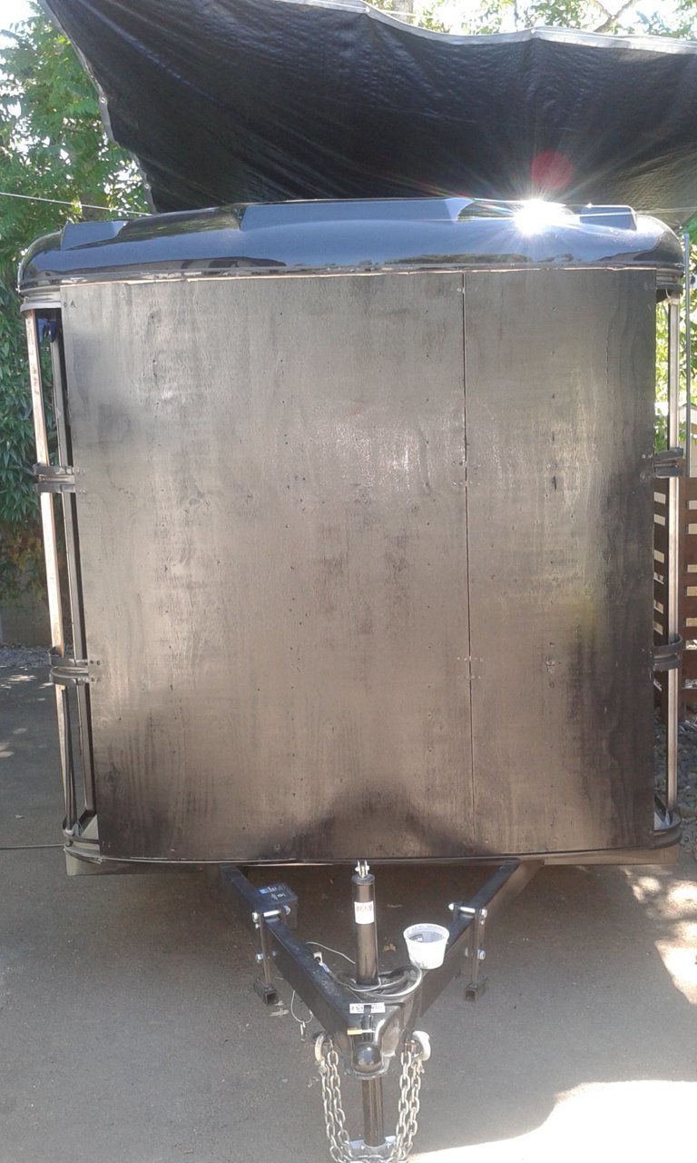

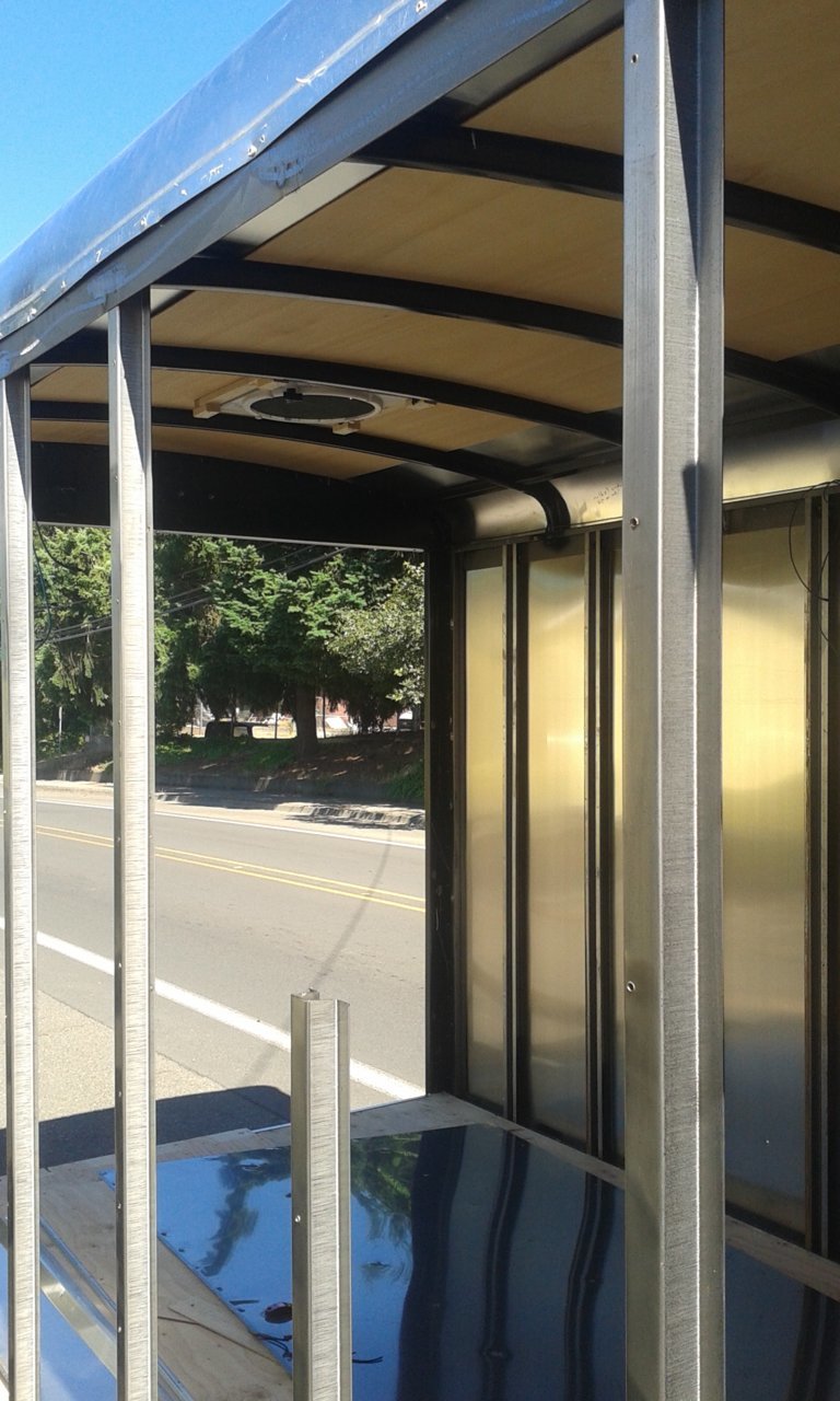

    Front panels removed. Their undercoating was missing, so I did it myself.

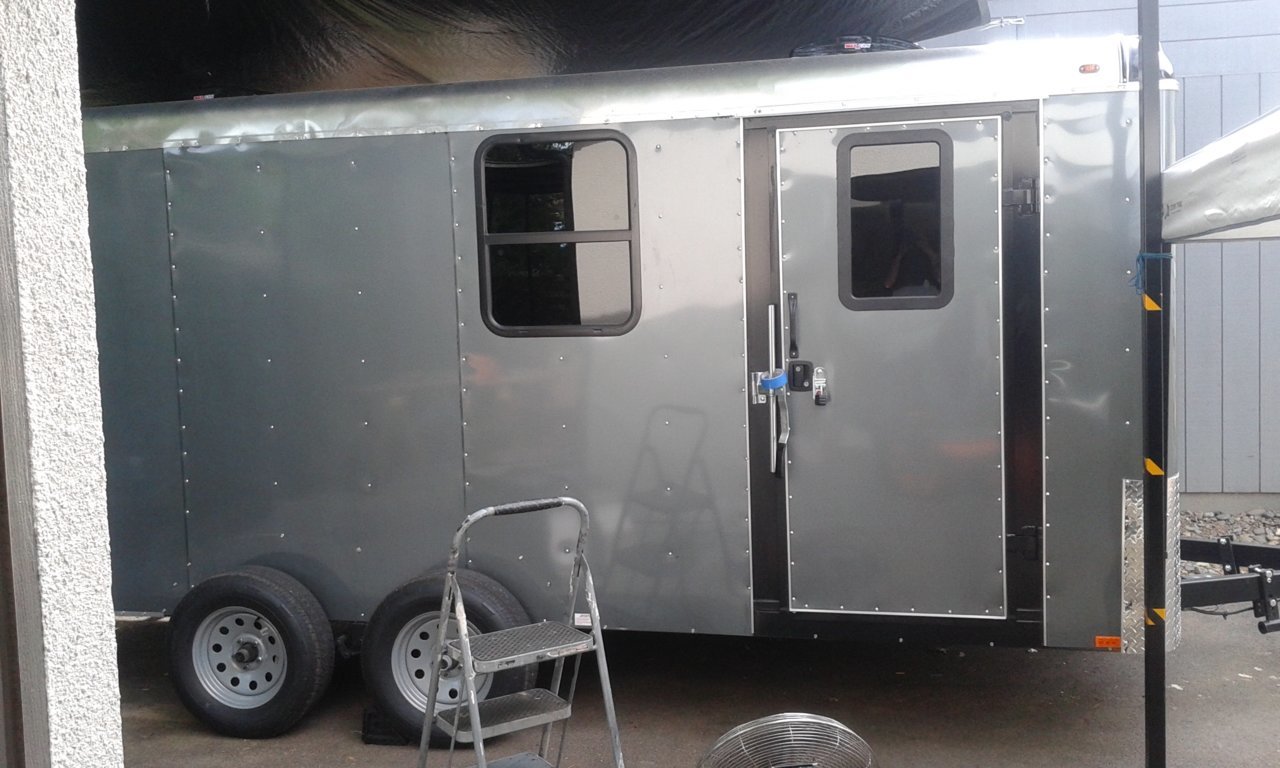

    Got the side panels removed, cleaned up, sealed, and re-installed. Ran out of sealant, so front panels will have to wait til monday to go back on.
    I had to hit a couple of the studs with a wire wheel to get lots of rust off. I painted the rusty ones with rust sealer.
    I am going to replace the 1" aluminum angle trim along the bottom with 2" aluminum angle. The 1" doesnt give enough coverage on the panels and th screw holes are crooked and right on the radius of the frame rails. They also do not extend into the wheel wells, so I will modify the new trim to fit there also.

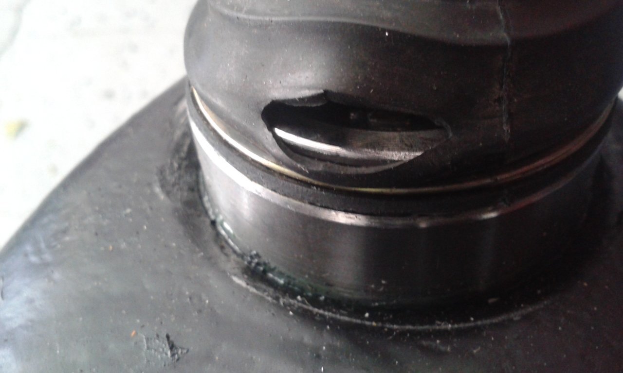

    Well son of a :#/&$. Got the driver side suspension all bolted up and as soon as I tightened the LBJ, the damn boot split.20180627_152009.jpg
