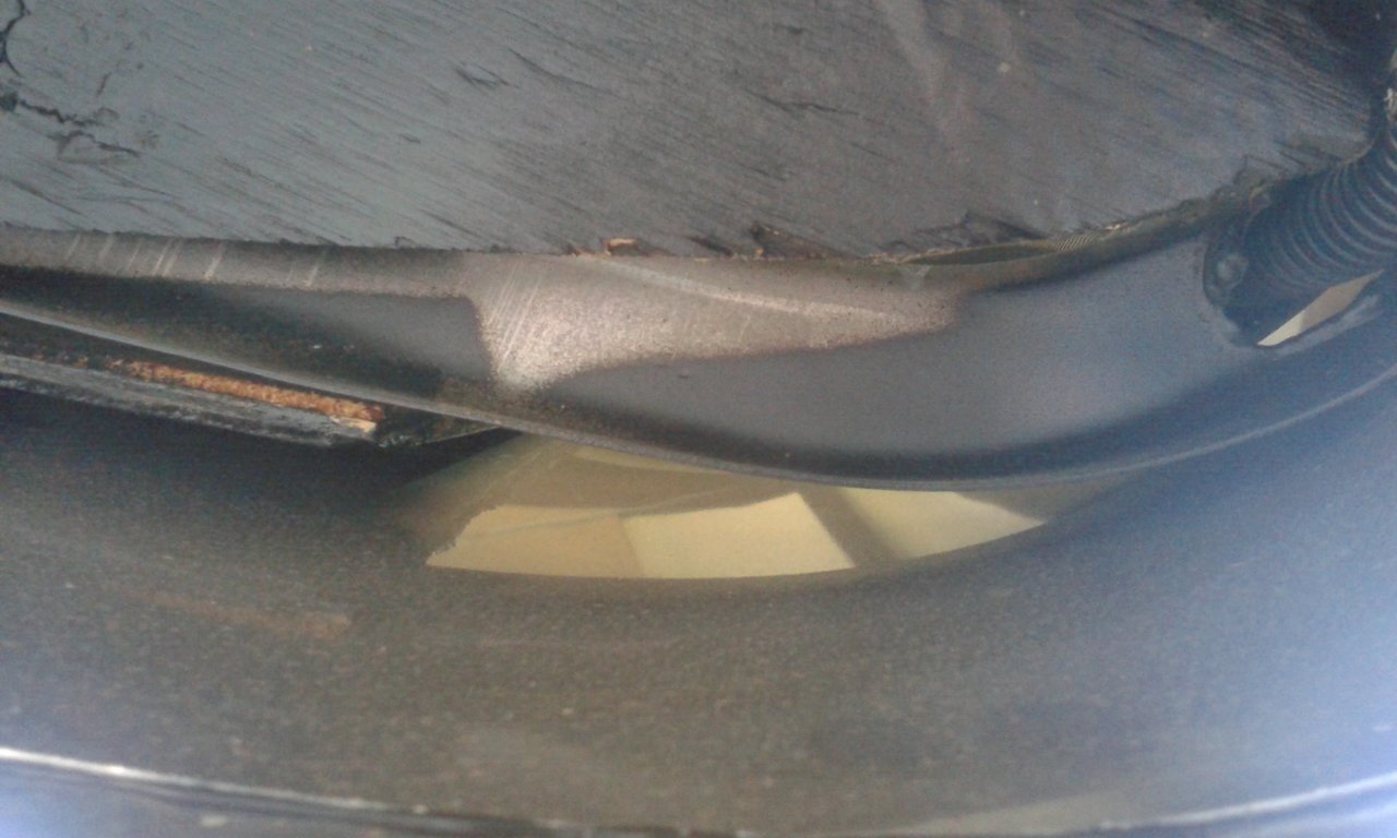

    Still waiting for the second coil spring insulator. Filing a complaint if it isnt here tomorrow. Already a week past the expected delivery date without any reply from seller.
    Got Energy Suspension dust boots installed and driver side back together. Boot didnt split this time.

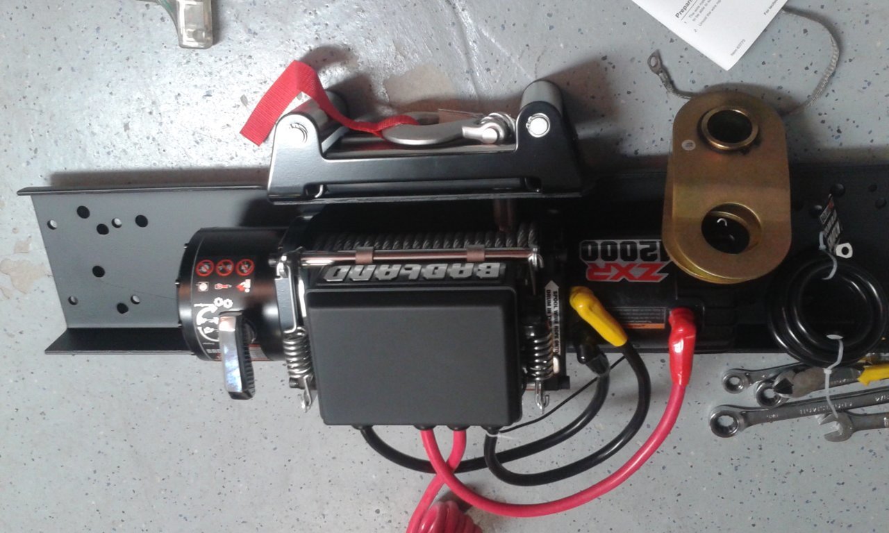

    So, when I loaded the rolling frame on my trailer last time, it took me over an hour with my lil portable winch. It really didnt like doing it. I decided that I needed to go a lil bit bigger.

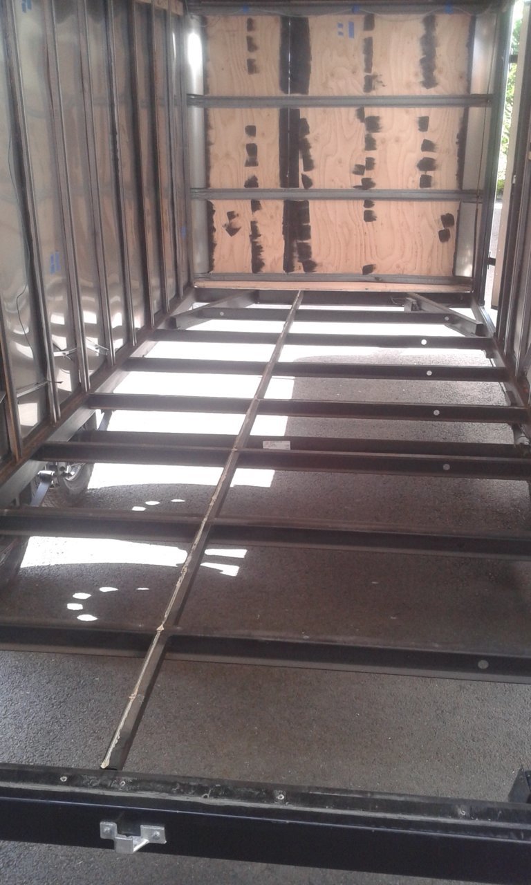

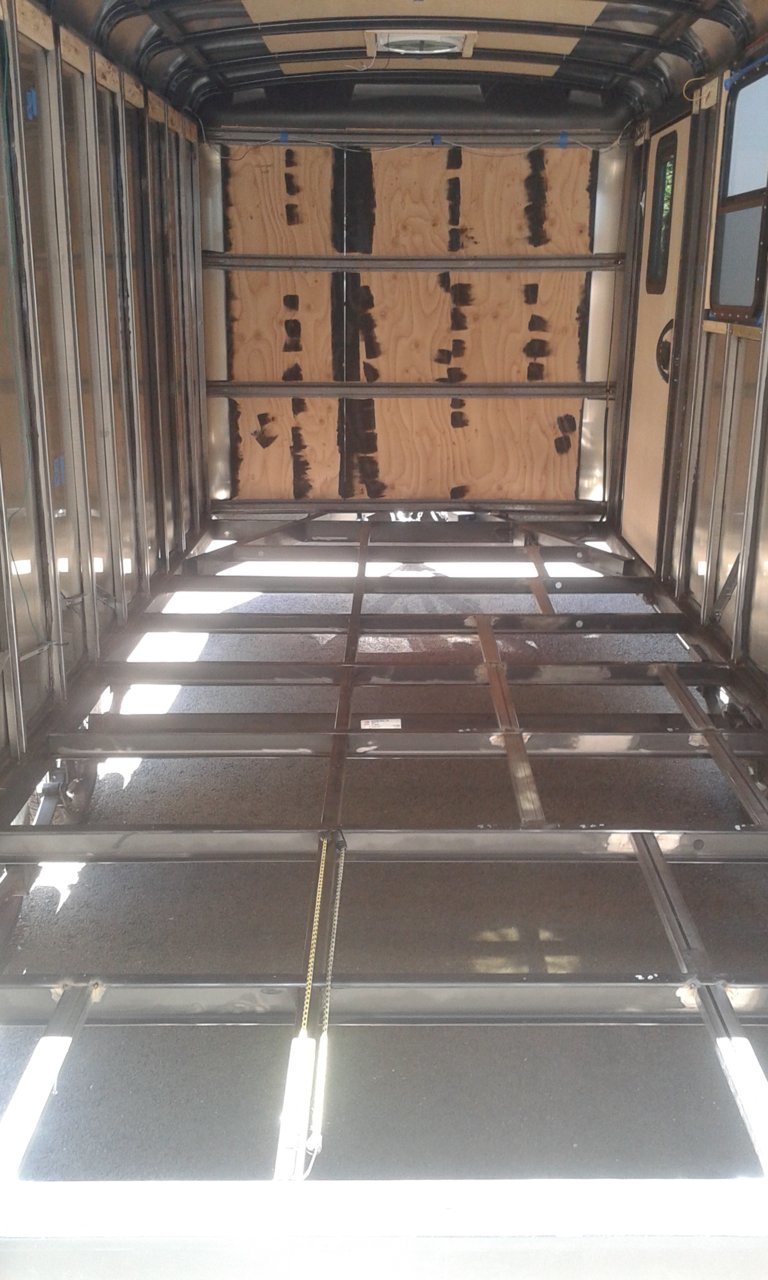

    Pulled the floor up. Will be cleaning, adding braces, painting it. LOTS of uncoated metal that will be cleaned and coated in bedliner. I also dont like how they wired it with the big a&& junction box, so I will rewire it also.

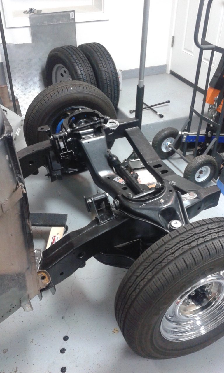

    YAY! Shes back on her tires.

    Bracing tacked in. Ill weld them in and the top joints of the crossmembers (manuf. Only put 1/2-3/4" welds on the sides of the crossmembers to the frame rails) after dinner. Ill clean and start painting it all tomorrow. Monday, I am picking up some parts. Tuesday, I will start wiring it up.

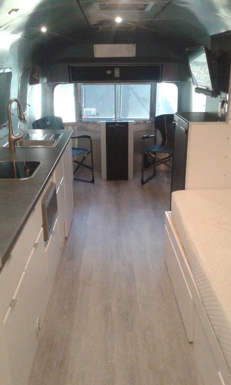

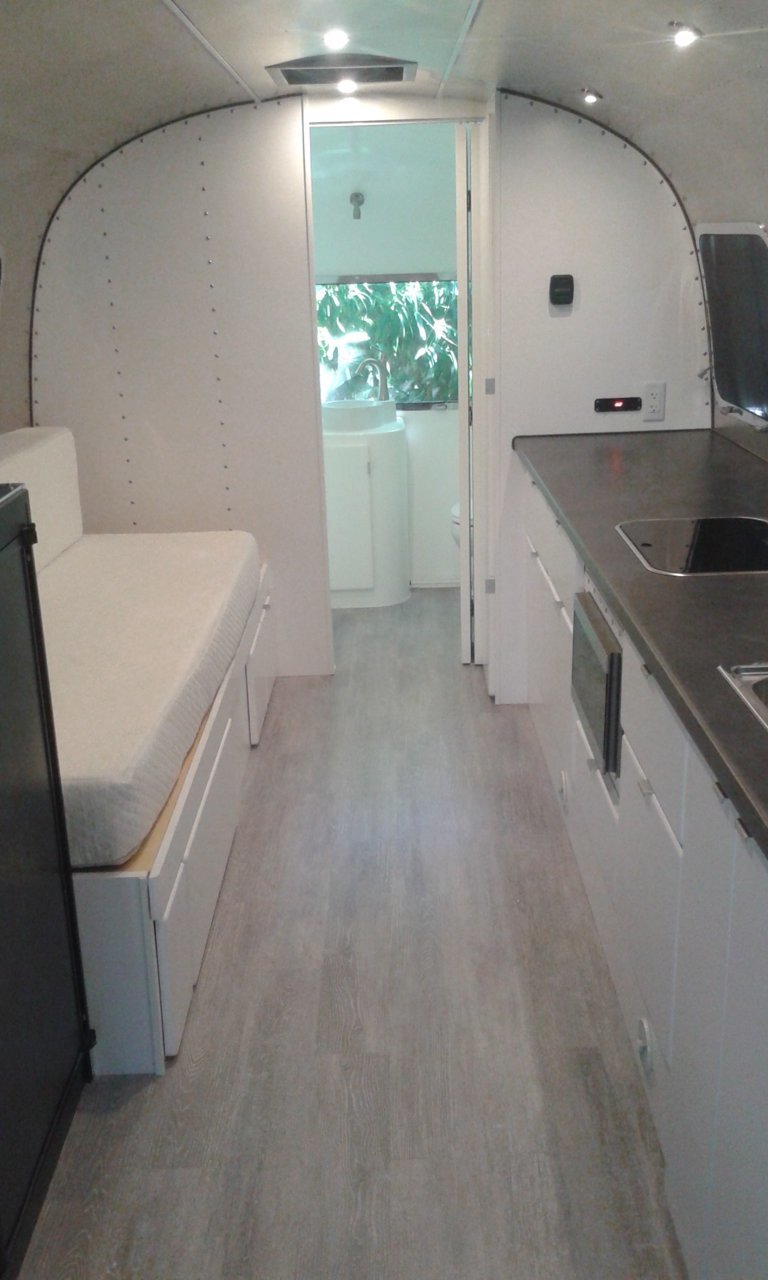

    Update on the Airstream. All major work is complete. It is now completely usable. Need to pick up some door handles and retainers. I am still trying to figure out how I am going to trim the front windows.

    How good of a job does that A/C do?
    I had one a few years ago and I thought it was garbage. I hope they have improved.
  9. Jul 7, 2018 at 4:54 PM
    #389
    windsor
    windsor [OP] Just a guy
    Dec 31, 2014
    #145322
    7,675
    Homeless in Oregon
    2008 Tacoma Super Duty aka Tundra
    Canopy, fitted seat covers, OBA with self leveling air bags, 100w solar, dual Rhino Rack Pioneer platforms, side & rear LED work/FU lights, CB, cell booster. 7x16 cargo conversion, 3" lift, 7'x6.5' fold down aluminum rear deck.
    It has trouble cooling down when it is above 80 (takes a long time). However, if it gets turned on when it is below 80 it will easily drop to 68 and maintain it on low. The key is to have a small fan on the back side of the trailer to help circulate air. The heat pump works well.

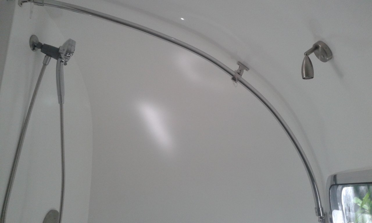

    Is that how you bent it?
  12. Jul 11, 2018 at 4:37 PM
    #392
    windsor
    Dec 31, 2014
    #145322
    7,675
    Homeless in Oregon
    Yeah. It has a couple spots that didnt bend exactly how I wanted ( actually stayed straight). However, it fits well and once the curtain is hanging, it blends it all together and you cant really see that it isnt curved all the way.

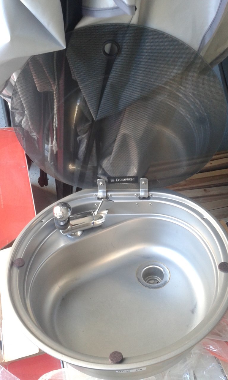

    Picked up a "new" Dometic round sink with folding faucet ($150), and a new LCI 18ft Solera awning tube and fabric ($250) for the new trailer.
    Sink will go in the kitchen. The awning will get cut down to make a patio awning on the curb side of the trailer and a window awning on the street side.

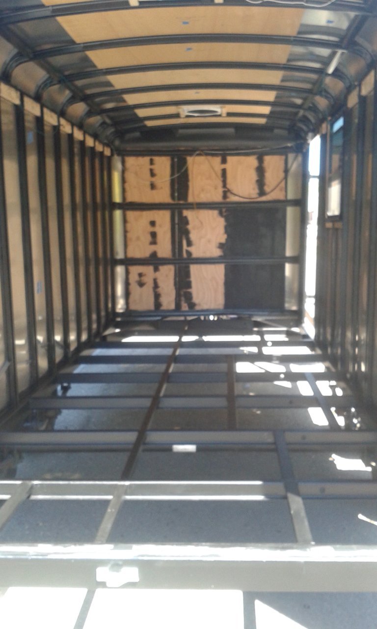

    Alrighty. Finished painting the studs with chassis paint and got the first coat of bedliner painted onto the frame. Tomorrow, I will get a second coat put on. By the time I was done with the first, I ended up having to use my cane to walk. So, tomorrow, I will do the second coat sitting on my creeper.
    After the second coat is on and set (about half an hour), I am going to start putting the wood studs into the channel of the metal studs.
    I decided that I am going to change the side door out for a RV radius corner entry door. That will be next months budget allotment.

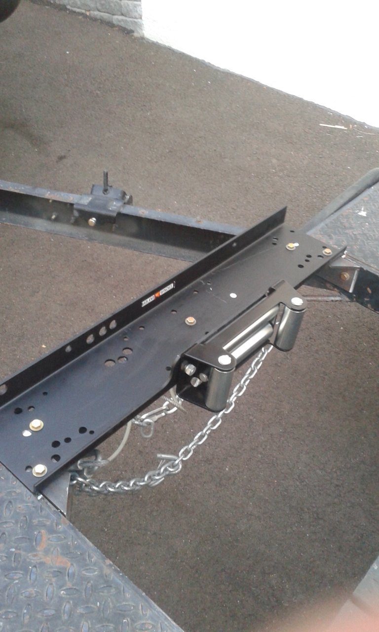

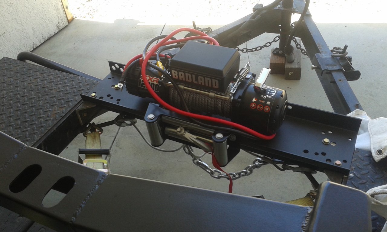

    Working on getting the winch attached to the car trailer. But, going slow as its 100* at the moment and I really dont feel like putting on my welding jacket.

    Its bolted on for now with thread locker. Ill pull it off later to sandblast the brackets. Then I will weld them to the trailer and put a spot weld on each nut/bolt. Ill figure out where I will put the box & battery after I get the location of the car on the trailer set and tie down (tire nets) points welded down.
