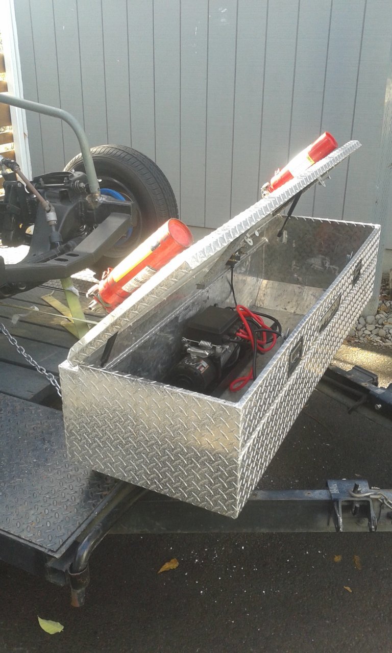

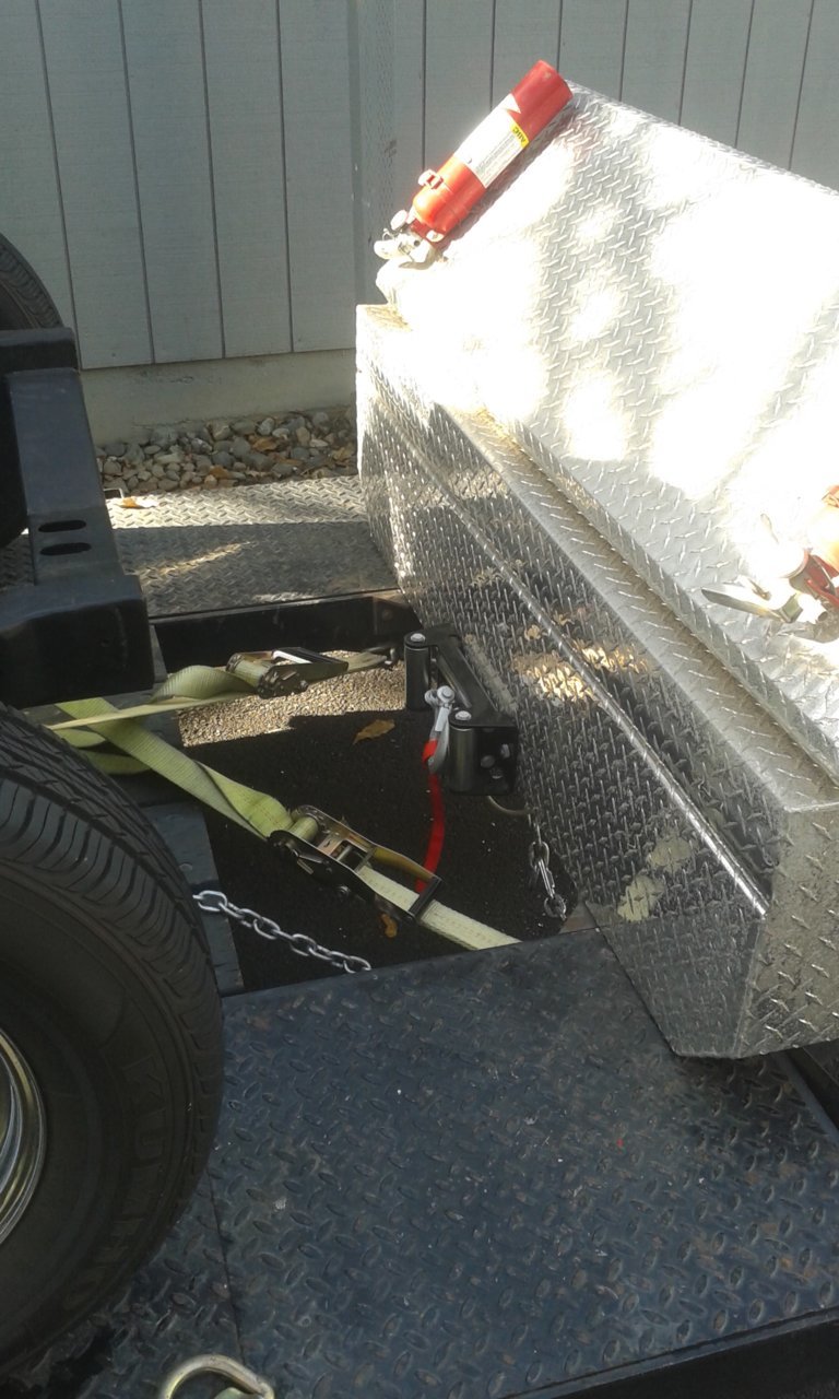

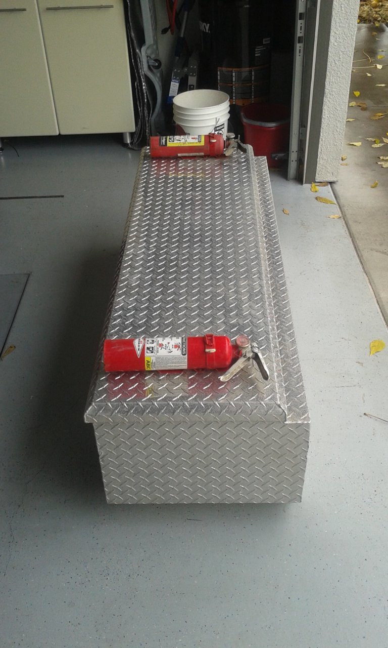

    Picked up a used tool box to go over the winch and store straps for the car trailer.
    Cost a whole $40 and came with 2 extinguishers and lots of grease/grime.

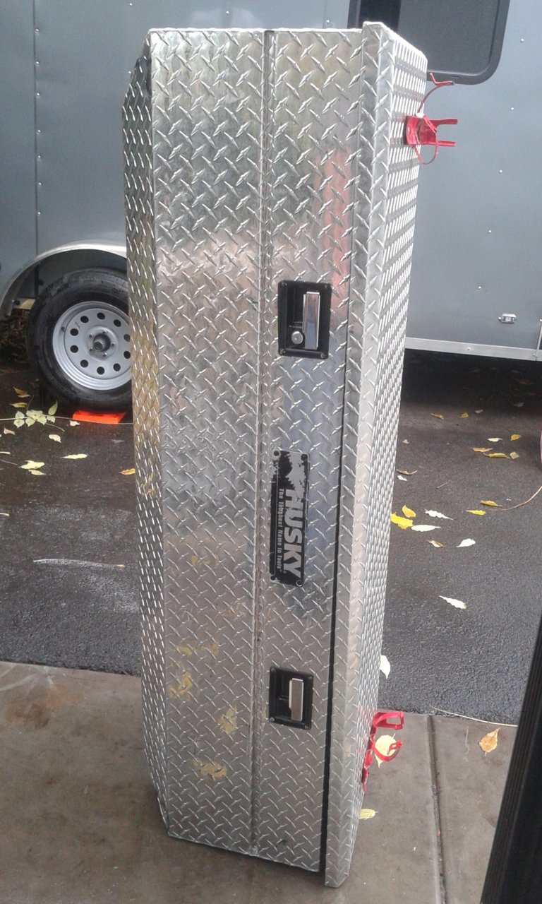

    Itll get more support when I rebuild the tongue on the trailer for more hitch clearance.

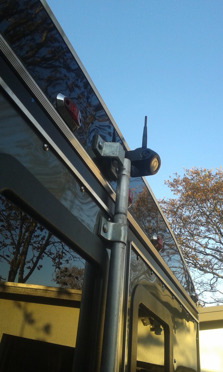

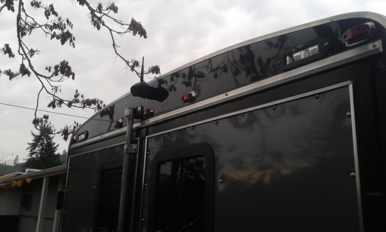

    Camera on.

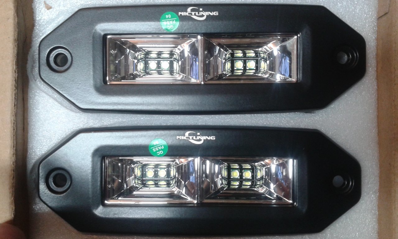

    Gonna try these for backup/area lights on the cargo trailer.
    $39 for the pair, 3 year warranty against failure and leaks with free shipping on return and replacement.

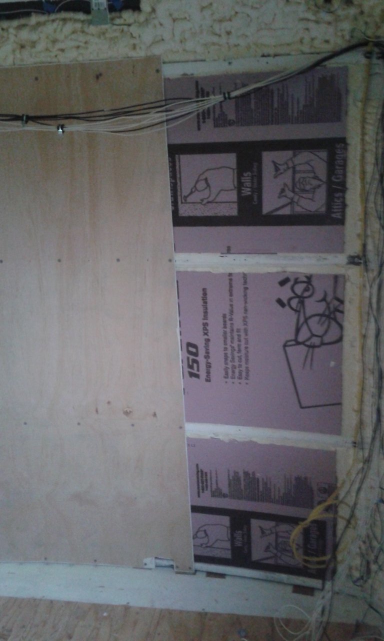

    Insulated the front wall and made the wall panels. 1 1/2" foam fit perfectly between the ribs. Got the 1/8" plywood at HD for 70% off because there was some edge damage. Had to shorten them anyways, so I was happy with that.

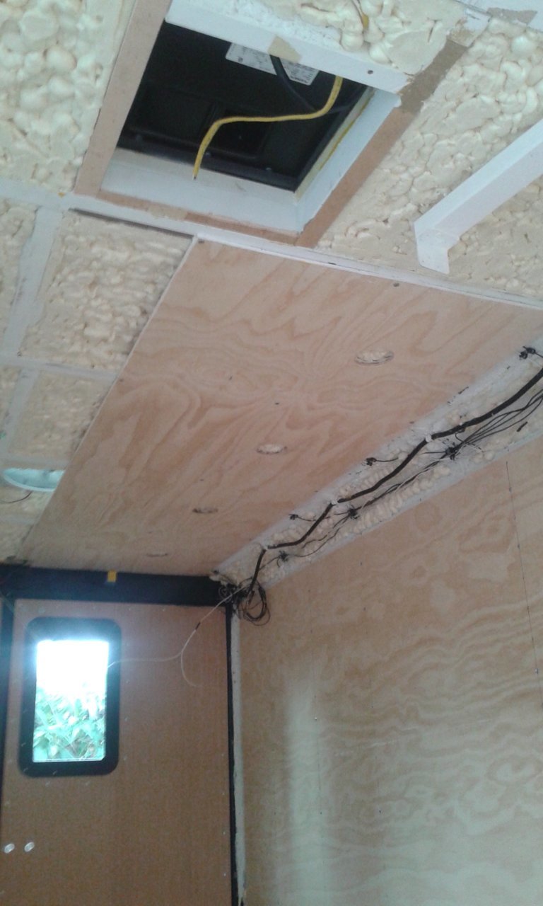

    Canopy, fitted seat covers, OBA with self leveling air bags, 100w solar, dual Rhino Rack Pioneer platforms, side & rear LED work/FU lights, CB, cell booster. 7x16 cargo conversion, 3" lift, 7'x6.5' fold down aluminum rear deck.
    Fitting the first ceiling panel. **** I hate drilling holes overhead. My shoulders are killing me.
    After holes are drilled, I will pull it down to cut the hole for the vent in the panel and clear out the foam where the lights go. Before it goes back up, the metal ribs gey vinyl tape to help reduce temp variances.

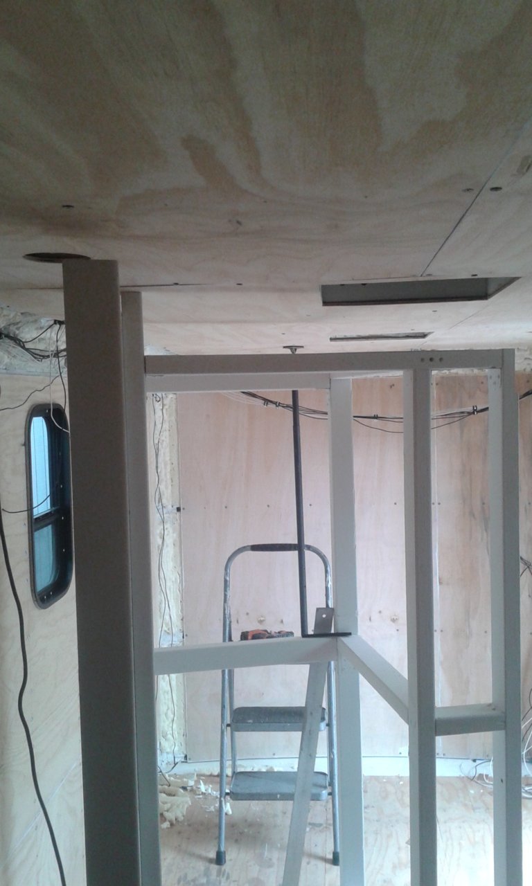

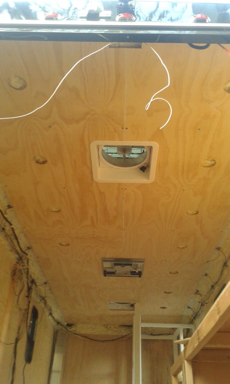

    Used the frame for the closet and my cargo bar to hold up the plywood sheets as I drilled holes in the steel ribs and put screws in.
    All panels are mocked up with all holes cut out.
    Next, I have to take them back down to trim the foam for the lights and to put the vinyl tape on the ribs. I will seal/prime the visible side while they are down (back side is already done).

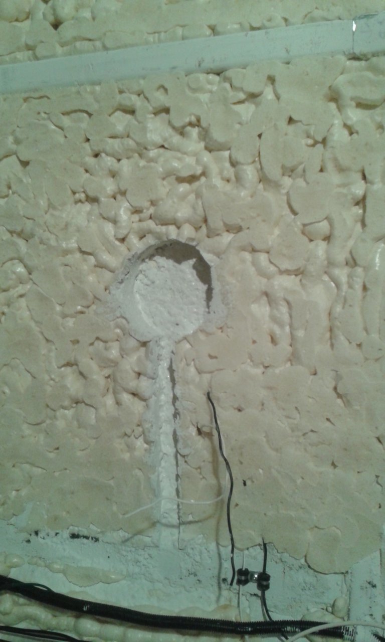

    Made some recesses for the LED light pods in the ceiling. The channel is to allow airflow.

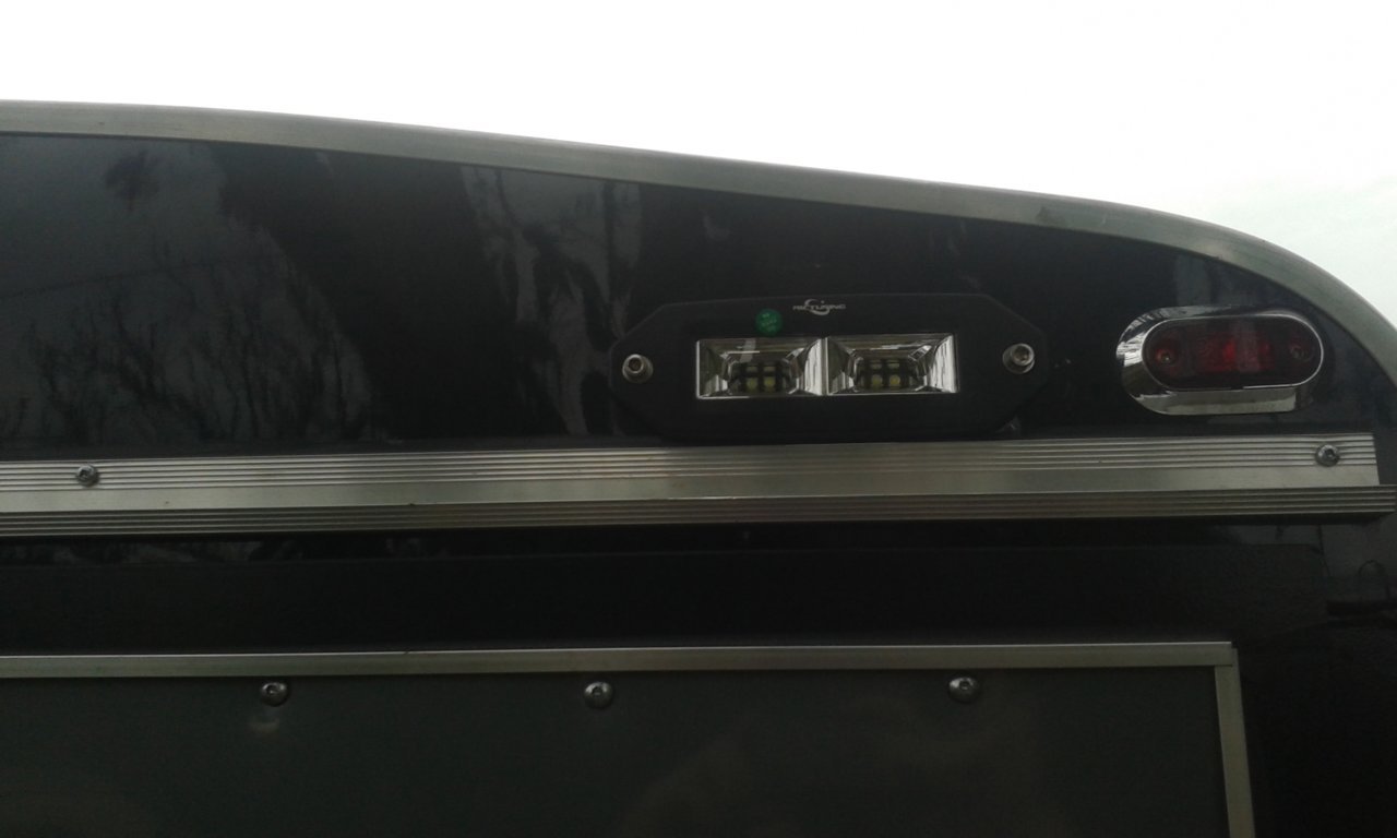

    Mounted the MicTuning lights as backup/area lights.
    Was going to get a shower, but the two that HD had were damaged and the manager wasnt willing to drop the price enough to make it worth my time to repair the damage to the gelcoat.
    I plan to wait for a couple dry days next month and I will haul the trailer up to pick up the flooring and the frp panels for the roof (grey) and bathroom wall (white).
    Anyways, lights....
