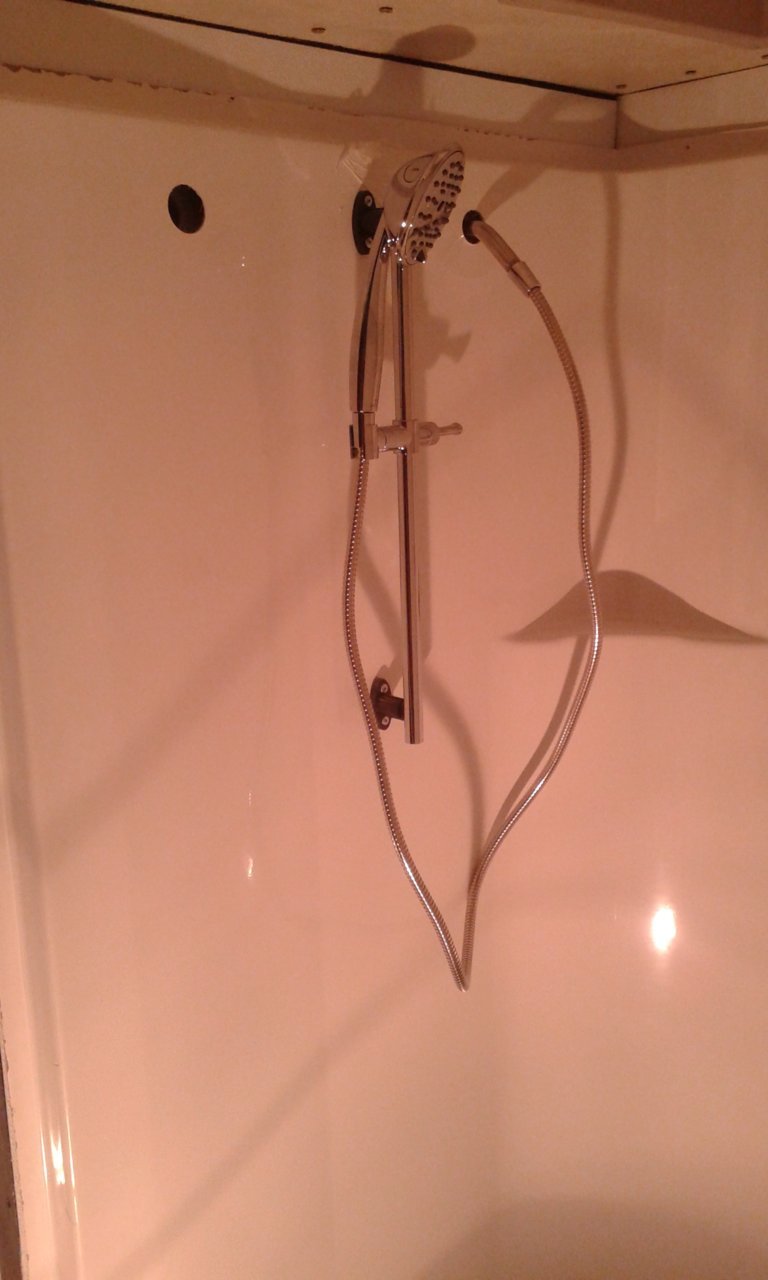

    Decided on this one. Looked what was available at 7 different stores, found this in the clearance section at HD.
    Clearwater Bill likes this.

    Trim isnt on since it has to come out again to get shelves and plumbing in. But, I got the locations figured out for the shower bar and the pipe.
    I put the pipe where I did because it is centered on the ceiling supports and if I decide to add a rain head for when I am hooked up external water and drainage, I can build a hardline to run above the ceiling and hook it to a diverter. The shower bar is centered on the shower wall with the head off center and aimed toward the back corner.

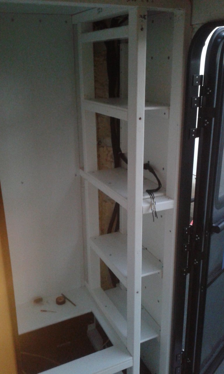

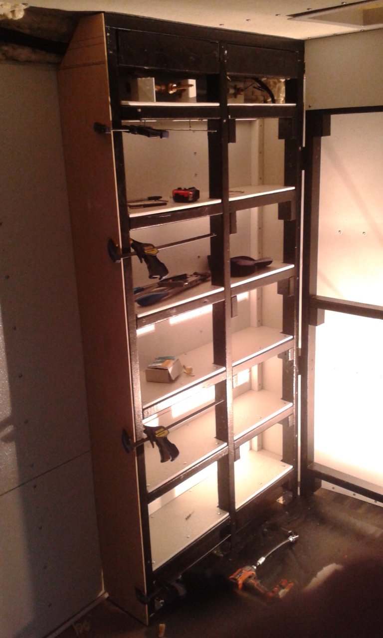

    Did some more shelving work and got the shower plumbing done. Tomorrow, I will work on the front panel for the bathroom shelves and the side panels of the closet shelves.

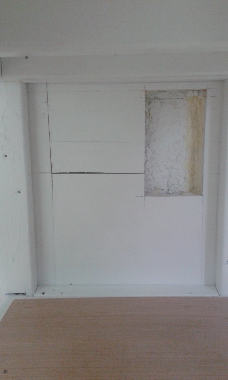

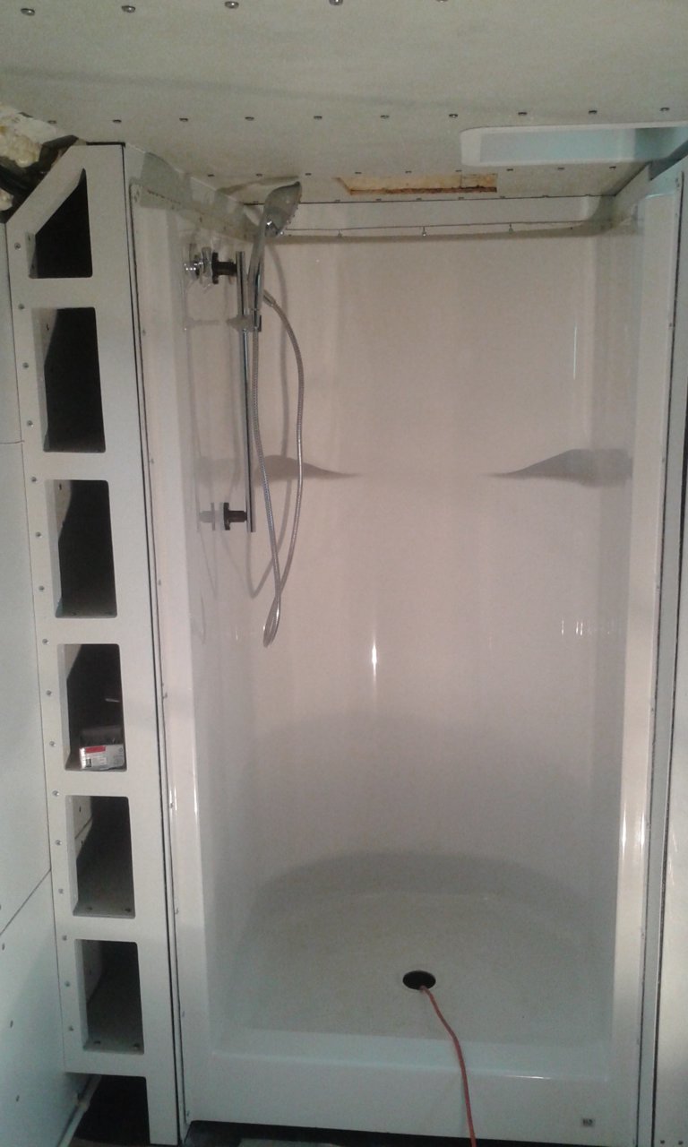

    Shower wall panels mounted and sealed (except for top, which had to wait for shower to be mounted). Shower screwed into place. Taking a break to let my back settle down, then I will go seal the edges with caulking and start making the trim.

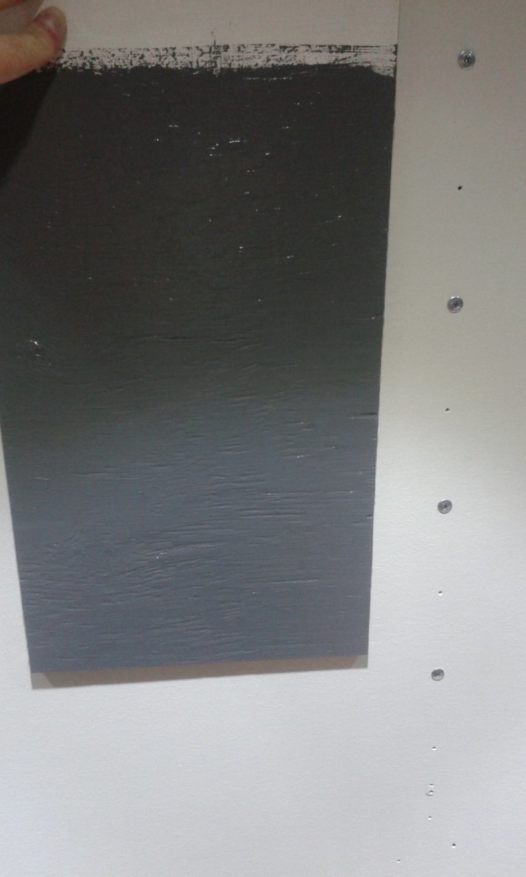

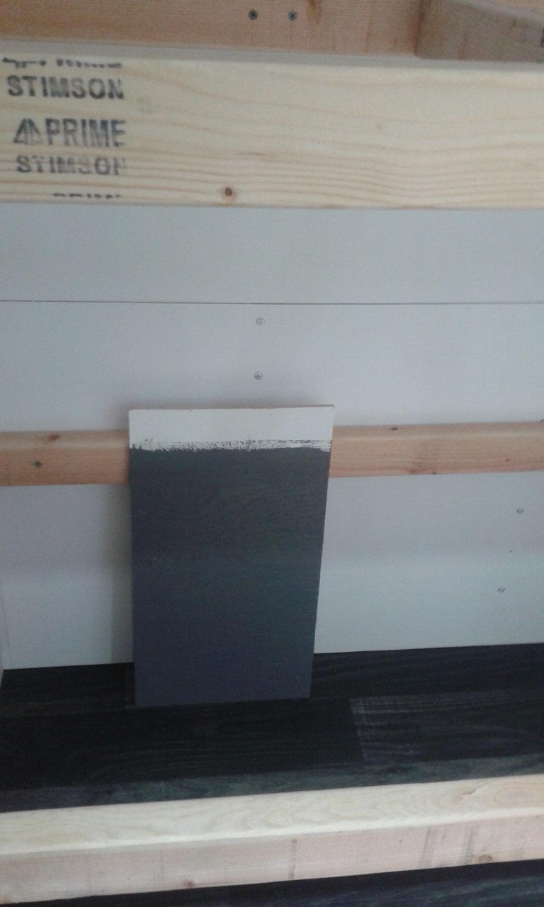

    Picked a color for the walls. Behr "Dark Ash". The throw of the lights will give it a two tone look.
    Ofcourse walls will be filled and sanded as needed prior to paint.

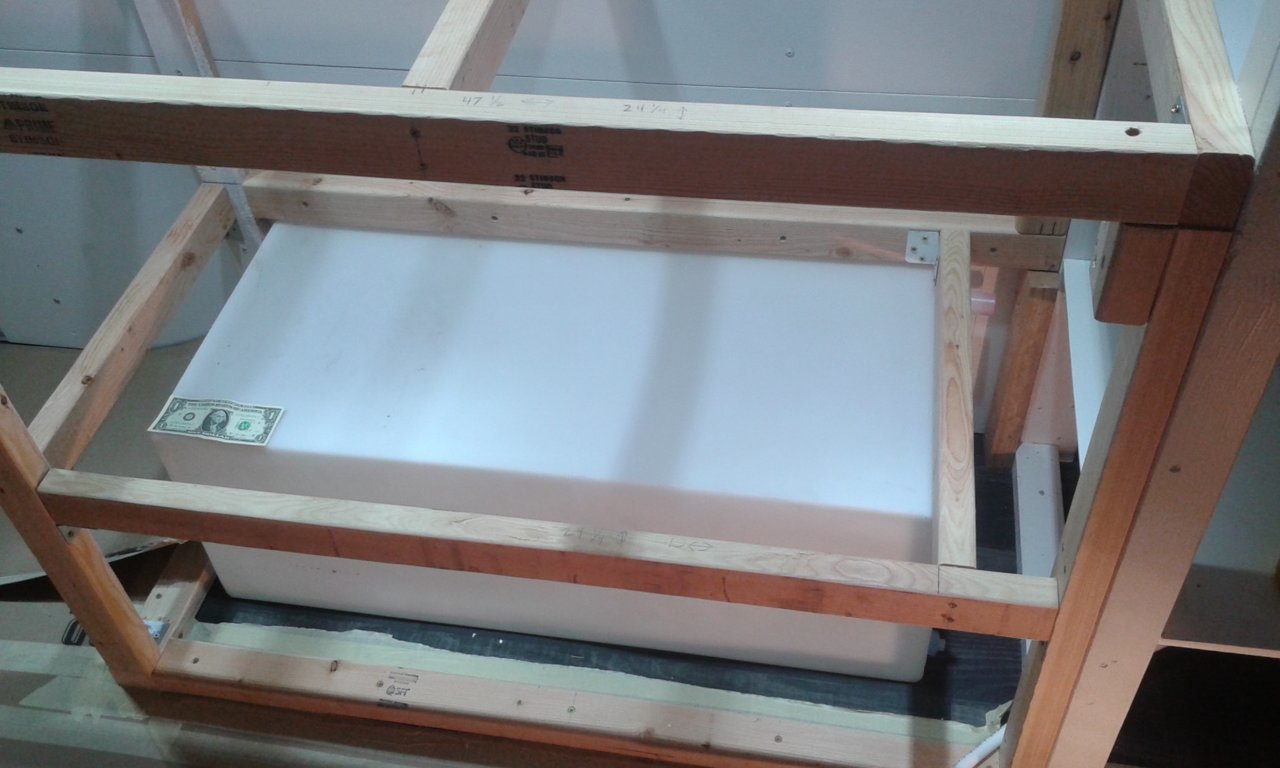

    Yay! 42 gallon water tank arrived. Strange thing to be excited about. $1 bill for size comparison.

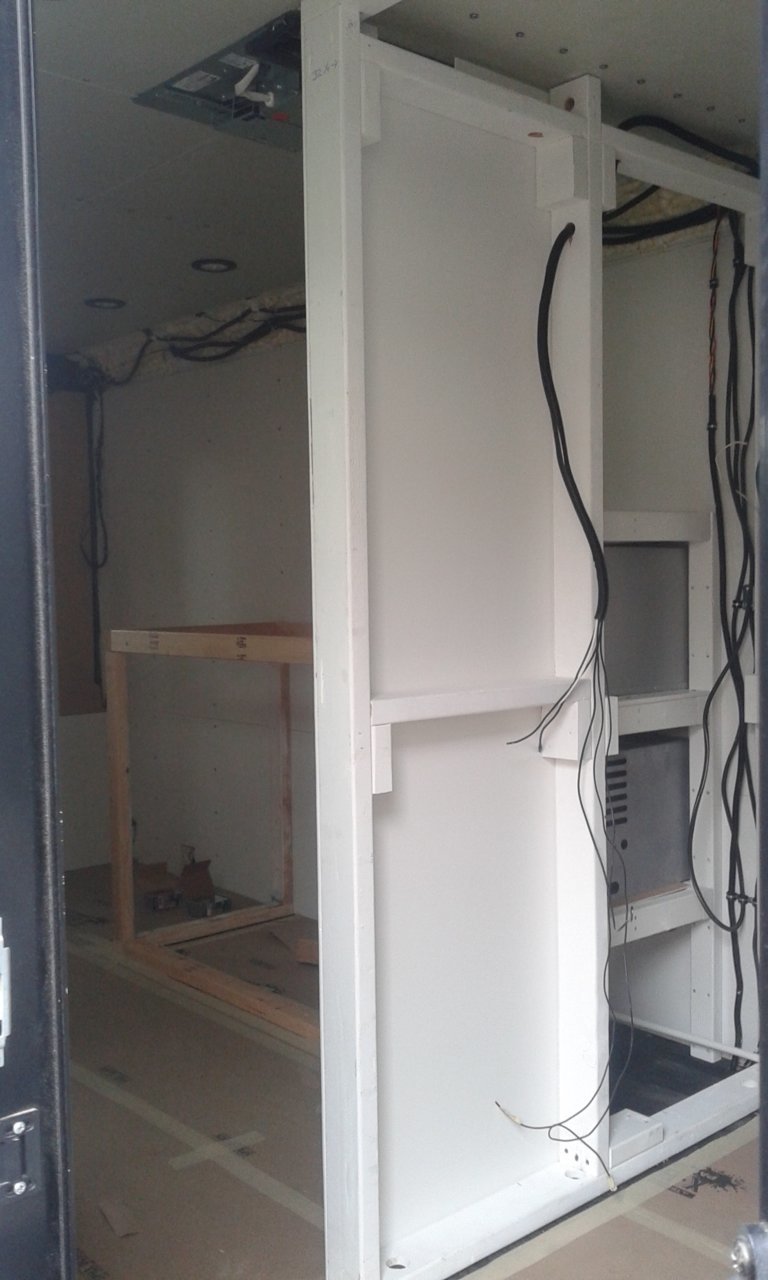

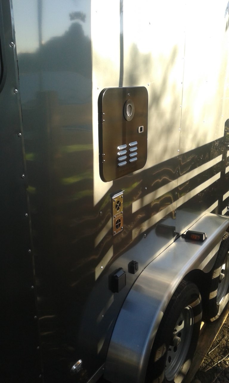

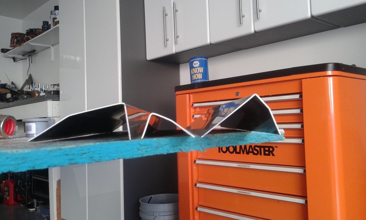

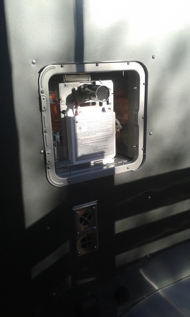

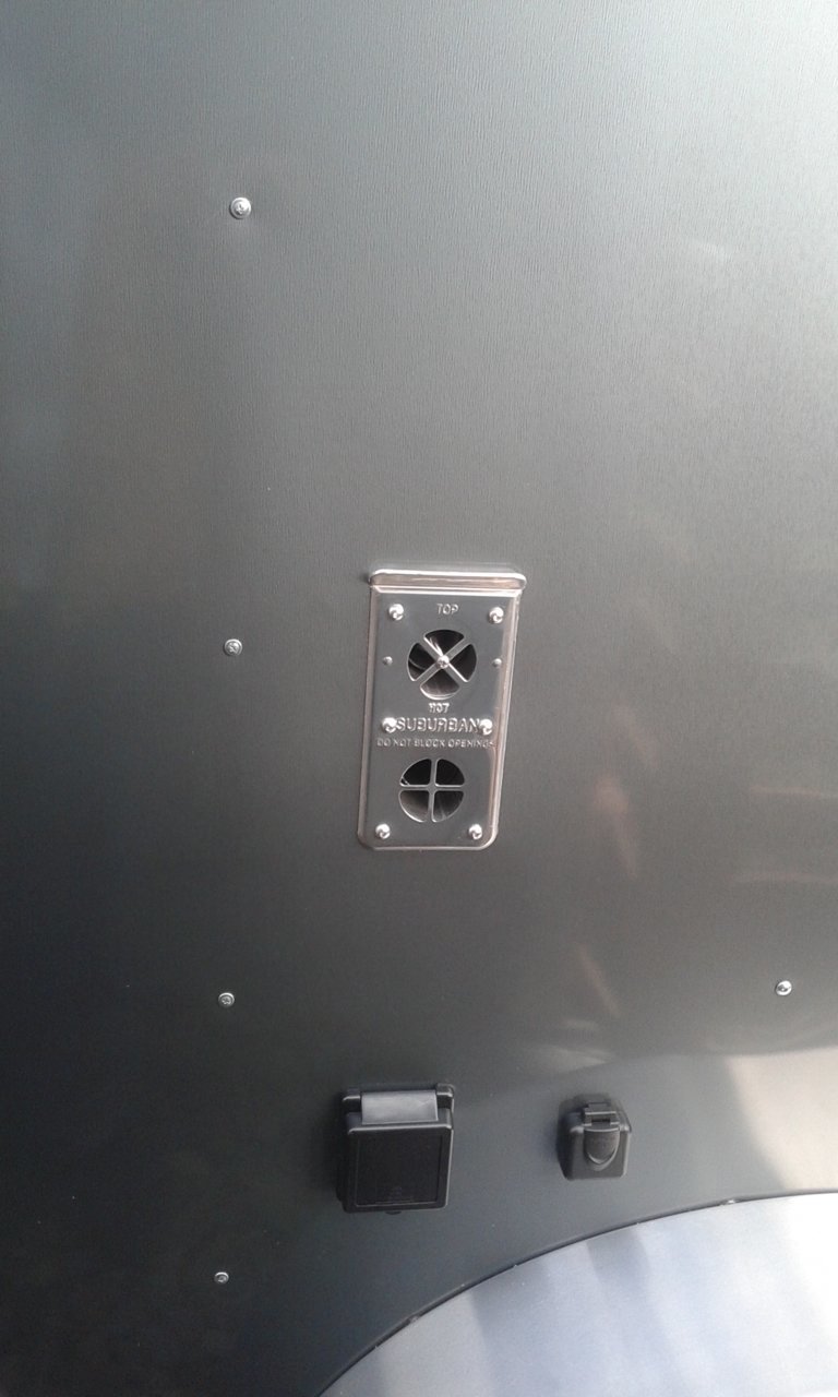

    Got the heater installed today, had to wait for a dry day to cut holes in the side of the trailer. Used m5-28 nutserts and stainless hardware.
    Made some aluminum heat guards with my HF brake.
    Hopefully, I will get the water heater installed tomorrow. Gotta cut a big hole and add some bracing at top and bottom of the hole so the screws dont just go into the aluminum skin. Sides have steel ribs that the screws will go into.

    Cut a big hole in the side of my trailer...
    Waiting for the paint to dry on the bracing before I put it all together.

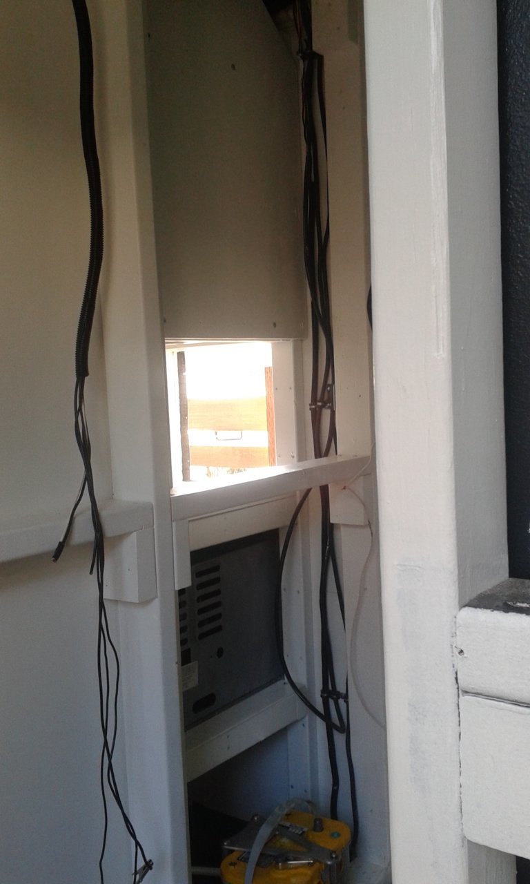

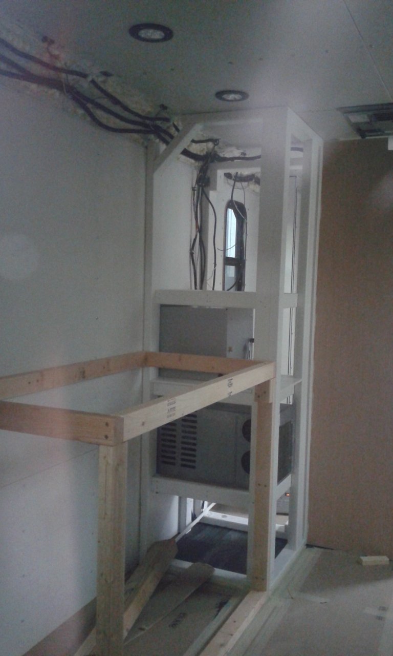

    Framed out, and installed water heater.

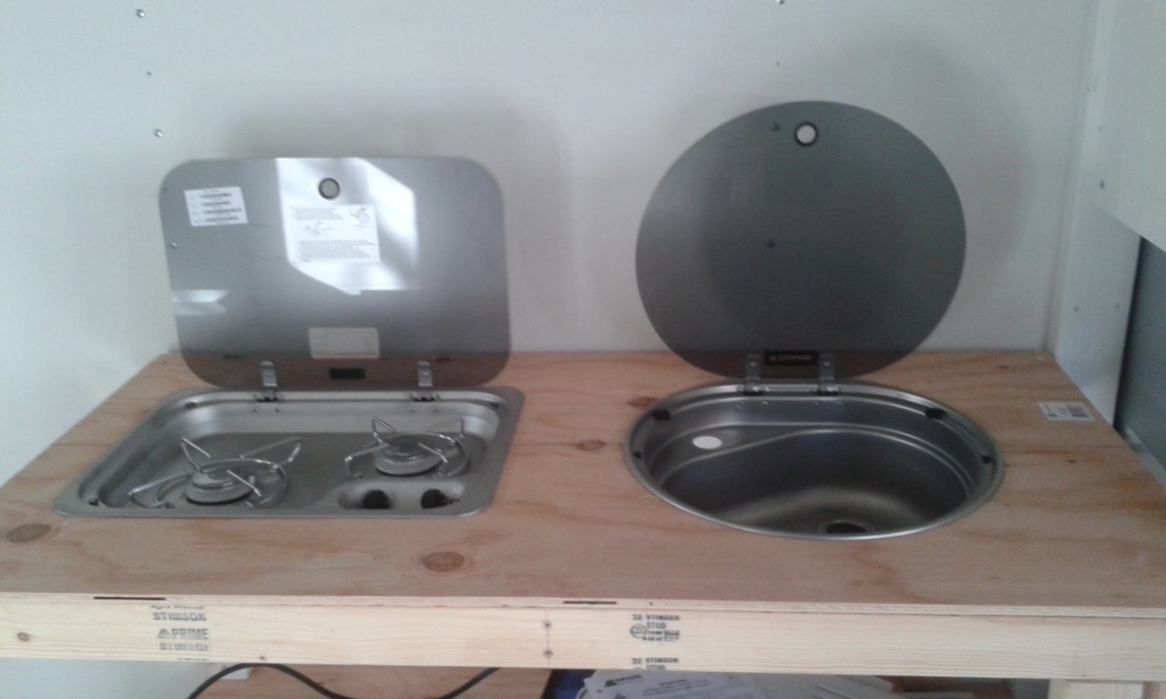

    Made the template counter top.
    Made it out of 3/8 plywood so that I can make the cabinets under the sink/stove and I know everything will clear when I put the 1" counter top on.
