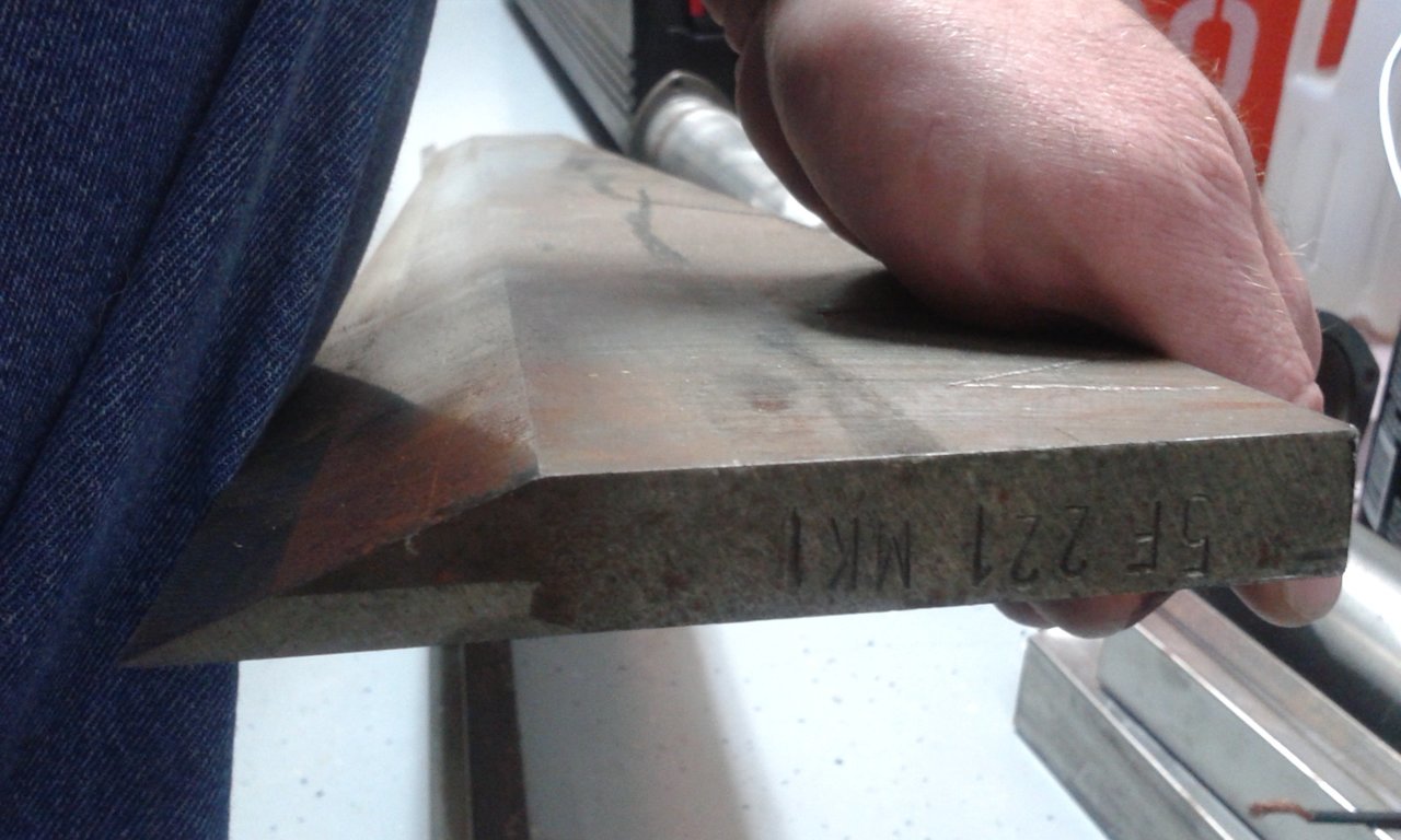

    So, I picked up a new edge. This is actually a planer knife that got replaced at one of the mills. Sharp as ****.

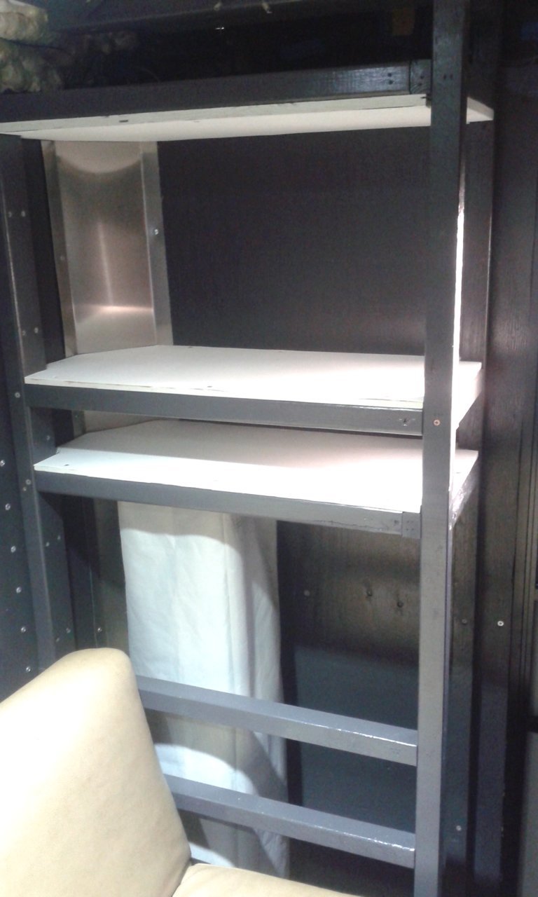

    A little work on the trailer.
    Shelves done for the rear curbside cabinet. Top shelf (with boards top and bottom) will be for pillow and blanket storage. Bottom shelf (small one) will be for anything I may decide I want quick access to while in bed. Space at the bottom will be for fold up chairs, outdoor shower components, and 10x10 canopy.

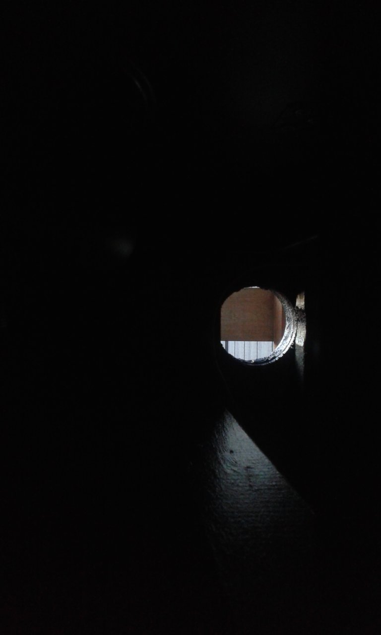

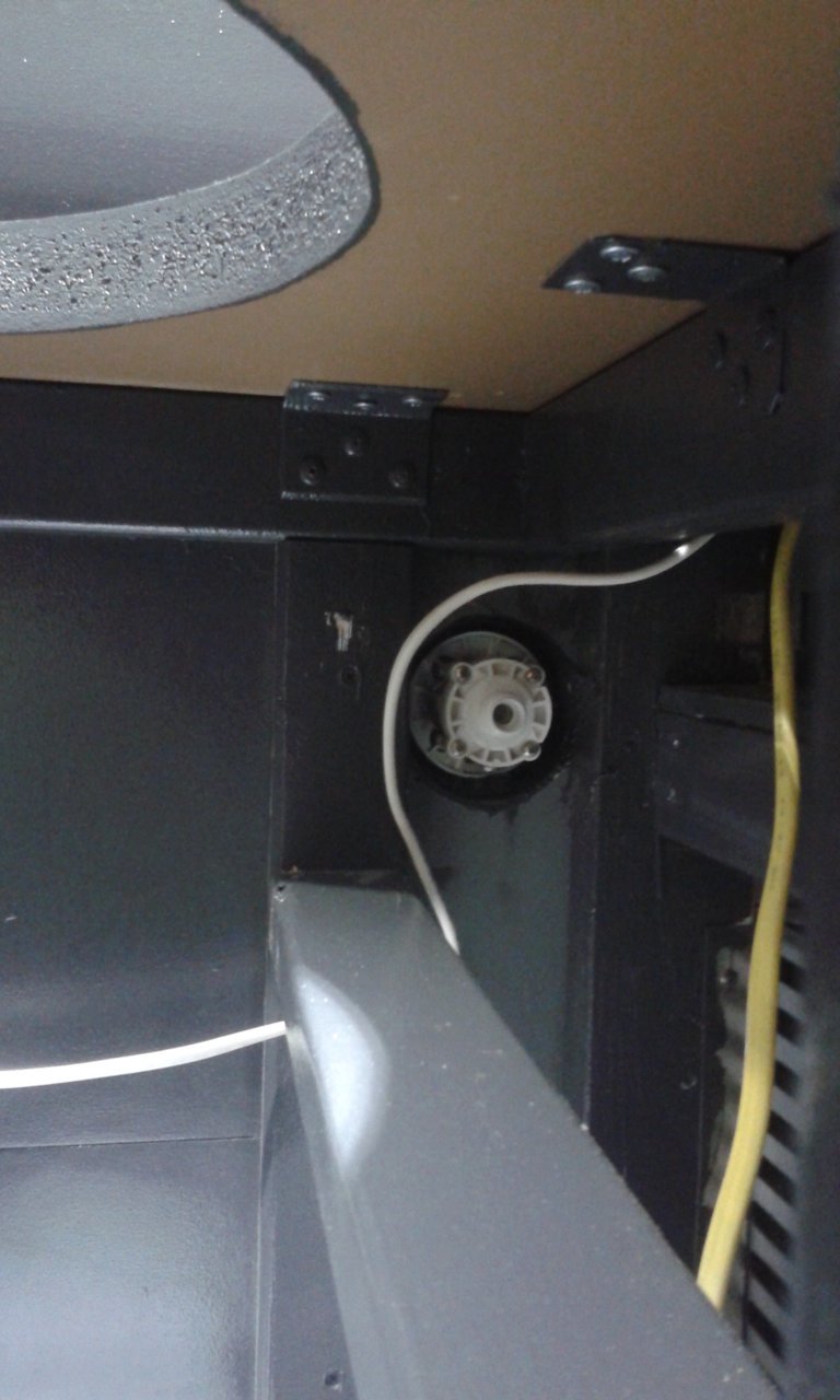

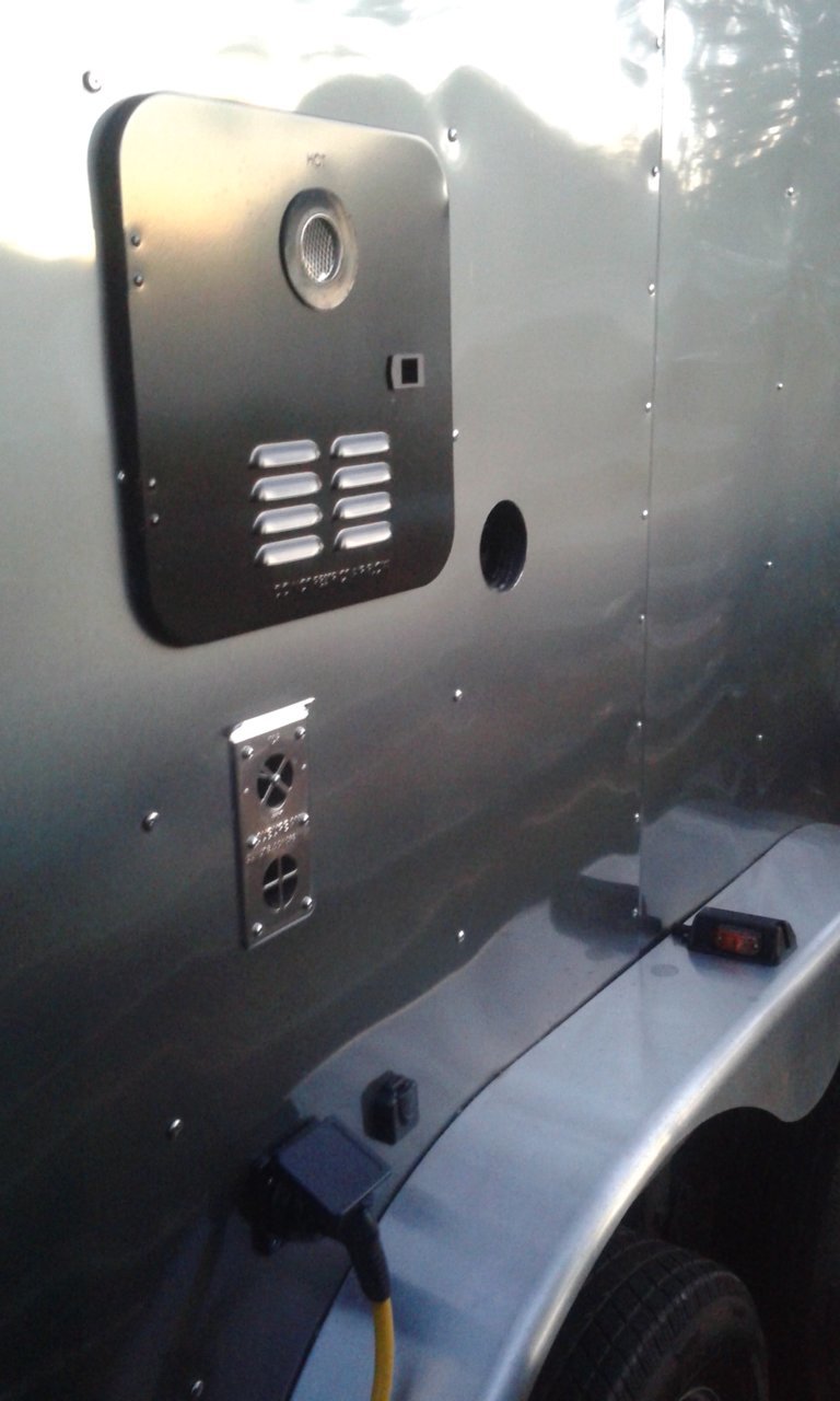

    Cut a hole through the wall and installed the water inlet. I installed it pretty high so I can put a hose on and lay the hose on the fender to prevent any tension from a hose hanging and putting stress on the sealant.
    20191209_164843.jpg 20191209_164807.jpg 20191209_174744.jpg 20191209_174948.jpg

    Reserected from the dead.
    Great idea on the hose connection. Kinda makes you wonder why RV manufacturer companies don't see this kind of simple stuff.

    Yeah. It makes me scratch my head when I see people with hoses hooked straight to the fitting on the side, putting strain on the connection and hose. They do make a 90* elbow which helps, and I do plan to use. But, I will make things cause less stress if I am able.

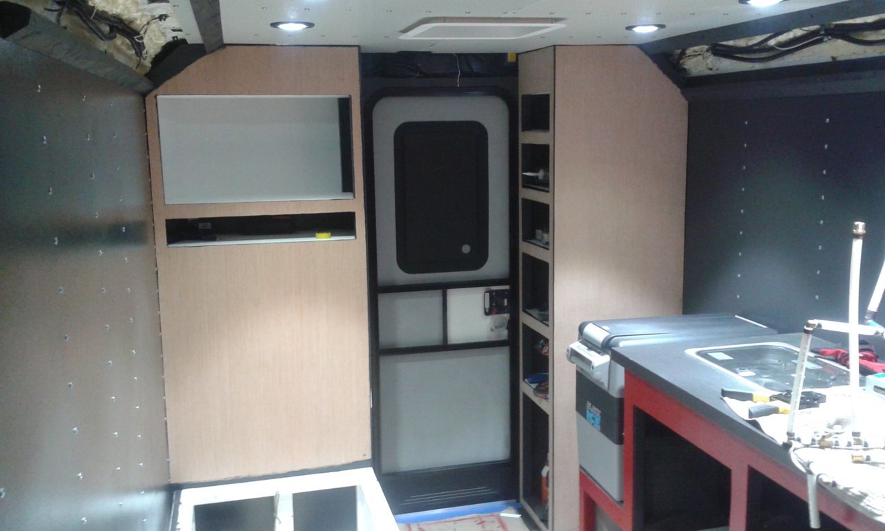

    This months trailer budget went to insulation, glue, some panels for the back cabinets, paint, bunch of cabinet handles, and the mounting kit for the bathroom door.
    Installed some of the foam. Used jacks to hold the panels up tight til the glue cures. Tomorrow, I will finish up the insulation.
    Used a router to groove the panels for the floor stringers and the wiring.

    Working on cabinets a bit. Paint is drying on the back sides of the panels for the other side and door side for this one.

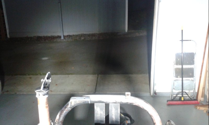

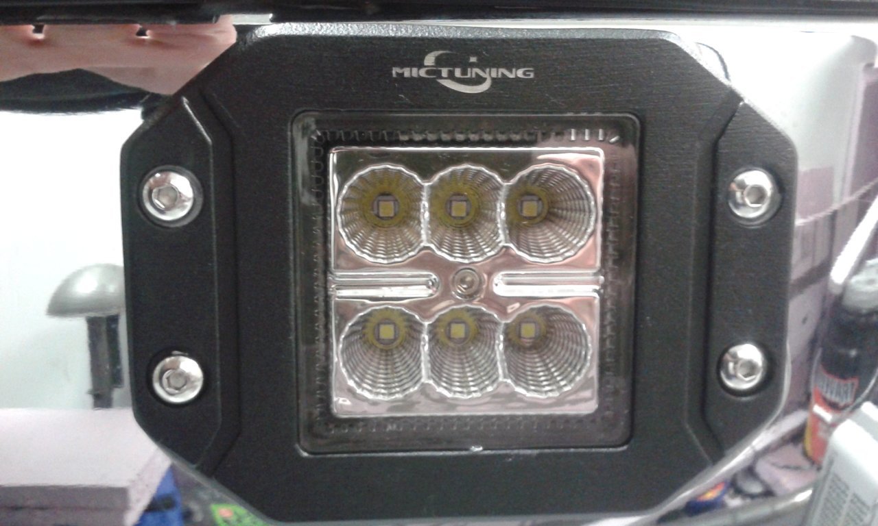

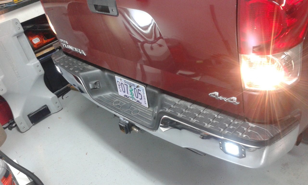

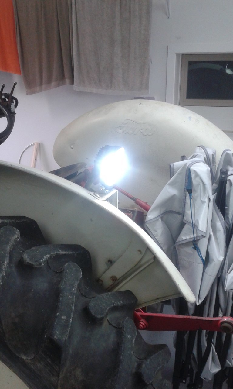

    Got tired of not being able to see the driveway entrance when backing in at night. So, I upgraded the reverse lights on the Tundra. Used the trailer backup light circuit at the plug as the trigger on the relay which is mounted above the spare tire. Lights are mounted with a slight outward angle.

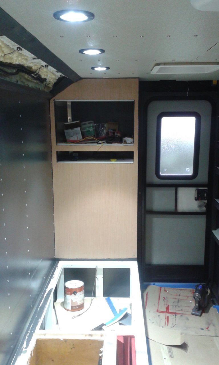

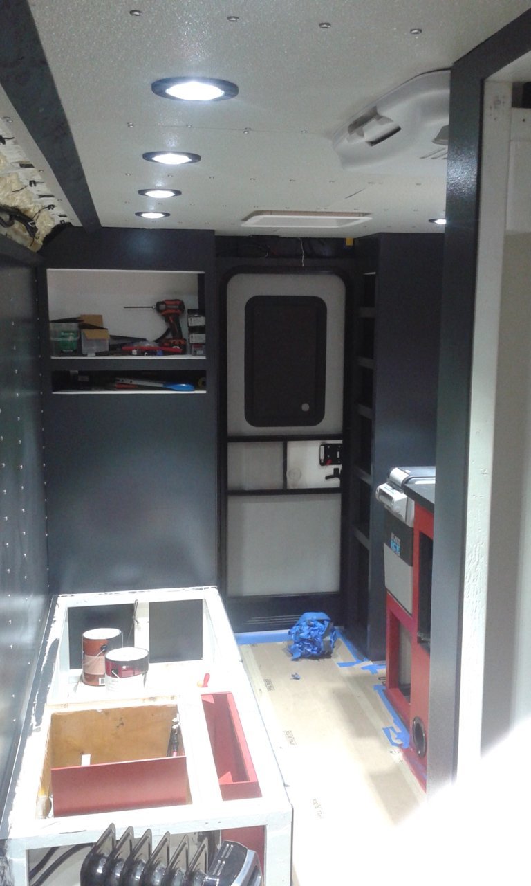

    Threw some paint up. Also trimmed out the wall where the bathroom door is. Tomorrow, I will cut the top panel of the door opening and, if I get a break in the rain, cut the door down to size.
    I think I have decided on a toilet, just want to find a dealer with one in stock so I can look at it. I am looking at the Natures Head Composting Toilet. If I go composting, I wont have to put in a black tank. This would allow me to either double up the grey water capacity, or just have one tank which will reduce my underbelly components. Only issue is the $1k price tag.
    The red painted section by the battery box is going to be used for master cutoff switch, solar control module and breakers, along with any additional 12v breakers that may be needed in the future and all associated wiring. The piece that is in the battery box is the mounting panel, just needed it out of the way to work on a bit of wiring.

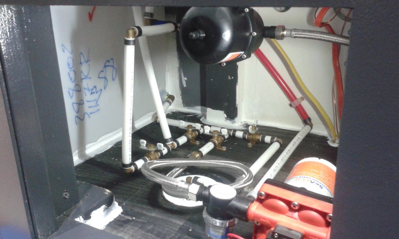

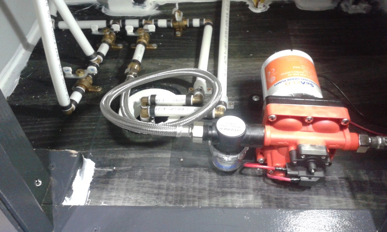

    Water manifold finished up.
    Flex line on input and output on pump to reduce vibration as much as possible. Accumulator (to reduce pump pulsation) mounted in easy to reach but out of the way spot. Drain in the floor to allow water to drain out of the trailer in event of catastrophic failure. The two lines are run down and out the floor drain are the tank vent (looped up from tank to bottom of counter, then back down) and the system drain.

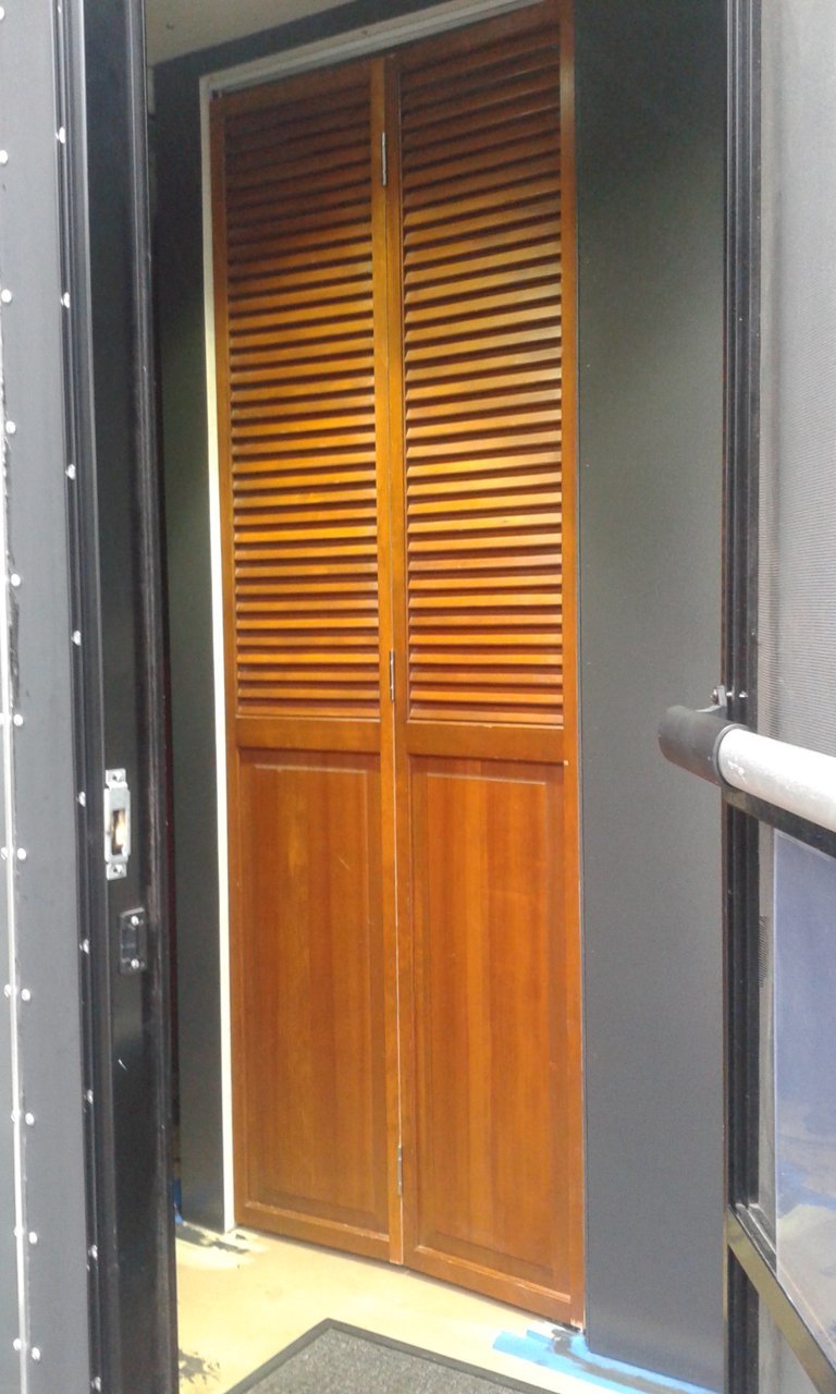

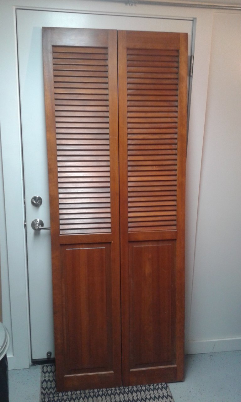

    My $30 bathroom door. Still need to paint and trim it.

    Why paint it. The stained look is nice.

    Its got some stain streaks, paint spots, and damage. If I dont paint, I will sand and restain it darker. Not going to happen right away. Just had to get it mocked up so I could make sure clearances are fine.
    Probably in March or April, I will be buying the $1k toilet so I can finish the bathroom walls and start the trim work.

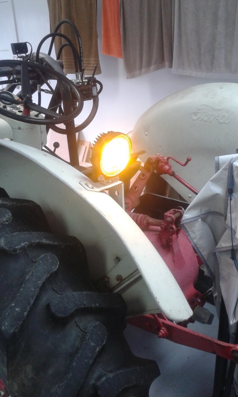

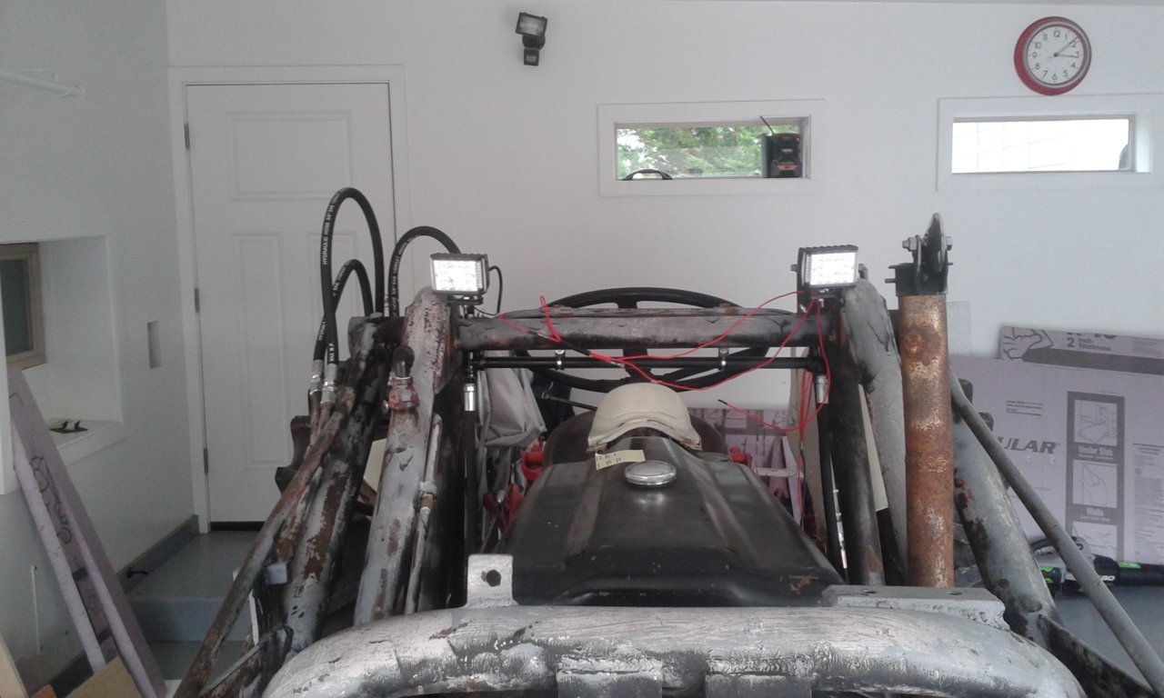

    Added some side shooters to the tractor. Got em because they only cost me $12 and they give off enough light that I can see the fuel level at night. I will move them overhead when I build the cage.

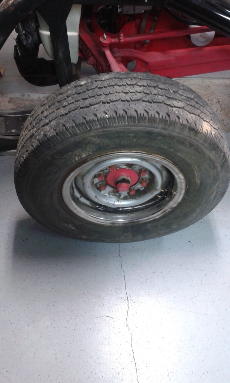

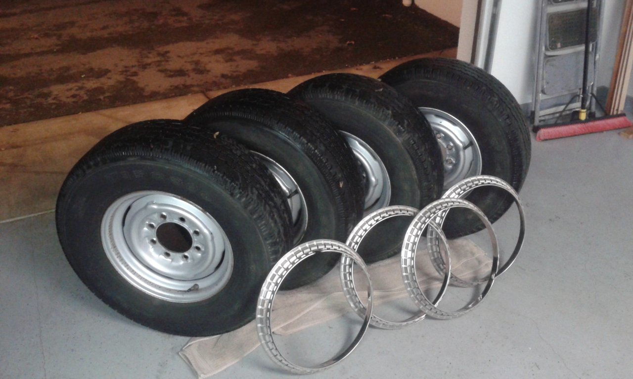

    These are the new(er) wheels and tires that I got today. Got 8 for $20, kept the 4 best and sold the other 4 for $40.
    They are a little bit taller, but are also a little bit narrower which will make it so they dont rub on the steering arm.

    I must have missed something, Chris. What are those wheels supposed to fit? Or did you just but them for the tires?
  20. Jan 24, 2020 at 7:48 PM
    #600
    windsor
    windsor [OP] Just a guy
    Dec 31, 2014
    #145322
    7,665
    Homeless in Oregon
    2008 Tacoma Super Duty aka Tundra
    Canopy, fitted seat covers, OBA with self leveling air bags, 100w solar, dual Rhino Rack Pioneer platforms, side & rear LED work/FU lights, CB, cell booster. 7x16 cargo conversion, 3" lift, 7'x6.5' fold down aluminum rear deck.
    Those are for the tractor. PO did a 8 lug conversion (drilled new holes and welded studs in). I got the tractor with 16.5" wheels, mismatched & rotten 9.5x16.5 and 10x16.5 tires. The selection seems a bit narrow, so I went hunting for 16s. Wanted to make sure I had decent tires before hitting the sagebrush in the spring/summer.
