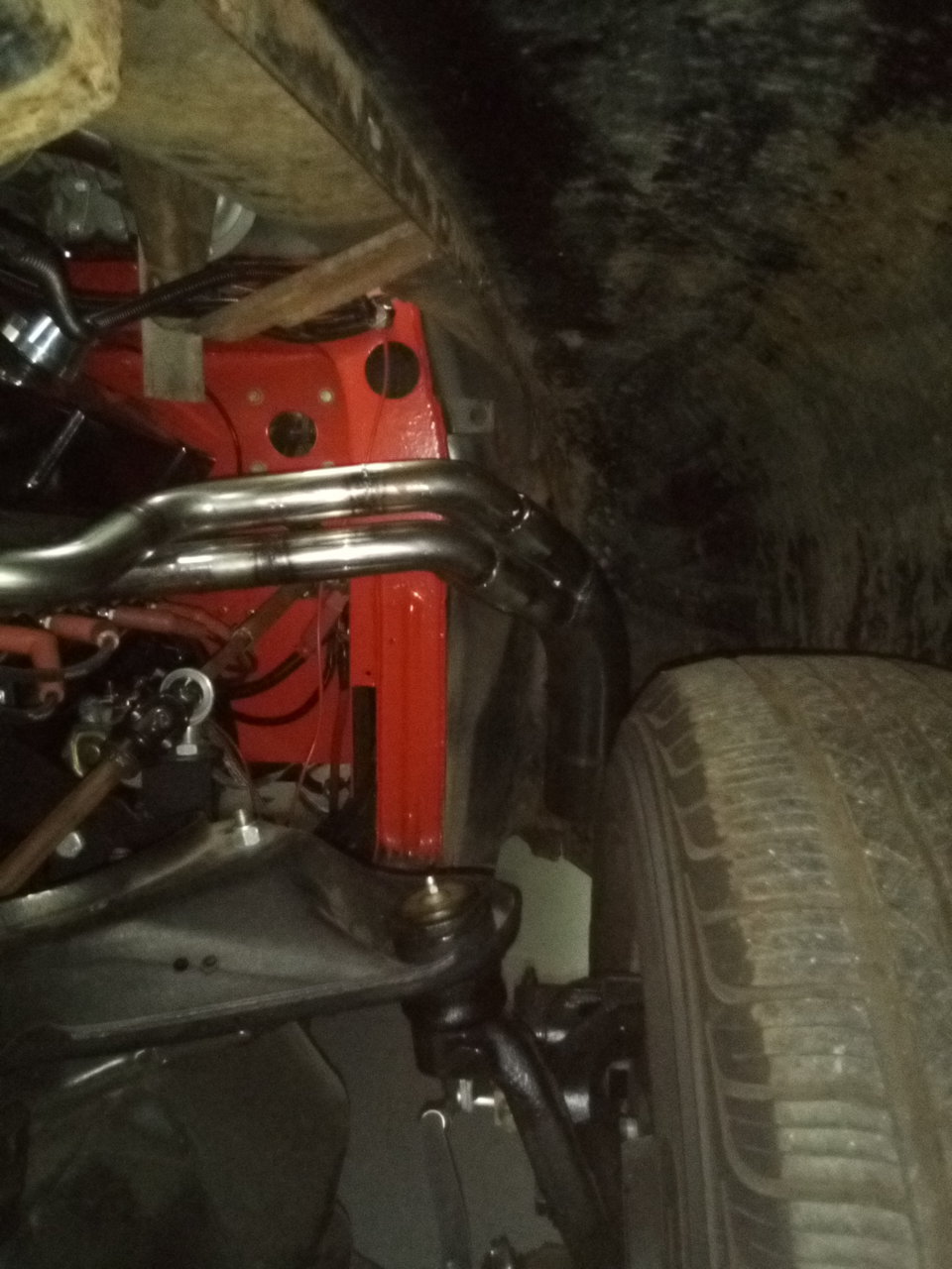

    Hand shaped some turndowns to fit the curves of the 4-1 collectors and got them welded on. Had to put the fenders back on to make sure that everything cleared.

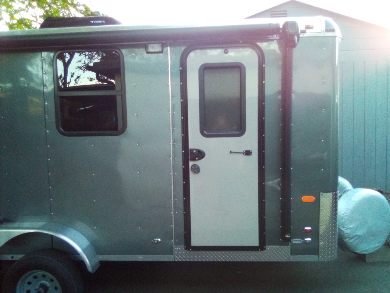

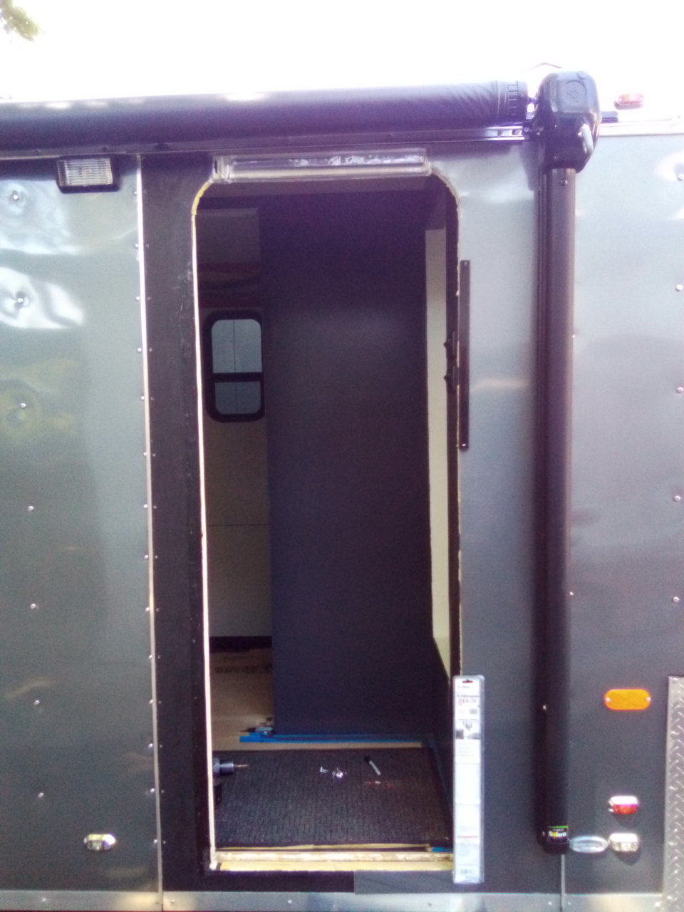

    Decided to use the leftover skin pieces from the back wall to skin over the side where the door is. Took me over an hour to get the door out. The butyl that I used had a really good bite.
    I probably should have waited, this kidney stone is kicking my butt at the moment.

    All that's left on the new paneling is to seal the edge of the kick panel, seal the edge above the door, remove/clean/reinstall the screws, and make something to go over where the door holder is.

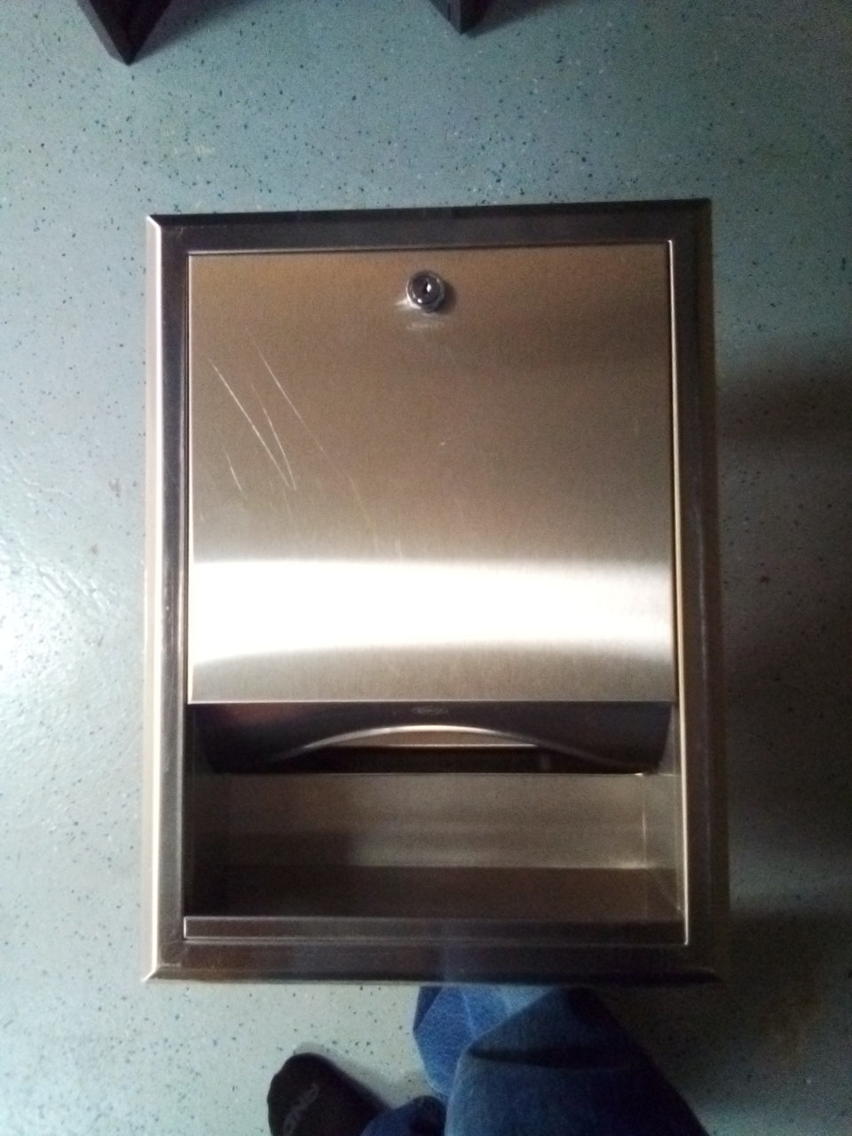

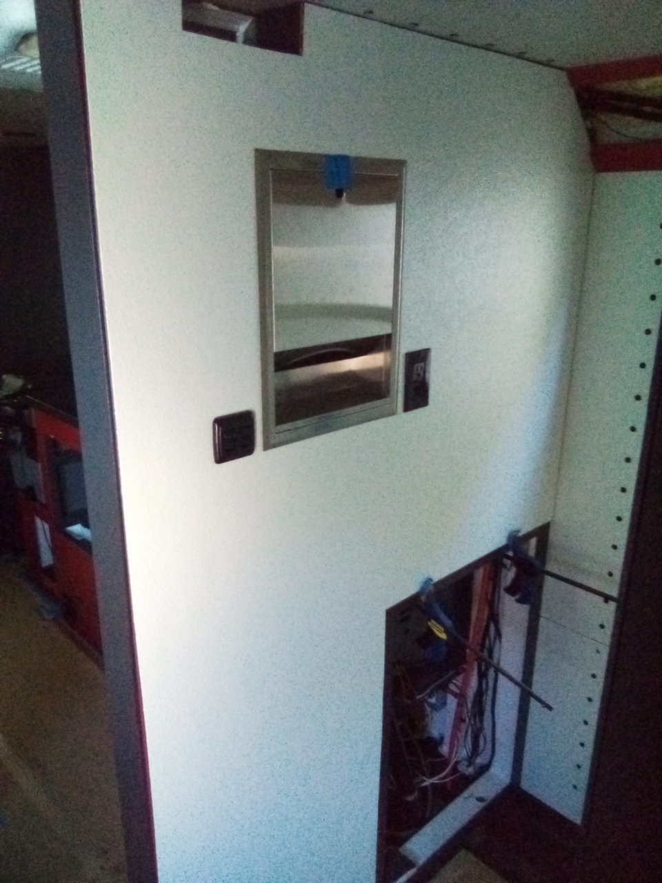

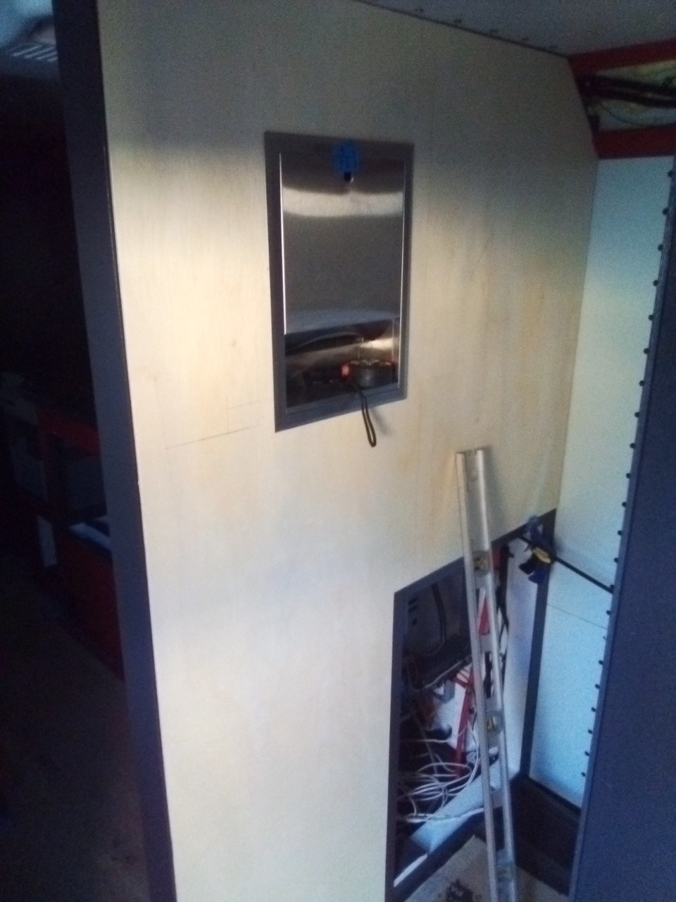

    Working on the bathroom in the trailer. Been thinking about a medicine cabinet and/or shelves in the wall for small storage and a mirror.
    Found this stainless paper towel dispenser at the local building materials reclaim shop. Cost me a whole $3. I am going cut out the dispenser opening and some shelves in it (probably go back to see if they have another one or different model that I can salvage the material from), then polish the door to a mirror.

    Still need to cut the FRP panel to fit, but the backer is cut to size and the cabinet studs are in place. It won't get permanently installed until the toilet and it's vent are installed (just easier to install the pipe when I have access behind the wall). The access panel is to have access to the water heater and furnace gas lines along with additional access to the water pump and plumbing. I did have to add 1/4" strips to the studs to get up to the 4" wall thickness needed for the cabinet to fit. Thankfully, it wasn't unexpected and I had plenty of remnants to do it.

    Cut the FRP to size. Waiting for the 12v outlet to get here to figure out where it goes.
    I also picked up two more of the paper towel dispensers to cut up for making shelves in the one I am using.

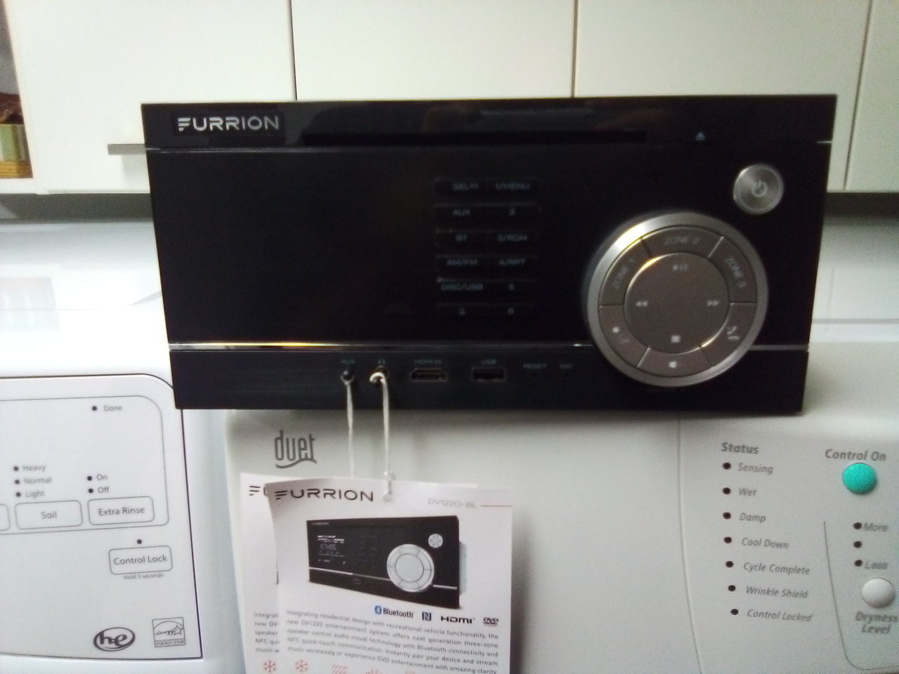

    Interesting day. Went hunting for parts for the trailer. Picked up a NIB Furrion DV1220-BL for $100, a crank open RV window for the kitchen for $120, and a couple of water tanks to put in the bed of the truck so I don't have to haul the trailer to get more water.

  14. Aug 4, 2020 at 1:44 AM

    Going in the tundra?

    No, trailer. Got it NIB for $100. I still need to get speakers.

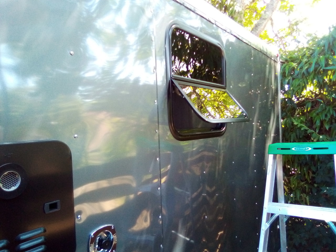

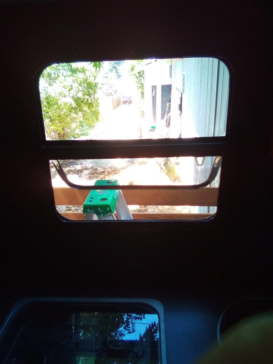

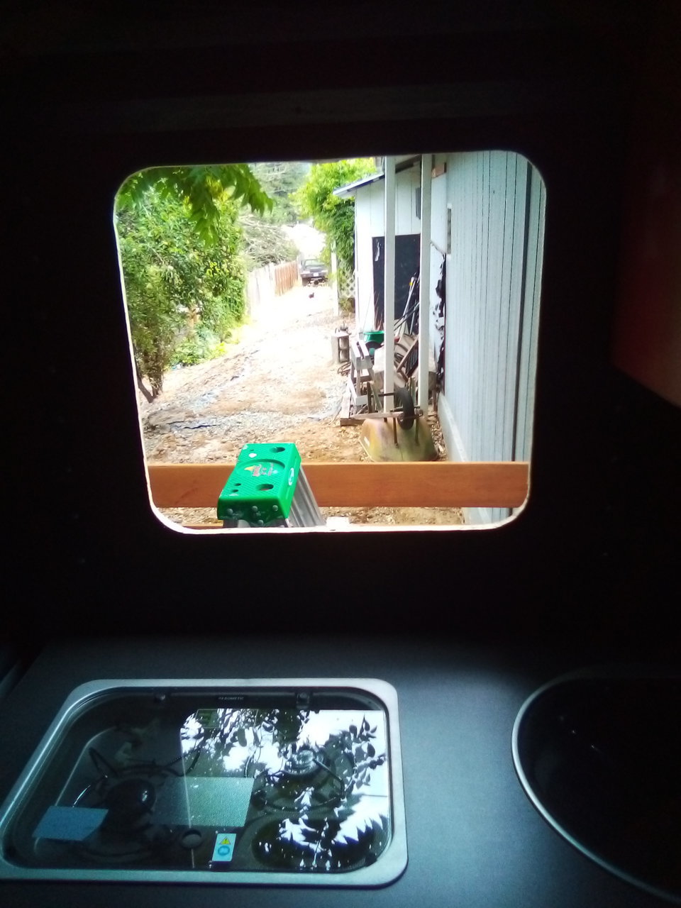

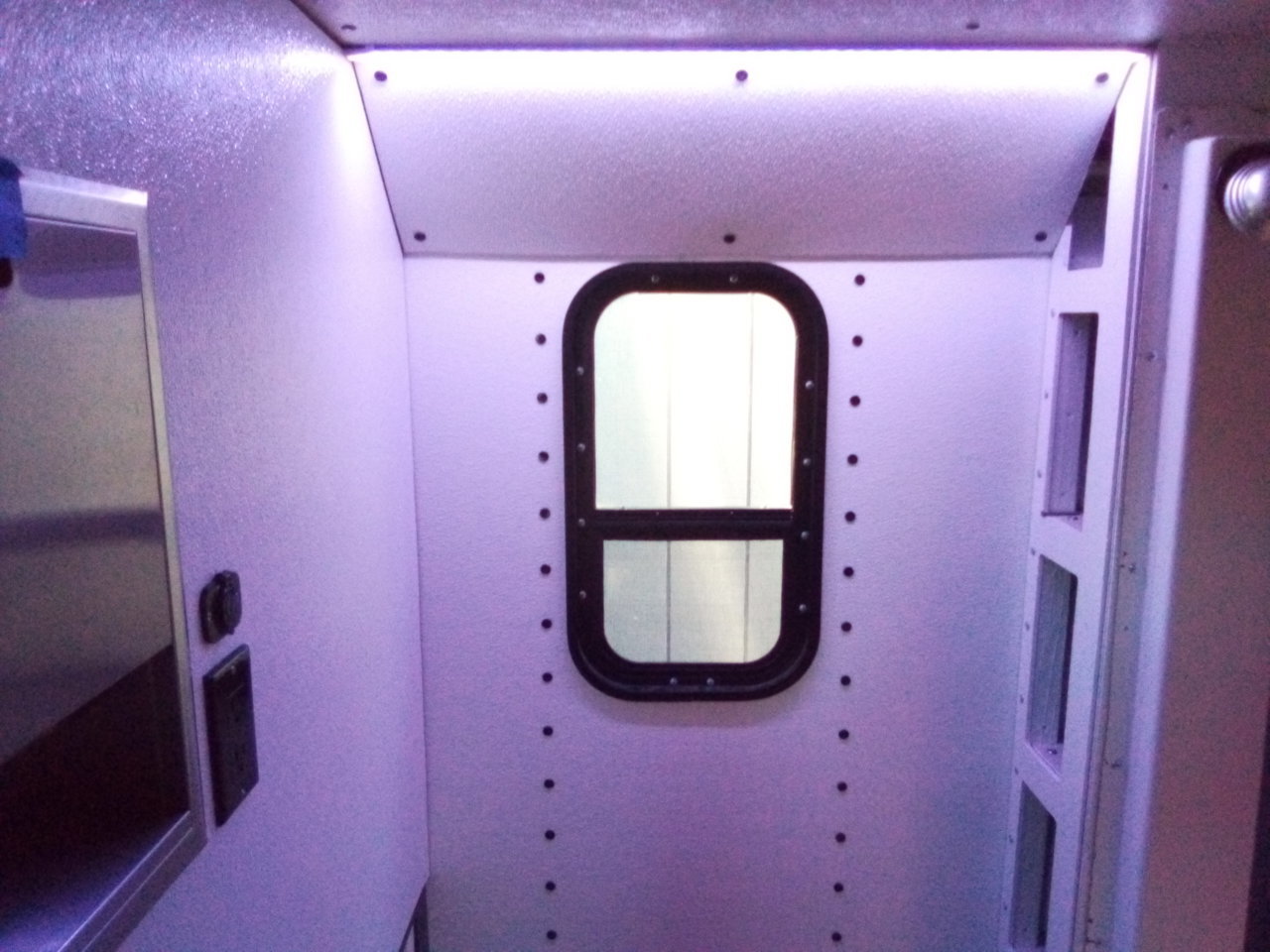

    Cut a hole in the kitchen wall, then put a window in it.
    Assembly is too thick for my wall. So, I need to either find or make a flat interior trim ring. I used some 1/2" round foam to fill the gap and the compression of the foam keeps everything tight. Not the ideal setup, but it works.

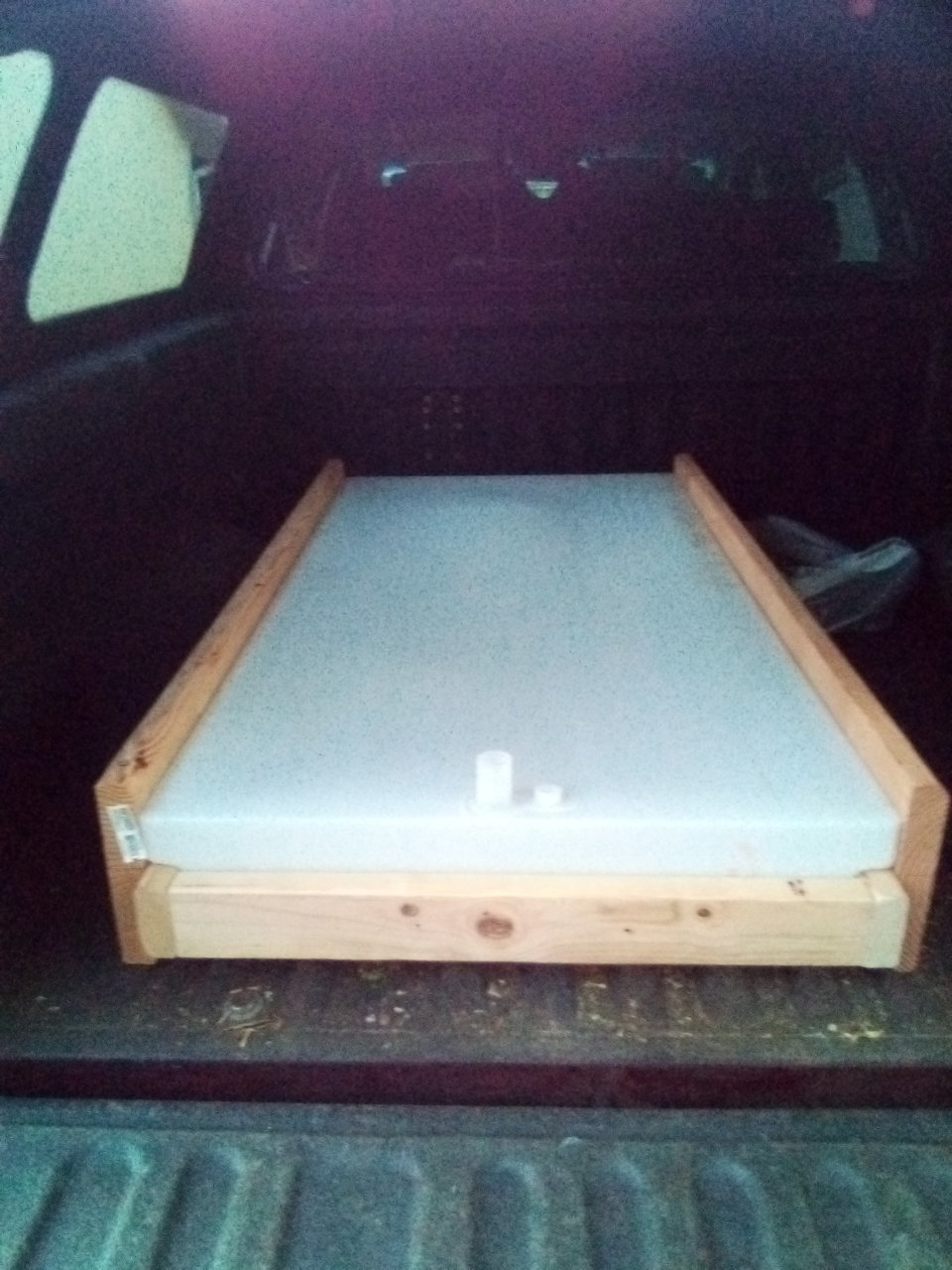

    Started working on the platform/tank rack. 44 gallon tank.

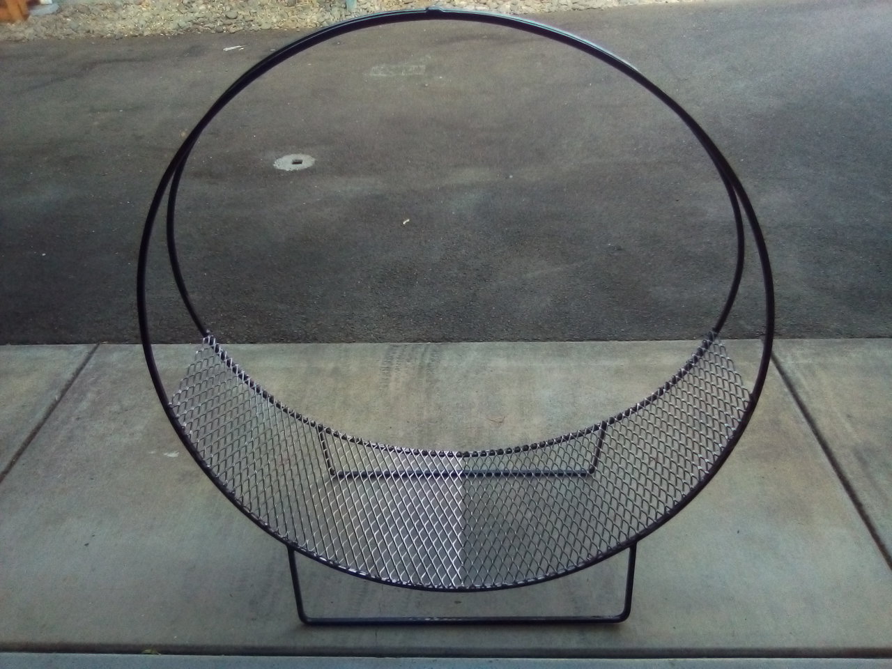

    Took the morning to rebuild the firewood rack. Used the leftover expanded steel from the tractor grill.

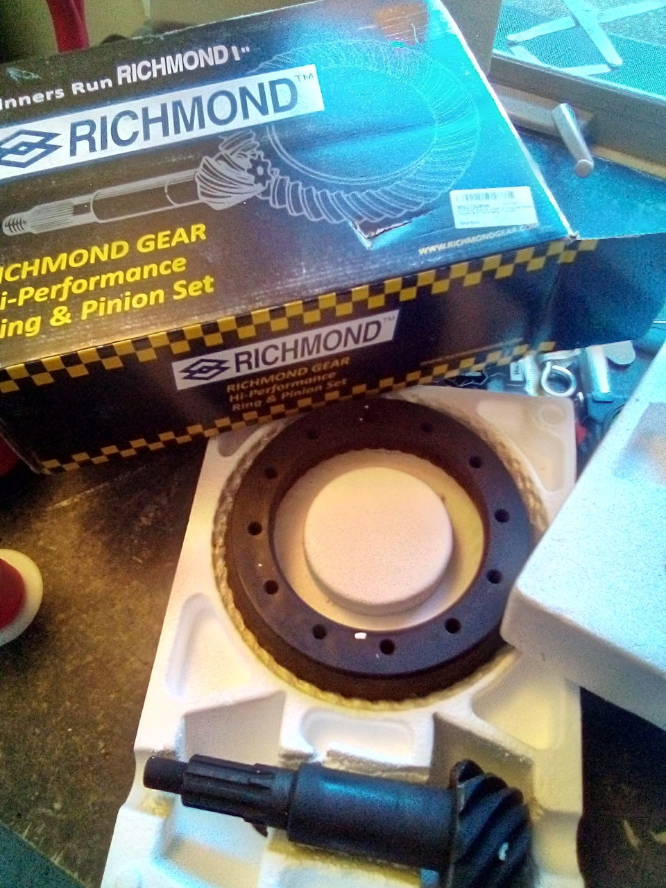

    Took the rear end out of the car today and dropped the housing off for sandblasting and powder coating (just black, nothing special. Will paint angry face on it in red). Pulled the third member apart and cleaned the carrier in gas after taking the spider gears out, now it is clean enough to handle with bare hands without gloves.
    Pulled the new pinion out of the box and started getting the new bearings and shims ready to take up to the shop to r&r.
    Everything looked good with all the Timken bearings being correct. Then, I checked the shims. Not good. The freaking pinion shims are undersized and one is rusty. Are you freaking kidding me. I spent $130 on this set and the shims are wrong?
    Yes, I could ream or file them out. But, I shouldn't have to fix Richmond parts to fit Richmond gears.
    I thought maybe my good deal on the gears was for a reason. Nope, put calipers on the pinion shaft where the shims go and it was dead on where it should be. I'm calling Summit in the morning to get the return shipping fee waived and I will order from Cass (DoctorDiff).
