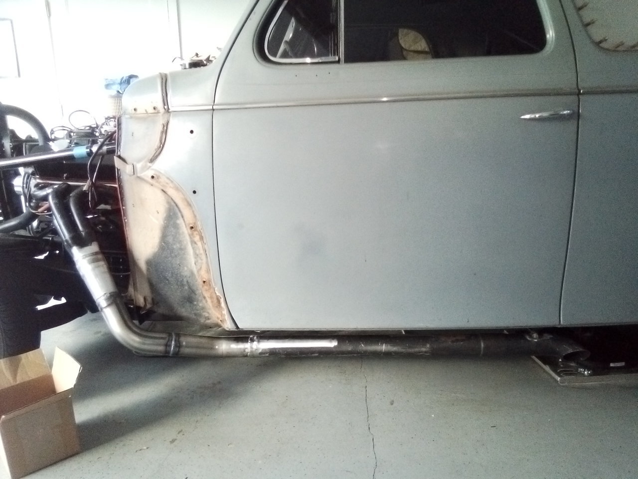

    Exhaust. Still have some work to do before it is "finished" but I didn't want to get it coated before I build the brackets for the running boards because I will be welding some pieces in place.
    After the running board brackets are done, I will be getting the exhaust blasted and ceramic coated.

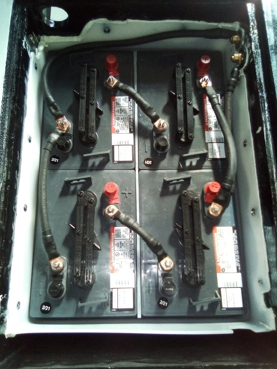

    Used the break in rain to do some work. Got the batteries installed and wired up, and put the first solar panel on. The first panel is on a tilt mount so I can aim it out of the entrance of my covered parking spot to get good afternoon sun. I'm not going to install the other two up top until it warms up and I paint the roof.

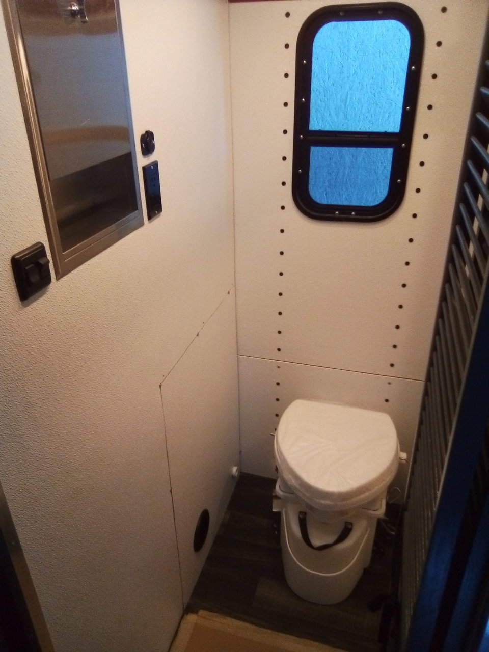

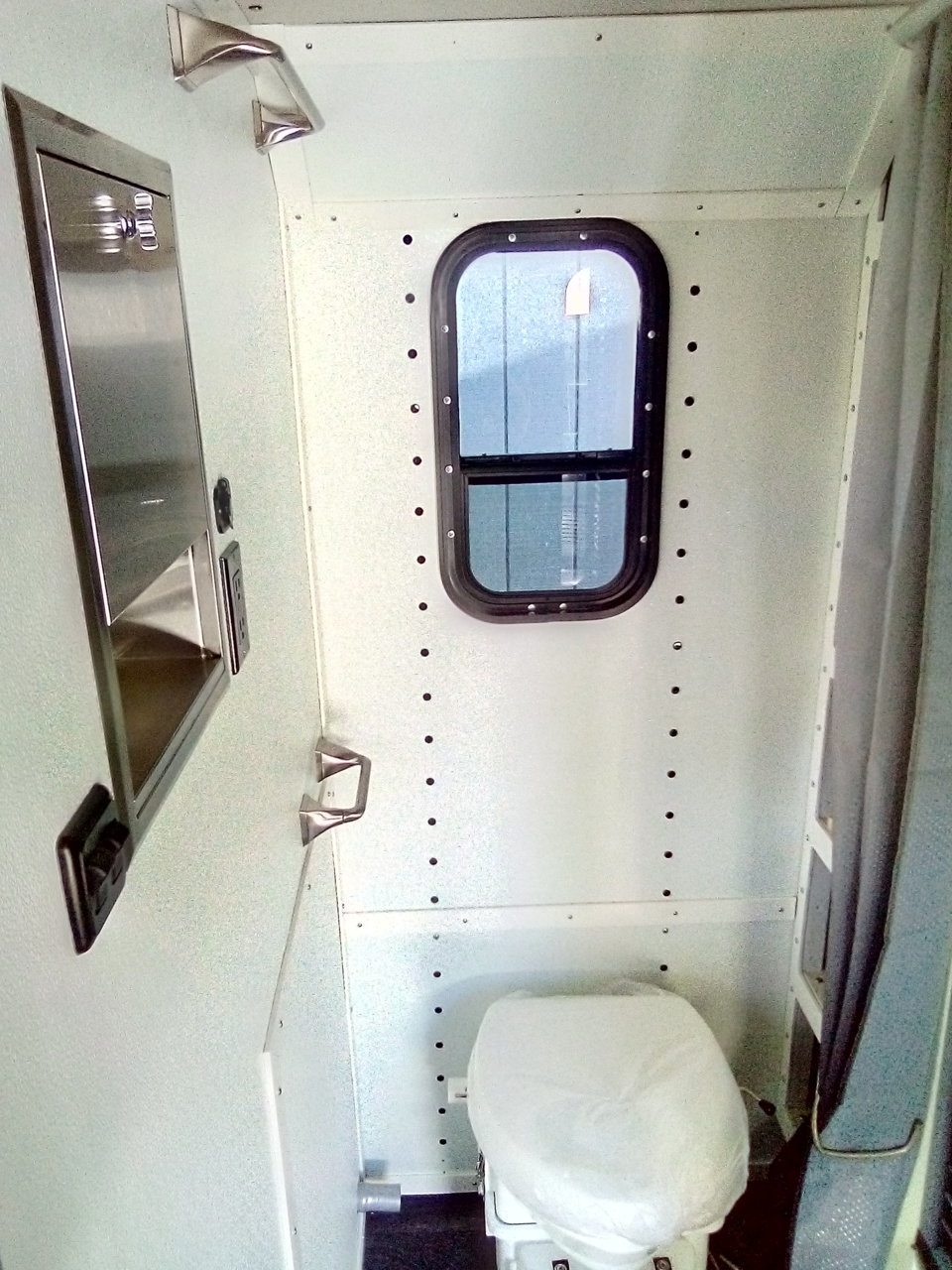

    I finished up the cutting on the access panel in the bathroom. Just need to get the aluminum flat stock to trim it. Unlike the vents in the main area, I left the flaps in the one in the bathroom to be able to reduce the airflow coming from the heater. If I left it fully open, I think it would get uncomfortably warm in there.

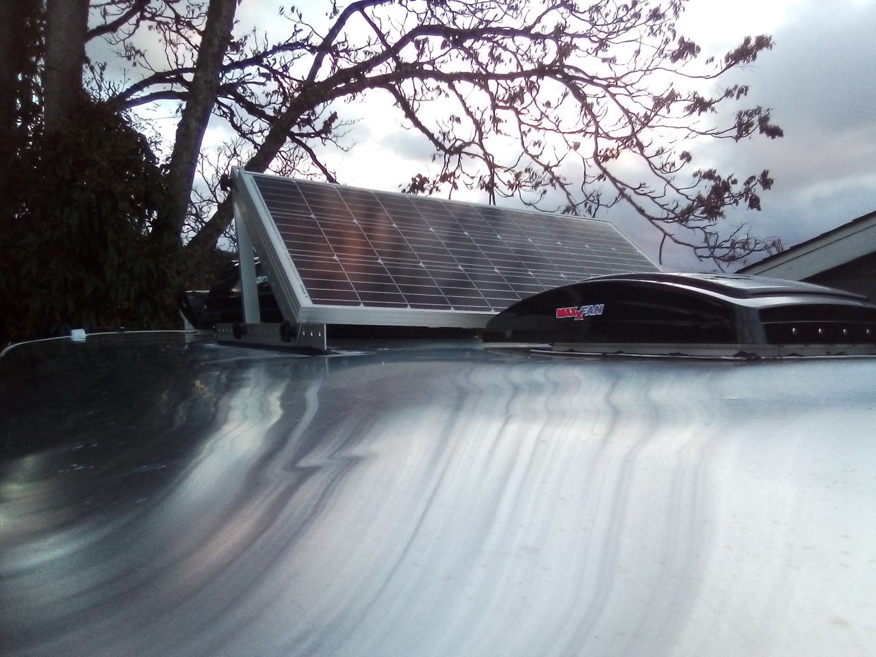

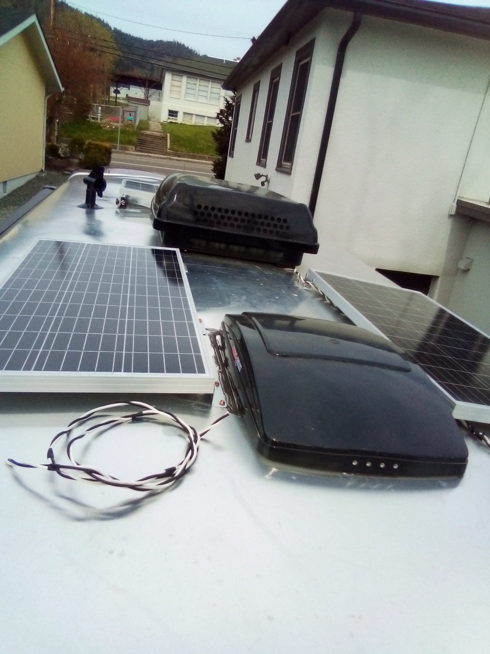

    Two more 100w panels on top. Not permanently mounted yet because I plan to paint the roof with thermal paint and want to get under the panels. So, waiting for a couple 70*+ days to remove the two panels then sand and paint the roof.

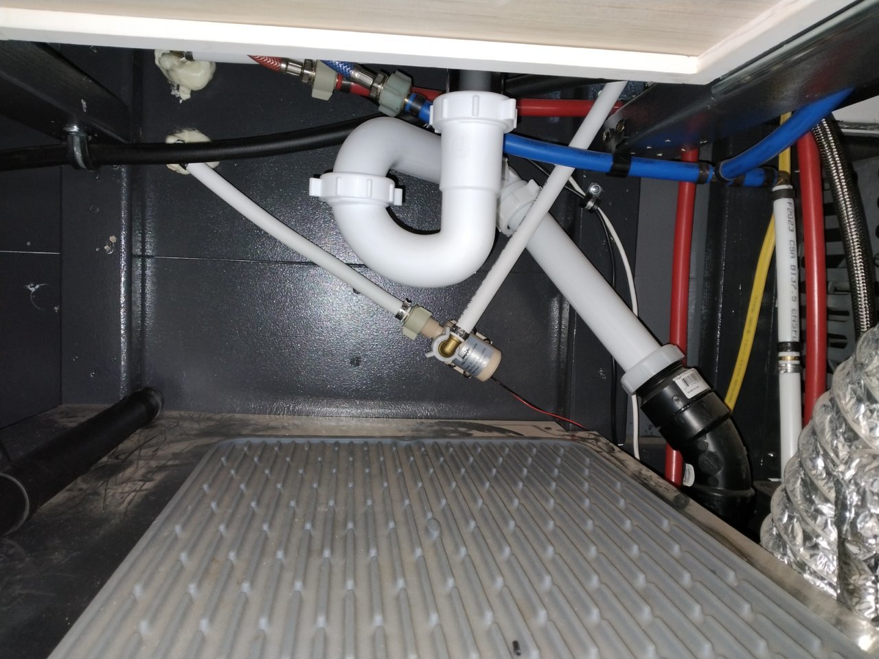

    Next for today is checking all the water connections and hooking up to city water to check for leaks.
    Once it is confirmed to not have any leaks, the trailer is liveable with only trim work/cabinet doors/drawers needed inside.

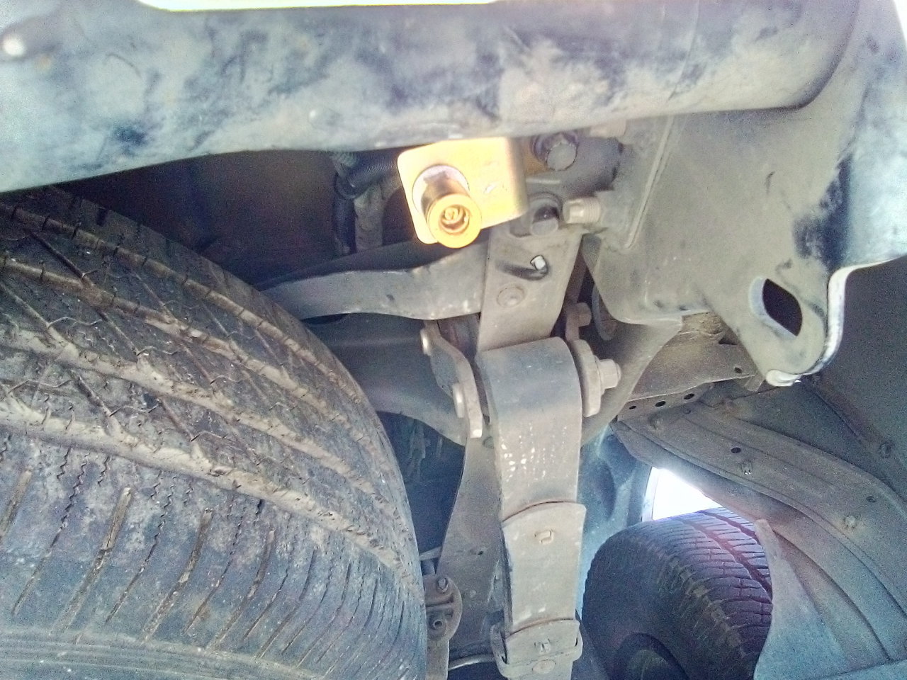

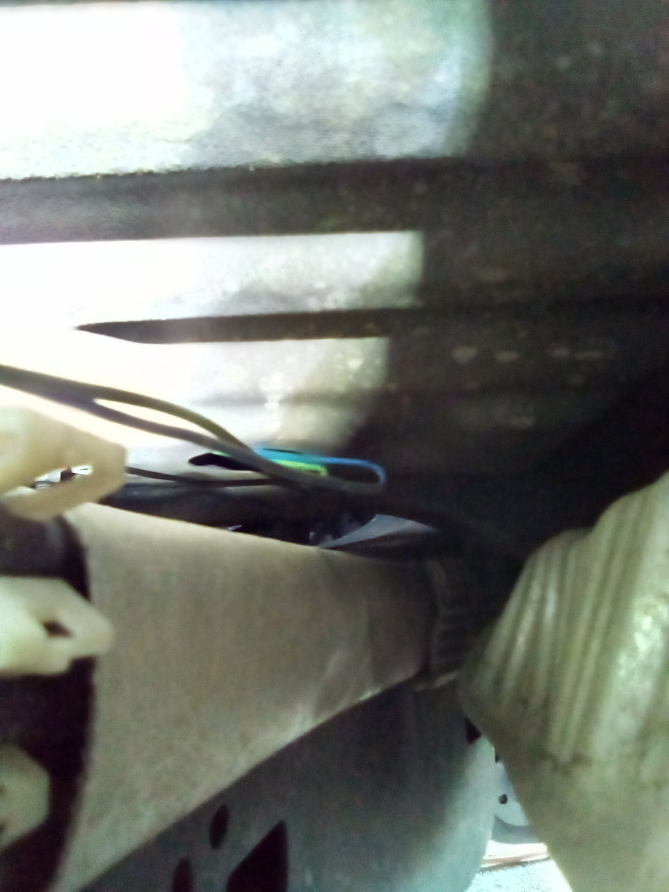

    Worked on my OBA for the truck today. When running the power wire for the air bag self leveling kit, I found that the jackass who put the canopy on ran the wires through the hole then put the body plug back in. Nothing like pinching a pair of wires against a sheet metal edge. So, I cut a hole in the body plug and re-ran the wires through the plug.
    Tomorrow, I need to wire in the compressor (and put a heat shield on it), and wire in the 28" air horn. Then, my OBA will be complete with air horn, self leveling bags, and a quick disconnect for an air hose hidden up behind the rear bumper.

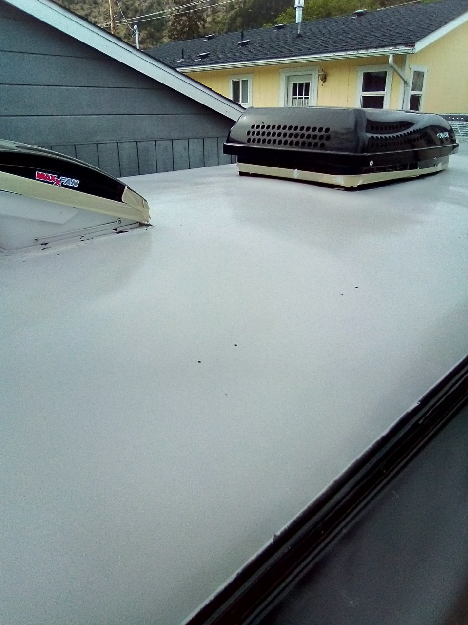

    Painted the roof white and started the trim work in the bathroom. Just waiting on a piece of vent hose for the toilet to get here, then it's ready to go. I just applied for an on site watchman for a logging company. Start on the June 1.

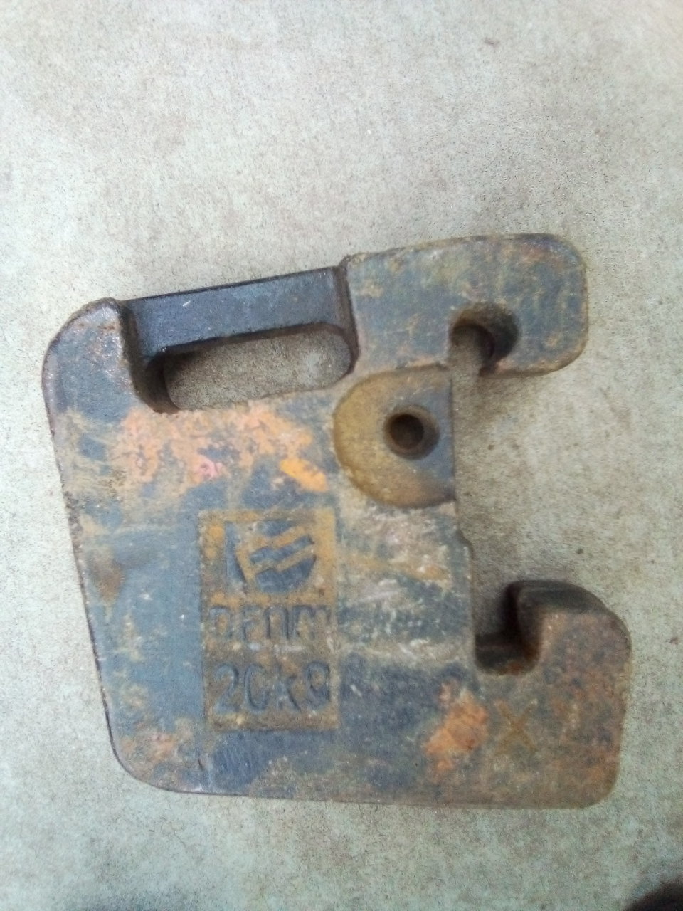

    Picked up 4 of these 20kg suitcase weights today for $50. It was a price that I could not pass on for weights for my tractor. They fit perfectly on my rear blade frame, just need to get 2 pieces is 4x6x1/2 steel plate to bolt to the frame to lock them in place.
    Not going to get to work on it again until there is a fire and my employer pulls me off the landing, or I spend a couple hours of my downtime offsite and bring my tractor up to the landing to work on it.

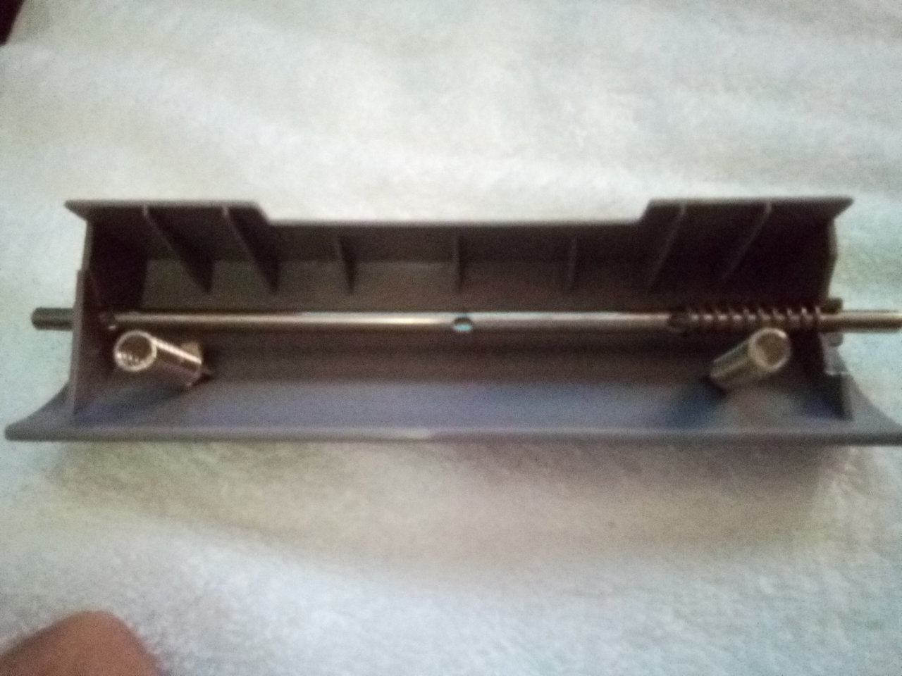

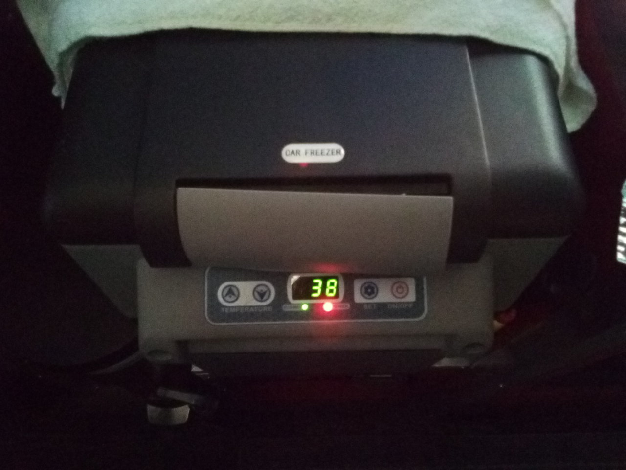

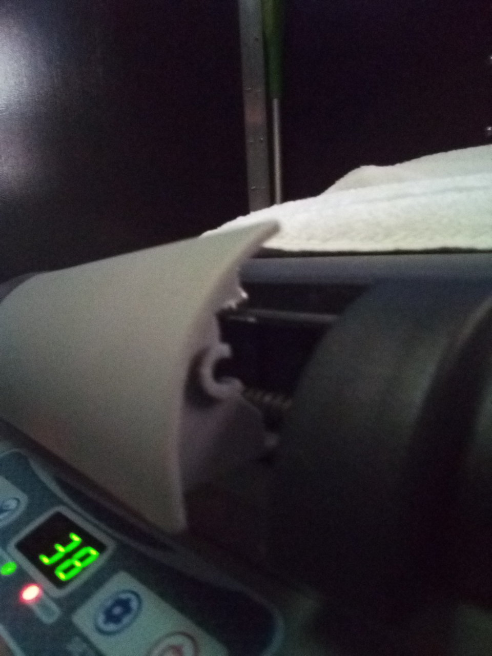

    Crap. Day 23 and my fridge broke.... Thin plastic on the handle where the shaft goes through.

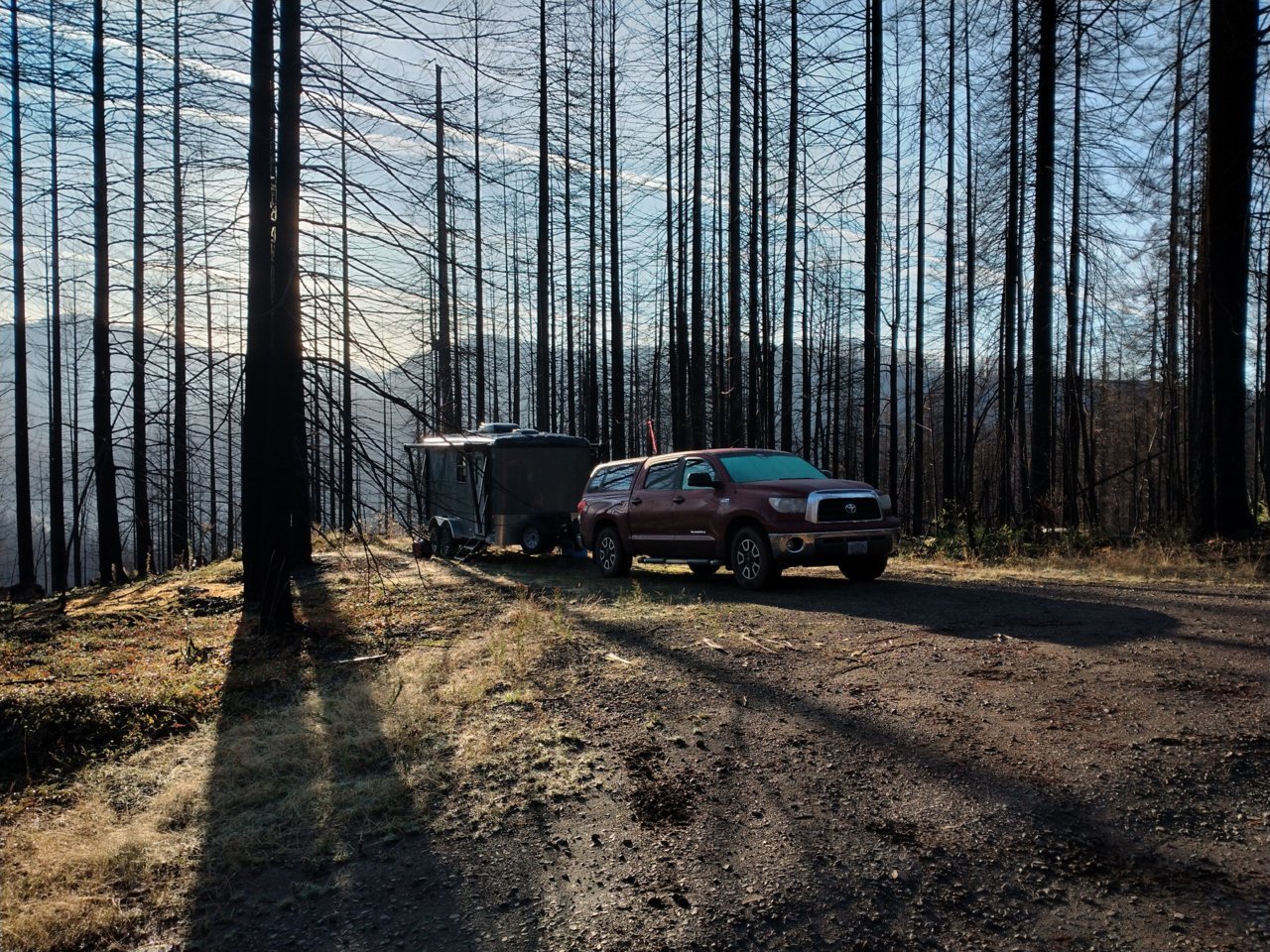

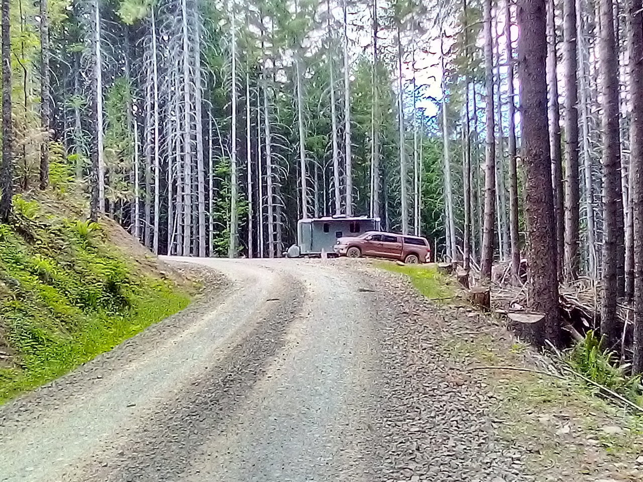

    On to site #3. Lots of burned trees. Unfortunately, they have me sitting in a spot with heavy tree coverage to the south. So, even when it isn't raining, I get crap solar. Once they clear out a spot up on the site (a mile away up a well travelled blm road), I am going to see about moving up to a clearing.

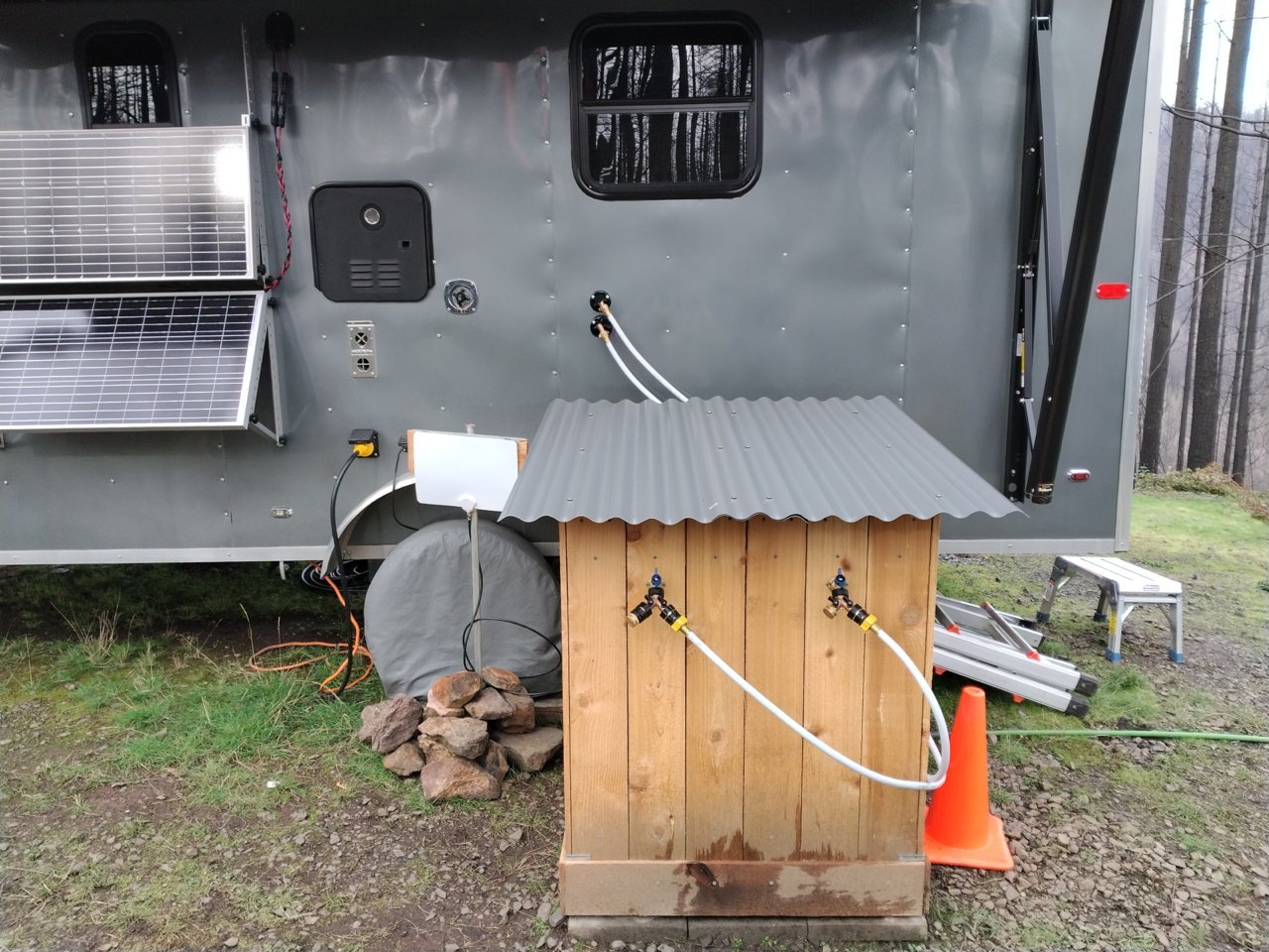

    Added spigots and y blocks to the side of the box. This way, I dont have to switch lines around when I want to fill the tank vs running the recirulating pump vs transferring water to the trailer. Will only need to connect one hose to fill or transfer water. Using quick disconnects on hose fittings also.

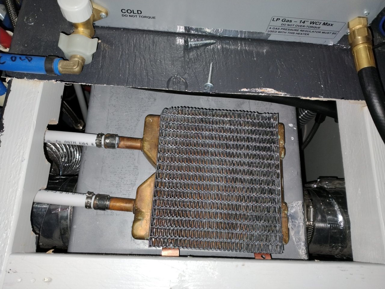

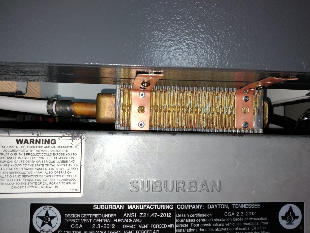

    I now have a functioning recirculating water warming setup. I'll pick up some foam to insulate the hoses next week.

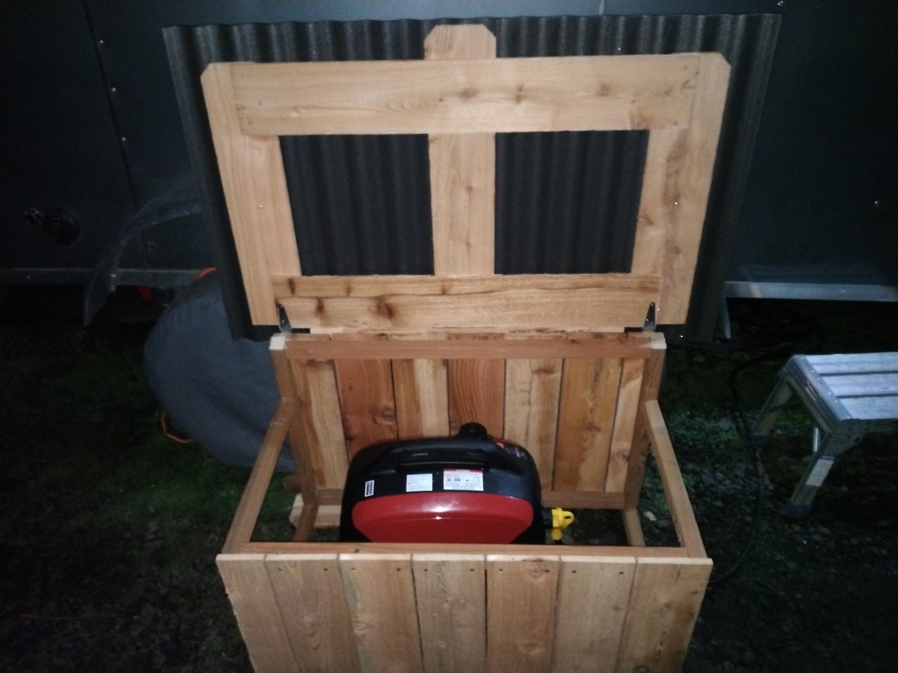

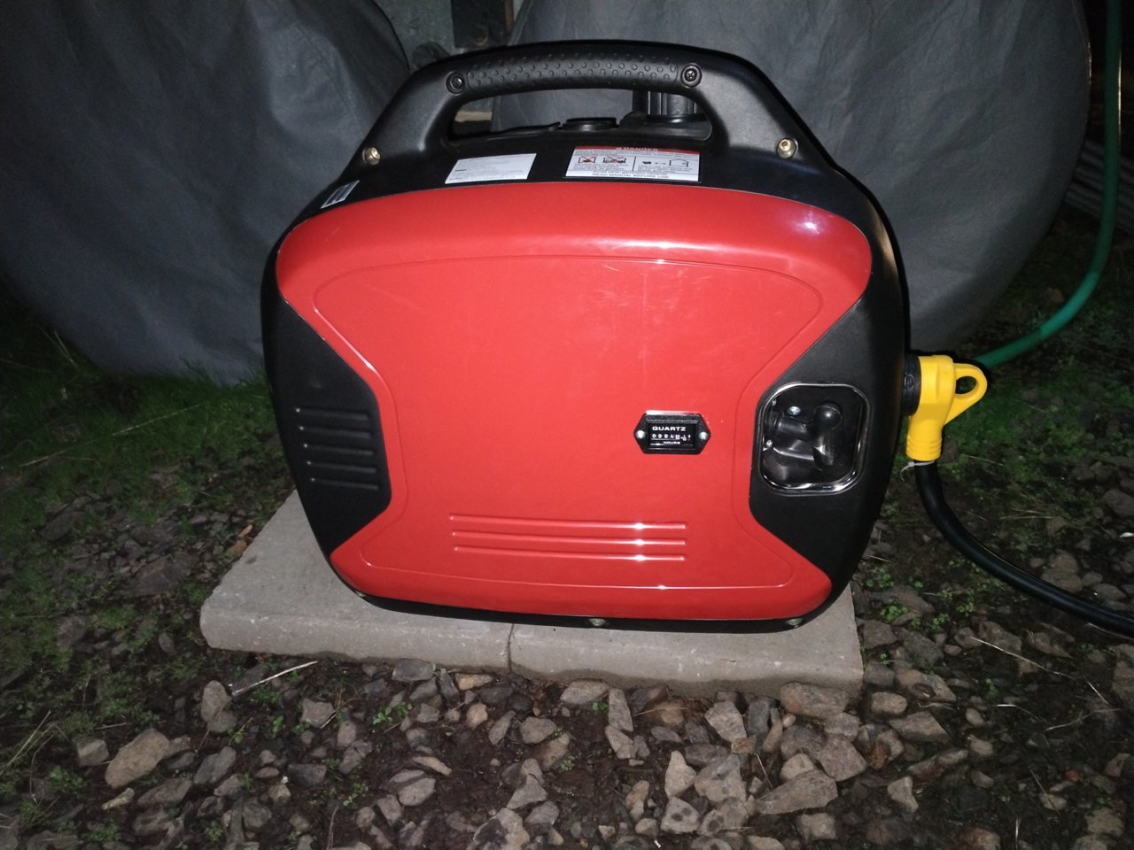

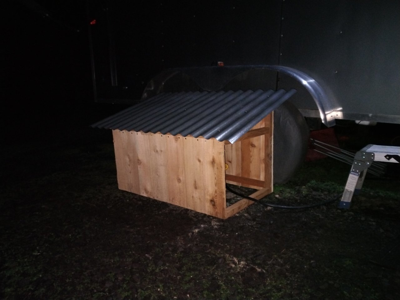

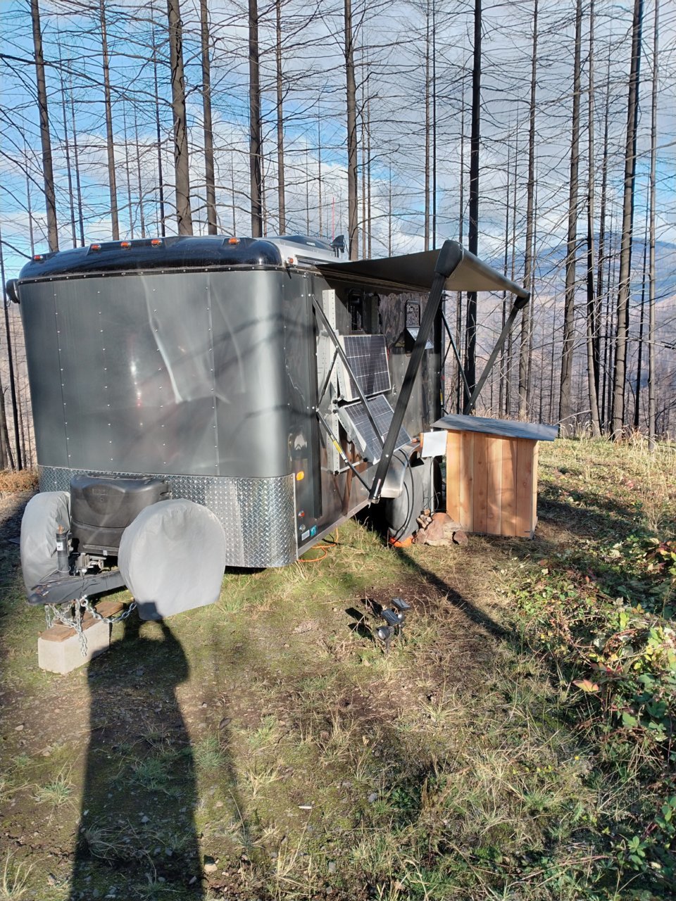

    So, with the little bit of freezing rain and snow we got, I remembered that I hated clearing snow off of awnings (owned a 33ft class A before I went into the army).

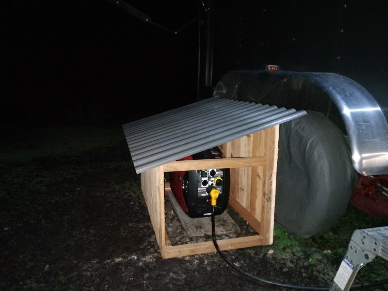

    I decided that I wanted to have my generator covered but be able to have the awning in. So I built a cover.
    No rain or snow getting on it, easy to access, easy to start with the lid closed.
