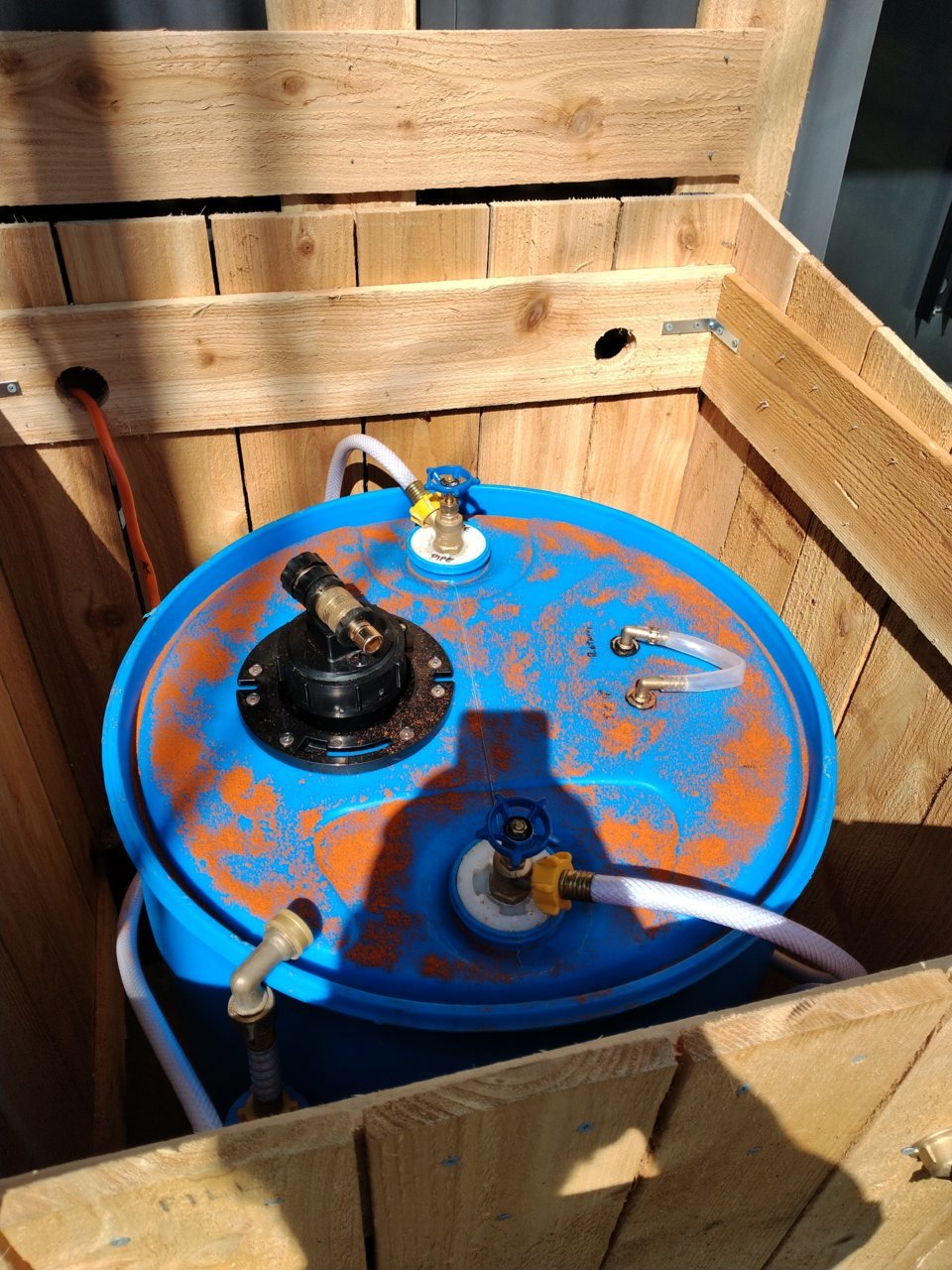

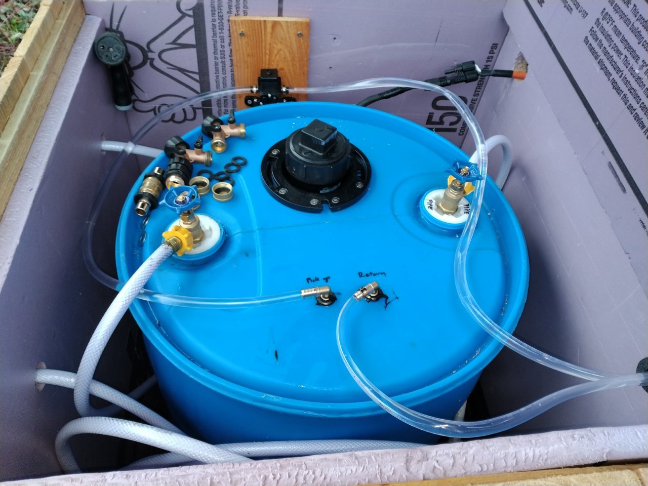

    Modified the water tank and moved the circulation pump outside because the damn thing is louder than my main water pump. Put in the flange so I can easily top it off from my 5gal cans.
    Got this done today, because they are saying we are about to get smacked with cold and snow this weekend, with potential for record low.

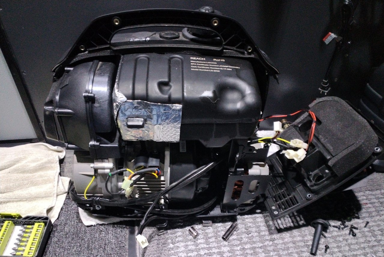

    Today's WTF moment for me. Went to start my generator and the pull cord snapped. Come to find out, the Chinaman who assembled it stripped one of the molded nuts while installing the pull cable assembly and it wouldn't come off the flywheel housing. In order to get it off, I had to strip it all the way down, as the flywheel housing is held on by both the gas tank and carb. All this in a 2'x3' section that I call my hallway as I sat on the bathroom floor. Would have taken it outside, but it was already dark and raining.
    To top it off, I don't have the right size hex key with me to take the side covers off. I did have a piece of 3/8" round stock and a file, so I make my own hex key.

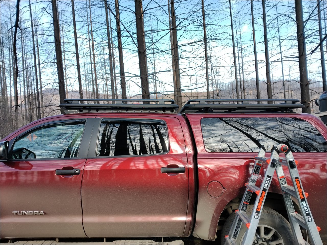

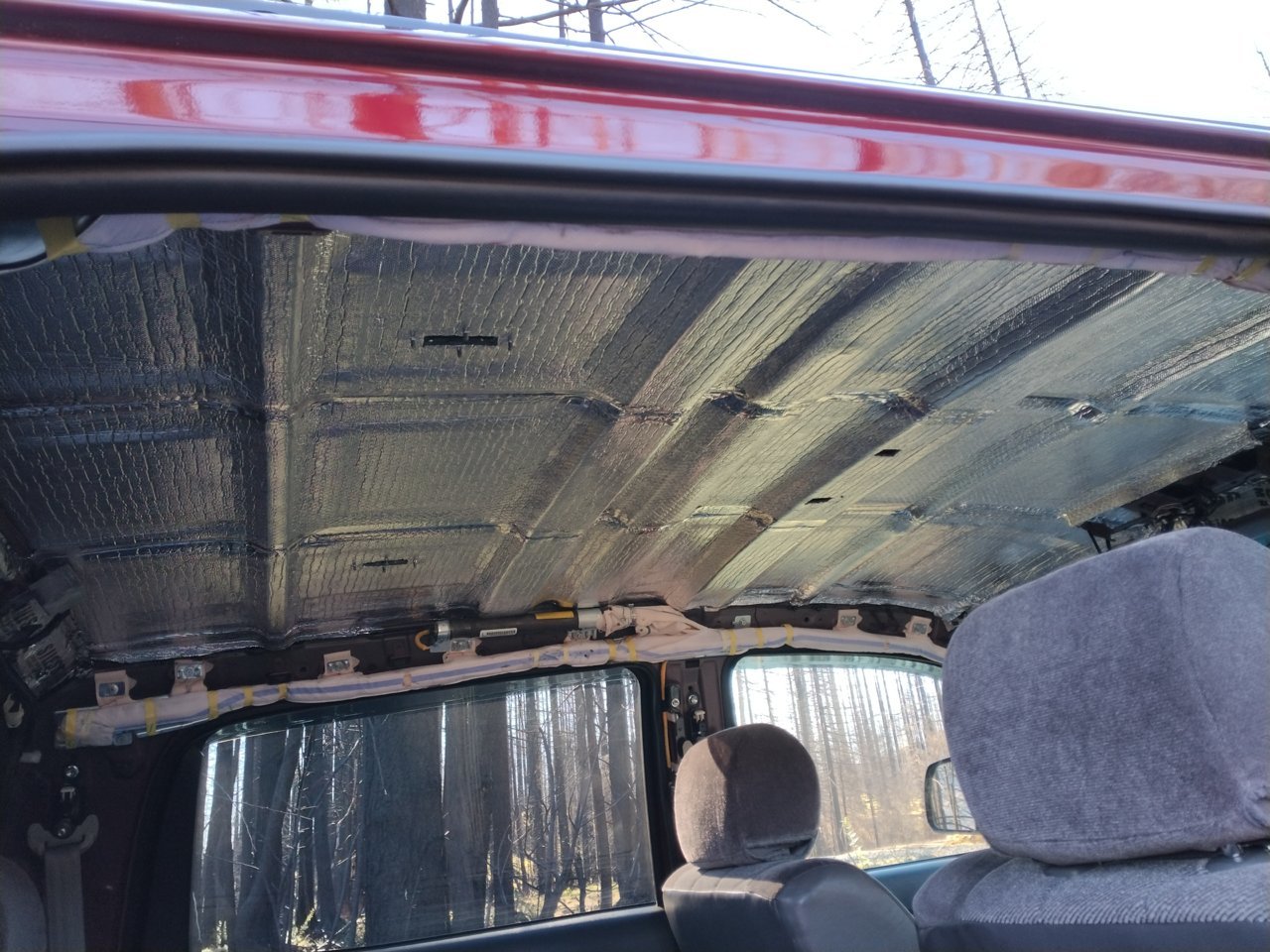

    Oh, and I put roof racks and platforms on top of the truck, along with some sound deadener.

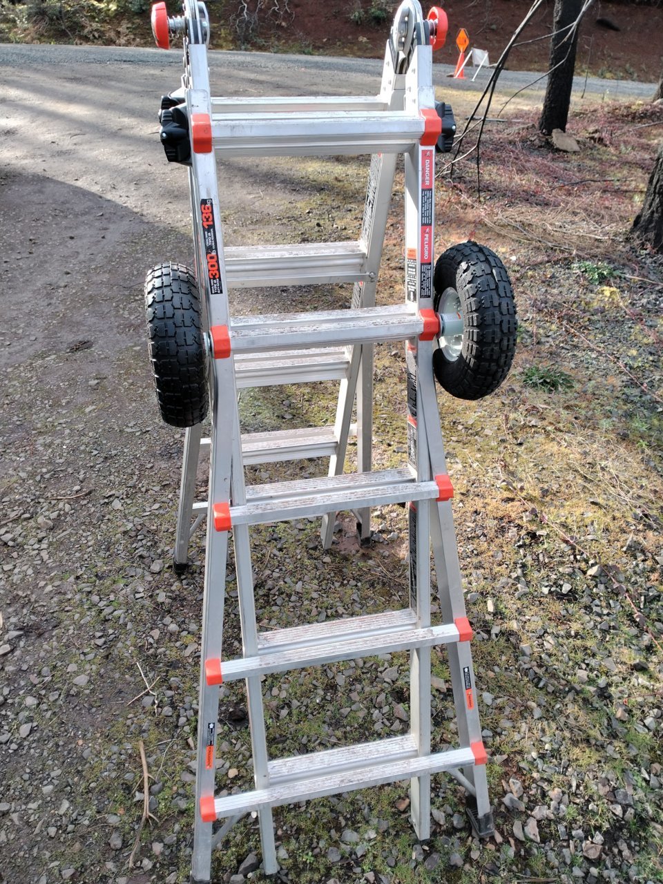

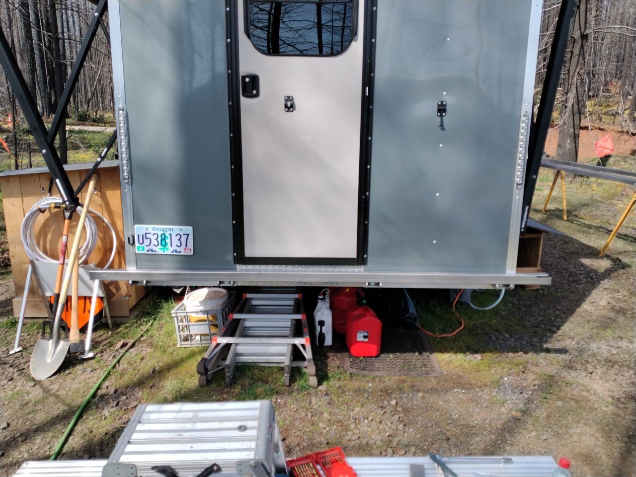

    Got tired of crawling under the trailer to put the ladder away or get it out. So, the ladder got tired.

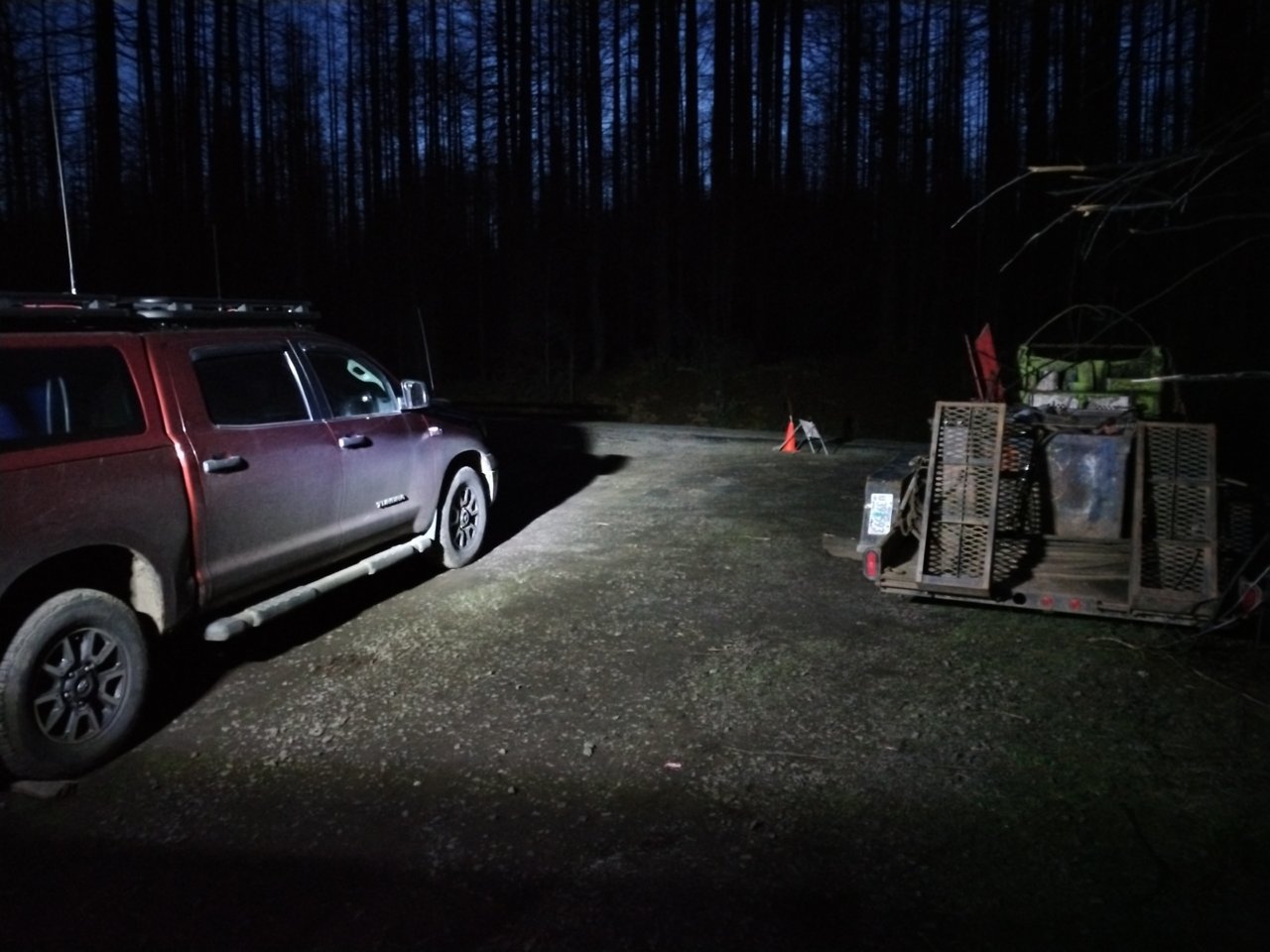

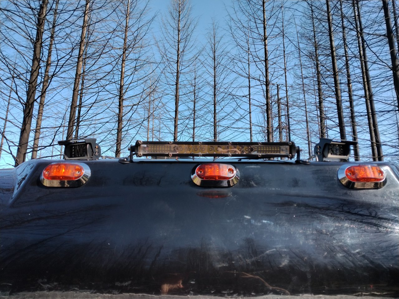

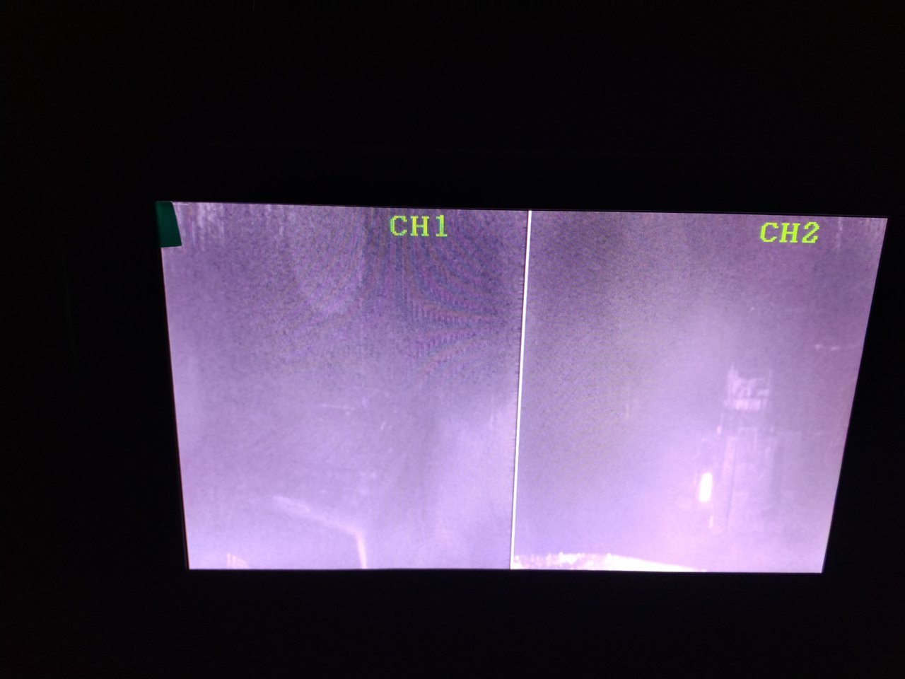

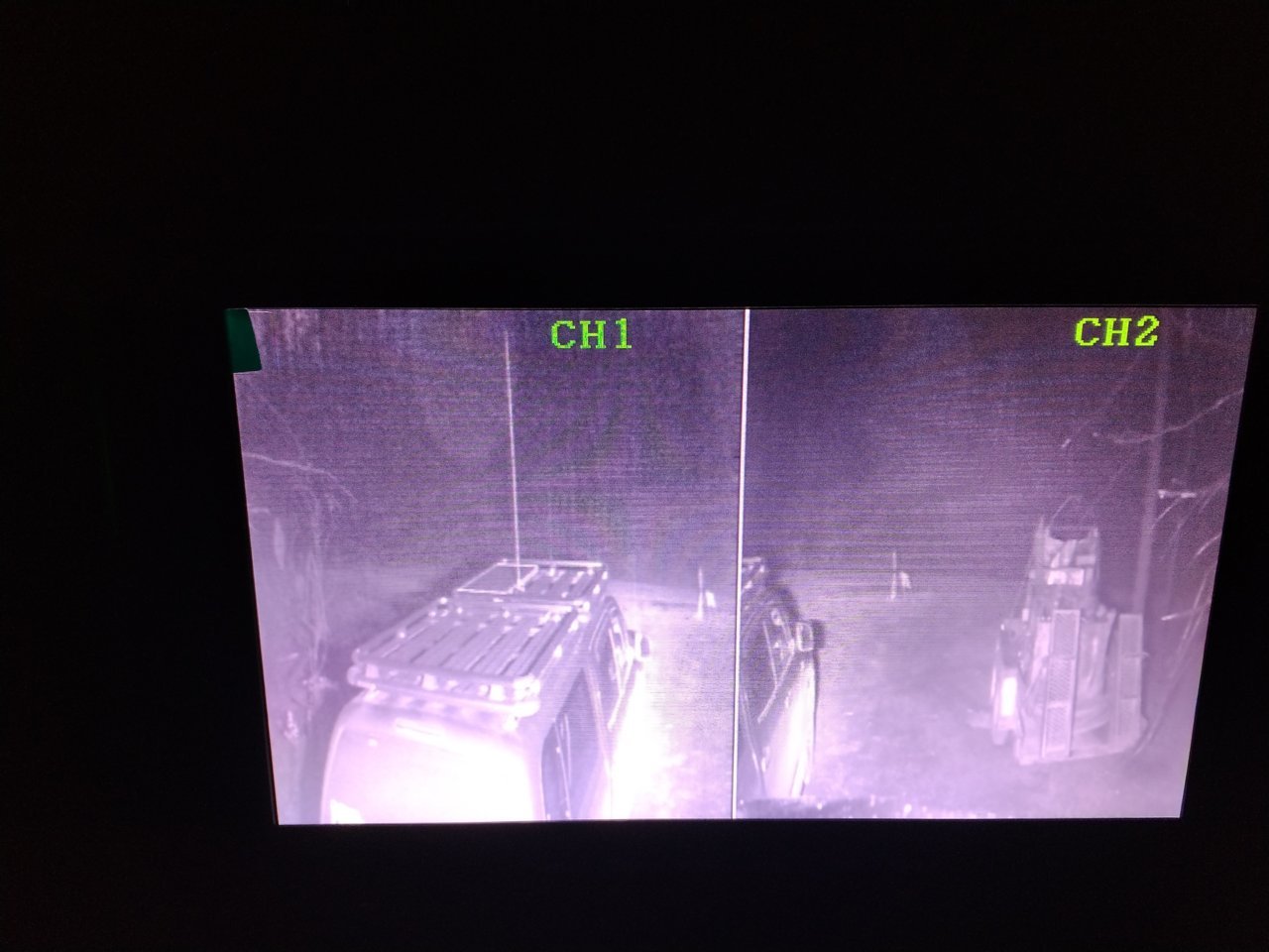

    Got tired of having a blind spot to the front of the trailer at night. No longer......

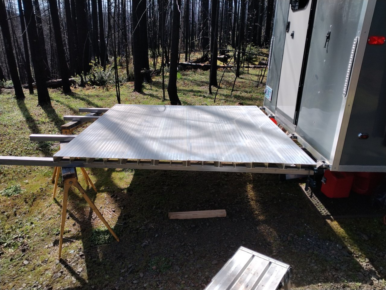

    Started mock up. Got hinges bolted to the trailer and notched the 2" tubing for the hinge arms. Gotta let it get dark so I can use my laser level to get the tubing square to the trailer. Going to cut both ends off the platforms to make them even and get rid of the buggered up holes from the manufacturer.
    I'll take the tubing to town with me next week to weld the hinge arms in place. I'll eventually take all the steel parts for sandblasting. Gotta decide if I want to get them powder coated after or just use POR15.

    I decided that with all the bracing built into the platforms, I don't need to add additional steel bracing. Other than the hinges being welded to the square tubing, it is all bolt together. I drilled and tapped 1/4-20 holes in the square tubing to attach the platforms. This way, I can fairly easily replace one if needed.
    I need to cut the sides of the platforms even with the sides of the square tubing and and decide if I want to remount the license plate and light or just cut a hole since it will be at the front corner. If I cut a hole, I might build a access door for it so it is covered when down and I could put a cooler or something under it.
    I'll take the steel to get sand blasted on my next trip down. I could only tack the hinges, generator wasn't strong enough to do a full weld, kept popping the overload breaker which made me have to shut down and restart the generator.

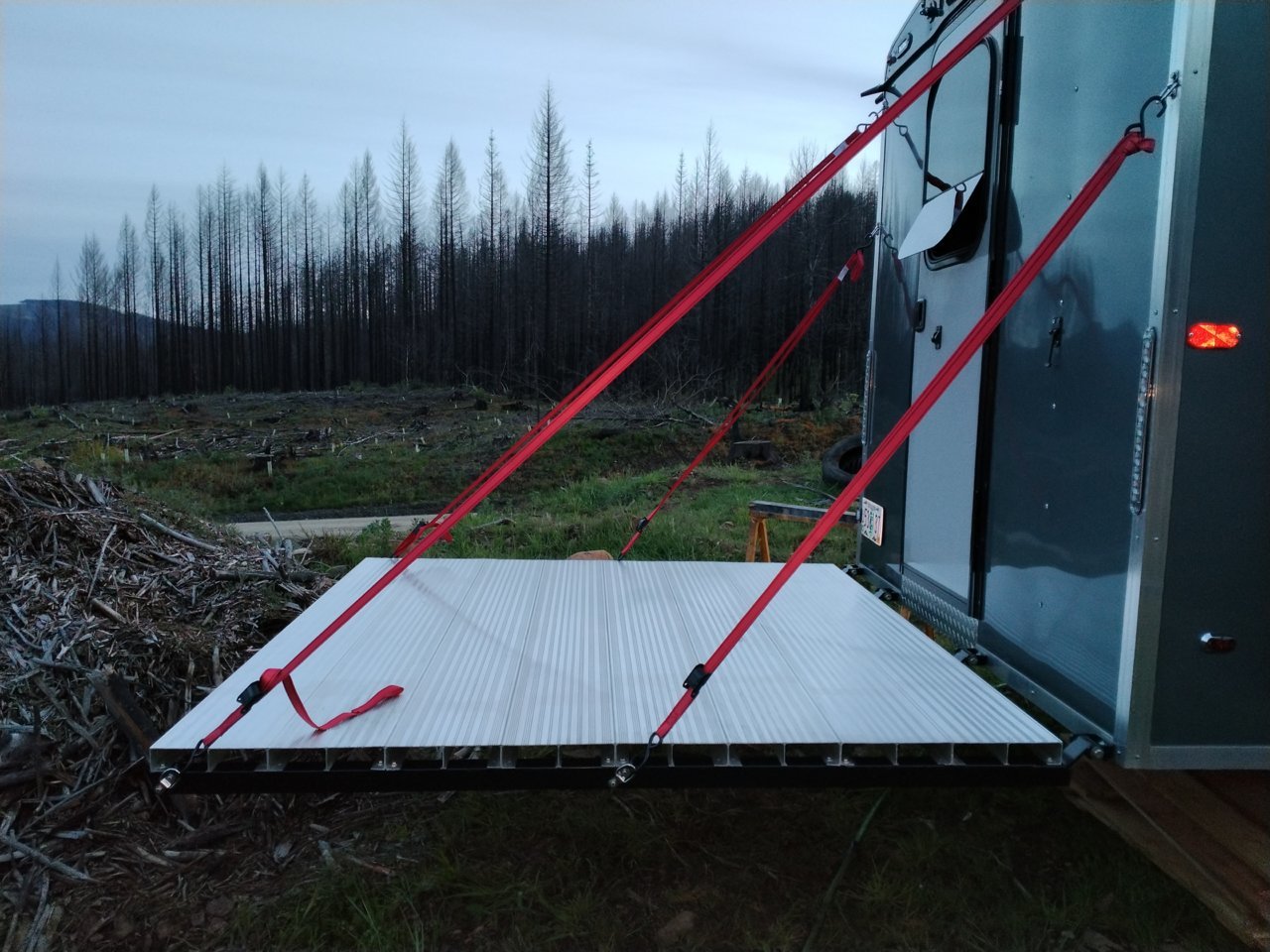

    Sandblaster/powder coating quality went downhill. I am done with that shop. They missed spots sandblasting which lead to poor adhesion, and spots. They didn't powder coat on the inside edge and there are spots of rusty metal showing in the spots that it didn't stick to. I've used this shop for years, but it had different guys there this time. Anyways, I'll pull it all off this summer to clean the missed spots for paint and run some paint or wax down the tubes (already have a schutz gun). For now, it'll be as it is. Before I take it off, I'll do the final marking on the platform edges to get the cut squared off before I trim it with aluminium angle.
    I got rid of the plastic bushings that came with the hinges. Reamed them out to be the correct size and installed oiled bronze bushings.

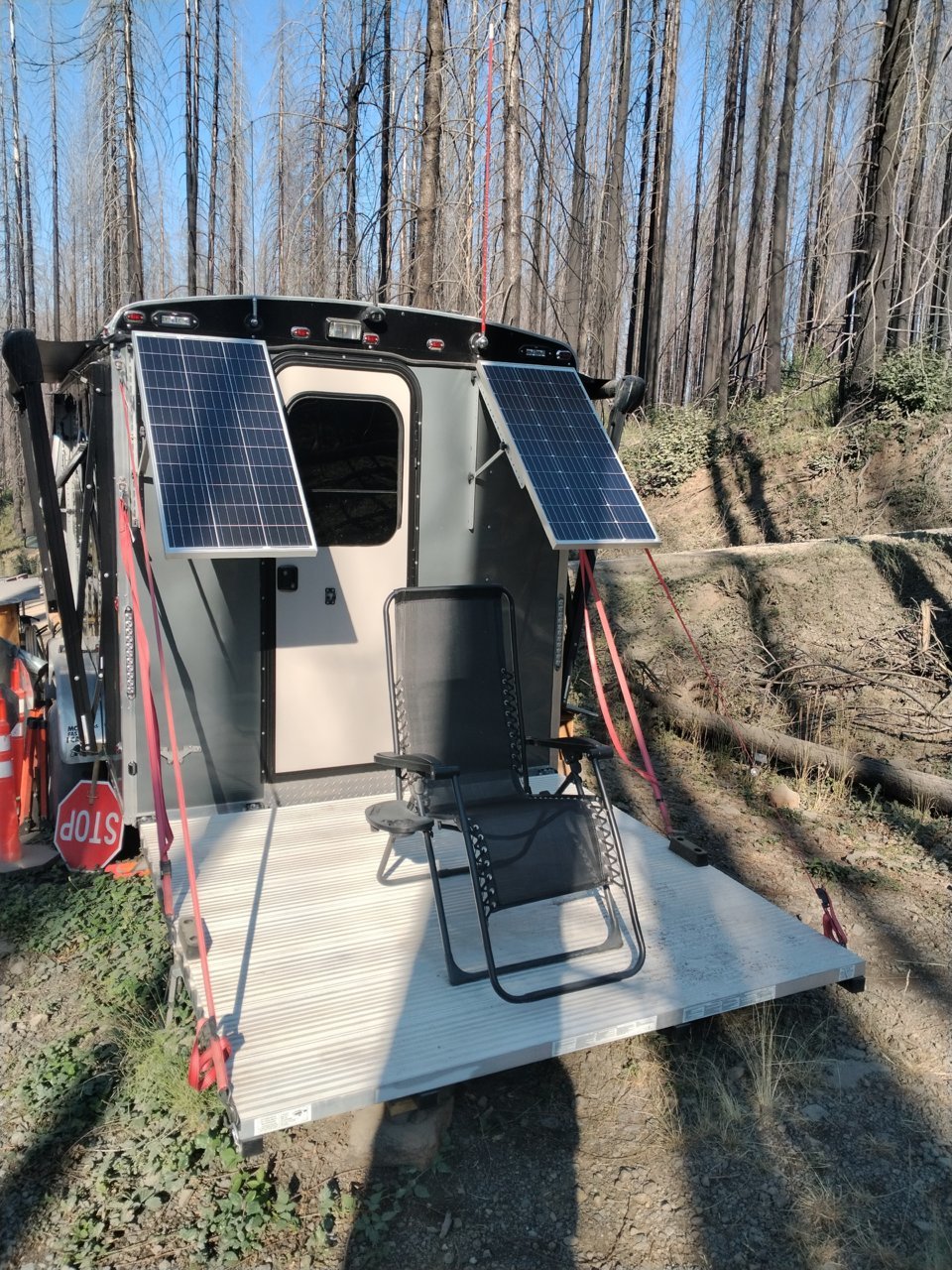

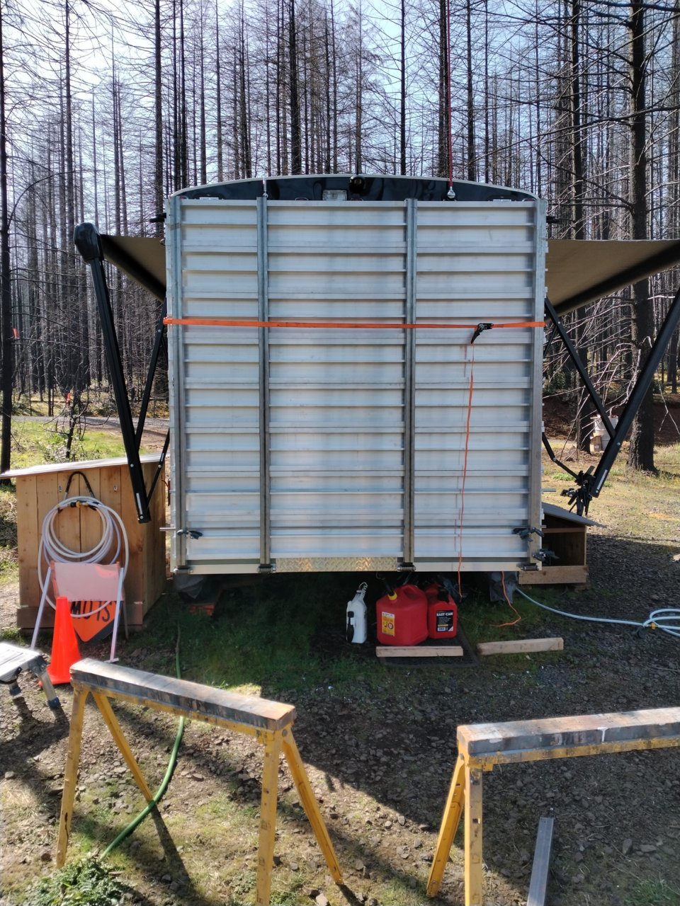

    Alrighty. So, the deck has proven to be a good investment in my mind. Gives a nice spot off the ground to relax. I was able to sit back there and watch the meteor shower, and use my spotting scope to look at the moon. I sweep it then wash it on Fridays to get all the dust off that the log trucks send all over the place. Then fri-sun night I have a clean place that I can walk around on wearing socks.
    I put two more panels on the back to take advantage of the angle of the road behind me. I also put truck dock bumpers on it to make sure it sits snugly against the back without hitting the panel mounts (panels get removed to raise it). The trailer got jacked up and put I out some jack stands under the axles along with additional supports under the frame. This way, my tires have been off the ground and it made the deck higher off the ground.
