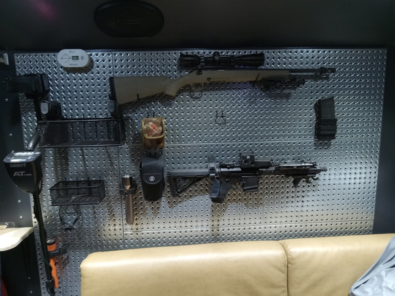

    I got some peg board panels mounted on the wall to hold some stuff. No, it doesn't get left in the trailer. All guns have spots to transport in the truck every time I am not at the trailer. The space between the rifles is designated for my 37mm and suppressors. 15-22 will get a mount below the SBR.

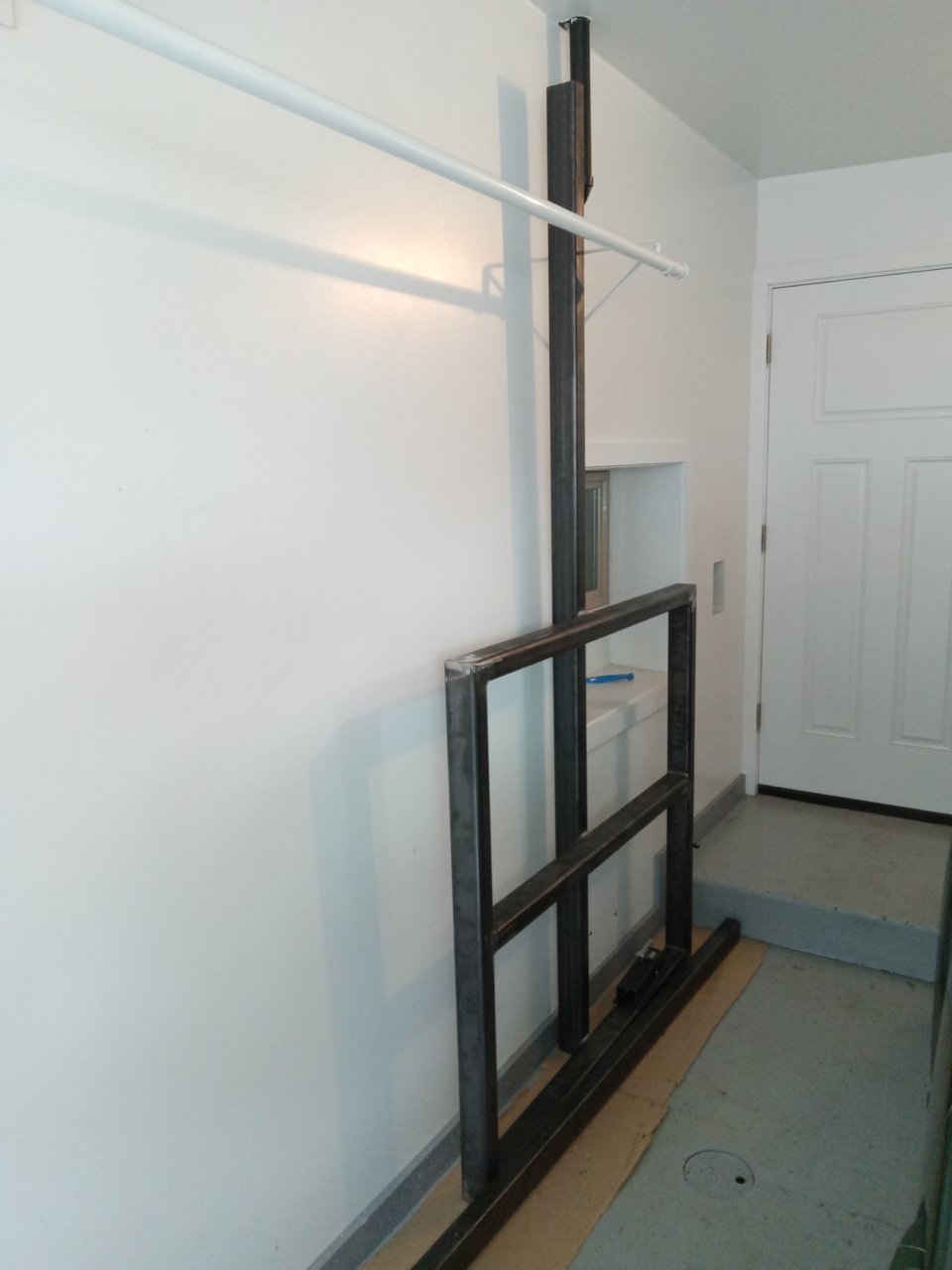

    Today is the start of my 2+ month break. Got the folder mocked up, currently welding on the brackets for the deck boards (using 2x10s). Have the hinge pin plate welded up, just need to weld the plate on as well as the plates that I have the pipes for the jacks. I'll put those pictures up after I get them on.
    Once I get all that stuff on, I'll put on the splitter/deck/engine/hydraulic tank/and some other stuff to get the center of balance figured out and adjust the axle location to get the tongue weight correct.

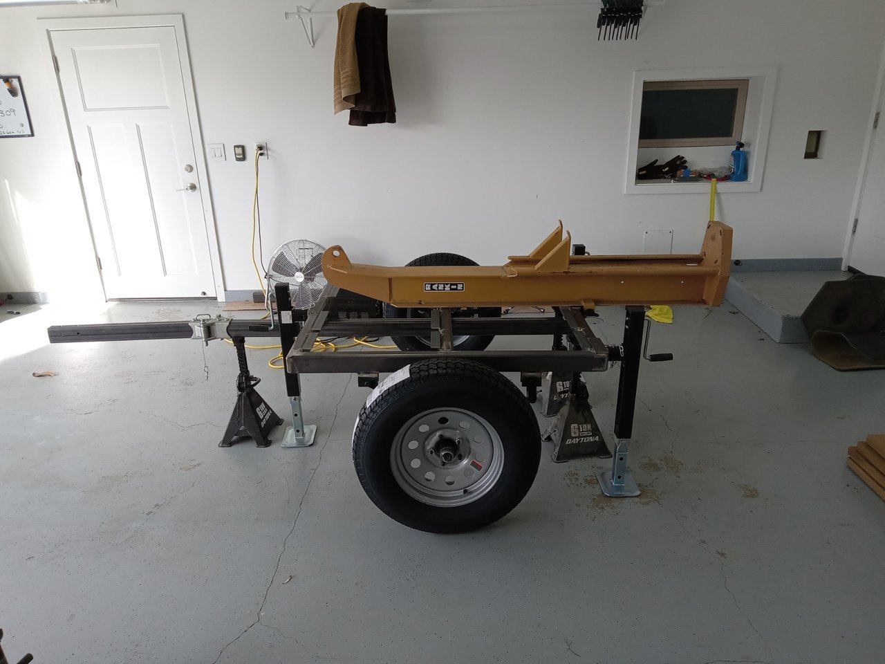

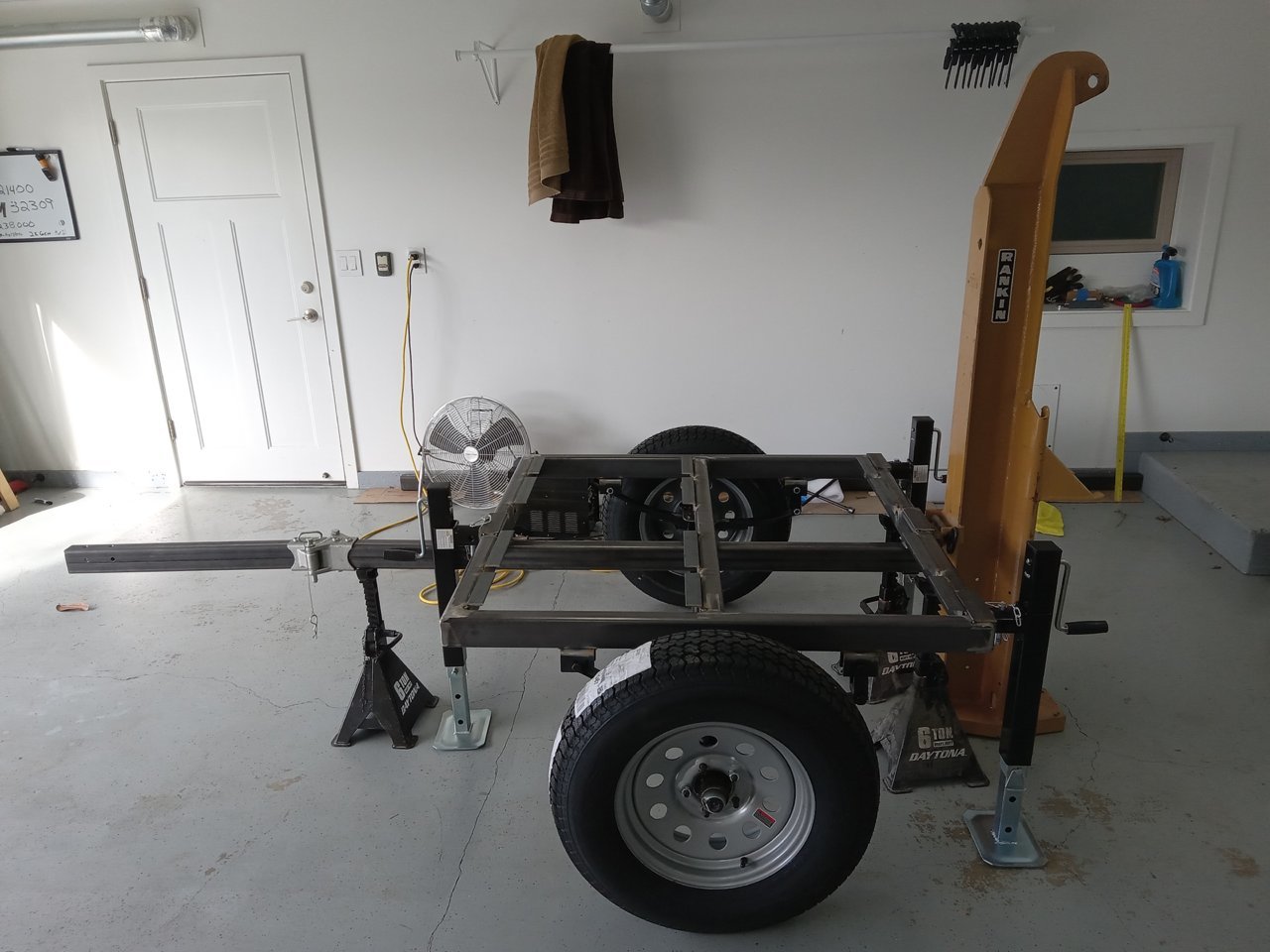

    Hangers tacked on to start getting weight/balance figured out. I have a 1000lb crane scale to help me out. Problem I found is that the perches on the axle are slightly offset from each other. So the hangers are dead on even, but the axle is slightly canted.
    I'll get a bolt with a larger head to replace the center pin. Then, I'll grind the head offset to allow it to shift to where I want it to be. That'll bring it even with how it needs to be. Waiting for UPS to drop off 5k rounds of 22LR, or I'd be down there right now working on it. Don't want them to say no one was home when delivery was attempted.
    One picture note, tongue hinge is not tightened down which is why it is sitting weird. Just wanted to show where it hinges. I'll also add an A frame from the front hangers to the back of the hinge to strengthen it.
    I'm using pipe weld jacks so I can pull them off and mount them to the deck for travel. By having the jacks, it can be leveled out and used without having to have it attached to the truck to prevent it from flipping.

    The canted axle isn't ganna matter a bit. It's not like this thing is gonna see thousands of miles a year.
    This gonna be the best built splitter frame west of the Mississippi.

    Yeah, I know, but it'll annoy the heck out of me seeing it off angle when the fenders are mounted. Not that hard to fix.

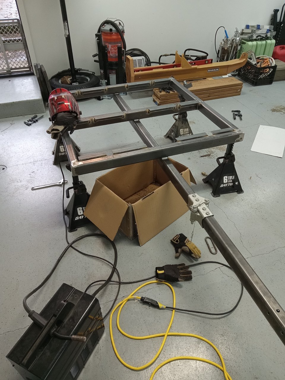

    Alright, got all the parts except the hoses and fenders. Set everything on the deck boards roughly where it will be and adjusted the location of the axles to get me 12% tongue weight. Got the hangers in their final position and made the A frame beams. Overkill, I know.
    I don't like using my 110 welder for chassis components, and don't have my 220 anymore. So, I'll take it back over to my buddy's shop and get it welded up with his welder. Sometime next week if there is a break in the rain.
    The angle iron is where the boards will be mounted using two 1/4" bolts at each support. I set them so the boards are 1/8" above the frame rails and with a 1" gap to help keep any water and debris from being held against the metal.
    I'm glad I used the pipe mount jacks. Made it nice to flip it over and have it elevated a bit to work on.
    Once it gets sandblasted and painted, I will use chassis sealant in all the open tube and make sure I get it to thoroughly coat the internal joints at the front of the A frame to help it last longer. I had thought about getting it galvanized.

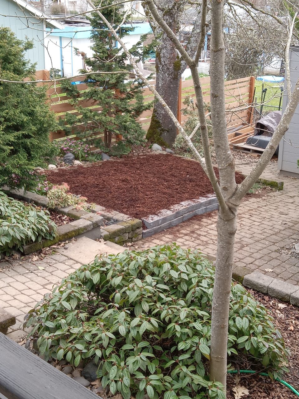

    House/dog sitting for my folks.
    Got tired of cleaning up the mud the dogs were tracking in from where there was once grass. So, I put down about a foot (2yd total) of medium fir bark. Need to get 8 more bricks to finish the edge then I'll dump the last wheelbarrow of bark down.
    I am going to have to pressure wash the deck, stairs, and walkway to get all the mud off. One of the few times my parents have actually pissed me off. They should and could have fixed the issue long ago. This will just be a temp fix.

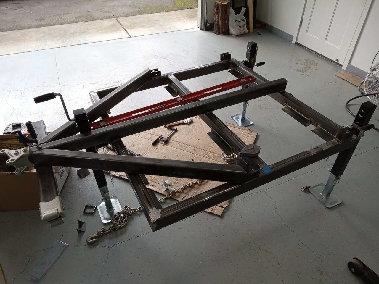

    Frame 97% welded (going to add filler plates on the back side of the A since the welder couldn't get in deep enough to weld the gap). Hangers fully welded. Tomorrow, I'll drill the holes for the deck boards and figure out how I want to do the wiring. Debating between running it along the side of the center beam with welded washers as hangers, or through the center beam and drill holes in the side to bring the wires out. Leaning more towards inside the beam.

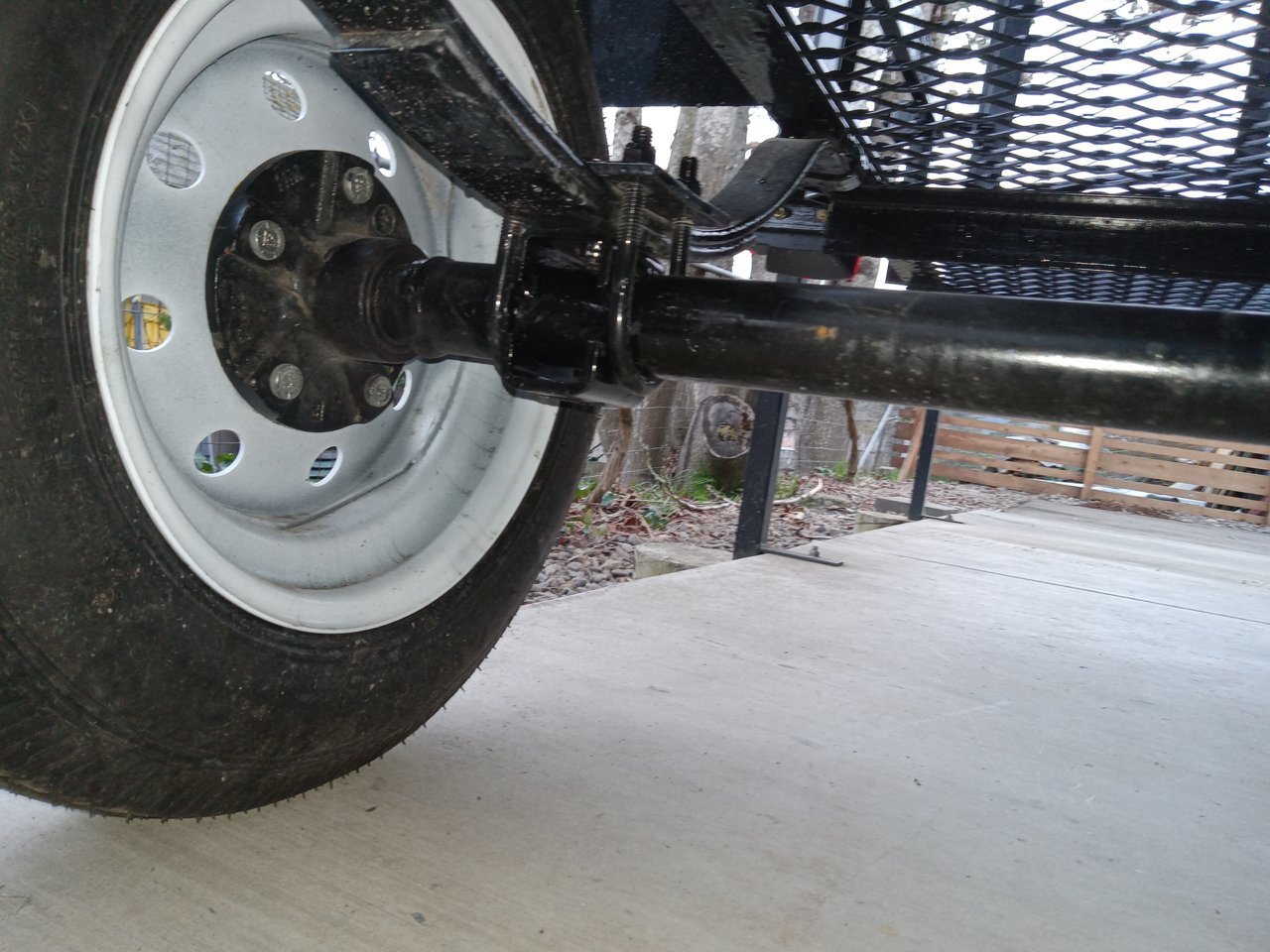

    Didn't like the tongue on my 5x8 (misc use) trailer being nose high when hooked to the truck with a 2" drop hitch. So, I did a spring over swap on it. I'll go up in wheel/tire size at some point.

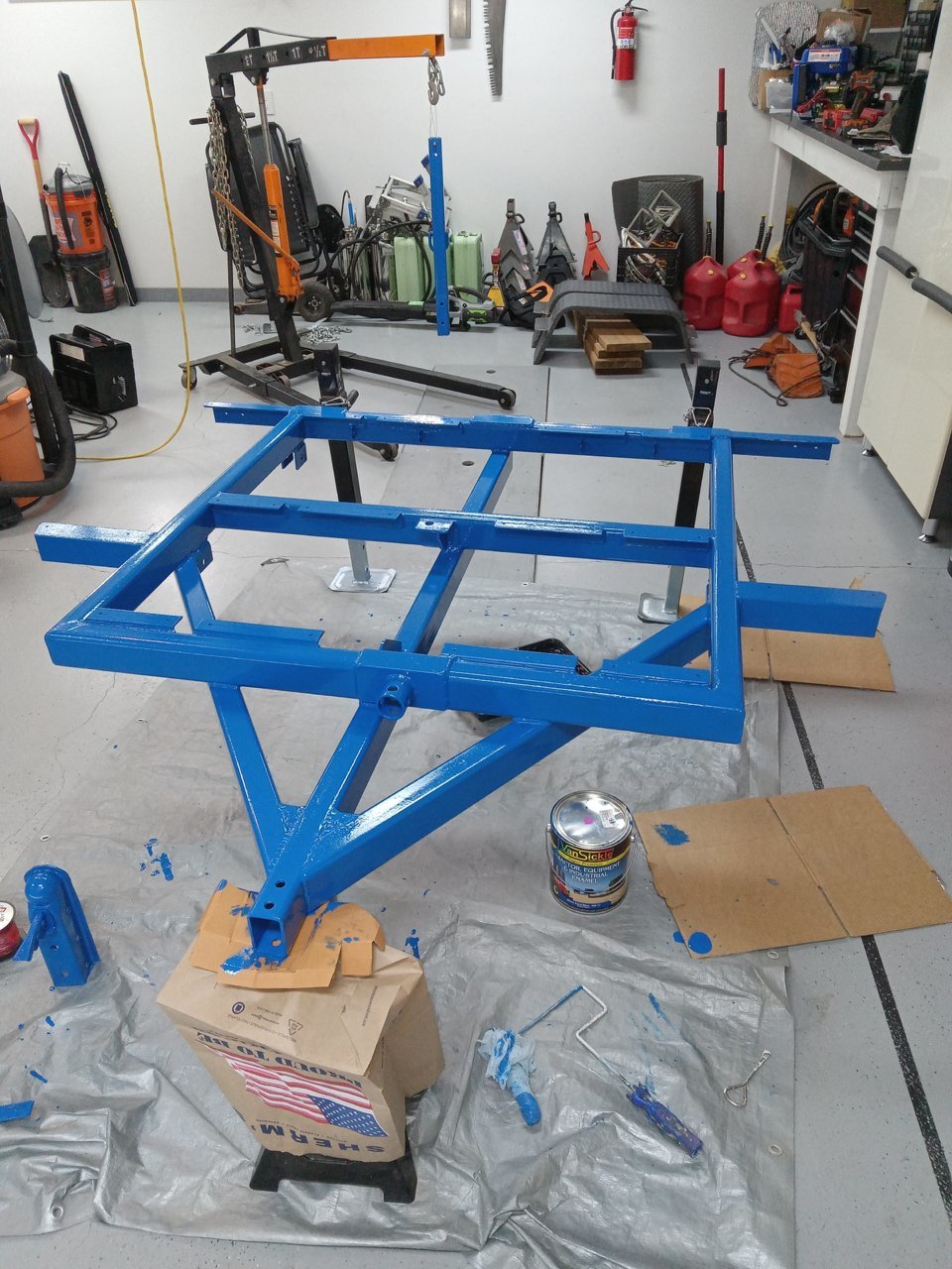

    Should gone with my gut and gone with orange instead of blue. Blue matches the blue and black on the engine for the hydraulic pump, but orange would have looked better. Oh well, not my trailer and he said go with the blue.
    First coat of Ford tractor blue.
    Fenders will get painted black.
    I am going to use a rag on a stick (basically a barrel mop) to paint the inside of the center beam and A frame.

    I use the washer welded to the inside of the frame method all the time. I actually think it's more durable than snaking the wires in the frame. You can buy grommets that pop right in the washers to remove any worry of the wires chafing. It's a hell of a lot easier wiring the thing as well, also makes repairs much easier.
