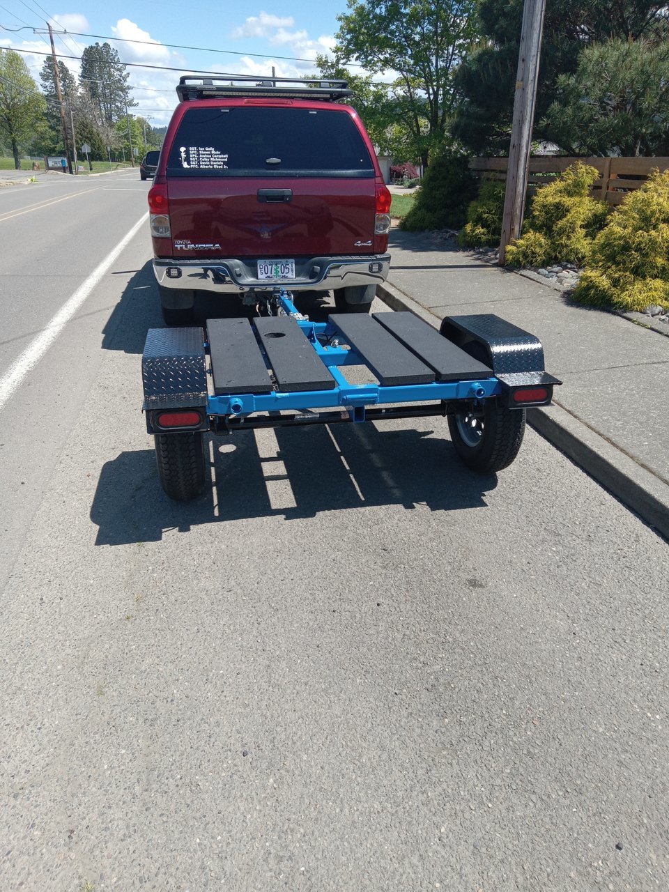

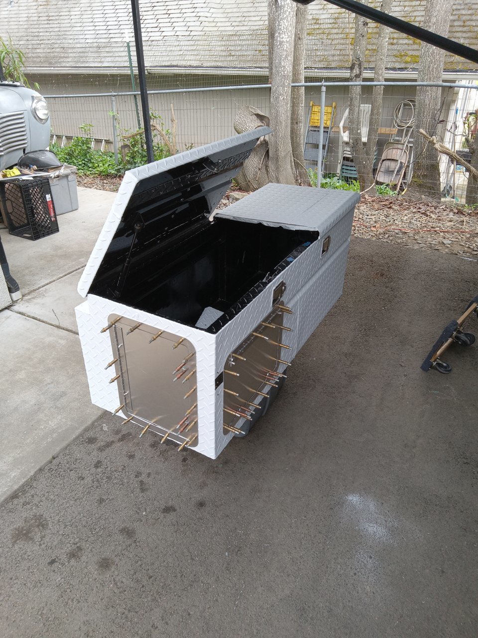

    Waiting for the buck rivets to arrive for the access doors. Box has since been painted black.

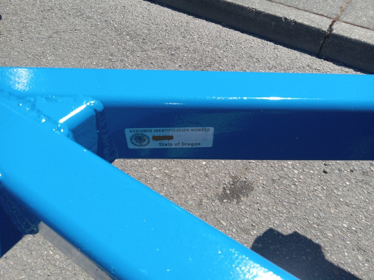

    Took the trailer to the DMV today and got an AIN for it. They wanted receipts for the material I used to build it and the axle. Told them I had no paperwork for the metal, wood, bolts, tires, coupler, wires, lights, fenders, or other stuff. Gave them an ebay receipt for the axle. Funny thing is, they didn't even check to make sure it was the axle on the receipt.
    Anyways, it is officially a titled trailer.
    I went ahead and stamped the AIN into the metal under where the splitter will sit, I am going to stamp it a few more times in random spots.

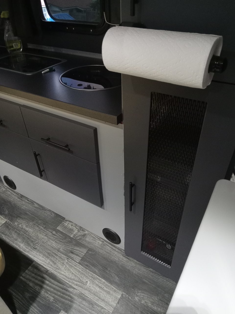

    On the camper, I painted the kitchen to get rid of the red. It suits it much better. Just need to put the trim back on. I also used some slotted sheet aluminum to make a grill for the service door.

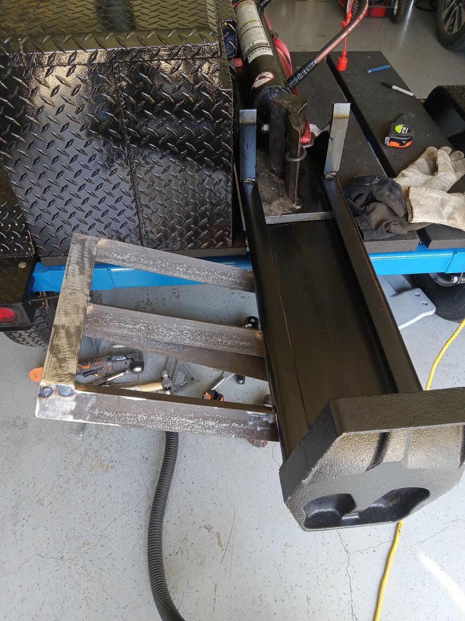

    On the splitter trailer, I am building a pair of angled tables to keep rounds from rolling off when split. Taking longer than I'd like because my welder is throwing a fit and will stop welding after only about 2", then I have to let it cool down. Time for a new one.

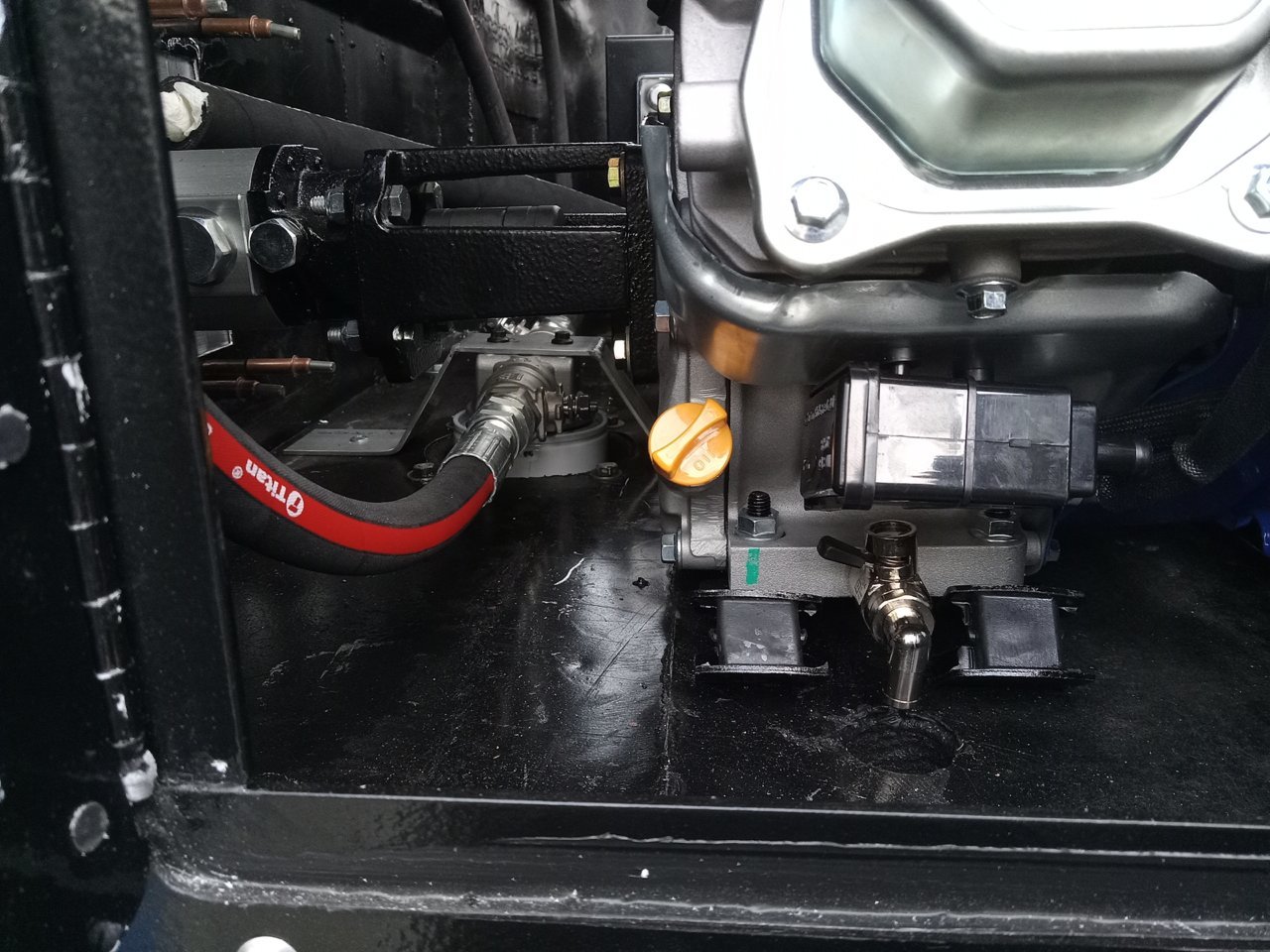

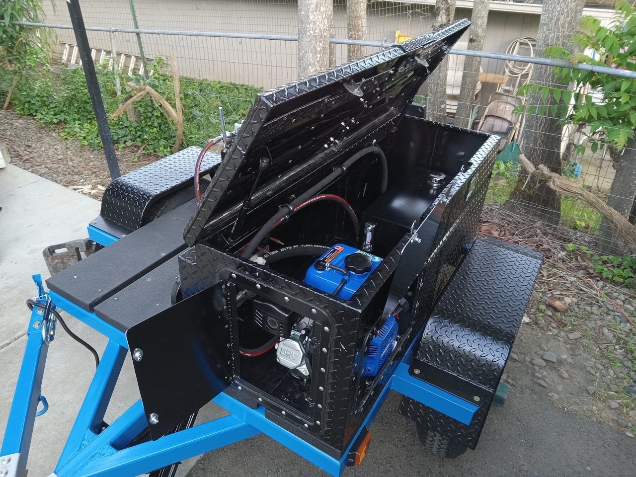

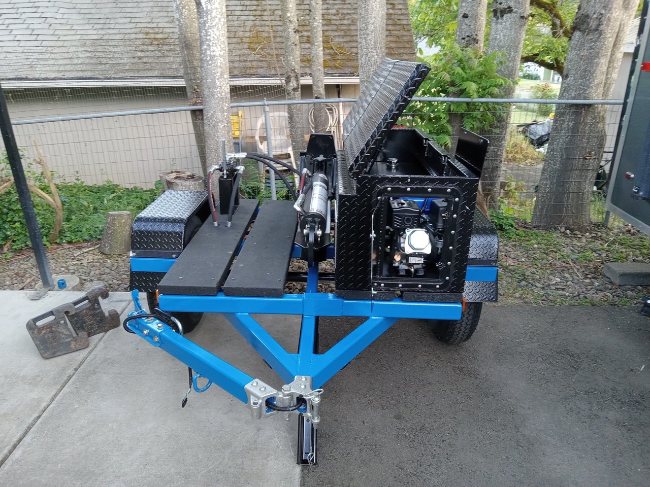

    Decided to put a tongue box on to help get the balance better since the oil tank move to be back from the original plan of having it at the front opposite the engine. So, I cut the jack mount off and mounted a BAL jack.
    Got all the plumbing done except the pickup hose as I forgot to get a couple hose clamps. I will go to napa tomorrow and get some. I do still need to order some hose wrap though.
    Last picture shows how I did the engine oil drain and the bracket I made to hold the hydraulic filter.

    All done. Splits wood well at just an idle, moves faster than the electric splitter too. Had some oak to try it on.

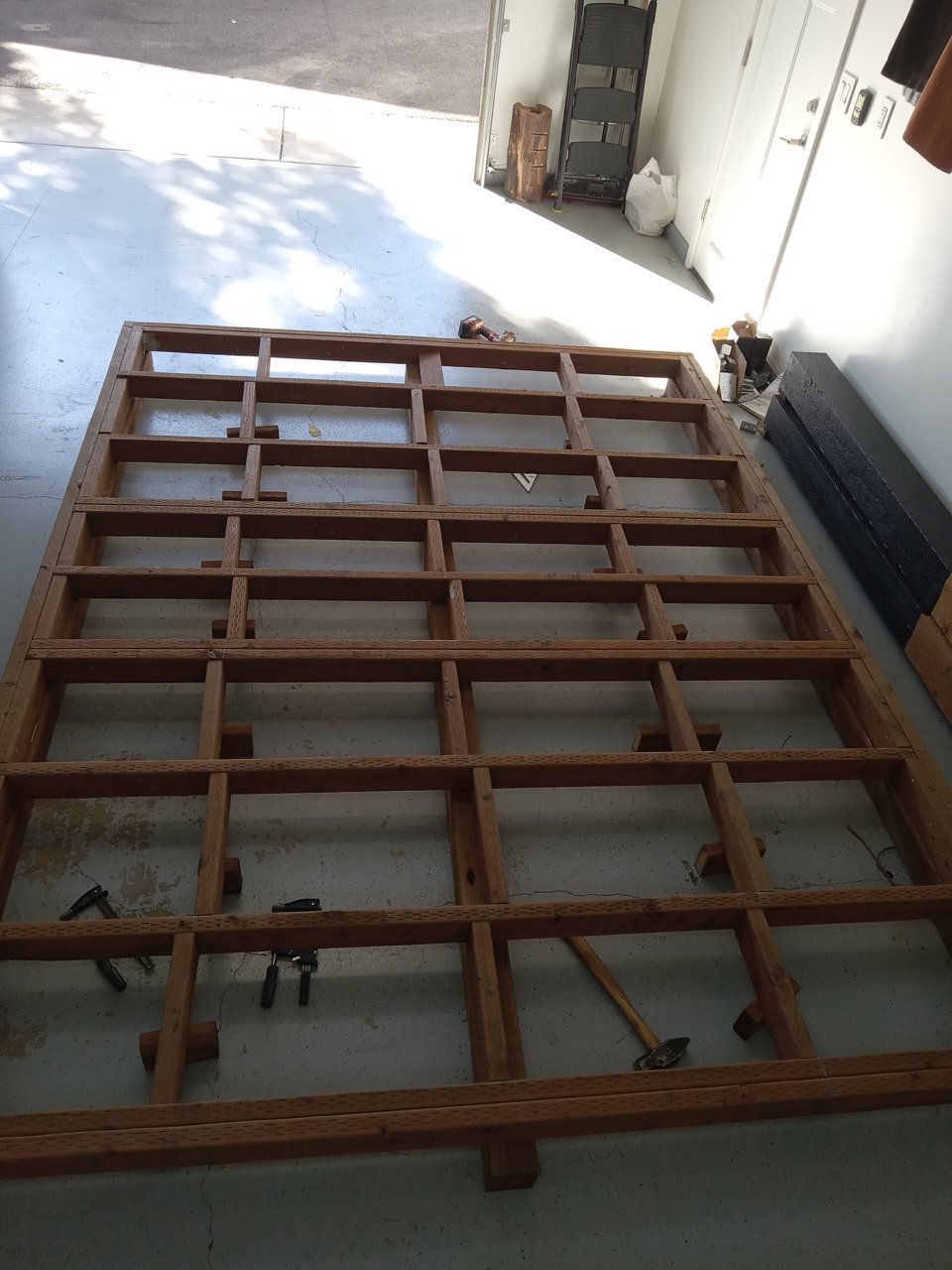

    Made a foundation kit for a 10x8 shed I picked up. I'll be able to haul it out to my property and assemble it without having to make any cuts.
    I hate how I got 2x4s from the same bundle and there is over 1/4" variation from board to board.

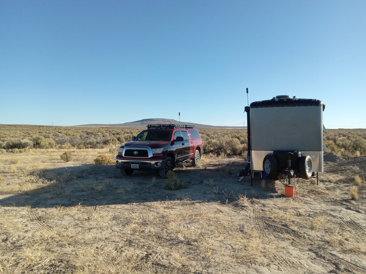

    Back out to the middle of nowhere. First day was nice and clear, now it is raining. I got about 50ft shy of my 1/4 mile long driveway cleared of sagebrush (by hand as I haven't gone and gotten my tractor and backhoe yet). Once the driveway is clear, I have 330ft of ROW/road to clear.
    Tomorrow, I'll go get my tractor and a bunch of other stuff. Tuesday, I'll get my backhoe and more stuff.
    It's a 9hr round trip to get stuff, so I'll be packing as much as I can per trip.
