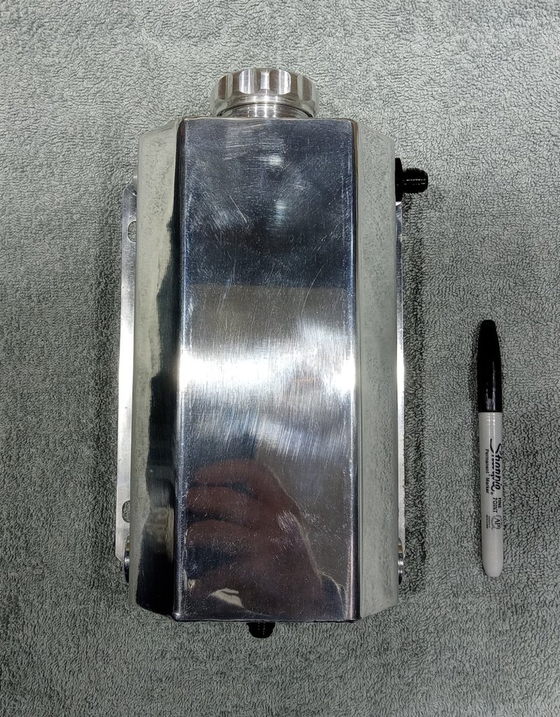

    Decided that since I am adding efi to my car, I'd update the vent. So, I put together a charcoal canister for it instead of using an open vent.
    Used a universal 2L overflow tank, added a couple fitting and some plugs, put an inch of activated carbon mat on the bottom and a 2x2 piece on the side at the top by the top fitting, then filled it with activated carbon pellets. The mat will prevent the pellets from getting into the fitting and line while also allowing the fumes to dissipate across the whole surface rather than just one point.
    I don't plan to run a purge line as while the engine runs and fuel is used, it will draw fresh air back through the canister and into the tank. It won't be as effective as it would with a purge, but it will still be effective enough for me. Once the pellets get saturated, it is cheap and easy enough for me to swap them.
    It will be mounted in the trunk with the inlet and vent running through bulkhead fittings through the metal and a K&N style filter on the vent side.

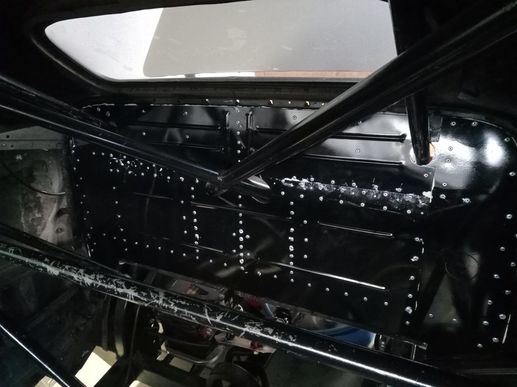

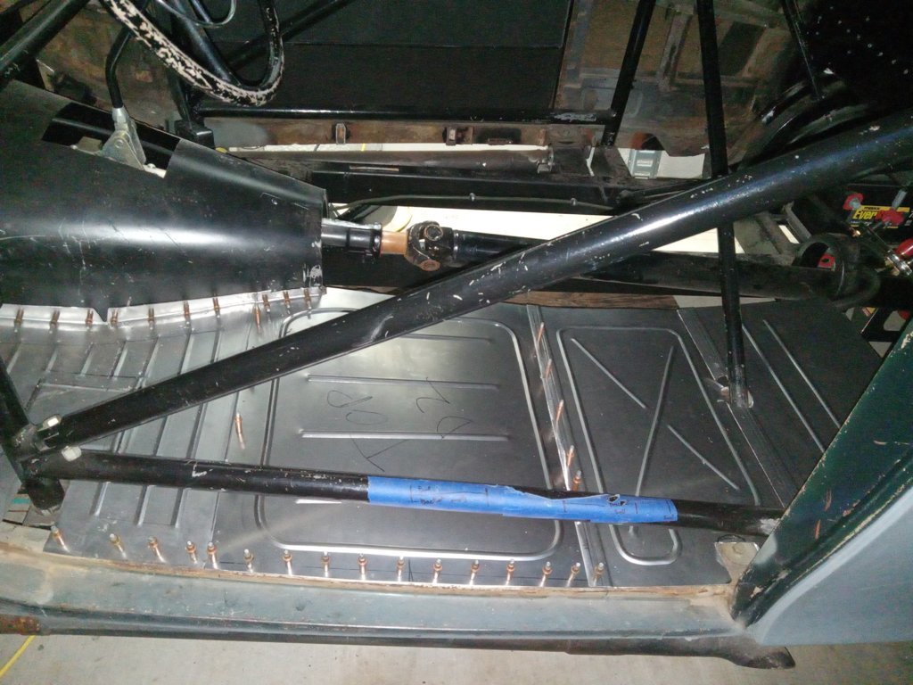

    Opted to use steel 3/8 pop rivet the back wall on. No reason other than it was easier. I did add in structural support to take place of what was removed when I installed the cage.

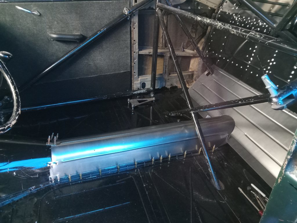

    I'm now working on the floor. I'm adding floor supports on the outside edge and adding 2 body mounts on the inside edge of the floor paneling to provide additional support. I didn't prestretch the metal, so the beads did cause some tin canning, but I am not worried about it.

    Finished up welding on the 4 floor supports and roughing the sheet metal in on the passenger side. Had to stop because it got too painful to keep working. Going to give my back a rest for a couple days. I may redo the passenger side panel to match the one I replaced on the driver side.

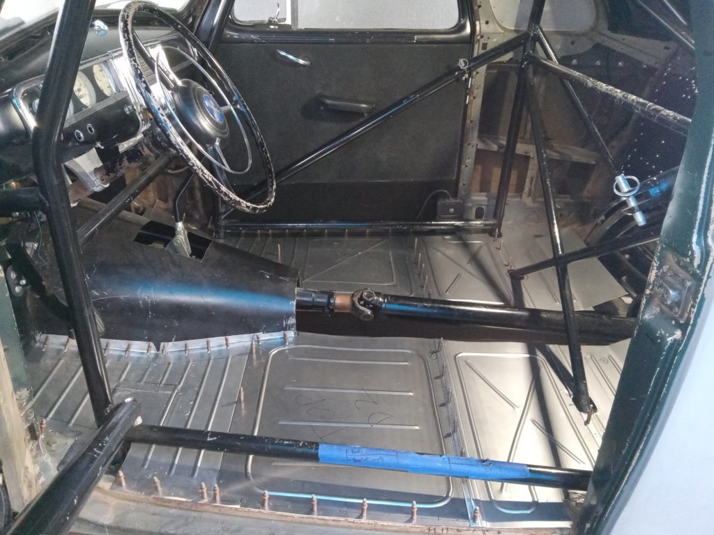

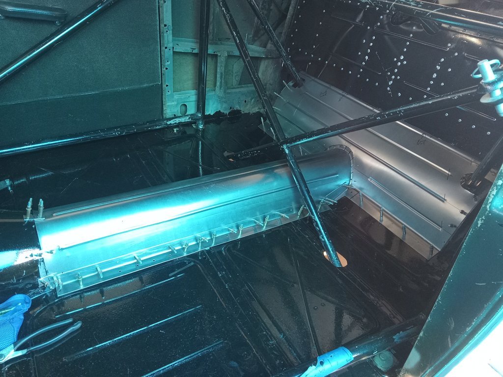

    Well, floor and trans tunnel are welded in. I have the last major piece for the back wall roughed up with 3 beads for strength, just need to put a slight curve in it and open it up for the driveshaft tunnel to weld to.

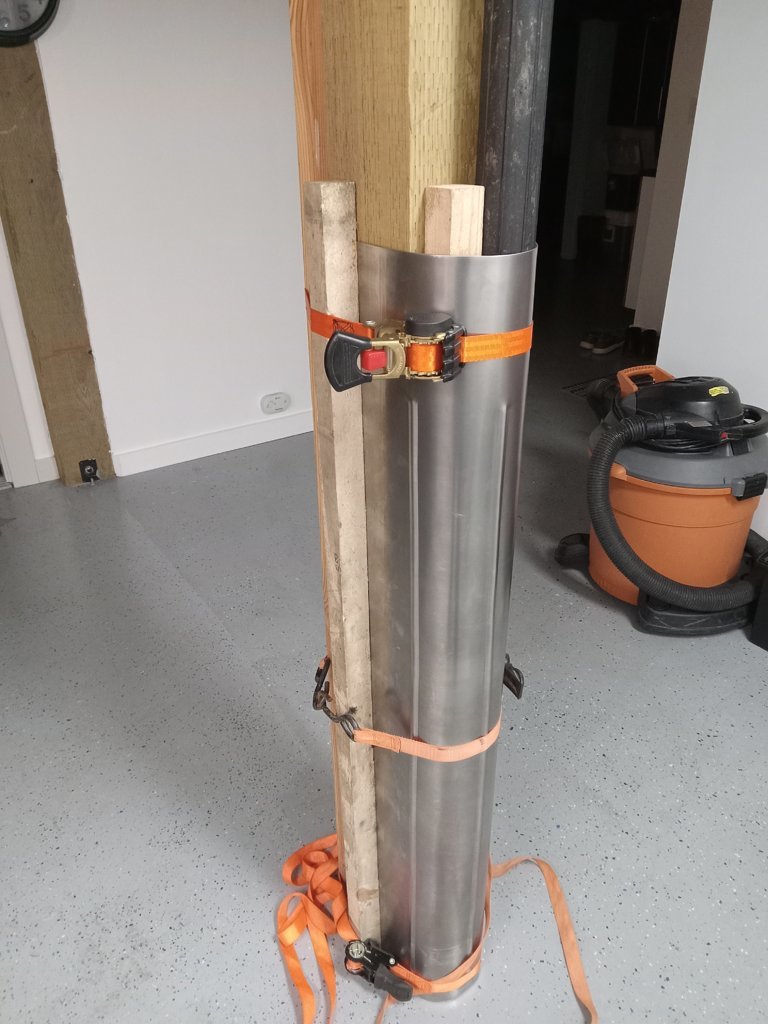

    I have the metal cut for the driveshaft tunnel, but I am fighting to get it formed. I wanted to do a 1 piece instead of a 3 piece, so forming the arch is a PITA by hand. Unlike the smaller pieces, shaping in over my leg doesn't work all that well.
    I tried shaping it against a telephone pole out by the street, but without having a backer on it, it just started to buckle. I might try to find a 5 inch peeler core or fence post. Or, I might find some other odd misuse of something to make it work. Who knows.
    I am going to try to get all the remaining floor pieces done by Monday so I can drop them off at the sand blasted to get grayed for POR15. I forgot how good that stuff sticks to grayed metal until I overpainted one spot and had to remove the paint to weld, wire wheel and flap disk didn't do squat. Had to pull out a grinding wheel to get it to bare metal.

    It was a royal pita. Taking a lunch break, then I'll go back to fitting everything together and make a couple angled tie rails to attach the floor and the driveshaft tunnel together as the steel angle won't work.

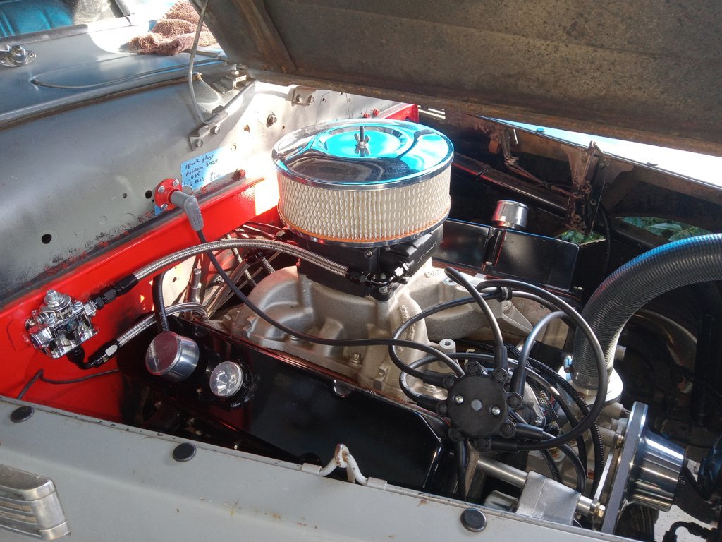

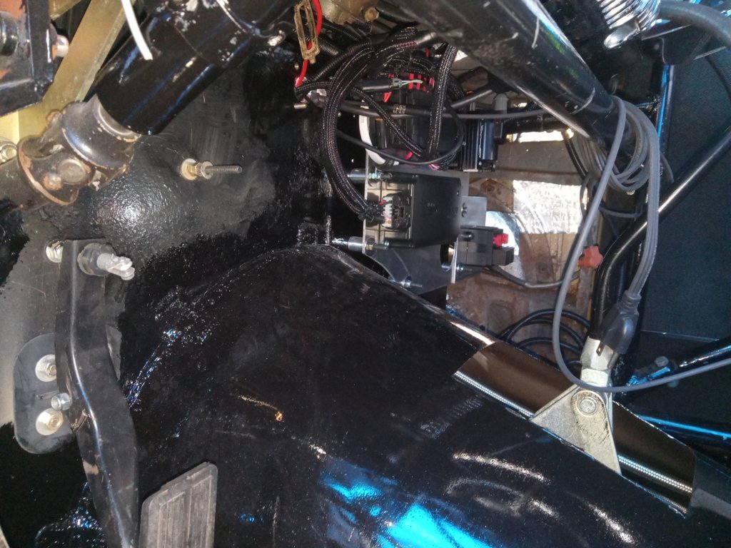

    Car is back alive with fuel injection. She starts easier, and runs better. I have it set to run a little on the rich side. I still need to clean up the wiring, but will wait until after I pull the dash to do some work on it so I can add hangers to mount the wiring to.
    I put the engine management component under the dash to keep them dry, clean, and cooler. It also helps clean the engine bay up a bit. I mounted the set with 1" spacers, this will allow mounting of thermal barrier and carpet.
    I am going to change headers again and will custom fit the spark plug wires once I finalize my choice of headers. For now, I just have them so they don't rub or burn.

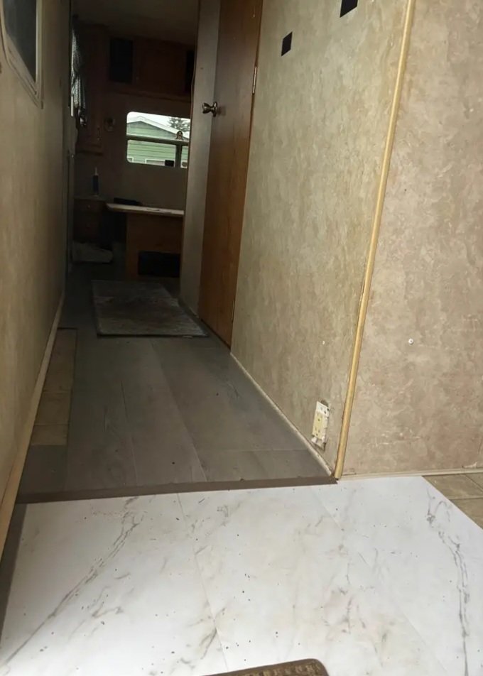

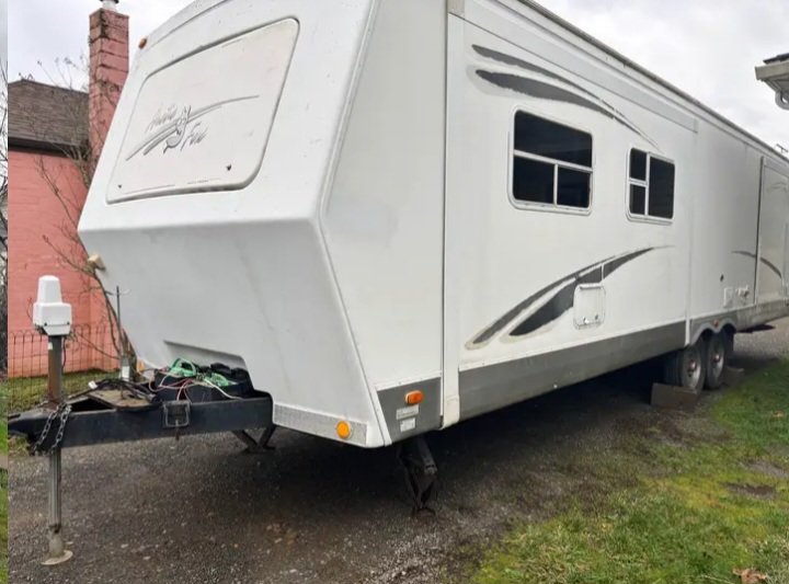

    I also added a 33ft Arctic Fox trailer to my list. Got it cheap due to water and rodents. But my plan was buying it for the frame and shell, so even with all the work needed, it was a good deal at a grand. It will get completely gutted including the floor, interior walls, and ceiling. All insulation, wiring, and interior will get replaced. I already pulled off the underbelly cover and 4 bags of water soaked and rat infested fiberglass insulation. I will be gutting it and turning it into a essentially a park model without self contained tanks. It will then be put out on my "Private RV park" (yes, I had my property zoned as an RV park) as the host quarters.
    I will say, I don't know how the hell someone was living in it. I have already removed atleast a hundred rodent bodies, lots of garbage, and contaminated soft build components like carpet and fabric accents. And yes, those are floating vinyl planks screwed to the floor with drywall and deck screws.

    Yeah, I'm going to install a 2 zone mini split. Roof mounted ducted AC and floor ducted furnace are going away. I will stay in my conversion while building the big one, probably swap the roof mounted ac for a mini split in it also.
    It's going to be like going from an apartment to a mansion. 7x16 up to a 8x33 with 2 slides. I'll have a full bedroom, even bigger bathroom, and separate living room and kitchen. I will also be installing a high efficiency fireplace in the living area.
