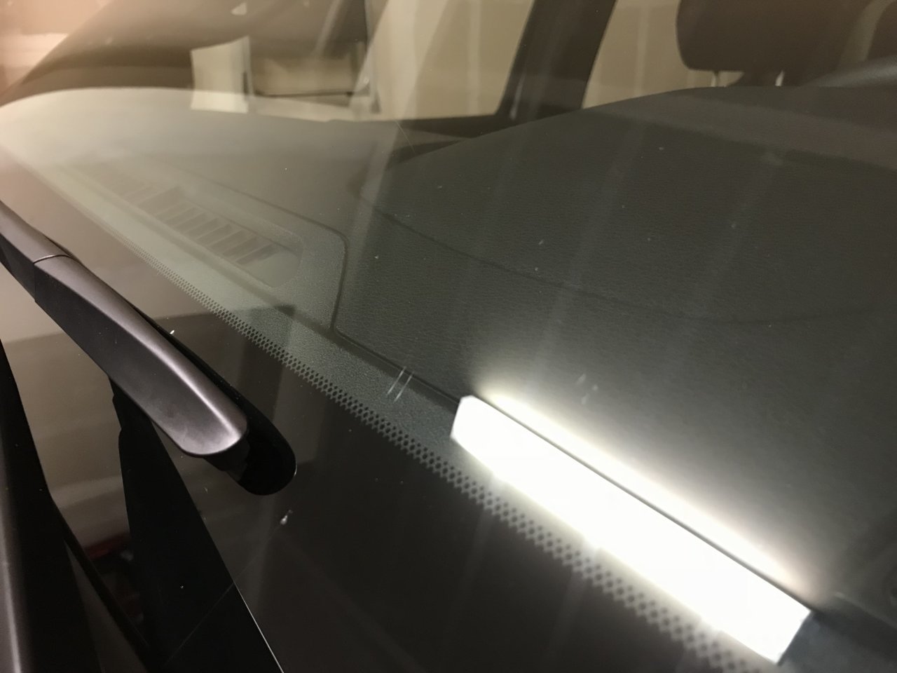

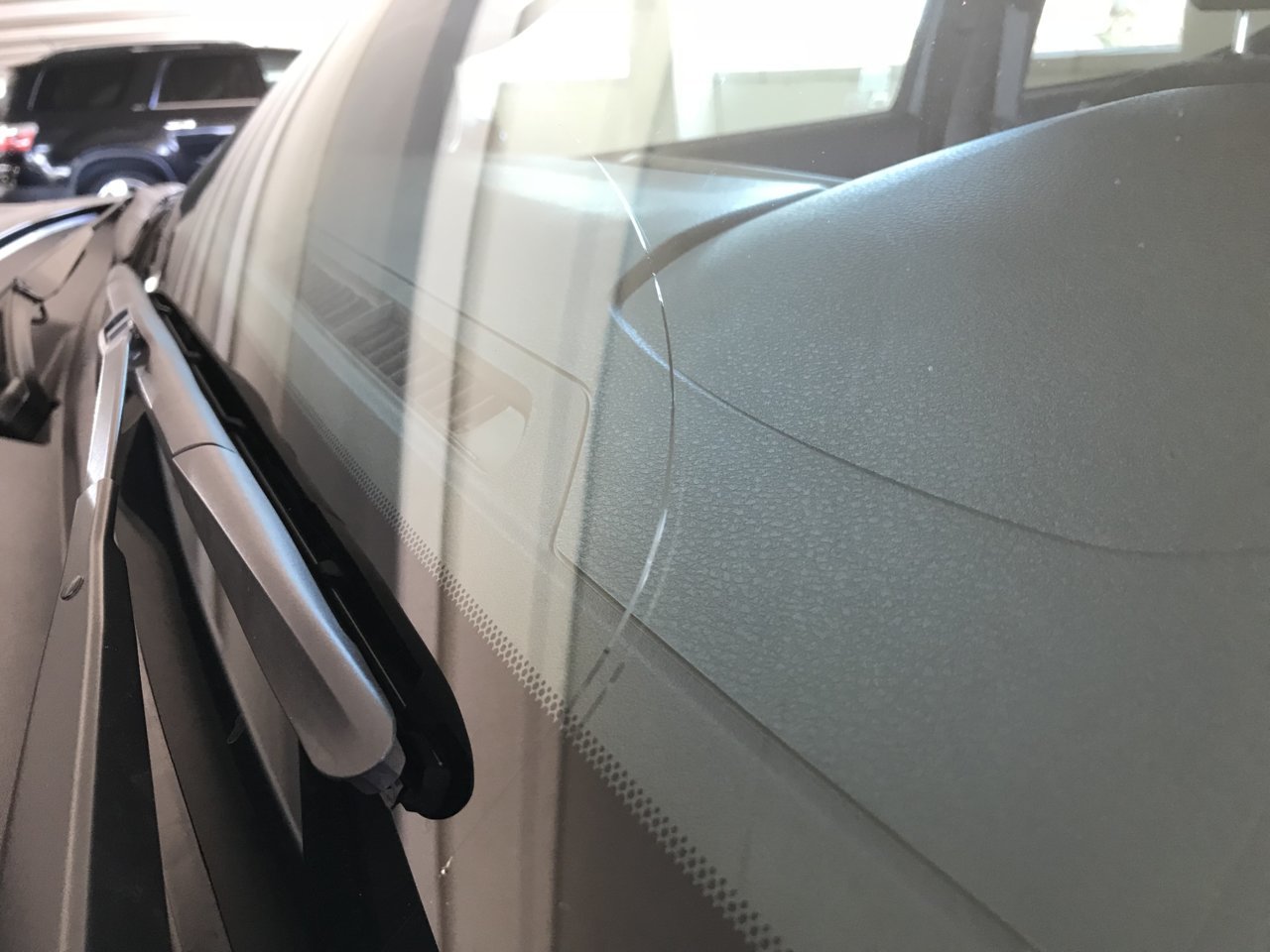

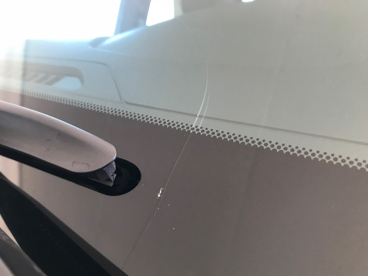

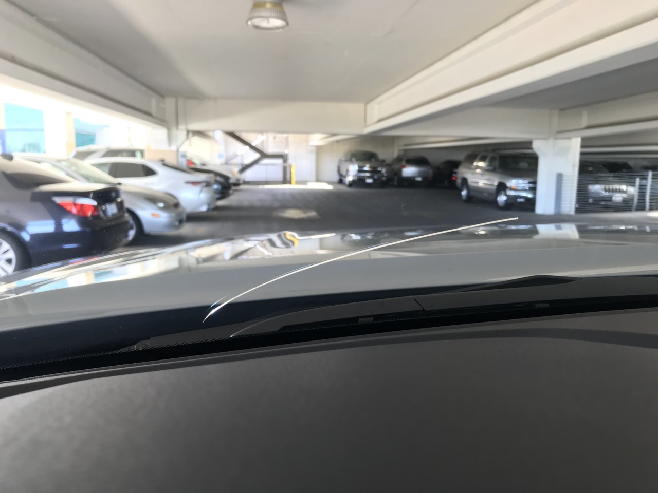

    Last month, on my 2018 DCSB TRD OR with 2.5k miles, I had a big chip repaired in the center of the windshield.
    Today, another rock chipped the windshield and instantly caused this 12" crack (that I'm also getting repaired- not replaced).

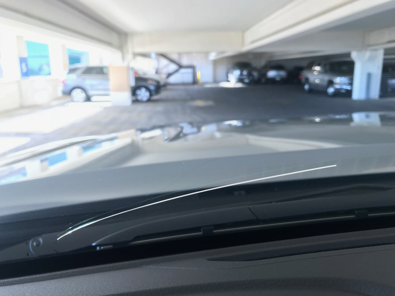

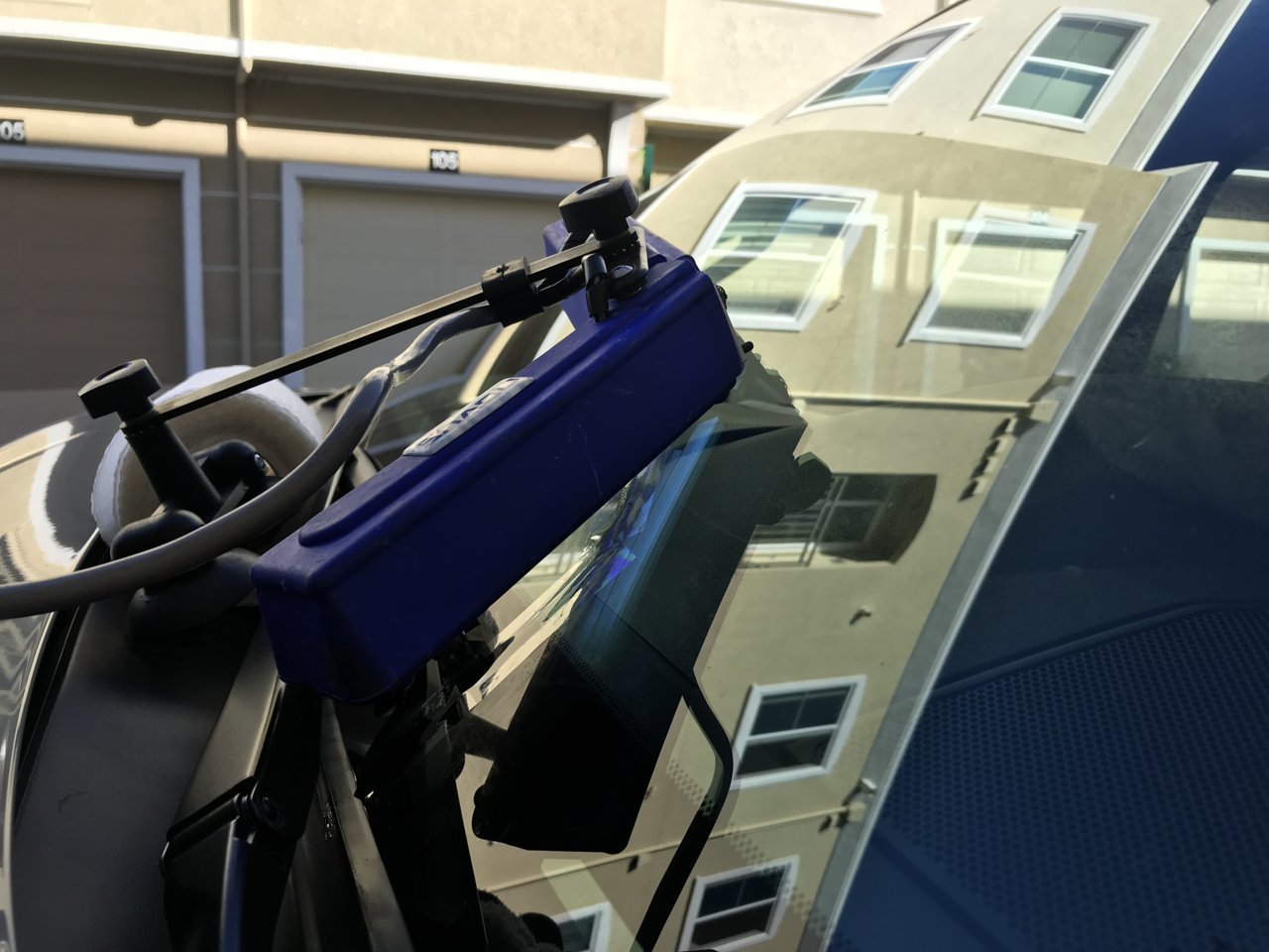

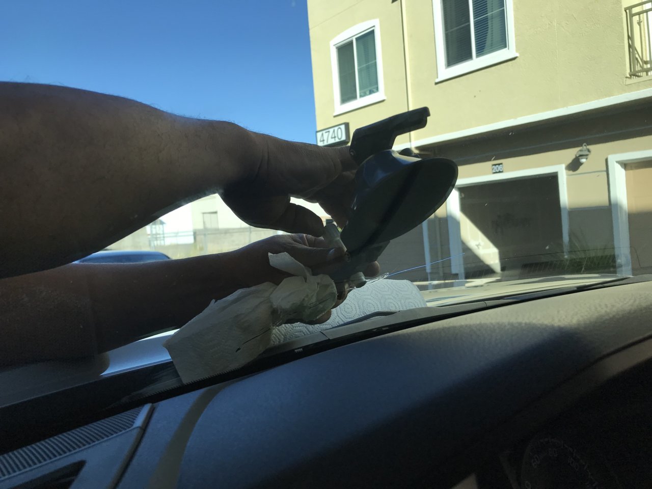

    I had my local glass guy (Frank from Novus in Bay Area) fix the crack. It's mostly invisible now but you can still see it if you really look for it. The way it's going, I feel like this is just a temporary fix until the next crack and windshield replacement. Frank said he'll put the money for the windshield repair towards a new windshield if it comes to that. Great guy and good repair.
    The before picture showed that the crack was about 12" long from the base of the windshield. By the end of the day, due to the heat, it was closer to 15" long.
    The fix involved dremeling to the glass along the crack line so he can pump resin into the crack at a high psi using a resin injection tool. You then pump, at high pressure, into the crack moving the injection tool along the crack line as you do so. After some drying time, you scrape off the excess using a razor blade then put a thin coat of resin along cover it with plastic strips. The resin is cured using a UV Lamp. Take the plastic off, scrap the excess resin until it's flush with the windshield. Clean the windshield then you're done.
    Since I know where the crack was and know where to look, I can see the crack but I think over time, I won't even see it anymore. There were some air bubbles in the crack which makes it a little bit more visible if you know where to look. My main concern was that the crack doesn't spread. I know I'll eventually have to replace the windshield anyway but I'm holding on to the OEM glass for as long as I can.
