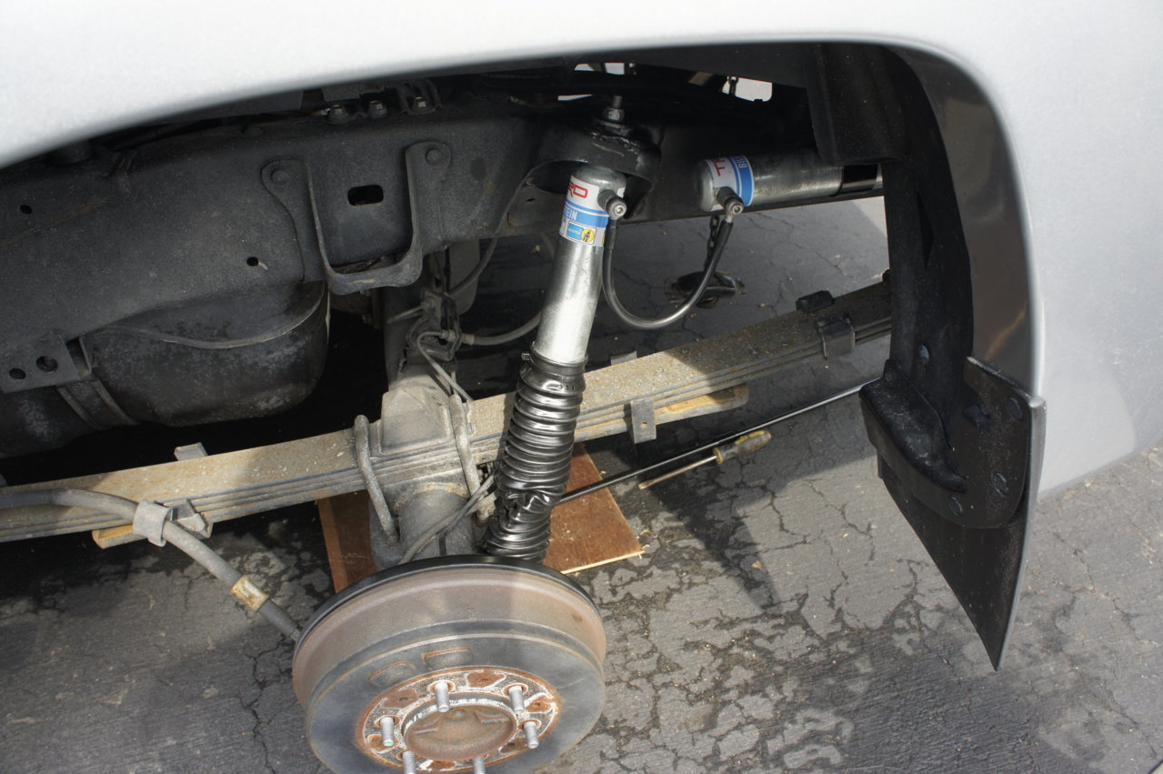

    Part of the justification of having external reservoir shocks is for the heat (or cooling).
    Front Pro 6112 Bilstein vs stock TRD Bilstein
