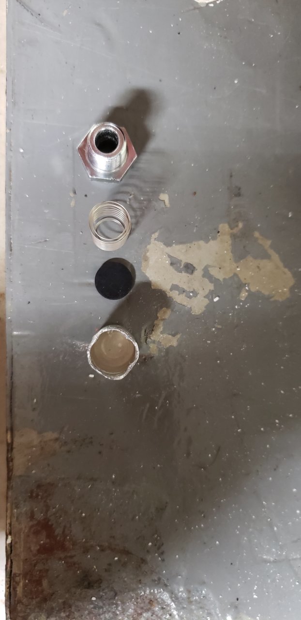

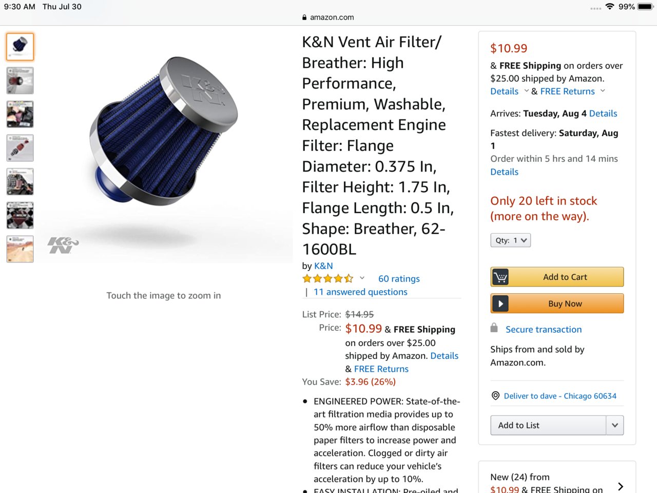

    The cheap one from Advance or NAPA does not; it's basically like the oem one in my pic without the black rubber piece. You'd have to get an ARB or a crankcase filter to have an actual filtered media. You're not talking about a lot of air going in or out; just enough to displace fluid expansion when hot or contraction when cold. You could leave it open without issues either provided its in a dry spot.
