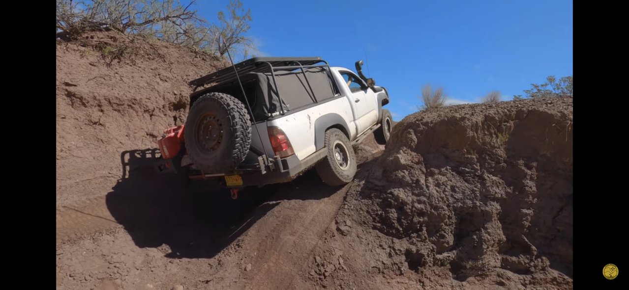

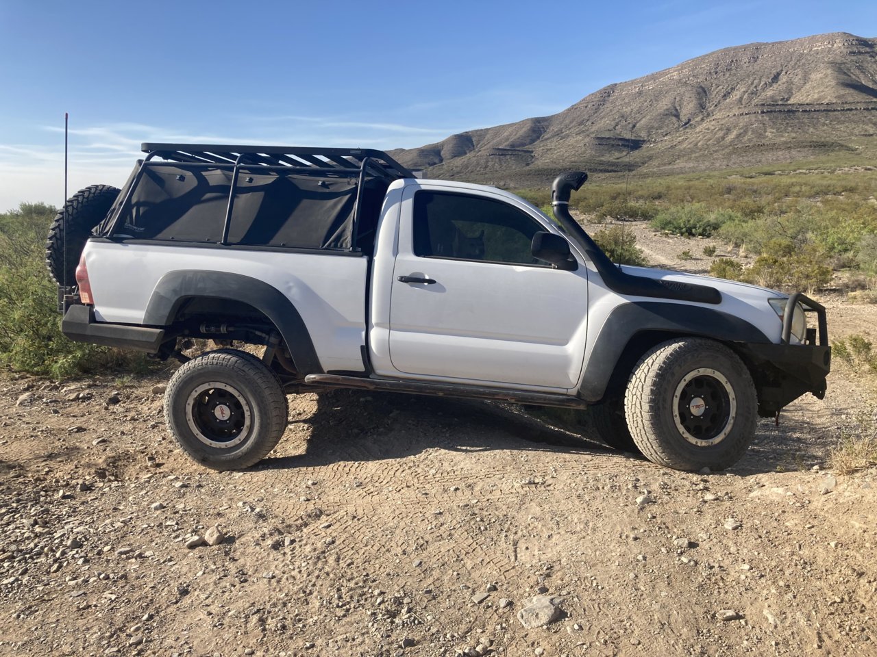

    I bought my truck and a couple years ago and I noticed it has 10 leaf springs on each side. Why? The guy I bought it from mentioned they used it as a work truck sometimes to haul concrete up the mountain but 10 leaf springs? That seems excessive. It already came with a 2.5 Icon w Remote Res. I’m thinking of doing the 63 swap to (A) increase suspensions travel and (B) to allow me to have a softer ride while having an empty bed. What are y’all’s thoughts. These pictures are with my current setup. Still flexes quite a bit.

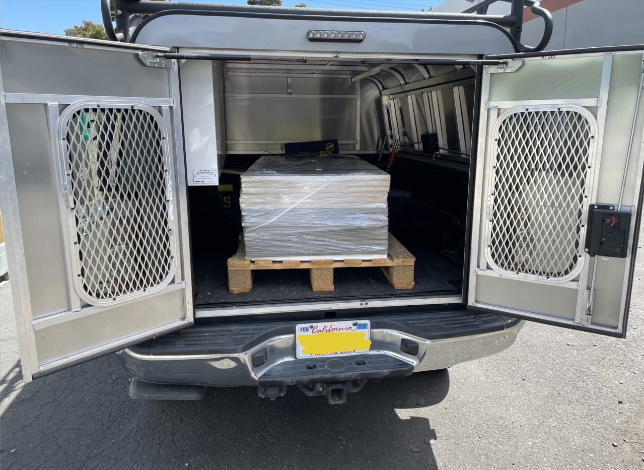

    I put Deaver U402 Stage IIIs, rated at 700-1000 lb load capacity on my 2014 AC 4.0L MT. I believe they also have 10 leaves. Mind you this is with FOX 2.5 Perf. Elites on all 4 corners, DSC knobs set to about 3 or 4 out of 10 for damping. (All provided by Accutune Offroad, highly recommend them. I did the install myself.)
    Gives about a 2.5" lift on the rear. Here it is loaded with a 1200 lb pallet of bathroom floor/wall tile. A mix of 8mm and 10mm porcelain and natural stone tile, 24" x 48" slabs. The rear utility shell & lumber rack add another 300 lbs, and I had at least 150 lbs of tools etc. also in the back. ~1650 lbs of cargo. This kind of load would probably cause a stock Taco to hit the bump stops, unsafe to drive.
    I don't haul this much weight routinely but it greatly adds to the overall value of the truck to be able to load it heavily when I want to.
    With the heavy Deaver springs I drove the cargo ~30 miles over surface streets and Bay Area freeways in various states of disrepair. Excellent load control & handling, no bottoming out on potholes or speed bumps, the thing rides like a lightly-loaded full-sized pickup. Safe freeway cruising at 70-75mph.
