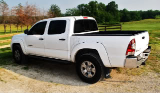

    Hmm, thanks for the clarification. I don't like the look of wheels like the Revolvers that seem to stick out several inches past the fenders but the pics I've seen of the MBs installed seem to edge out barely past the flares. Hard to find good images though.
    Here's a pic of some, though they look like 17s perhaps. Don't stick out really, though they might have a different offset.
    http://www.tacomaworld.com/forum/at...omas/76359d1288079512-about-time-img00351.jpg
    Anyone else have a good shot of 16s along the side of the truck to show spacing?
