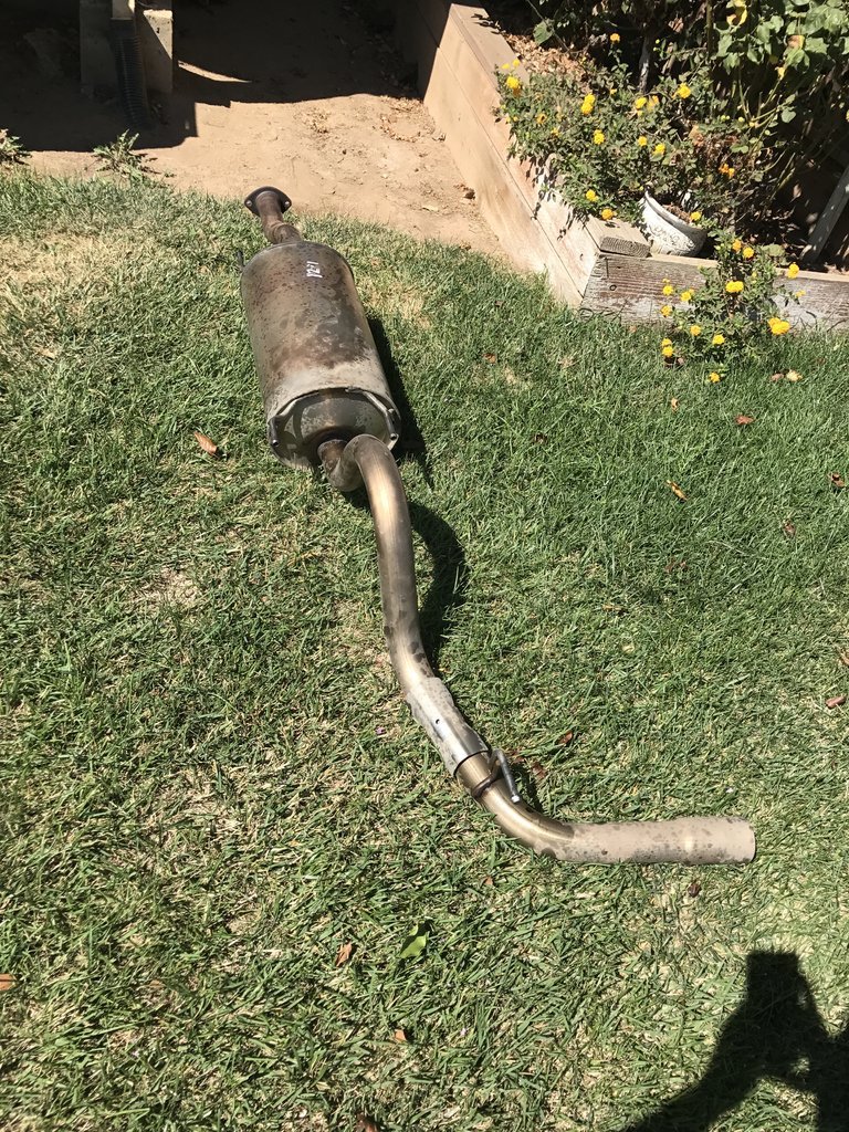

    Im Installing this exhaust i picked up on Ebay from a dealer for 200.
    I noticed there was no thread yet so Im posting to share personal experience
    MBRP S5339AL 3" Cat-Back Aluminized Steel Turn Down Style.

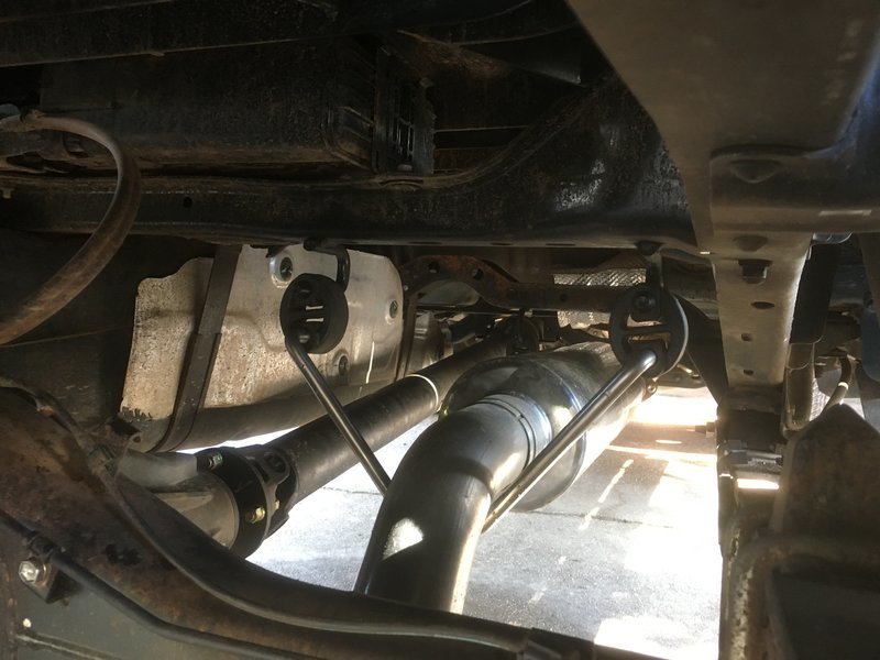

    Well I posted b/c I couldnt find any Threads. I know people have posted about the cat back but not the Drop Down one. I tried Installing myself on my Access Cab, but it seems like I have to cut into the pipe to make it fit on the clamps. Will be doing that tomorrow. Ill have an update soon

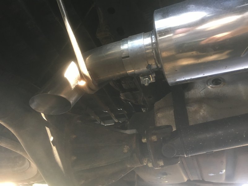

    Just a follow up, I installed the exhaust at home. Had to cut about 13 inches to make it fit. I felt like the included clamps weren't enough or maybe its my ocd. Theres is noticable drone inside the truck as im driving higher speeds. Its bothering me a little at the moment but im going to leave it as is. Theres Defiantly a difference in sound from stock and i feel as if the truck shifts smoother with an aftermarket exhaust. My only downfall is the damn drone. Ima have a shop check the taco out for proper fitment or leak issues. Im thinking of having them weld the whole thing as well, and possibly running the exhaust all the way to the back. I know..... I should of just bought a full sized one
