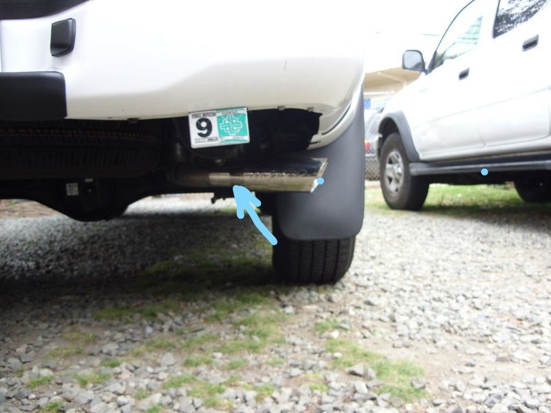

    Just installed mbrp dual wall exhaust tip.2.5 inlet 3.5 outlet 12in long.Wanted something different than valor.Pretty happy with looks except for mbrp stamped on side .When ordered didnt have stamp on side.
    Clamp on style but will be welding it on.

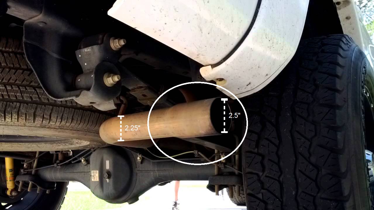

    Great thanks! So I assume you ended up cutting off the flared part at the end of the pipe? And it slid over the rest of the tailpipe with no issues?
    Does my picture below make sense?

    Correct. Mine was 12 inch long so depending on what length you buy will determine how much to cut . 12 in long one worked for me

    Perfect thanks! That confirms that the 2.5" inlet will fit.
    How far back did you cut? The one I'm looking at is a Black 2.5" Inlet x 3.5" Outlet x 12" long.
    Thanks again!

    About here . Cut a little longer and adjust from there .
    Lost those pics awhile ago lol... copied
