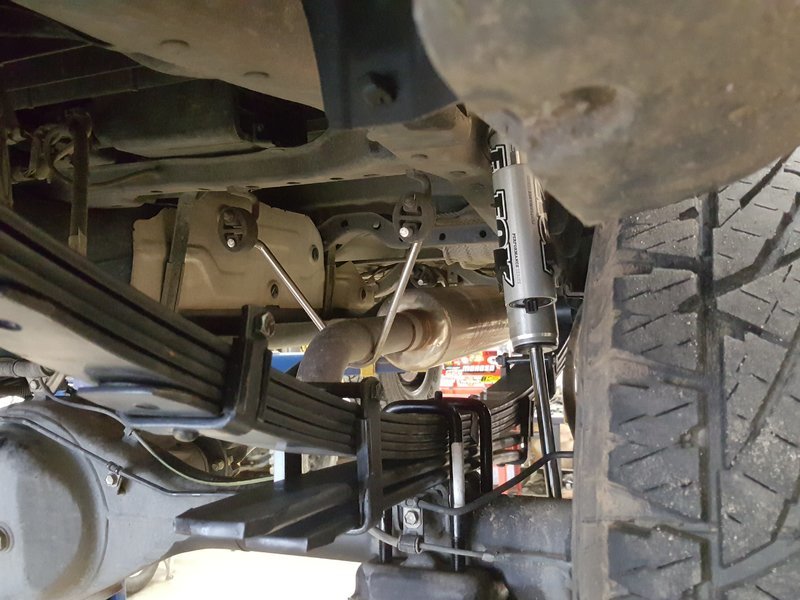

    I love mine too sounds really good paired with a set of DTST headers to20170211_164914.jpg
