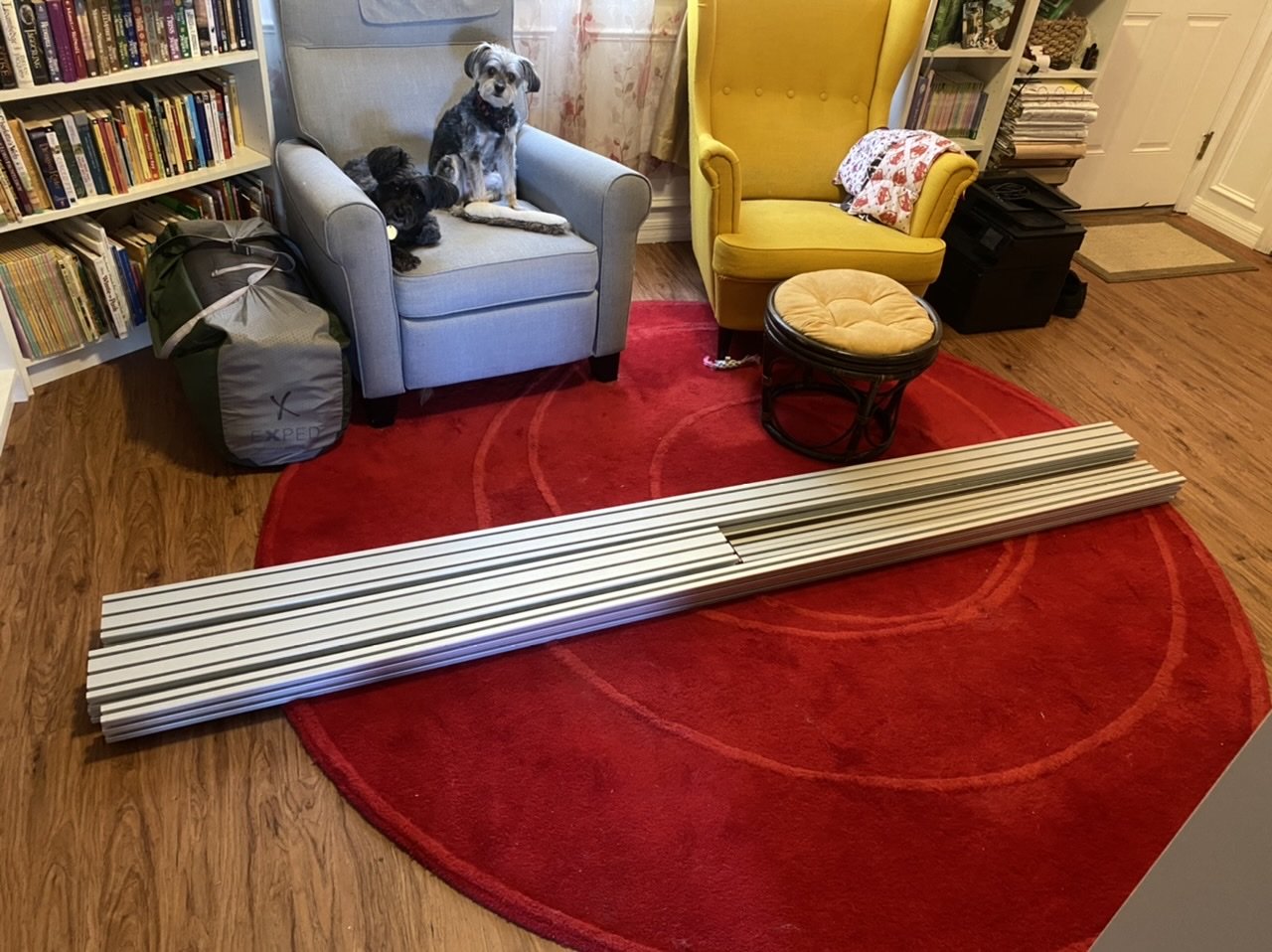

    aluminum extrusion from 8020 arrived. Its magnificent. I may reorder the exterior gussets since the crap, literally, from TNutz is not worthy. If you're thinking of buying the external gussets from TNutz, dont. Spend the extra and get them from 8020. The stuff from Tnutz looks like factory 2nds and 3rds. The black anodizing also apparently turns gold

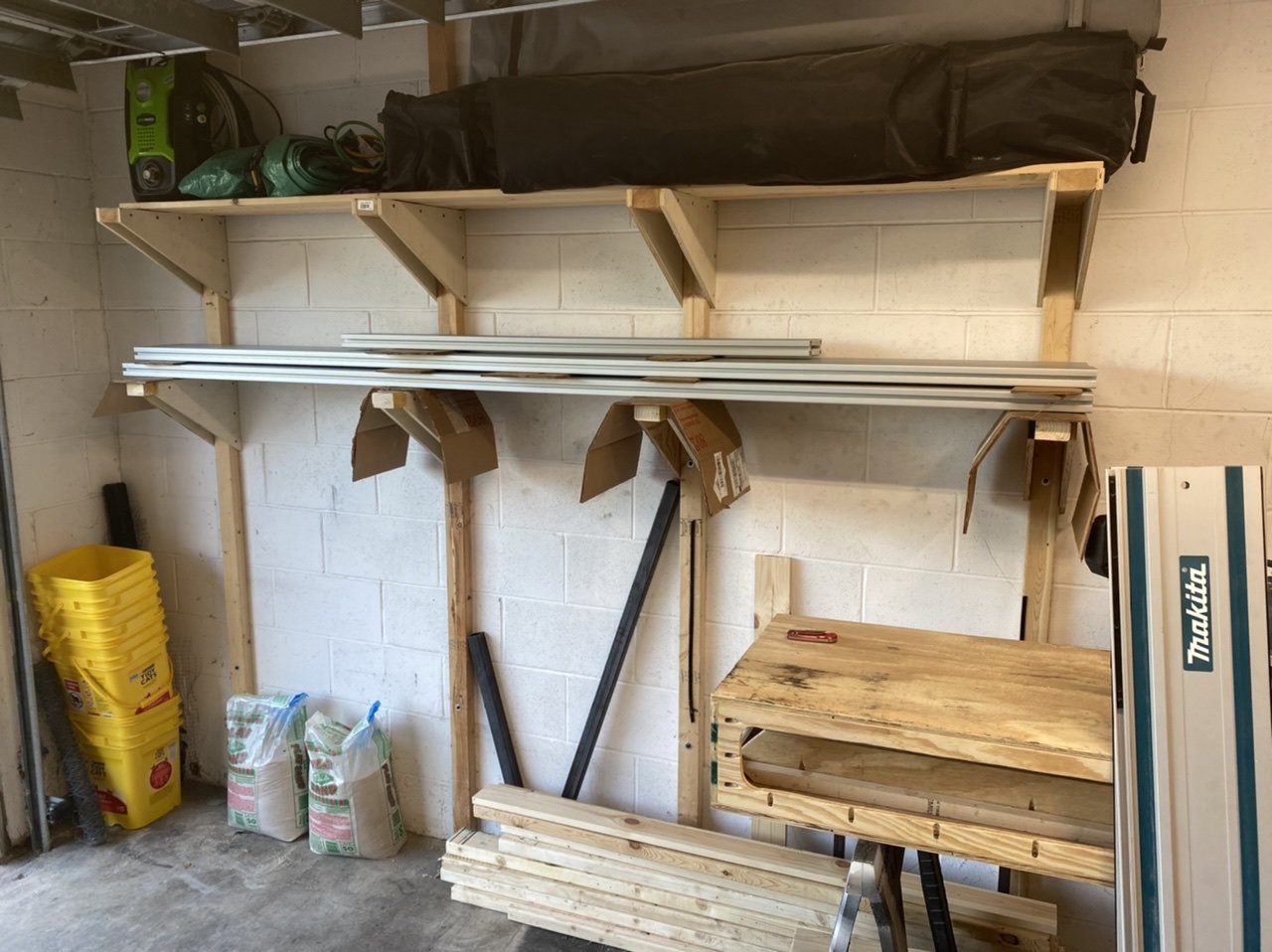

    whipped up a quick set of shelf brackets to hold the extrusion out of the way while I wait to order $400 worth of hardware from McMaster to get the assembly underway

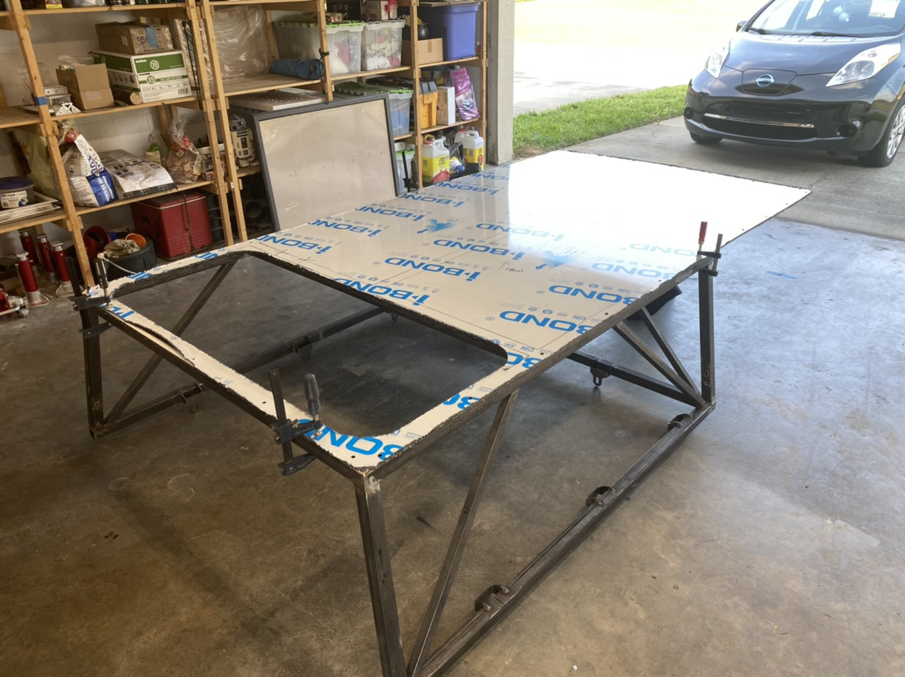

    I didn’t Cnc cut the center rib holes and front because I wasn’t confident in my welding but it’s pretty darn close. I marked out the space frame so I can drill them out in the ACM floor panel.
    I’m hoping to paint the space frame this week and hopefully dry fit the tall extrusion this weekend. I do need to figure out how to seal the floor to space frame and floor to extrusion.

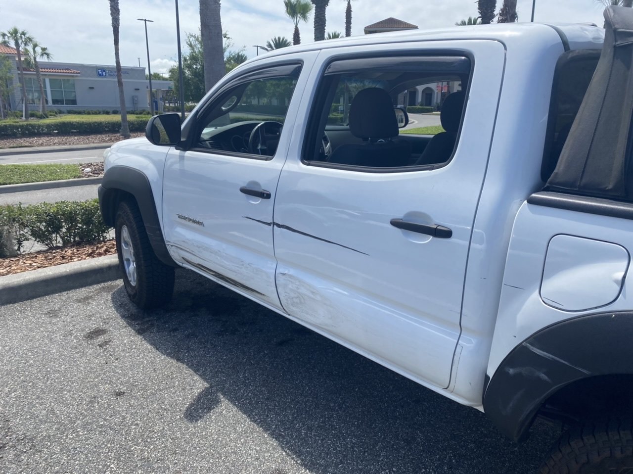

    sideswiped by a distracted driver. Waiting for insurance to do it’s thing. I’m really sad that my truck is damaged. I don’t want to pay for someone else’s mistake.

    Well looks like I’ll have to find doors at least the rear door locally and get it painted since no one will ship one to me.
    front door is fine except for scrapes and dings. Rear door took most of the impact.

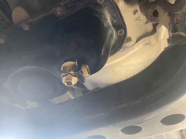

    Installed a Fumoto valve today. Will make oil changes a lot easier since every time I do it the oil splashes everywhere no matter what I do.
    oil filter, air filter, and drive shaft greased

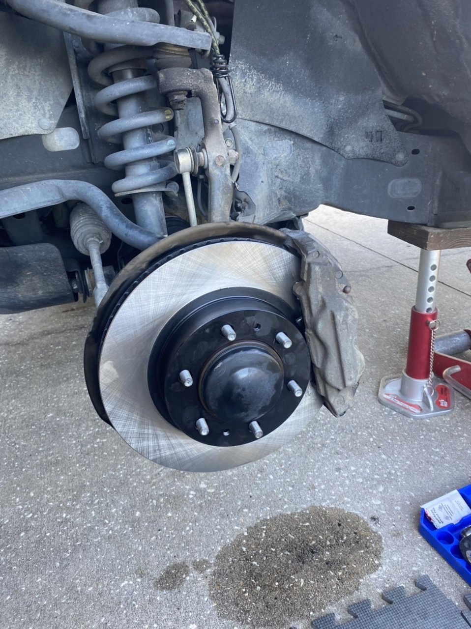

    New Hawk LTS pads and centric rotors.

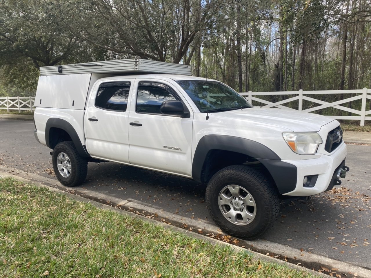

    Ironman 4x4 Foam Cell Pro Stage 2 installed

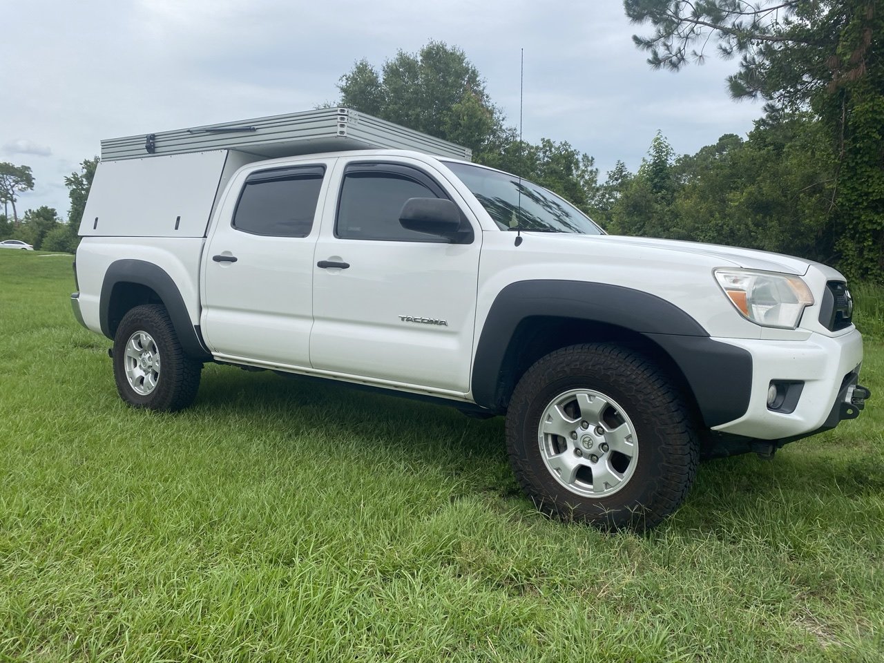

    Not too bad. I personally had some issues visualizing the compound angles but I made some wood to the same dimensions as the steel stock and practiced until i got it right. It also helped having an Evolution Miter saw that cuts steel, aluminum, and wood. So once I had the angles locked in I just cut it on the same saw I did the compound angles.
    still have yet to sew the tent portion, I mainly wanted a topper because at the time fiberglass shells were like an 8 month lead time. Im happy with it, but not the MPG hit. I also still need to improve the sealing of the side doors since they leak from the hinges. If you can swing the $300, get hurricane hinges.
