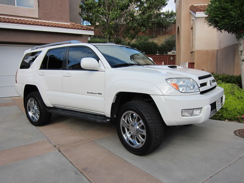

    I assume you are using the "Meguiars NXT Generation Tech Wax 2.0". I don't think you supposed to let it dry....apply and polish immediately after application.
    http://www.youtube.com/watch?v=LE2NJBMZFoM
    That said, if you are going to wax your car every 3-4 months, then wax is good. I recommend using glaze, only have to do it once a year.
    Klasse All In One and Klasse High Gloss Sealant Glaze
    http://www.autogeek.net/klassekit.html
    This is a pic of my 4Runner...don't have pics of my Taco online, but it gives you an idea. Used the glaze linked above.
    PS. Really have to apply it very thin...almost not able to see, otherwise you will buff till your arms fall off!
