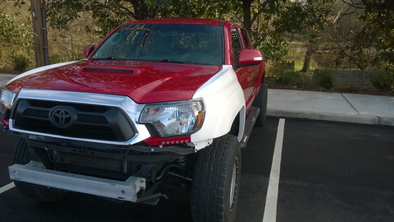

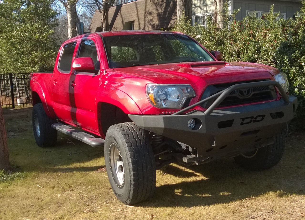

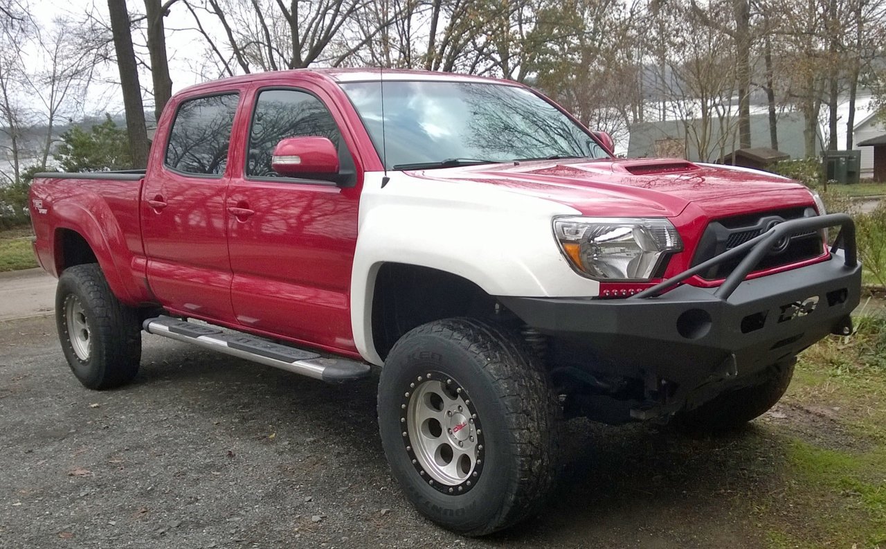

    In those pic's I had 285/70 r17
    I currently am running 285/75 r17, and I had to do some more trimming to avoid the rub..

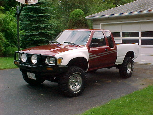

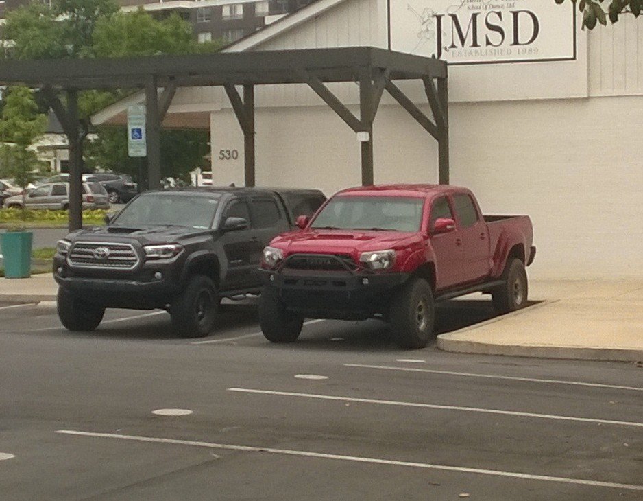

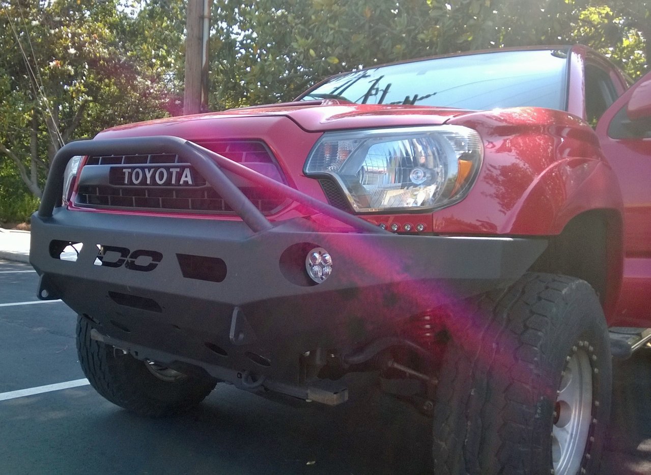

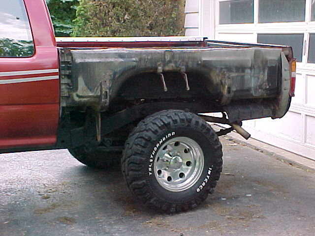

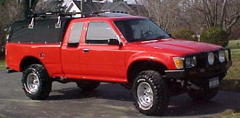

    Nope just the fronts, the rears are stock, waiting on the matching +2..
    I have done the full setup on my last Toy, I did +3 front and rear but that was back in the 90's..

    My backspace is -12 17x9 m/t classic lock
    oops, I forgot I have "special" wheels they are a -15 offset.. even though M/T clamed they never made that size....

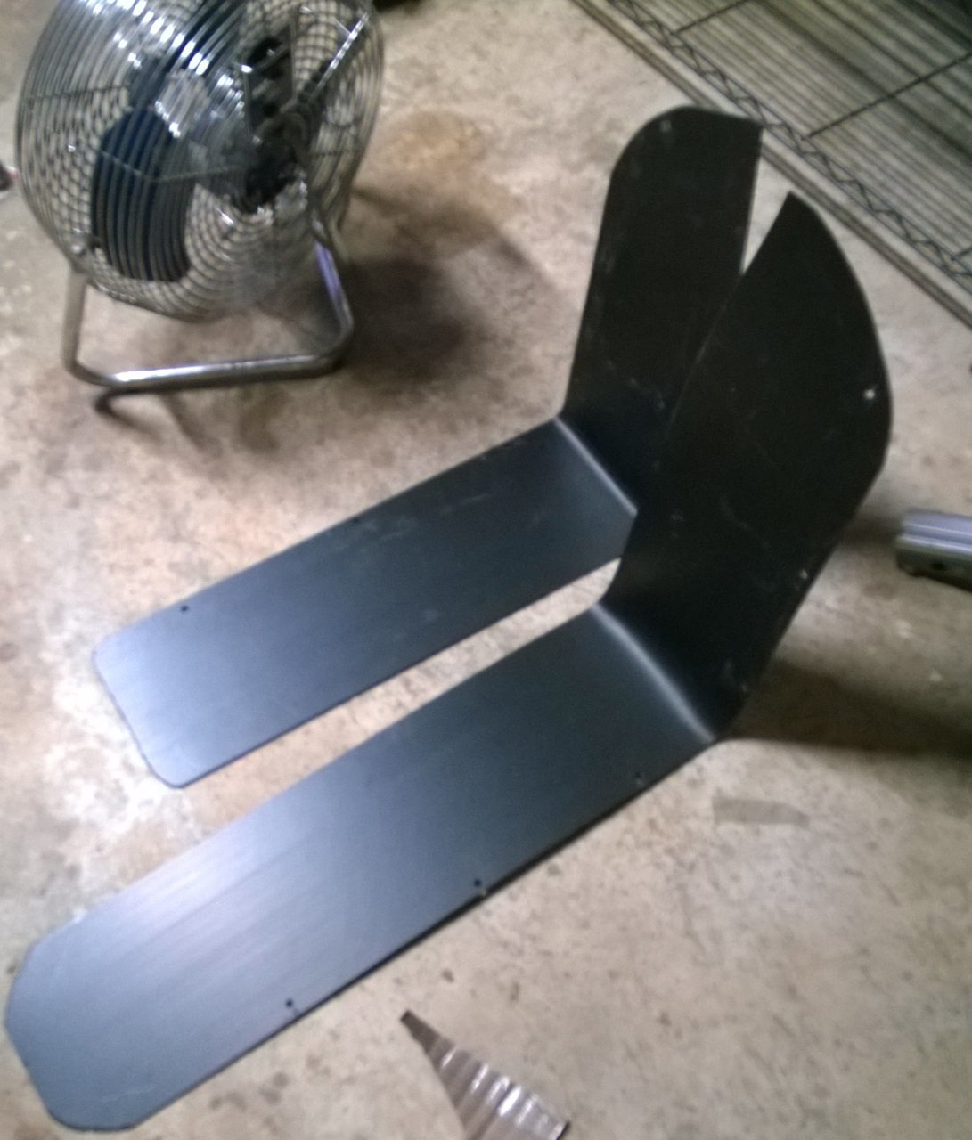

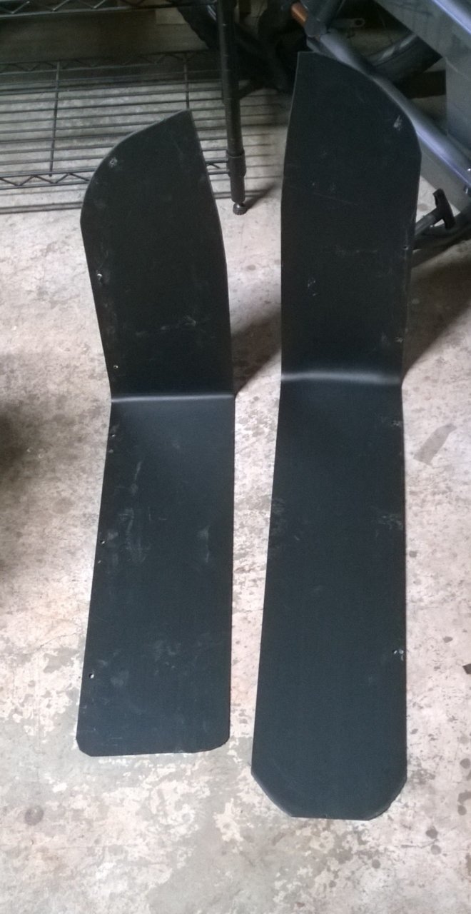

    I made some shields with some ABS plastic works pretty good I just attached them to what ever I could in the wheel opening and drilled some holes in the fender lip for the outer edge.

    I'll run out an get a pic later, but that is pretty close to the contour I needed.. I just heated them up and pre bent them before I installed them. I just wanted to cover the intake opening on the passenger side and the door hinges. So it just covers the top and back of the wheel opening.

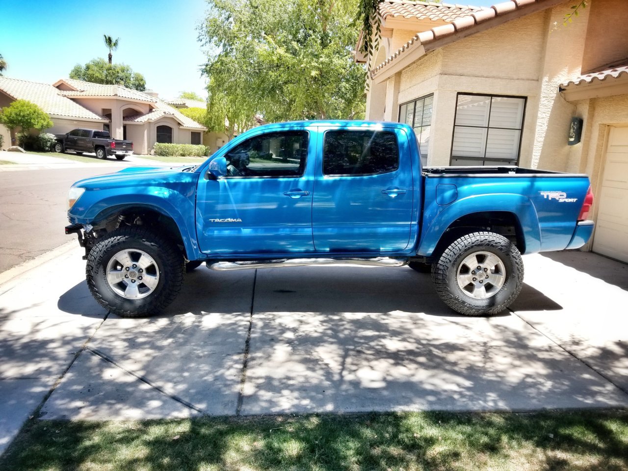

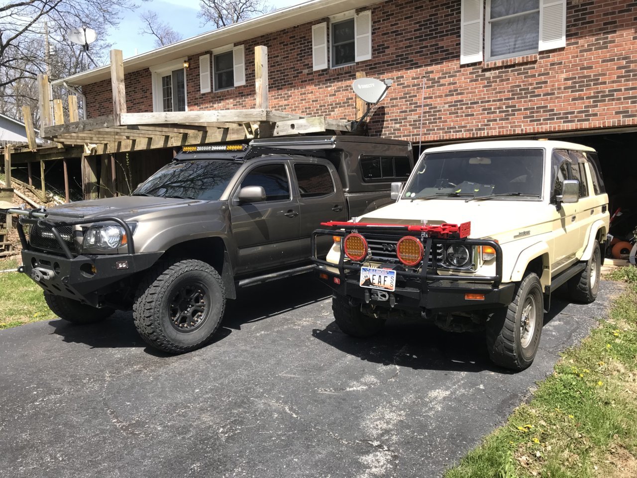

    Icon mid travel, 1.25 spacers, 285/75/17 (34ish") I scored these fenders used/unpainted and could not identify them via any logo's/branding but I believe they are glassworx, fit-up was a little iffy as they had been sitting in a backyard leaning up against a wall.. but they turned out nice after painting.. my painter warpped them back into place with heat lamps when he was curing the paint..

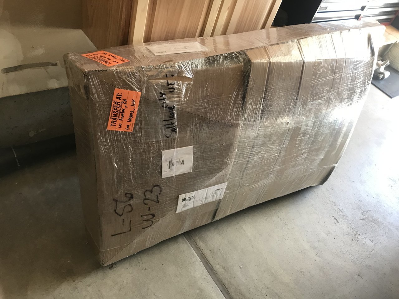

    Well my fenders came in today :cool:..... now to attempt to take the stock fenders off lol!

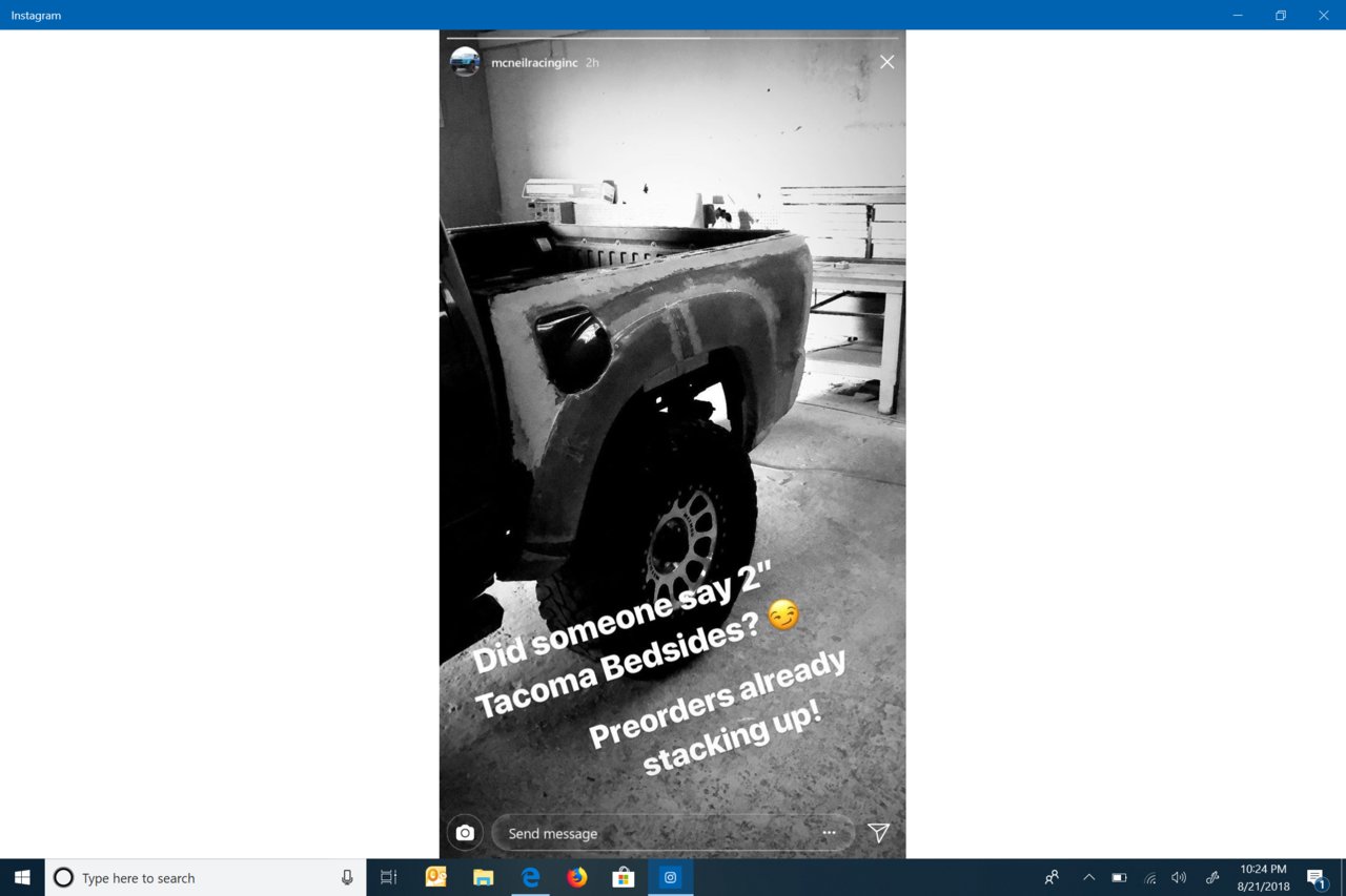

    I saw an Instagram sneak peek of the +2 bedsides.... its happening!!upload_2018-8-21_22-24-15.jpg
