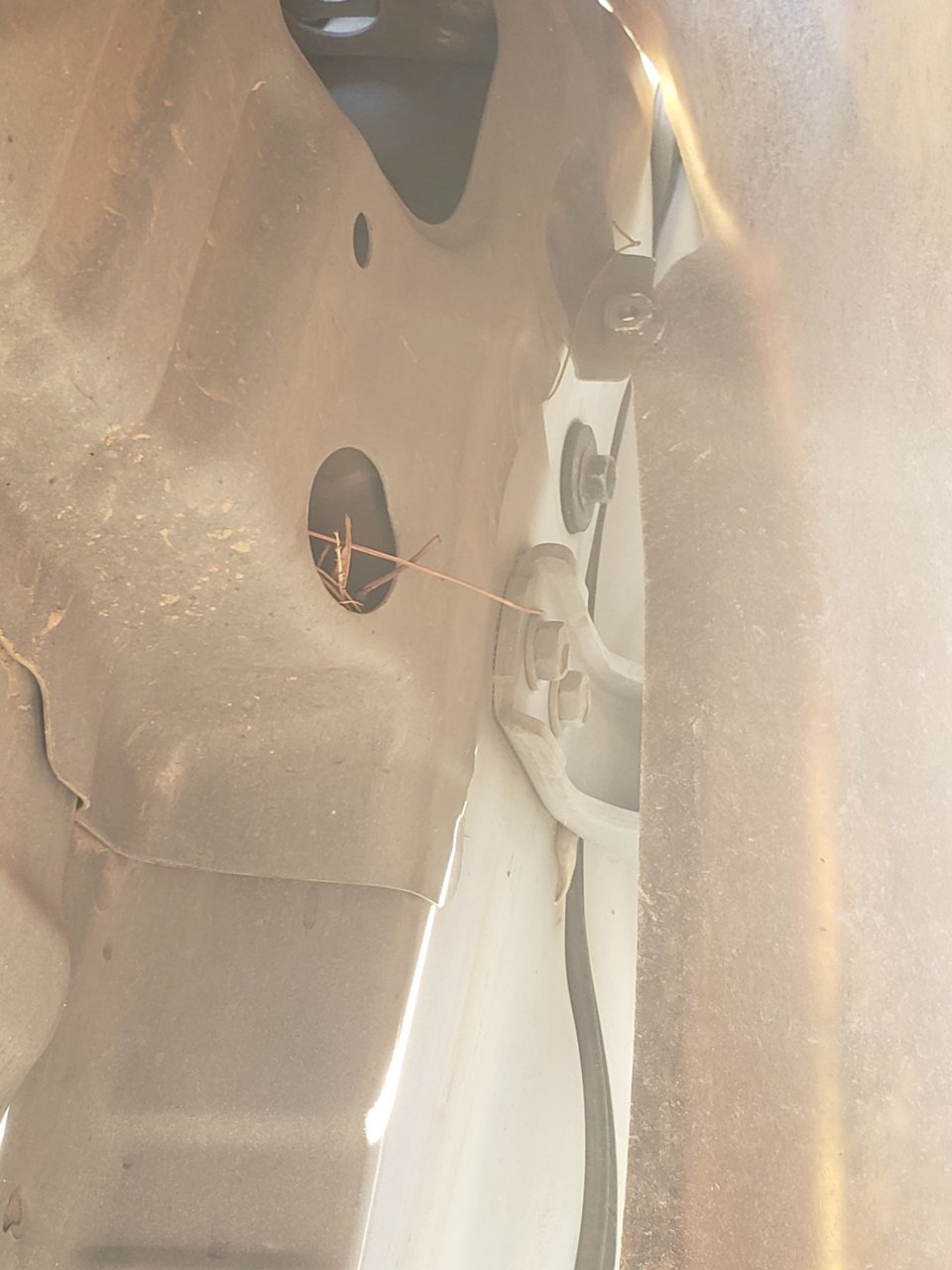

    The first hole on the top. They made it short is their anything I can do

    Only thing wasn't too happy about with McNeil fenders was inside hole was made too short idk what to do20190824_183730.jpg

    If it were me, I would attempt to fit a large washer to pinch the fiberglass in order to keep it from shifting. But in all honesty, with all the other bolts holding it I wouldn’t worry too much.

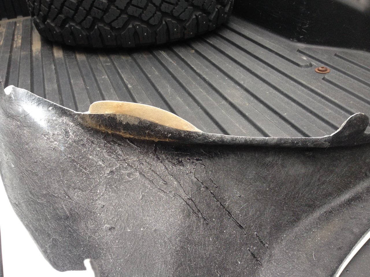

    I had the same thing happen when they over trimmed. Just went to west marine and grabbed a can of polyester resin and chopped mat and made the tab bigger.
